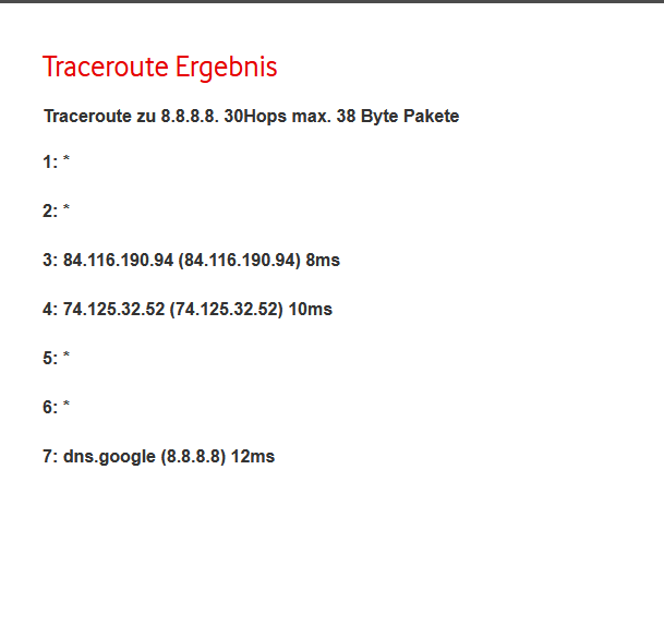

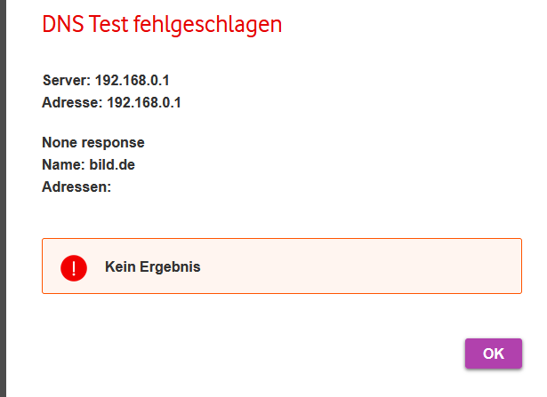

Vodafon Station diagnostics :

:~ $ traceroute 8.8.8.8
traceroute to 8.8.8.8 (8.8.8.8), 30 hops max, 60 byte packets
1 kabelbox.local (192.168.0.1) 1.141 ms 1.190 ms 2.411 ms
2 * * *
3 de-fra04a-rc1-ae23.fra.unity-media.net (81.210.141.29) 23.216 ms 24.394 ms 24.245 ms
4 84.116.190.94 (84.116.190.94) 21.227 ms 21.092 ms 21.072 ms
5 74.125.32.52 (74.125.32.52) 20.855 ms 18.911 ms 17.108 ms
6 * * *
7 dns.google (8.8.8.8) 19.693 ms 14.775 ms 14.665 ms

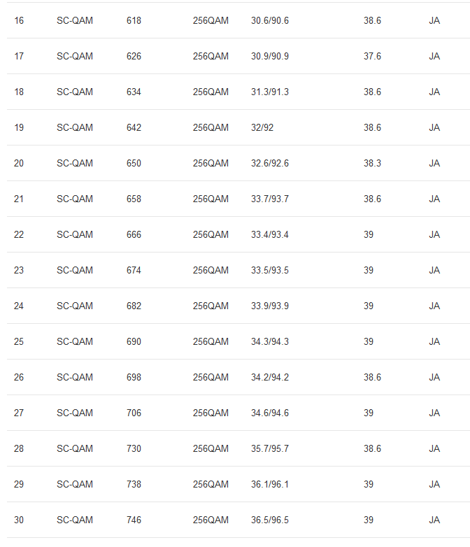

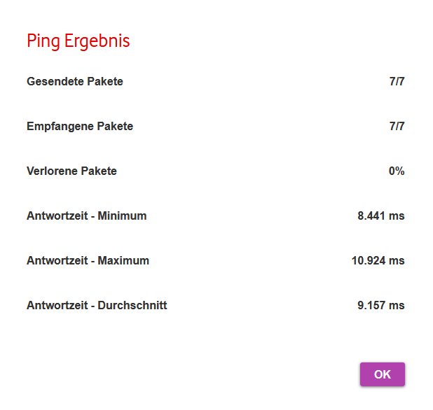

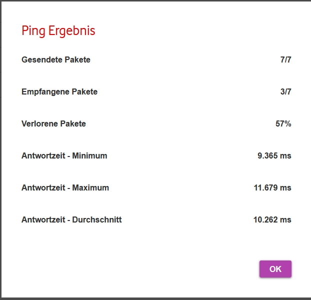

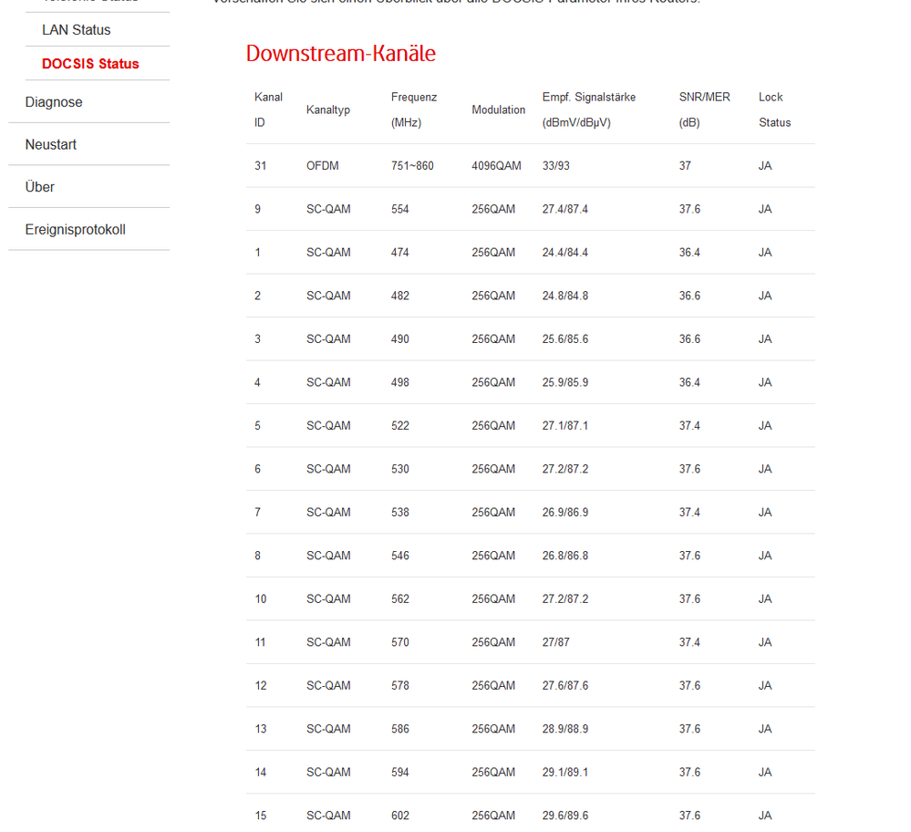

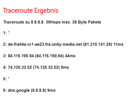

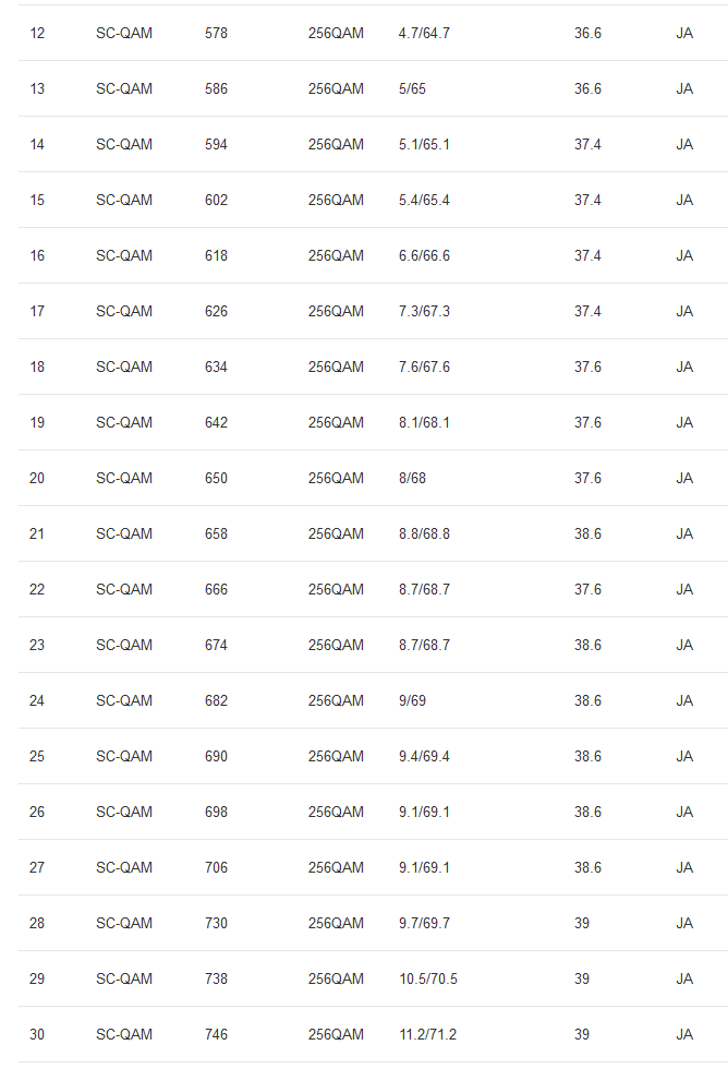

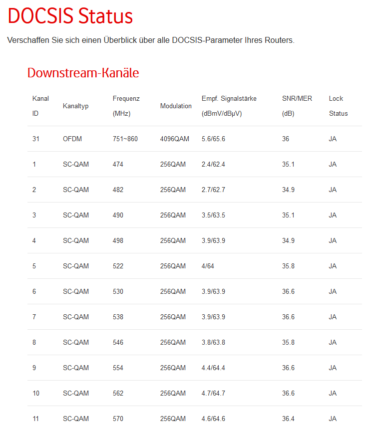

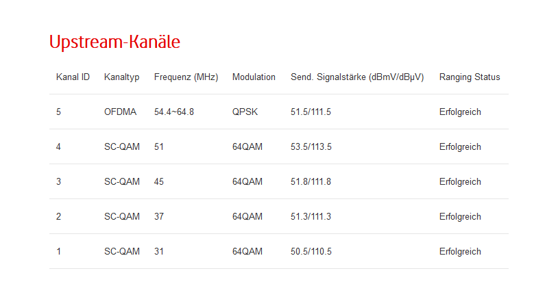

In attachments you can find outout from the Vodafonbox.
Tell me what's next in order to get the speed for which i pay, because if this is the maximum then i'm not happy to pay for 250 Mbit/s and to receive 25Mbit/s....
If on my address is not possible to get 250 Mbit/s then what speed i can get?
What are the next steps of troubleshooting ?
Best regards,
