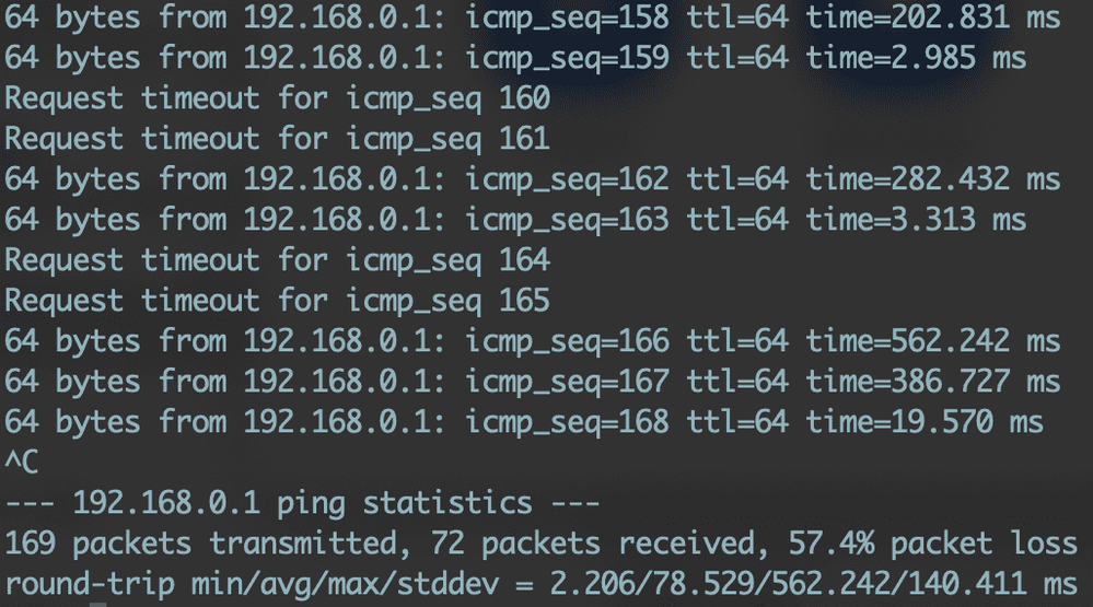

Please excuse my English. I've had the Vodafone Station for over 1 year now, and it is continuously giving issues now. I have the 1000Mbps Kabel connection, but I can never get more than 10Mbps from 10 meters away via wifi. I'm also experiencing constant Packet Loss and have to reboot the router almost daily. I do not think that I have the Wifi 6 model and would like to try it out before having to throw €30 at swopping it out for a Fritzbox and adding to my monthly bill.

  • Packet loss occurs regularly locally. Screenshots attached of ping values using WLAN from 0.5m away.
  • LAN and WLAN is used on multiple devices. Packet loss is experienced through both connections.
  • Chrome
  • Windows and MacOS
  • Daily, since product installation in January 2021
  • Signal values from the router to the exchange(Vodafone) are good. The issue is with the WLAN module on the router that is faulty.
  • I have contacted the hotline multiple times. They mostly recommend restarting of the router. I do this daily, which resolves the issue for a few hours. Then they occur again. Screenshot 2022-03-31 at 17.30.37.png

The option we have here is that we replace your router free of charge. Unfortunately, we can not guarantee that you actually get a Vodafone station with Wifi 6?
