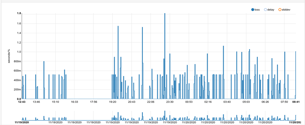

wealas
Not much of a change on my end. I've restarted modem and router several times and I've switched the monitoring IP but packet loss persits. And while the channel modulation seems to be pretty good I'm noticing reduced upstream - usually in the 20-25 mbit/s region. Here is a snapshot of the packet loss in the last 20 hours.
Thanks for the help!

Hello,
yes, I do have my own router. However, when I switch the network monitor to only ping the cable modem I get no packet loss. When I switch to ping 1.1.1.1 or 8.8.8.8 I get packet loss.
Here is a screenshot of the past 20 hours. You can see the period of no packet loss between 16 and 19 hours when the router was just pinging the cable modem. After that I switched to 8.8.8.8 and got consistent packet loss.
I also noticed that when the upstream channel modulation falls to 8 QAM the packet loss stops. It happened last week for about 2 days and as soon as the upstream modulation recovered to 16/32 QAM the packet loss was back without any intervention on my side.
Thanks!

wealas
Hi Martin,
packet loss happens throughout the day. Attached is a snapshot of the past 60 hours at 25min averages.
Thanks!
