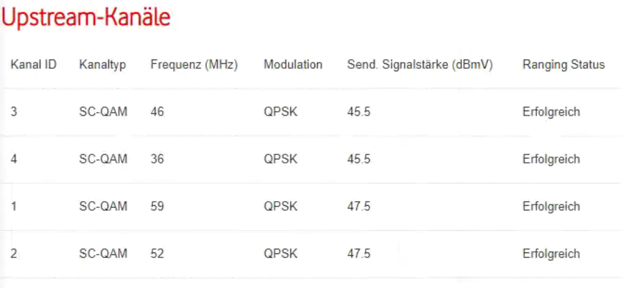

I saw this thread and posted our details there and saw someone talk about the modulation of upstream channels, so I checked this on our newly installed Vodafone Station box, and all 4 of our upstream channels are using QPSK modulation, which i believe will explain why the line is locking at 10-12mbps maximum upload and understand this shows a line fault?

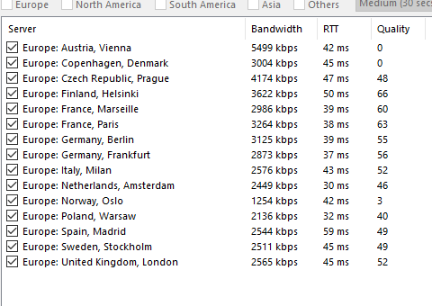

Also, here is the results of the twitch bandwidth test

An engineer came same-day yesterday and checked the internal cabling. He found the signal up to our apartment was not good and so we have moved our vodafone station kabel modem to the main amplified in the cellar which has better signal, but has not solved the problems.
He said the issue must be with the network outside the apartment, but that he wasn't able to solve that as he wasn't the correct type of engineer - so our problems persist.
Are you able to retest our line now, and if need be arrange another technician to resolve the faults with the connection into our apartment building?

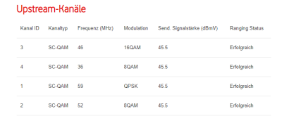

lcgee
This morning the line is much worse.
Upstream ChannelsUpstream ChannelsTwitch bandwidth testTwitch bandwidth testPingplotterPingplotter
