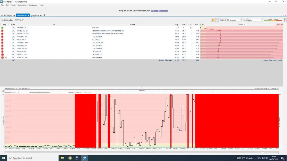

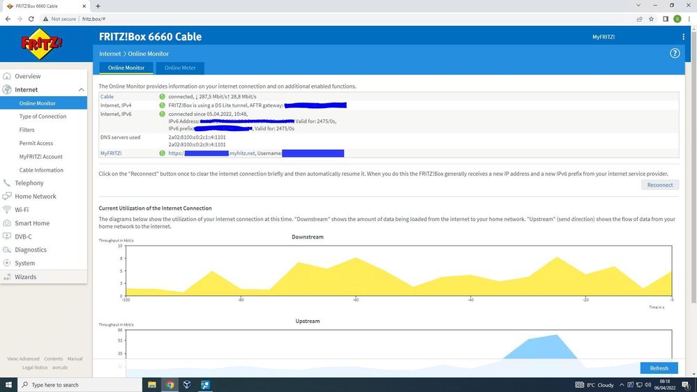

The issues persist this morning, no service at all. I had ping plotter running on a PC that was connected with ethernet to the router and it appears the outage started at approximately 07:07.
The web page on the fritz boz states that the internet connections is okay.

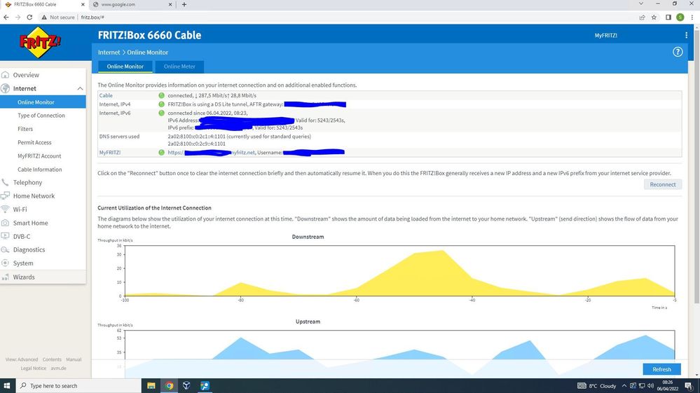

I pressed the reconnect button on the internet status webpage, once it 'reconnected' there was still no internet reachable.

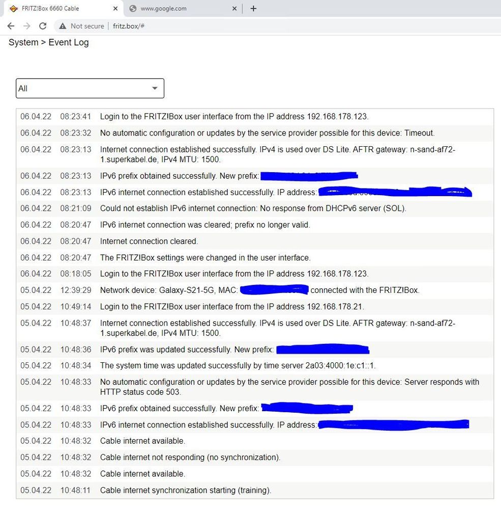

There is no information in the 'system log' to suggest what may be causing the problem.
fritz box system log 060422.jpgCan anyone on this form escalate this issue to Vodafone?

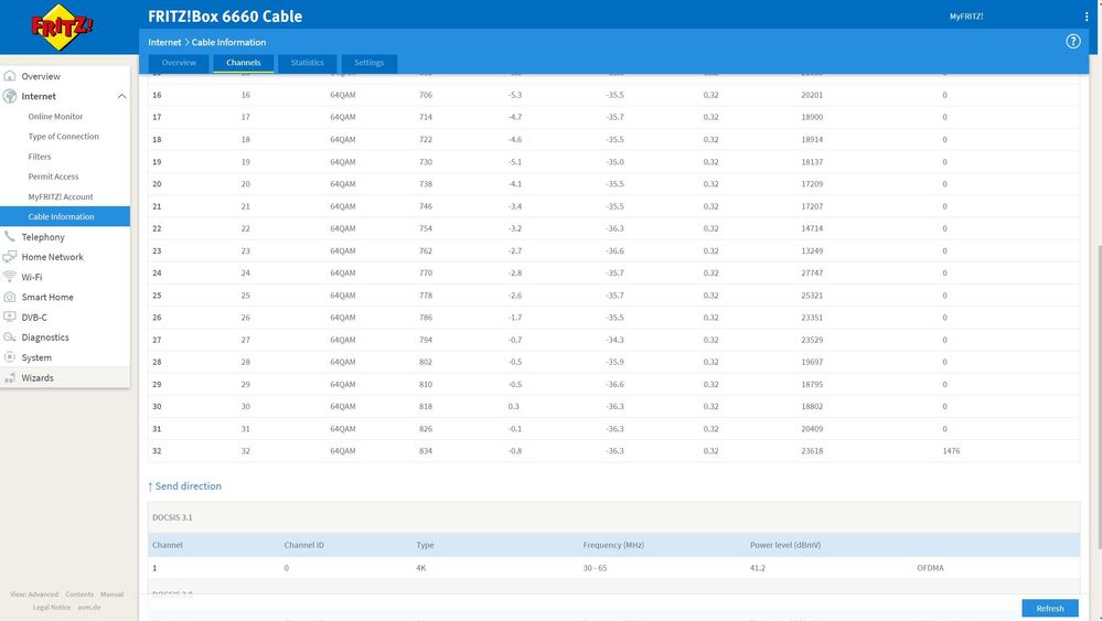

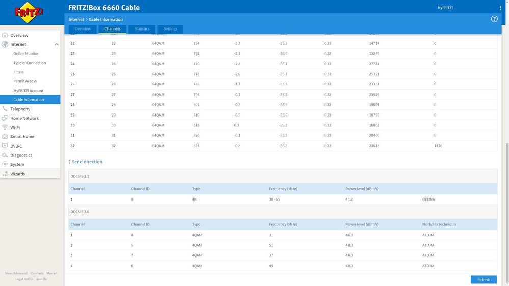

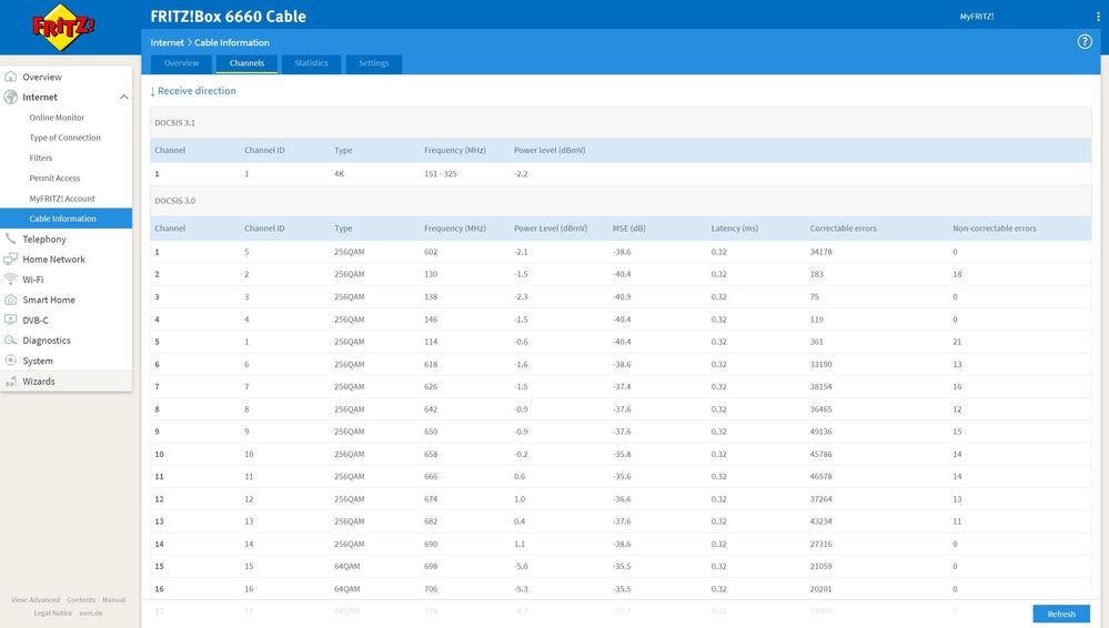

    Signal results 3 060422.JPGSignal results 2 060422.JPGSignal results 060422.JPG

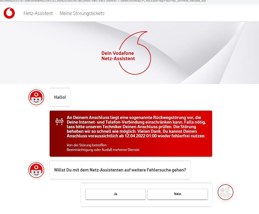

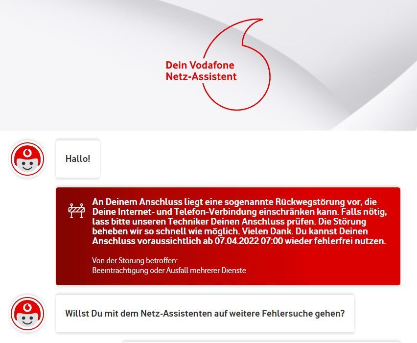

I just checked the net assistant and it states there is an issue with the line:
As I have had a lot of issues with the service since the start of the contract, I don't have much confidence that once this issue is resolved that all will be good.
Moni_GK
Hello scott1,
of course malfunctions are always annoying. However, it will show you that they are already working on the error.
Greetings Moni

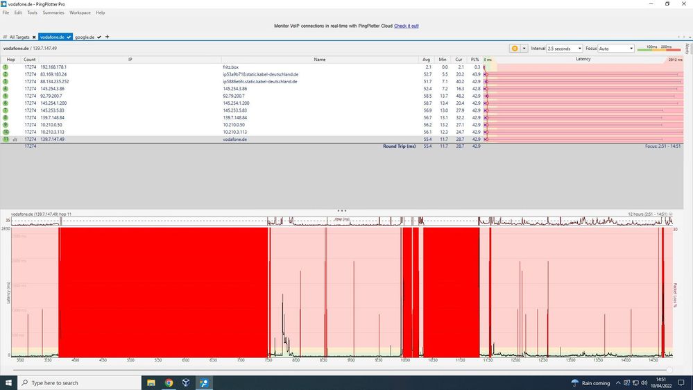

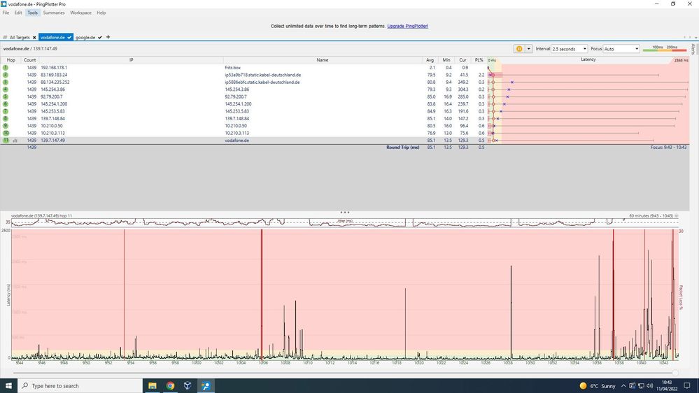

There service is again down today. When a webpage is requested is usually times outs, occasionaly it loads. The ping plotter results can be seen below: ping results 100422.JPG

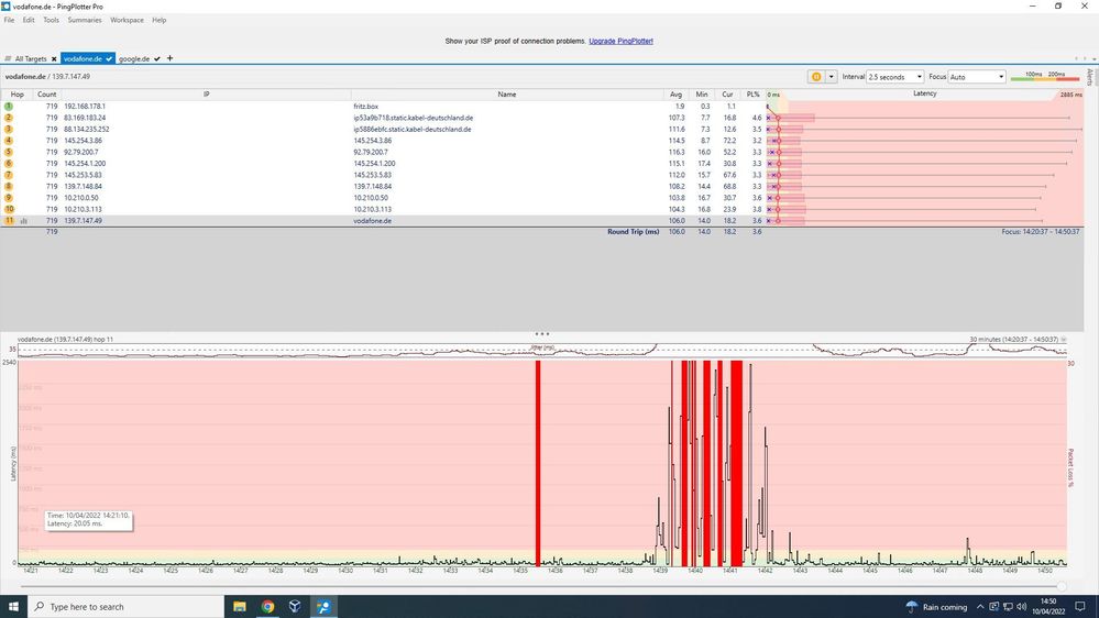

For the last 12 hours the ping performance has been poor. We have not been in the house most of today, but the instances of high latency appears to correlate to when we attempt to request a webpage:

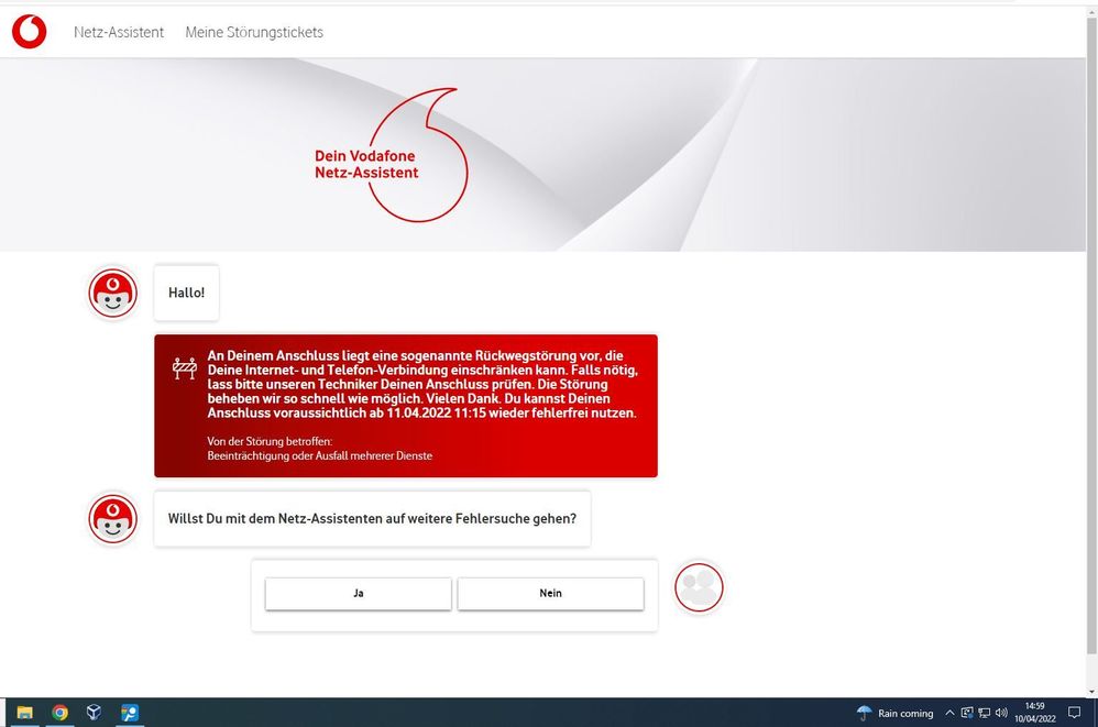

The Netz-Assistent states there is problem in the line and it will be correct by tomorrow afternoon. netz 100422.JPG
Am I able to cancel the contract given the continued poor level of service?
