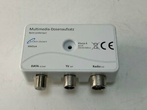

I contracted a new cable internet from vodafone for my new apartment. I got the vodafone router today but after setting up the router, the internet lid is blinking with red color for 3 hours.
After I checked the router admin area in DOCSIS, I saw that there is one downstream link, but there isn't any upstream link.
What should I do now?

Finally I found the problem. In my apartment the sockets was like this:
Based on Vodafone documents, I used the multimedia socket attachment for connecting router to socket:
And it never connected with it and the internet light was blinking red.
After that I searched for root of my cables in building and find out there is a tool like this in root of my cable:
I connected router directly to TAP 16 dB (without multimedia socket attachment) and after that the router connected.
So if with this approach, everything is OK, Yes you can cancel my appointment.
