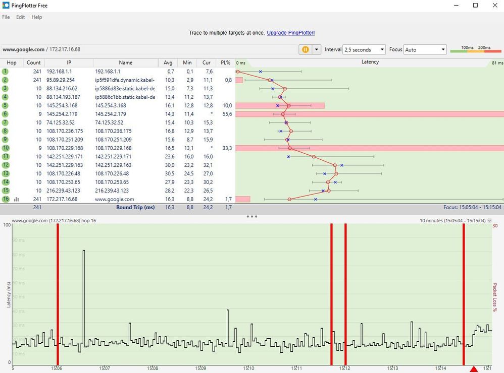

15:06h 20.01.22
Pinging www.google.com [172.217.16.68] with 128 bytes of data:
 Reply from 172.217.16.68:  bytes=68  time=24  TTL=113  seq=1
 Reply from 172.217.16.68:  bytes=68  time=27  TTL=113  seq=2
 Reply from 172.217.16.68:  bytes=68  time=23  TTL=113  seq=3
 Reply from 172.217.16.68:  bytes=68  time=24  TTL=113  seq=4
 Reply from 172.217.16.68:  bytes=68  time=22  TTL=113  seq=5
 Reply from 172.217.16.68:  bytes=68  time=23  TTL=113  seq=6
 Reply from 172.217.16.68:  bytes=68  time=26  TTL=113  seq=7
 Reply from 172.217.16.68:  bytes=68  time=23  TTL=113  seq=8
 Reply from 172.217.16.68:  bytes=68  time=26  TTL=113  seq=9
 Reply from 172.217.16.68:  bytes=68  time=40  TTL=113  seq=10
 Reply from 172.217.16.68:  bytes=68  time=24  TTL=113  seq=11
 Reply from 172.217.16.68:  bytes=68  time=26  TTL=113  seq=12
 Reply from 172.217.16.68:  bytes=68  time=21  TTL=113  seq=13
 Reply from 172.217.16.68:  bytes=68  time=22  TTL=113  seq=14
 Reply from 172.217.16.68:  bytes=68  time=22  TTL=113  seq=15
 Reply from 172.217.16.68:  bytes=68  time=23  TTL=113  seq=16
 Reply from 172.217.16.68:  bytes=68  time=29  TTL=113  seq=17
 Reply from 172.217.16.68:  bytes=68  time=25  TTL=113  seq=18
 Reply from 172.217.16.68:  bytes=68  time=28  TTL=113  seq=19
 Reply from 172.217.16.68:  bytes=68  time=23  TTL=113  seq=20
 Reply from 172.217.16.68:  bytes=68  time=22  TTL=113  seq=21
 Reply from 172.217.16.68:  bytes=68  time=88  TTL=113  seq=22
 Reply from 172.217.16.68:  bytes=68  time=90  TTL=113  seq=23
 Request timed out.
 Reply from 172.217.16.68:  bytes=68  time=24  TTL=113  seq=25
 Reply from 172.217.16.68:  bytes=68  time=73  TTL=113  seq=26
 Request timed out.
 Request timed out.
 Reply from 172.217.16.68:  bytes=68  time=23  TTL=113  seq=29
 Reply from 172.217.16.68:  bytes=68  time=23  TTL=113  seq=30
 Reply from 172.217.16.68:  bytes=68  time=22  TTL=113  seq=31
 Reply from 172.217.16.68:  bytes=68  time=28  TTL=113  seq=32
 Reply from 172.217.16.68:  bytes=68  time=24  TTL=113  seq=33
 Reply from 172.217.16.68:  bytes=68  time=23  TTL=113  seq=34
 Reply from 172.217.16.68:  bytes=68  time=24  TTL=113  seq=35
 Reply from 172.217.16.68:  bytes=68  time=25  TTL=113  seq=36
 Reply from 172.217.16.68:  bytes=68  time=22  TTL=113  seq=37
 Reply from 172.217.16.68:  bytes=68  time=18  TTL=113  seq=38
 Reply from 172.217.16.68:  bytes=68  time=22  TTL=113  seq=39
 Reply from 172.217.16.68:  bytes=68  time=29  TTL=113  seq=40
 Reply from 172.217.16.68:  bytes=68  time=22  TTL=113  seq=41
 Reply from 172.217.16.68:  bytes=68  time=24  TTL=113  seq=42
 Reply from 172.217.16.68:  bytes=68  time=23  TTL=113  seq=43
 Reply from 172.217.16.68:  bytes=68  time=24  TTL=113  seq=44
 Reply from 172.217.16.68:  bytes=68  time=21  TTL=113  seq=45
 Reply from 172.217.16.68:  bytes=68  time=22  TTL=113  seq=46
 Reply from 172.217.16.68:  bytes=68  time=27  TTL=113  seq=47
 Reply from 172.217.16.68:  bytes=68  time=27  TTL=113  seq=48
 Reply from 172.217.16.68:  bytes=68  time=26  TTL=113  seq=49
 Reply from 172.217.16.68:  bytes=68  time=24  TTL=113  seq=50
 Ping statistics for www.google.com
  Packets: Sent = 50, Received = 47, Lost = 3 (6% loss),
 Approximate round trip times in milliseconds:
  Minimum = 18, Maximum = 90, Average = 28

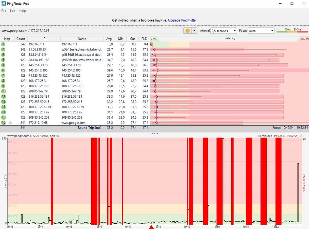

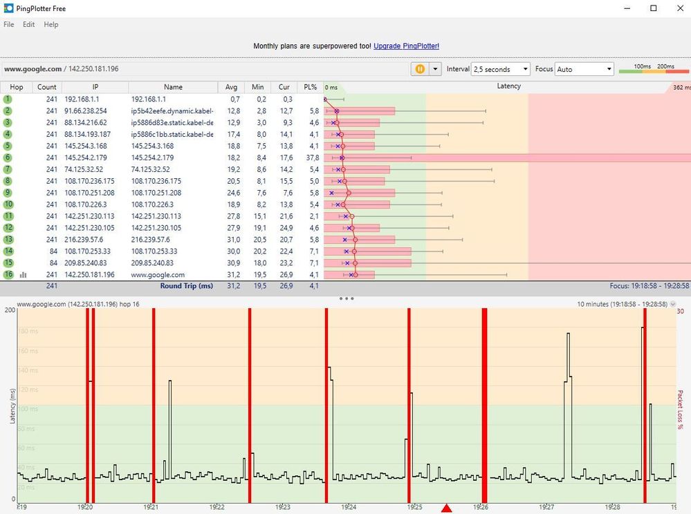

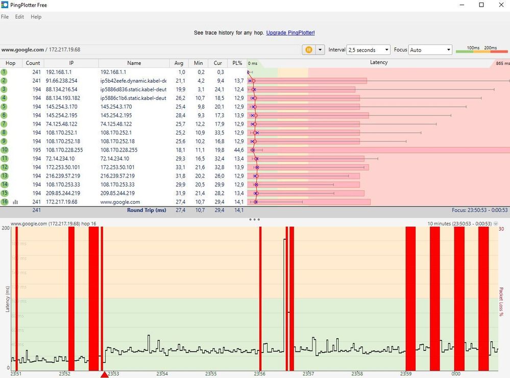

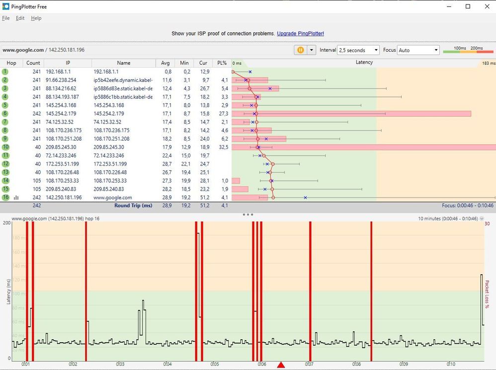

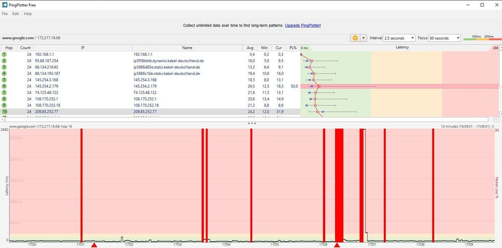

Anbei noch ein paar Screenshots von den Abbrüchen gestern.
23.01.2022 18:0523.01.2022 18:0523.01.2022 19:5223.01.2022 19:5224.01.2022 00:0024.01.2022 00:00

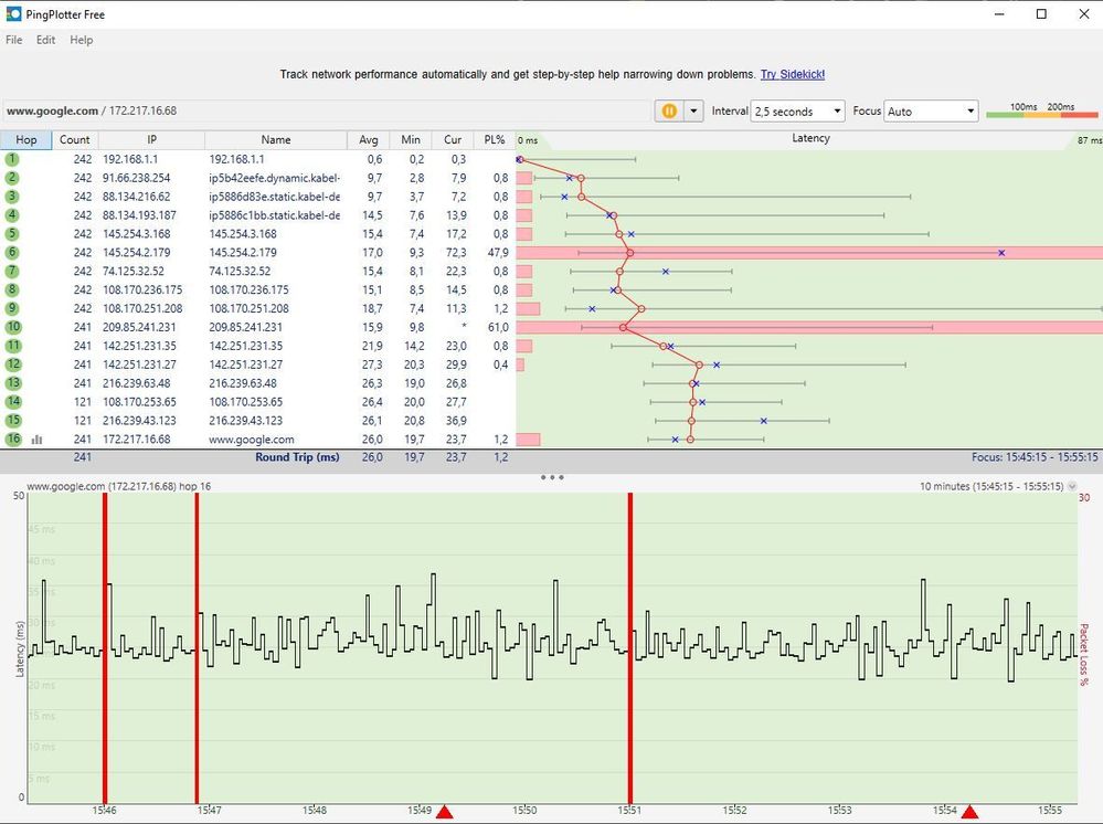

Zocken und Arbeiten war endlich die letzten 2 Tage wieder ohne Probleme möglich, auch wenn laut PingPlotter immer noch manchmal Pakete verloren gehen (siehe Screenshot).
Ich schaue jetzt mal wie es übers Wochenende läuft.
Danke und schönes Wochenende!
28.01.2022 15:5528.01.2022 15:55

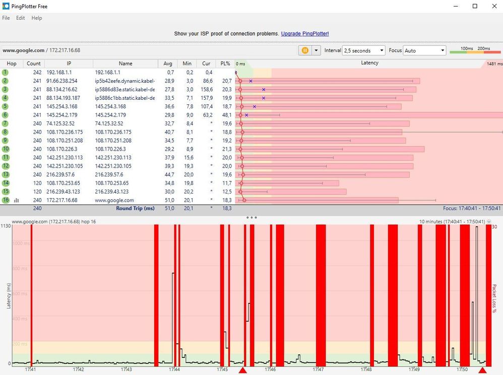

hier nochmal ein Update vom Wochenende (siehe Screenshots)
Gestern gab es allgmein eine große Störung, danach ging es wieder, aber auch wie immer mit kleinen Paketverlusten alle 3-5 Min. Habe gestern mal ausnahmsweise nicht dokumentiert.
Der letzte Screenshot ist von heute, leichte Paketverluste, aber so sieht es bei mir meistens aus, wenn es "gut" läuft.
Jetzt aktuell (in der Zeit, in der ich das hier schreibe) gabs es die letzten 10 Minuten gar keine Paketverluste, aber die werden sich heute wieder einschleichen. Das ist inzwischen so sicher wie das Amen in der Kirche...
30.01.22 - 18:38 (am Schluss Unterbrechung wegen Router+Modem-Neustart)30.01.22 - 18:38 (am Schluss Unterbrechung wegen Router+Modem-Neustart)
29.01.2022 - 17:4529.01.2022 - 17:4529.01.2022 - 00:1029.01.2022 - 00:1029.01.2022 -17:5029.01.2022 -17:5029.01.2022 - 19:2929.01.2022 - 19:29
01.02.2022 - 15:1501.02.2022 - 15:15
