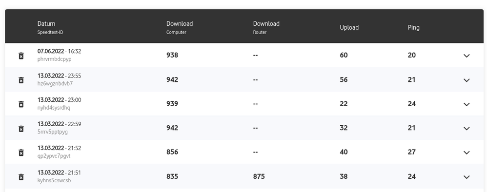

Ab wann abends hast Du die Probleme? Sende bitte eine Liste der Speedtestergebnisse, so sehen wir am besten die Schwankungen.

am 07.06.2022 17:02
SpeedtestsPLZ ist 24143
Bridge mode ist deaktiviert, ich benutze die Fritz!Box als Router
Habe auch einen solchen Upload Test angefügt.

[ 5] 874.00-875.01 sec 2.00 MBytes 16.8 Mbits/sec
[ 5] 875.01-876.01 sec 1.75 MBytes 14.7 Mbits/sec
[ 5] 876.01-877.00 sec 2.38 MBytes 20.0 Mbits/sec
[ 5] 877.00-878.00 sec 2.12 MBytes 17.9 Mbits/sec
[ 5] 878.00-879.01 sec 1.00 MBytes 8.29 Mbits/sec
[ 5] 879.01-880.01 sec 768 KBytes 6.30 Mbits/sec
[ 5] 880.01-881.01 sec 1.50 MBytes 12.6 Mbits/sec
[ 5] 881.01-882.00 sec 1.62 MBytes 13.7 Mbits/sec
[ 5] 882.00-883.01 sec 896 KBytes 7.28 Mbits/sec
[ 5] 883.01-884.00 sec 256 KBytes 2.11 Mbits/sec
[ 5] 884.00-885.02 sec 896 KBytes 7.26 Mbits/sec
[ 5] 885.02-886.01 sec 1.50 MBytes 12.6 Mbits/sec
[ 5] 886.01-887.01 sec 2.25 MBytes 18.9 Mbits/sec
[ 5] 887.01-888.01 sec 1.50 MBytes 12.6 Mbits/sec
[ 5] 888.01-889.00 sec 1.38 MBytes 11.6 Mbits/sec
[ 5] 889.00-890.00 sec 1.75 MBytes 14.7 Mbits/sec
[ 5] 890.00-891.02 sec 2.12 MBytes 17.6 Mbits/sec
[ 5] 891.02-892.01 sec 2.88 MBytes 24.3 Mbits/sec
[ 5] 892.01-893.00 sec 3.62 MBytes 30.5 Mbits/sec
[ 5] 893.00-894.01 sec 4.50 MBytes 37.4 Mbits/sec
[ 5] 894.01-895.01 sec 5.38 MBytes 45.2 Mbits/sec
[ 5] 895.01-896.00 sec 6.25 MBytes 52.8 Mbits/sec
[ 5] 896.00-897.01 sec 6.38 MBytes 52.9 Mbits/sec
[ 5] 897.01-898.01 sec 6.25 MBytes 52.7 Mbits/sec
[ 5] 898.01-899.01 sec 6.38 MBytes 53.2 Mbits/sec
[ 5] 899.01-900.00 sec 6.25 MBytes 52.9 Mbits/sec
Test Complete. Summary Results:
[ ID] Interval Transfer Bitrate
[ 5] 0.00-900.00 sec 4.99 GBytes 47.6 Mbits/sec sender
[ 5] 0.00-900.05 sec 4.98 GBytes 47.6 Mbits/sec receiver
CPU Utilization: local/sender 0.4% (0.2%u/0.3%s), remote/receiver 5.8% (0.8%u/5.0%s)
rcv_tcp_congestion cubic
iperf Done.13.06.2022 12:20 - bearbeitet 13.06.2022 12:24
Nicht ganz sauber, aber annehmbar. Mache den gleichen Test zur Primetime.
Ein Säulendiagramm kannst du selbst erstellen. Den kopierten Inhalt des test.txt files ab 1 sek. im geöffneten Excel als 'Inhalte einfügen' -> 'unformatierter Text' einfügen oder das file test.txt in Excel öffnen.
Lösche die Zeilen bis sek1
Die Vorgaben sind: https://i.imgur.com/842sw0w.png
