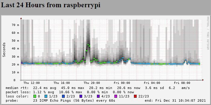

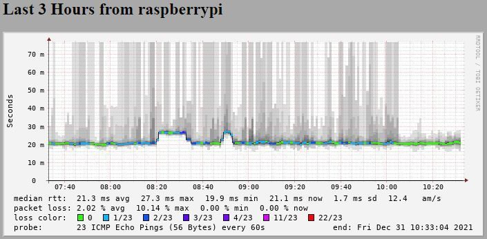

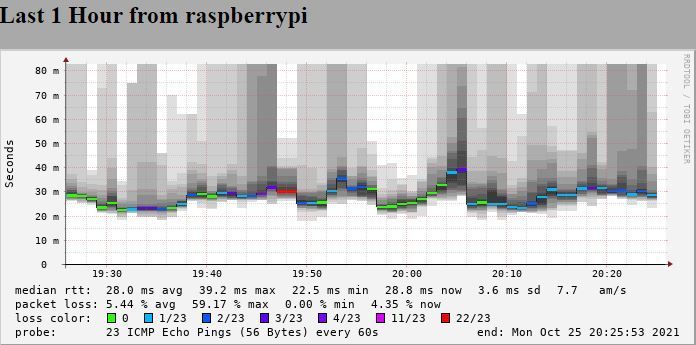

Beispiele von vielen vielen vielen Smokeping Aufzeichnungen dieser Art:

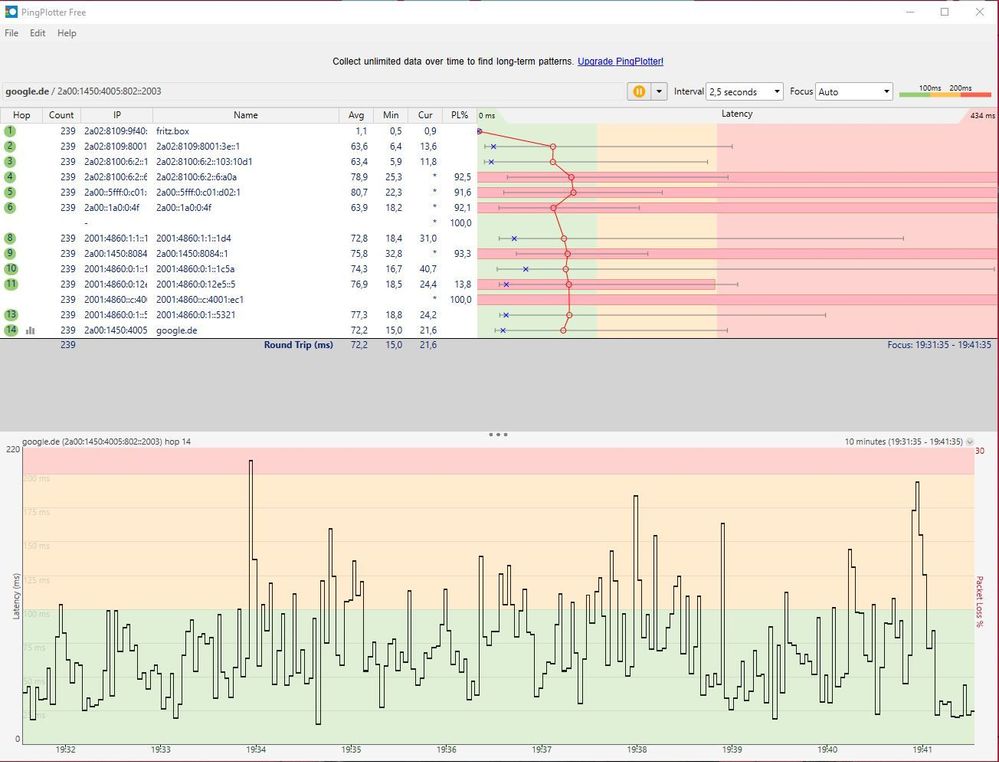

Modulationswerte / Pingplotter / iperf zum gleichen zeitpunkt heute:
Starting Test: protocol: TCP, 1 streams, 131072 byte blocks, omitting 0 seconds, 900 second test [ ID] Interval Transfer Bandwidth [ 4] 0.00-1.00 sec 4.75 MBytes 39.7 Mbits/sec [ 4] 1.00-2.01 sec 5.25 MBytes 43.7 Mbits/sec [ 4] 2.01-3.00 sec 5.50 MBytes 46.6 Mbits/sec [ 4] 3.00-4.01 sec 5.25 MBytes 43.7 Mbits/sec [ 4] 4.01-5.00 sec 5.12 MBytes 43.4 Mbits/sec [ 4] 5.00-6.01 sec 5.12 MBytes 42.5 Mbits/sec [ 4] 6.01-7.01 sec 5.00 MBytes 42.2 Mbits/sec [ 4] 7.01-8.00 sec 5.12 MBytes 43.2 Mbits/sec [ 4] 8.00-9.01 sec 5.00 MBytes 41.7 Mbits/sec [ 4] 9.01-10.01 sec 4.88 MBytes 40.7 Mbits/sec [ 4] 10.01-11.00 sec 4.75 MBytes 40.1 Mbits/sec [ 4] 11.00-12.01 sec 4.88 MBytes 40.7 Mbits/sec [ 4] 12.01-13.01 sec 4.38 MBytes 36.7 Mbits/sec [ 4] 13.01-14.00 sec 4.25 MBytes 35.8 Mbits/sec [ 4] 14.00-15.00 sec 4.25 MBytes 35.7 Mbits/sec [ 4] 15.00-16.00 sec 4.62 MBytes 38.9 Mbits/sec [ 4] 16.00-17.01 sec 5.00 MBytes 41.7 Mbits/sec [ 4] 17.01-18.01 sec 4.38 MBytes 36.8 Mbits/sec [ 4] 18.01-19.01 sec 3.62 MBytes 30.2 Mbits/sec [ 4] 19.01-20.01 sec 4.12 MBytes 34.6 Mbits/sec [ 4] 20.01-21.01 sec 4.25 MBytes 35.9 Mbits/sec [ 4] 21.01-22.01 sec 4.25 MBytes 35.6 Mbits/sec [ 4] 22.01-23.02 sec 1.38 MBytes 11.4 Mbits/sec [ 4] 23.02-24.01 sec 384 KBytes 3.18 Mbits/sec [ 4] 24.01-25.01 sec 256 KBytes 2.08 Mbits/sec [ 4] 25.01-26.00 sec 256 KBytes 2.12 Mbits/sec [ 4] 26.00-27.01 sec 512 KBytes 4.17 Mbits/sec [ 4] 27.01-28.01 sec 256 KBytes 2.08 Mbits/sec [ 4] 28.01-29.01 sec 384 KBytes 3.17 Mbits/sec [ 4] 29.01-30.01 sec 384 KBytes 3.13 Mbits/sec [ 4] 30.01-31.01 sec 256 KBytes 2.09 Mbits/sec [ 4] 31.01-32.01 sec 384 KBytes 3.17 Mbits/sec [ 4] 32.01-33.01 sec 640 KBytes 5.21 Mbits/sec [ 4] 33.01-34.01 sec 512 KBytes 4.21 Mbits/sec [ 4] 34.01-35.02 sec 384 KBytes 3.13 Mbits/sec [ 4] 35.02-36.00 sec 384 KBytes 3.18 Mbits/sec [ 4] 36.00-37.01 sec 512 KBytes 4.18 Mbits/sec [ 4] 37.01-38.02 sec 384 KBytes 3.12 Mbits/sec [ 4] 38.02-39.01 sec 512 KBytes 4.22 Mbits/sec [ 4] 39.01-40.00 sec 256 KBytes 2.11 Mbits/sec [ 4] 40.00-41.01 sec 384 KBytes 3.13 Mbits/sec [ 4] 41.01-42.01 sec 640 KBytes 5.24 Mbits/sec [ 4] 42.01-43.01 sec 384 KBytes 3.15 Mbits/sec [ 4] 43.01-44.01 sec 512 KBytes 4.18 Mbits/sec [ 4] 44.01-45.00 sec 384 KBytes 3.18 Mbits/sec [ 4] 45.00-46.01 sec 512 KBytes 4.16 Mbits/sec [ 4] 46.01-47.00 sec 640 KBytes 5.29 Mbits/sec [ 4] 47.00-48.01 sec 384 KBytes 3.11 Mbits/sec [ 4] 48.01-49.01 sec 256 KBytes 2.11 Mbits/sec [ 4] 49.01-50.01 sec 384 KBytes 3.12 Mbits/sec [ 4] 50.01-51.00 sec 384 KBytes 3.18 Mbits/sec [ 4] 51.00-52.01 sec 384 KBytes 3.12 Mbits/sec [ 4] 52.01-53.00 sec 256 KBytes 2.11 Mbits/sec [ 4] 53.00-54.01 sec 256 KBytes 2.08 Mbits/sec [ 4] 54.01-55.00 sec 384 KBytes 3.19 Mbits/sec [ 4] 55.00-56.01 sec 512 KBytes 4.17 Mbits/sec [ 4] 56.01-57.01 sec 512 KBytes 4.17 Mbits/sec [ 4] 57.01-58.01 sec 384 KBytes 3.16 Mbits/sec [ 4] 58.01-59.01 sec 384 KBytes 3.15 Mbits/sec [ 4] 59.01-60.01 sec 512 KBytes 4.19 Mbits/sec [ 4] 60.01-61.00 sec 256 KBytes 2.11 Mbits/sec [ 4] 61.00-62.01 sec 256 KBytes 2.08 Mbits/sec [ 4] 62.01-63.01 sec 512 KBytes 4.22 Mbits/sec [ 4] 63.01-64.00 sec 256 KBytes 2.11 Mbits/sec [ 4] 64.00-65.01 sec 384 KBytes 3.12 Mbits/sec [ 4] 65.01-66.01 sec 384 KBytes 3.13 Mbits/sec [ 4] 66.01-67.01 sec 256 KBytes 2.11 Mbits/sec [ 4] 67.01-68.01 sec 512 KBytes 4.19 Mbits/sec [ 4] 68.01-69.00 sec 128 KBytes 1.06 Mbits/sec [ 4] 69.00-70.01 sec 384 KBytes 3.13 Mbits/sec [ 4] 70.01-71.01 sec 512 KBytes 4.17 Mbits/sec [ 4] 71.01-72.01 sec 384 KBytes 3.14 Mbits/sec [ 4] 72.01-73.01 sec 512 KBytes 4.22 Mbits/sec [ 4] 73.01-74.01 sec 384 KBytes 3.12 Mbits/sec [ 4] 74.01-75.01 sec 512 KBytes 4.22 Mbits/sec [ 4] 75.01-76.01 sec 640 KBytes 5.21 Mbits/sec [ 4] 76.01-77.01 sec 512 KBytes 4.20 Mbits/sec [ 4] 77.01-78.01 sec 384 KBytes 3.16 Mbits/sec [ 4] 78.01-79.00 sec 512 KBytes 4.22 Mbits/sec [ 4] 79.00-80.01 sec 512 KBytes 4.17 Mbits/sec [ 4] 80.01-81.01 sec 640 KBytes 5.22 Mbits/sec [ 4] 81.01-82.01 sec 512 KBytes 4.22 Mbits/sec [ 4] 82.01-83.01 sec 512 KBytes 4.17 Mbits/sec [ 4] 83.01-84.00 sec 640 KBytes 5.29 Mbits/sec [ 4] 84.00-85.00 sec 512 KBytes 4.21 Mbits/sec [ 4] 85.00-86.01 sec 256 KBytes 2.07 Mbits/sec [ 4] 86.01-87.01 sec 256 KBytes 2.11 Mbits/sec [ 4] 87.01-88.02 sec 512 KBytes 4.17 Mbits/sec [ 4] 88.02-89.01 sec 512 KBytes 4.24 Mbits/sec [ 4] 89.01-90.00 sec 512 KBytes 4.20 Mbits/sec [ 4] 90.00-91.01 sec 384 KBytes 3.11 Mbits/sec [ 4] 91.01-92.01 sec 384 KBytes 3.16 Mbits/sec [ 4] 92.01-93.00 sec 384 KBytes 3.16 Mbits/sec [ 4] 93.00-94.01 sec 256 KBytes 2.07 Mbits/sec [ 4] 94.01-95.00 sec 256 KBytes 2.12 Mbits/sec [ 4] 95.00-96.00 sec 384 KBytes 3.15 Mbits/sec [ 4] 96.00-97.00 sec 128 KBytes 1.05 Mbits/sec [ 4] 97.00-98.01 sec 640 KBytes 5.19 Mbits/sec [ 4] 98.01-99.01 sec 512 KBytes 4.21 Mbits/sec [ 4] 99.01-100.01 sec 384 KBytes 3.16 Mbits/sec [ 4] 100.01-101.00 sec 384 KBytes 3.16 Mbits/sec [ 4] 101.00-102.01 sec 384 KBytes 3.13 Mbits/sec [ 4] 102.01-103.01 sec 384 KBytes 3.15 Mbits/sec [ 4] 103.01-104.00 sec 384 KBytes 3.16 Mbits/sec [ 4] 104.00-105.01 sec 512 KBytes 4.18 Mbits/sec [ 4] 105.01-106.00 sec 384 KBytes 3.16 Mbits/sec [ 4] 106.00-107.01 sec 512 KBytes 4.15 Mbits/sec [ 4] 107.01-108.02 sec 384 KBytes 3.14 Mbits/sec [ 4] 108.02-109.01 sec 384 KBytes 3.16 Mbits/sec [ 4] 109.01-110.00 sec 512 KBytes 4.23 Mbits/sec [ 4] 110.00-111.00 sec 512 KBytes 4.19 Mbits/sec [ 4] 111.00-112.01 sec 512 KBytes 4.15 Mbits/sec [ 4] 112.01-113.01 sec 512 KBytes 4.22 Mbits/sec [ 4] 113.01-114.01 sec 256 KBytes 2.09 Mbits/sec [ 4] 114.01-115.01 sec 512 KBytes 4.21 Mbits/sec [ 4] 115.01-116.00 sec 640 KBytes 5.28 Mbits/sec [ 4] 116.00-117.00 sec 256 KBytes 2.10 Mbits/sec [ 4] 117.00-118.01 sec 512 KBytes 4.17 Mbits/sec [ 4] 118.01-119.01 sec 384 KBytes 3.14 Mbits/sec [ 4] 119.01-120.02 sec 512 KBytes 4.16 Mbits/sec [ 4] 120.02-121.00 sec 640 KBytes 5.31 Mbits/sec [ 4] 121.00-122.00 sec 384 KBytes 3.15 Mbits/sec [ 4] 122.00-123.01 sec 512 KBytes 4.17 Mbits/sec [ 4] 123.01-135.32 sec 256 KBytes 170 Kbits/sec [ 4] 135.32-135.32 sec 0.00 Bytes 0.00 bits/sec [ 4] 135.32-135.32 sec 0.00 Bytes 0.00 bits/sec [ 4] 135.32-135.32 sec 0.00 Bytes 0.00 bits/sec [ 4] 135.32-135.32 sec 0.00 Bytes 0.00 bits/sec [ 4] 135.32-135.32 sec 0.00 Bytes 0.00 bits/sec [ 4] 135.32-135.32 sec 0.00 Bytes 0.00 bits/sec [ 4] 135.32-135.32 sec 0.00 Bytes 0.00 bits/sec [ 4] 135.32-135.32 sec 0.00 Bytes 0.00 bits/sec [ 4] 135.32-135.33 sec 0.00 Bytes 0.00 bits/sec [ 4] 135.33-135.33 sec 0.00 Bytes 0.00 bits/sec [ 4] 135.33-135.33 sec 0.00 Bytes 0.00 bits/sec [ 4] 135.33-136.01 sec 384 KBytes 4.60 Mbits/sec [ 4] 136.01-137.00 sec 1.38 MBytes 11.6 Mbits/sec [ 4] 137.00-138.01 sec 2.62 MBytes 21.9 Mbits/sec [ 4] 138.01-139.00 sec 3.12 MBytes 26.4 Mbits/sec [ 4] 139.00-140.01 sec 3.62 MBytes 30.2 Mbits/sec [ 4] 140.01-141.02 sec 4.62 MBytes 38.5 Mbits/sec [ 4] 141.02-142.01 sec 4.75 MBytes 40.0 Mbits/sec [ 4] 142.01-143.00 sec 5.12 MBytes 43.5 Mbits/sec [ 4] 143.00-144.01 sec 5.12 MBytes 42.7 Mbits/sec [ 4] 144.01-145.00 sec 5.00 MBytes 42.2 Mbits/sec [ 4] 145.00-146.01 sec 5.00 MBytes 41.5 Mbits/sec [ 4] 146.01-147.00 sec 5.38 MBytes 45.5 Mbits/sec [ 4] 147.00-148.01 sec 5.12 MBytes 42.6 Mbits/sec [ 4] 148.01-149.00 sec 5.12 MBytes 43.4 Mbits/sec [ 4] 149.00-150.00 sec 4.62 MBytes 38.8 Mbits/sec [ 4] 150.00-151.00 sec 3.75 MBytes 31.4 Mbits/sec [ 4] 151.00-152.00 sec 2.75 MBytes 23.1 Mbits/sec [ 4] 152.00-153.01 sec 2.12 MBytes 17.6 Mbits/sec [ 4] 153.01-154.01 sec 1.88 MBytes 15.8 Mbits/sec [ 4] 154.01-155.01 sec 2.00 MBytes 16.7 Mbits/sec [ 4] 155.01-156.00 sec 1.88 MBytes 15.9 Mbits/sec [ 4] 156.00-157.01 sec 1.88 MBytes 15.7 Mbits/sec [ 4] 157.01-158.00 sec 2.00 MBytes 16.8 Mbits/sec [ 4] 158.00-159.01 sec 1.88 MBytes 15.6 Mbits/sec [ 4] 159.01-160.01 sec 1.88 MBytes 15.8 Mbits/sec [ 4] 160.01-161.00 sec 2.75 MBytes 23.2 Mbits/sec [ 4] 161.00-162.00 sec 768 KBytes 6.30 Mbits/sec [ 4] 162.00-163.00 sec 384 KBytes 3.15 Mbits/sec [ 4] 163.00-164.00 sec 128 KBytes 1.05 Mbits/sec [ 4] 164.00-165.01 sec 0.00 Bytes 0.00 bits/sec [ 4] 165.01-166.00 sec 256 KBytes 2.12 Mbits/sec [ 4] 166.00-167.01 sec 128 KBytes 1.04 Mbits/sec [ 4] 167.01-168.00 sec 128 KBytes 1.06 Mbits/sec [ 4] 168.00-169.01 sec 0.00 Bytes 0.00 bits/sec [ 4] 169.01-170.01 sec 256 KBytes 2.09 Mbits/sec [ 4] 170.01-171.00 sec 128 KBytes 1.06 Mbits/sec [ 4] 171.00-172.00 sec 256 KBytes 2.10 Mbits/sec [ 4] 172.00-173.00 sec 1.12 MBytes 9.44 Mbits/sec [ 4] 173.00-174.00 sec 768 KBytes 6.30 Mbits/sec [ 4] 174.00-175.01 sec 1.50 MBytes 12.4 Mbits/sec [ 4] 175.01-176.01 sec 2.00 MBytes 16.8 Mbits/sec [ 4] 176.01-177.01 sec 3.00 MBytes 25.3 Mbits/sec [ 4] 177.01-178.01 sec 4.38 MBytes 36.7 Mbits/sec [ 4] 178.01-179.00 sec 5.12 MBytes 43.3 Mbits/sec [ 4] 179.00-180.01 sec 5.25 MBytes 43.7 Mbits/sec [ 4] 180.01-181.02 sec 5.12 MBytes 42.6 Mbits/sec [ 4] 181.02-182.01 sec 5.00 MBytes 42.2 Mbits/sec [ 4] 182.01-183.01 sec 5.12 MBytes 43.2 Mbits/sec [ 4] 183.01-184.00 sec 5.38 MBytes 45.3 Mbits/sec [ 4] 184.00-185.00 sec 4.62 MBytes 38.9 Mbits/sec [ 4] 185.00-186.01 sec 5.25 MBytes 43.7 Mbits/sec [ 4] 186.01-187.01 sec 4.88 MBytes 40.8 Mbits/sec [ 4] 187.01-188.01 sec 4.75 MBytes 39.8 Mbits/sec [ 4] 188.01-189.00 sec 4.75 MBytes 40.2 Mbits/sec [ 4] 189.00-190.00 sec 4.62 MBytes 38.8 Mbits/sec [ 4] 190.00-191.01 sec 4.75 MBytes 39.7 Mbits/sec [ 4] 191.01-192.01 sec 4.62 MBytes 38.7 Mbits/sec [ 4] 192.01-193.00 sec 4.25 MBytes 35.9 Mbits/sec [ 4] 193.00-194.01 sec 4.75 MBytes 39.5 Mbits/sec [ 4] 194.01-195.01 sec 4.12 MBytes 34.7 Mbits/sec [ 4] 195.01-196.00 sec 4.38 MBytes 36.8 Mbits/sec [ 4] 196.00-197.01 sec 4.62 MBytes 38.6 Mbits/sec [ 4] 197.01-198.01 sec 4.62 MBytes 39.0 Mbits/sec [ 4] 198.01-199.01 sec 4.88 MBytes 40.8 Mbits/sec [ 4] 199.01-200.01 sec 5.00 MBytes 41.8 Mbits/sec [ 4] 200.01-201.01 sec 4.25 MBytes 35.7 Mbits/sec [ 4] 201.01-202.00 sec 4.88 MBytes 41.1 Mbits/sec [ 4] 202.00-203.01 sec 5.12 MBytes 42.6 Mbits/sec [ 4] 203.01-204.01 sec 4.75 MBytes 39.9 Mbits/sec [ 4] 204.01-205.01 sec 5.00 MBytes 41.9 Mbits/sec [ 4] 205.01-206.01 sec 4.38 MBytes 36.7 Mbits/sec [ 4] 206.01-207.00 sec 5.12 MBytes 43.3 Mbits/sec [ 4] 207.00-208.00 sec 5.12 MBytes 43.0 Mbits/sec [ 4] 208.00-209.00 sec 5.12 MBytes 43.1 Mbits/sec [ 4] 209.00-210.00 sec 5.12 MBytes 43.0 Mbits/sec [ 4] 210.00-211.00 sec 4.50 MBytes 37.6 Mbits/sec [ 4] 211.00-212.01 sec 4.25 MBytes 35.3 Mbits/sec [ 4] 212.01-213.01 sec 4.12 MBytes 34.9 Mbits/sec [ 4] 213.01-214.00 sec 4.88 MBytes 41.1 Mbits/sec [ 4] 214.00-215.00 sec 5.12 MBytes 43.0 Mbits/sec [ 4] 215.00-216.01 sec 4.88 MBytes 40.5 Mbits/sec [ 4] 216.01-217.01 sec 4.88 MBytes 41.2 Mbits/sec [ 4] 217.01-218.01 sec 5.50 MBytes 46.0 Mbits/sec [ 4] 218.01-219.01 sec 4.75 MBytes 39.9 Mbits/sec [ 4] 219.01-220.00 sec 5.00 MBytes 42.1 Mbits/sec [ 4] 220.00-221.00 sec 5.12 MBytes 42.9 Mbits/sec [ 4] 221.00-222.01 sec 5.12 MBytes 42.7 Mbits/sec [ 4] 222.01-223.00 sec 5.38 MBytes 45.4 Mbits/sec [ 4] 223.00-224.01 sec 5.12 MBytes 42.6 Mbits/sec [ 4] 224.01-225.01 sec 4.75 MBytes 40.1 Mbits/sec [ 4] 225.01-226.00 sec 4.62 MBytes 38.9 Mbits/sec [ 4] 226.00-227.00 sec 3.75 MBytes 31.5 Mbits/sec [ 4] 227.00-228.01 sec 2.00 MBytes 16.7 Mbits/sec [ 4] 228.01-229.01 sec 1.12 MBytes 9.42 Mbits/sec [ 4] 229.01-230.02 sec 1.12 MBytes 9.38 Mbits/sec [ 4] 230.02-231.01 sec 1.12 MBytes 9.52 Mbits/sec [ 4] 231.01-232.01 sec 1.75 MBytes 14.6 Mbits/sec [ 4] 232.01-233.00 sec 1.88 MBytes 15.8 Mbits/sec [ 4] 233.00-234.01 sec 1.00 MBytes 8.34 Mbits/sec [ 4] 234.01-235.00 sec 1.00 MBytes 8.43 Mbits/sec [ 4] 235.00-236.01 sec 1.50 MBytes 12.5 Mbits/sec [ 4] 236.01-237.02 sec 1.38 MBytes 11.5 Mbits/sec [ 4] 237.02-238.01 sec 1.50 MBytes 12.7 Mbits/sec [ 4] 238.01-239.00 sec 1.25 MBytes 10.5 Mbits/sec [ 4] 239.00-240.01 sec 1.62 MBytes 13.5 Mbits/sec [ 4] 240.01-241.00 sec 1.75 MBytes 14.8 Mbits/sec [ 4] 241.00-242.01 sec 2.50 MBytes 20.9 Mbits/sec [ 4] 242.01-243.01 sec 1.88 MBytes 15.7 Mbits/sec [ 4] 243.01-244.01 sec 2.25 MBytes 19.0 Mbits/sec [ 4] 244.01-245.00 sec 2.12 MBytes 18.0 Mbits/sec [ 4] 245.00-246.01 sec 1.25 MBytes 10.4 Mbits/sec [ 4] 246.01-247.01 sec 896 KBytes 7.30 Mbits/sec [ 4] 247.01-248.00 sec 640 KBytes 5.28 Mbits/sec [ 4] 248.00-249.01 sec 1.12 MBytes 9.41 Mbits/sec [ 4] 249.01-250.01 sec 896 KBytes 7.32 Mbits/sec [ 4] 250.01-251.01 sec 640 KBytes 5.26 Mbits/sec [ 4] 251.01-252.01 sec 768 KBytes 6.28 Mbits/sec [ 4] 252.01-253.00 sec 768 KBytes 6.33 Mbits/sec [ 4] 253.00-254.01 sec 1.00 MBytes 8.29 Mbits/sec [ 4] 254.01-255.01 sec 768 KBytes 6.32 Mbits/sec [ 4] 255.01-256.01 sec 1.25 MBytes 10.5 Mbits/sec [ 4] 256.01-257.01 sec 1.25 MBytes 10.4 Mbits/sec [ 4] 257.01-258.01 sec 1.25 MBytes 10.6 Mbits/sec [ 4] 258.01-259.01 sec 1.25 MBytes 10.5 Mbits/sec [ 4] 259.01-260.01 sec 2.50 MBytes 20.9 Mbits/sec [ 4] 260.01-261.01 sec 2.50 MBytes 20.9 Mbits/sec [ 4] 261.01-262.01 sec 2.50 MBytes 21.1 Mbits/sec [ 4] 262.01-263.01 sec 2.88 MBytes 23.9 Mbits/sec [ 4] 263.01-264.01 sec 2.50 MBytes 21.1 Mbits/sec [ 4] 264.01-265.01 sec 2.00 MBytes 16.8 Mbits/sec [ 4] 265.01-266.01 sec 3.25 MBytes 27.3 Mbits/sec [ 4] 266.01-267.00 sec 3.62 MBytes 30.5 Mbits/sec [ 4] 267.00-268.00 sec 2.62 MBytes 22.1 Mbits/sec [ 4] 268.00-269.00 sec 2.88 MBytes 24.1 Mbits/sec [ 4] 269.00-270.00 sec 2.12 MBytes 17.9 Mbits/sec [ 4] 270.00-271.01 sec 2.50 MBytes 20.8 Mbits/sec [ 4] 271.01-272.00 sec 3.12 MBytes 26.4 Mbits/sec [ 4] 272.00-273.00 sec 3.75 MBytes 31.6 Mbits/sec [ 4] 273.00-274.01 sec 4.00 MBytes 33.3 Mbits/sec [ 4] 274.01-275.00 sec 3.00 MBytes 25.3 Mbits/sec [ 4] 275.00-276.00 sec 3.88 MBytes 32.5 Mbits/sec [ 4] 276.00-277.00 sec 4.62 MBytes 38.9 Mbits/sec [ 4] 277.00-278.00 sec 4.62 MBytes 38.7 Mbits/sec [ 4] 278.00-279.00 sec 4.75 MBytes 39.8 Mbits/sec [ 4] 279.00-280.00 sec 4.50 MBytes 37.8 Mbits/sec [ 4] 280.00-281.01 sec 3.25 MBytes 27.2 Mbits/sec [ 4] 281.01-282.02 sec 3.12 MBytes 26.0 Mbits/sec [ 4] 282.02-283.01 sec 2.50 MBytes 21.0 Mbits/sec [ 4] 283.01-284.01 sec 1.25 MBytes 10.5 Mbits/sec [ 4] 284.01-285.00 sec 1.62 MBytes 13.7 Mbits/sec [ 4] 285.00-286.01 sec 3.00 MBytes 25.0 Mbits/sec [ 4] 286.01-287.00 sec 4.00 MBytes 33.8 Mbits/sec [ 4] 287.00-288.00 sec 4.75 MBytes 39.9 Mbits/sec [ 4] 288.00-289.01 sec 4.75 MBytes 39.6 Mbits/sec [ 4] 289.01-290.00 sec 4.25 MBytes 36.0 Mbits/sec [ 4] 290.00-291.00 sec 4.38 MBytes 36.7 Mbits/sec [ 4] 291.00-292.01 sec 4.25 MBytes 35.2 Mbits/sec [ 4] 292.01-293.00 sec 4.50 MBytes 38.2 Mbits/sec [ 4] 293.00-294.01 sec 4.12 MBytes 34.3 Mbits/sec [ 4] 294.01-295.01 sec 1.00 MBytes 8.42 Mbits/sec [ 4] 295.01-296.01 sec 384 KBytes 3.15 Mbits/sec [ 4] 296.01-297.01 sec 256 KBytes 2.08 Mbits/sec [ 4] 297.01-298.01 sec 384 KBytes 3.14 Mbits/sec [ 4] 298.01-299.01 sec 512 KBytes 4.20 Mbits/sec [ 4] 299.01-300.01 sec 384 KBytes 3.17 Mbits/sec [ 4] 300.01-301.01 sec 640 KBytes 5.21 Mbits/sec [ 4] 301.01-302.01 sec 768 KBytes 6.34 Mbits/sec [ 4] 302.01-303.01 sec 640 KBytes 5.21 Mbits/sec [ 4] 303.01-304.01 sec 384 KBytes 3.16 Mbits/sec [ 4] 304.01-305.00 sec 640 KBytes 5.27 Mbits/sec [ 4] 305.00-306.00 sec 512 KBytes 4.20 Mbits/sec [ 4] 306.00-307.01 sec 896 KBytes 7.29 Mbits/sec [ 4] 307.01-308.01 sec 640 KBytes 5.22 Mbits/sec [ 4] 308.01-309.00 sec 512 KBytes 4.23 Mbits/sec [ 4] 309.00-310.01 sec 640 KBytes 5.19 Mbits/sec [ 4] 310.01-311.01 sec 768 KBytes 6.33 Mbits/sec [ 4] 311.01-312.00 sec 768 KBytes 6.31 Mbits/sec [ 4] 312.00-313.00 sec 512 KBytes 4.20 Mbits/sec [ 4] 313.00-314.01 sec 640 KBytes 5.18 Mbits/sec [ 4] 314.01-315.01 sec 256 KBytes 2.10 Mbits/sec [ 4] 315.01-316.01 sec 512 KBytes 4.18 Mbits/sec [ 4] 316.01-317.00 sec 512 KBytes 4.24 Mbits/sec [ 4] 317.00-318.01 sec 768 KBytes 6.25 Mbits/sec [ 4] 318.01-319.01 sec 512 KBytes 4.19 Mbits/sec [ 4] 319.01-320.00 sec 768 KBytes 6.34 Mbits/sec [ 4] 320.00-321.01 sec 512 KBytes 4.16 Mbits/sec [ 4] 321.01-322.01 sec 768 KBytes 6.26 Mbits/sec [ 4] 322.01-323.01 sec 640 KBytes 5.27 Mbits/sec [ 4] 323.01-324.01 sec 512 KBytes 4.17 Mbits/sec [ 4] 324.01-325.01 sec 512 KBytes 4.23 Mbits/sec [ 4] 325.01-326.00 sec 384 KBytes 3.16 Mbits/sec [ 4] 326.00-327.01 sec 384 KBytes 3.10 Mbits/sec [ 4] 327.01-328.01 sec 640 KBytes 5.27 Mbits/sec [ 4] 328.01-329.01 sec 256 KBytes 2.08 Mbits/sec [ 4] 329.01-330.00 sec 384 KBytes 3.18 Mbits/sec [ 4] 330.00-331.01 sec 512 KBytes 4.17 Mbits/sec [ 4] 331.01-332.01 sec 128 KBytes 1.05 Mbits/sec [ 4] 332.01-333.01 sec 256 KBytes 2.08 Mbits/sec [ 4] 333.01-334.00 sec 128 KBytes 1.06 Mbits/sec [ 4] 334.00-335.01 sec 256 KBytes 2.08 Mbits/sec [ 4] 335.01-336.00 sec 256 KBytes 2.12 Mbits/sec [ 4] 336.00-337.01 sec 128 KBytes 1.04 Mbits/sec [ 4] 337.01-338.01 sec 256 KBytes 2.08 Mbits/sec [ 4] 338.01-339.01 sec 128 KBytes 1.06 Mbits/sec [ 4] 339.01-340.00 sec 384 KBytes 3.15 Mbits/sec [ 4] 340.00-341.01 sec 384 KBytes 3.12 Mbits/sec [ 4] 341.01-342.00 sec 256 KBytes 2.11 Mbits/sec [ 4] 342.00-343.01 sec 128 KBytes 1.04 Mbits/sec [ 4] 343.01-344.00 sec 384 KBytes 3.17 Mbits/sec [ 4] 344.00-345.01 sec 1.00 MBytes 8.32 Mbits/sec [ 4] 345.01-346.00 sec 1.88 MBytes 15.9 Mbits/sec [ 4] 346.00-347.01 sec 3.25 MBytes 27.2 Mbits/sec [ 4] 347.01-348.01 sec 4.12 MBytes 34.3 Mbits/sec [ 4] 348.01-349.00 sec 3.75 MBytes 31.8 Mbits/sec [ 4] 349.00-350.01 sec 3.25 MBytes 27.1 Mbits/sec [ 4] 350.01-351.02 sec 3.62 MBytes 30.2 Mbits/sec [ 4] 351.02-352.00 sec 3.62 MBytes 30.8 Mbits/sec [ 4] 352.00-353.01 sec 3.12 MBytes 26.0 Mbits/sec [ 4] 353.01-354.00 sec 3.12 MBytes 26.4 Mbits/sec [ 4] 354.00-355.01 sec 2.75 MBytes 22.9 Mbits/sec [ 4] 355.01-356.01 sec 2.75 MBytes 23.1 Mbits/sec [ 4] 356.01-357.00 sec 3.12 MBytes 26.4 Mbits/sec [ 4] 357.00-358.00 sec 2.75 MBytes 23.1 Mbits/sec [ 4] 358.00-359.01 sec 3.00 MBytes 24.9 Mbits/sec [ 4] 359.01-360.00 sec 3.25 MBytes 27.5 Mbits/sec [ 4] 360.00-361.01 sec 2.50 MBytes 20.8 Mbits/sec [ 4] 361.01-362.01 sec 2.50 MBytes 21.1 Mbits/sec [ 4] 362.01-363.00 sec 2.50 MBytes 21.1 Mbits/sec [ 4] 363.00-364.01 sec 2.50 MBytes 20.8 Mbits/sec [ 4] 364.01-365.01 sec 2.75 MBytes 23.1 Mbits/sec [ 4] 365.01-366.00 sec 2.50 MBytes 21.1 Mbits/sec [ 4] 366.00-367.01 sec 3.00 MBytes 24.9 Mbits/sec [ 4] 367.01-368.00 sec 4.50 MBytes 38.2 Mbits/sec [ 4] 368.00-369.01 sec 4.25 MBytes 35.4 Mbits/sec [ 4] 369.01-370.00 sec 5.38 MBytes 45.4 Mbits/sec [ 4] 370.00-371.01 sec 4.88 MBytes 40.5 Mbits/sec [ 4] 371.01-372.01 sec 5.00 MBytes 42.1 Mbits/sec [ 4] 372.01-373.02 sec 4.25 MBytes 35.4 Mbits/sec [ 4] 373.02-374.00 sec 2.50 MBytes 21.2 Mbits/sec [ 4] 374.00-375.01 sec 2.38 MBytes 19.7 Mbits/sec [ 4] 375.01-376.00 sec 2.88 MBytes 24.4 Mbits/sec [ 4] 376.00-377.01 sec 2.38 MBytes 19.7 Mbits/sec [ 4] 377.01-378.01 sec 2.12 MBytes 17.9 Mbits/sec [ 4] 378.01-379.01 sec 2.12 MBytes 17.8 Mbits/sec [ 4] 379.01-380.02 sec 1.75 MBytes 14.6 Mbits/sec [ 4] 380.02-381.00 sec 2.38 MBytes 20.2 Mbits/sec [ 4] 381.00-382.01 sec 2.50 MBytes 20.9 Mbits/sec [ 4] 382.01-383.01 sec 2.25 MBytes 18.8 Mbits/sec [ 4] 383.01-384.01 sec 1.88 MBytes 15.8 Mbits/sec [ 4] 384.01-385.00 sec 2.62 MBytes 22.1 Mbits/sec [ 4] 385.00-386.01 sec 1.88 MBytes 15.6 Mbits/sec [ 4] 386.01-387.01 sec 1.62 MBytes 13.7 Mbits/sec [ 4] 387.01-388.00 sec 2.38 MBytes 20.0 Mbits/sec [ 4] 388.00-389.01 sec 1.62 MBytes 13.6 Mbits/sec [ 4] 389.01-390.01 sec 2.12 MBytes 17.9 Mbits/sec [ 4] 390.01-391.01 sec 3.38 MBytes 28.3 Mbits/sec [ 4] 391.01-392.00 sec 4.50 MBytes 37.9 Mbits/sec [ 4] 392.00-393.01 sec 4.75 MBytes 39.7 Mbits/sec [ 4] 393.01-394.02 sec 4.62 MBytes 38.4 Mbits/sec [ 4] 394.02-395.01 sec 4.62 MBytes 38.9 Mbits/sec [ 4] 395.01-396.01 sec 5.12 MBytes 43.3 Mbits/sec [ 4] 396.01-397.01 sec 4.88 MBytes 40.8 Mbits/sec [ 4] 397.01-398.00 sec 4.75 MBytes 40.0 Mbits/sec [ 4] 398.00-399.00 sec 4.12 MBytes 34.7 Mbits/sec [ 4] 399.00-400.01 sec 4.62 MBytes 38.4 Mbits/sec [ 4] 400.01-401.01 sec 4.75 MBytes 40.0 Mbits/sec [ 4] 401.01-402.01 sec 4.62 MBytes 38.7 Mbits/sec [ 4] 402.01-403.00 sec 3.62 MBytes 30.6 Mbits/sec [ 4] 403.00-404.01 sec 4.62 MBytes 38.6 Mbits/sec [ 4] 404.01-405.01 sec 4.12 MBytes 34.4 Mbits/sec [ 4] 405.01-406.00 sec 4.62 MBytes 39.0 Mbits/sec [ 4] 406.00-407.00 sec 4.88 MBytes 41.0 Mbits/sec [ 4] 407.00-408.00 sec 4.38 MBytes 36.6 Mbits/sec [ 4] 408.00-409.01 sec 4.12 MBytes 34.2 Mbits/sec [ 4] 409.01-410.00 sec 4.62 MBytes 39.2 Mbits/sec [ 4] 410.00-411.00 sec 4.75 MBytes 40.0 Mbits/sec [ 4] 411.00-412.01 sec 4.62 MBytes 38.4 Mbits/sec [ 4] 412.01-413.00 sec 4.12 MBytes 34.9 Mbits/sec [ 4] 413.00-414.01 sec 4.12 MBytes 34.2 Mbits/sec [ 4] 414.01-415.00 sec 4.25 MBytes 36.0 Mbits/sec [ 4] 415.00-416.01 sec 5.38 MBytes 44.9 Mbits/sec [ 4] 416.01-417.00 sec 4.38 MBytes 36.9 Mbits/sec [ 4] 417.00-418.01 sec 4.62 MBytes 38.6 Mbits/sec [ 4] 418.01-419.00 sec 4.75 MBytes 40.0 Mbits/sec [ 4] 419.00-420.01 sec 4.62 MBytes 38.6 Mbits/sec [ 4] 420.01-421.00 sec 4.50 MBytes 37.9 Mbits/sec [ 4] 421.00-422.01 sec 3.88 MBytes 32.2 Mbits/sec [ 4] 422.01-423.01 sec 3.50 MBytes 29.5 Mbits/sec [ 4] 423.01-424.01 sec 1.62 MBytes 13.7 Mbits/sec [ 4] 424.01-425.00 sec 2.25 MBytes 19.0 Mbits/sec [ 4] 425.00-426.01 sec 3.25 MBytes 27.0 Mbits/sec [ 4] 426.01-427.00 sec 5.00 MBytes 42.4 Mbits/sec [ 4] 427.00-428.01 sec 4.88 MBytes 40.7 Mbits/sec [ 4] 428.01-429.00 sec 3.75 MBytes 31.6 Mbits/sec [ 4] 429.00-430.01 sec 3.25 MBytes 27.0 Mbits/sec [ 4] 430.01-431.01 sec 3.00 MBytes 25.3 Mbits/sec [ 4] 431.01-432.00 sec 2.62 MBytes 22.1 Mbits/sec [ 4] 432.00-433.00 sec 3.00 MBytes 25.2 Mbits/sec [ 4] 433.00-434.01 sec 2.62 MBytes 21.8 Mbits/sec [ 4] 434.01-435.01 sec 2.75 MBytes 23.2 Mbits/sec [ 4] 435.01-436.00 sec 3.12 MBytes 26.3 Mbits/sec [ 4] 436.00-437.00 sec 2.50 MBytes 21.0 Mbits/sec [ 4] 437.00-438.01 sec 3.00 MBytes 25.1 Mbits/sec [ 4] 438.01-439.00 sec 2.38 MBytes 20.0 Mbits/sec [ 4] 439.00-440.01 sec 2.88 MBytes 24.0 Mbits/sec [ 4] 440.01-441.01 sec 4.00 MBytes 33.6 Mbits/sec [ 4] 441.01-442.00 sec 3.62 MBytes 30.5 Mbits/sec [ 4] 442.00-443.00 sec 4.50 MBytes 37.9 Mbits/sec [ 4] 443.00-444.00 sec 4.25 MBytes 35.7 Mbits/sec [ 4] 444.00-445.01 sec 3.25 MBytes 27.0 Mbits/sec [ 4] 445.01-446.00 sec 1.88 MBytes 15.9 Mbits/sec [ 4] 446.00-447.00 sec 2.25 MBytes 18.9 Mbits/sec [ 4] 447.00-448.01 sec 1.75 MBytes 14.6 Mbits/sec [ 4] 448.01-449.01 sec 1.75 MBytes 14.7 Mbits/sec [ 4] 449.01-450.01 sec 2.88 MBytes 23.9 Mbits/sec [ 4] 450.01-451.00 sec 3.75 MBytes 31.8 Mbits/sec [ 4] 451.00-452.02 sec 4.12 MBytes 34.2 Mbits/sec [ 4] 452.02-453.00 sec 3.50 MBytes 29.8 Mbits/sec [ 4] 453.00-454.01 sec 1.75 MBytes 14.6 Mbits/sec [ 4] 454.01-455.02 sec 2.12 MBytes 17.7 Mbits/sec [ 4] 455.02-456.01 sec 2.12 MBytes 17.9 Mbits/sec [ 4] 456.01-457.02 sec 2.00 MBytes 16.7 Mbits/sec [ 4] 457.02-458.00 sec 1.12 MBytes 9.54 Mbits/sec [ 4] 458.00-459.01 sec 1.62 MBytes 13.6 Mbits/sec [ 4] 459.01-460.00 sec 2.25 MBytes 19.0 Mbits/sec [ 4] 460.00-461.00 sec 2.12 MBytes 17.8 Mbits/sec [ 4] 461.00-462.01 sec 2.12 MBytes 17.7 Mbits/sec [ 4] 462.01-463.01 sec 4.12 MBytes 34.8 Mbits/sec [ 4] 463.01-464.01 sec 4.62 MBytes 38.6 Mbits/sec [ 4] 464.01-465.01 sec 2.75 MBytes 23.2 Mbits/sec [ 4] 465.01-466.02 sec 2.00 MBytes 16.6 Mbits/sec [ 4] 466.02-467.01 sec 1.38 MBytes 11.6 Mbits/sec [ 4] 467.01-468.01 sec 2.25 MBytes 19.0 Mbits/sec [ 4] 468.01-469.00 sec 3.25 MBytes 27.4 Mbits/sec [ 4] 469.00-470.01 sec 2.12 MBytes 17.7 Mbits/sec [ 4] 470.01-471.01 sec 2.00 MBytes 16.8 Mbits/sec [ 4] 471.01-472.01 sec 3.00 MBytes 25.2 Mbits/sec [ 4] 472.01-473.02 sec 4.38 MBytes 36.4 Mbits/sec [ 4] 473.02-474.01 sec 4.00 MBytes 33.8 Mbits/sec [ 4] 474.01-475.01 sec 2.12 MBytes 17.8 Mbits/sec [ 4] 475.01-476.00 sec 1.88 MBytes 15.8 Mbits/sec [ 4] 476.00-477.01 sec 1.88 MBytes 15.7 Mbits/sec [ 4] 477.01-478.01 sec 3.00 MBytes 25.0 Mbits/sec [ 4] 478.01-479.01 sec 3.88 MBytes 32.7 Mbits/sec [ 4] 479.01-480.01 sec 4.25 MBytes 35.7 Mbits/sec [ 4] 480.01-481.02 sec 4.25 MBytes 35.3 Mbits/sec [ 4] 481.02-482.01 sec 3.62 MBytes 30.6 Mbits/sec [ 4] 482.01-483.00 sec 4.12 MBytes 34.8 Mbits/sec [ 4] 483.00-484.01 sec 2.88 MBytes 23.9 Mbits/sec [ 4] 484.01-485.01 sec 2.88 MBytes 24.1 Mbits/sec [ 4] 485.01-486.00 sec 2.12 MBytes 17.9 Mbits/sec [ 4] 486.00-487.01 sec 2.88 MBytes 24.1 Mbits/sec [ 4] 487.01-488.00 sec 3.12 MBytes 26.3 Mbits/sec [ 4] 488.00-489.01 sec 3.62 MBytes 30.0 Mbits/sec [ 4] 489.01-490.00 sec 4.62 MBytes 39.3 Mbits/sec [ 4] 490.00-491.01 sec 4.38 MBytes 36.3 Mbits/sec [ 4] 491.01-492.01 sec 4.62 MBytes 39.1 Mbits/sec [ 4] 492.01-493.01 sec 4.62 MBytes 38.8 Mbits/sec [ 4] 493.01-494.01 sec 3.88 MBytes 32.4 Mbits/sec [ 4] 494.01-495.01 sec 4.25 MBytes 35.7 Mbits/sec [ 4] 495.01-496.01 sec 5.00 MBytes 41.9 Mbits/sec [ 4] 496.01-497.00 sec 4.50 MBytes 38.0 Mbits/sec [ 4] 497.00-498.00 sec 4.88 MBytes 41.0 Mbits/sec [ 4] 498.00-499.00 sec 4.88 MBytes 40.7 Mbits/sec [ 4] 499.00-500.00 sec 4.25 MBytes 35.7 Mbits/sec [ 4] 500.00-501.01 sec 4.25 MBytes 35.5 Mbits/sec [ 4] 501.01-502.00 sec 3.12 MBytes 26.4 Mbits/sec [ 4] 502.00-503.01 sec 2.00 MBytes 16.7 Mbits/sec [ 4] 503.01-504.00 sec 3.00 MBytes 25.3 Mbits/sec [ 4] 504.00-505.00 sec 3.12 MBytes 26.2 Mbits/sec [ 4] 505.00-506.01 sec 2.12 MBytes 17.7 Mbits/sec [ 4] 506.01-507.00 sec 2.88 MBytes 24.2 Mbits/sec [ 4] 507.00-508.00 sec 3.12 MBytes 26.2 Mbits/sec [ 4] 508.00-509.01 sec 3.12 MBytes 26.0 Mbits/sec [ 4] 509.01-510.00 sec 4.00 MBytes 33.9 Mbits/sec [ 4] 510.00-511.01 sec 4.00 MBytes 33.2 Mbits/sec [ 4] 511.01-512.01 sec 3.00 MBytes 25.2 Mbits/sec [ 4] 512.01-513.00 sec 2.75 MBytes 23.3 Mbits/sec [ 4] 513.00-514.01 sec 3.50 MBytes 29.1 Mbits/sec [ 4] 514.01-515.01 sec 3.62 MBytes 30.6 Mbits/sec [ 4] 515.01-516.02 sec 3.38 MBytes 28.1 Mbits/sec [ 4] 516.02-517.01 sec 2.12 MBytes 18.0 Mbits/sec [ 4] 517.01-518.02 sec 2.62 MBytes 21.8 Mbits/sec [ 4] 518.02-519.00 sec 4.62 MBytes 39.3 Mbits/sec [ 4] 519.00-520.00 sec 4.50 MBytes 37.8 Mbits/sec [ 4] 520.00-521.00 sec 4.25 MBytes 35.6 Mbits/sec [ 4] 521.00-522.01 sec 5.38 MBytes 44.7 Mbits/sec [ 4] 522.01-523.00 sec 3.62 MBytes 30.8 Mbits/sec [ 4] 523.00-524.01 sec 1.88 MBytes 15.5 Mbits/sec [ 4] 524.01-525.00 sec 2.38 MBytes 20.1 Mbits/sec [ 4] 525.00-526.00 sec 1.12 MBytes 9.44 Mbits/sec [ 4] 526.00-527.01 sec 768 KBytes 6.23 Mbits/sec [ 4] 527.01-528.01 sec 1.25 MBytes 10.6 Mbits/sec [ 4] 528.01-529.00 sec 1.75 MBytes 14.7 Mbits/sec [ 4] 529.00-530.00 sec 2.62 MBytes 22.0 Mbits/sec [ 4] 530.00-531.00 sec 2.75 MBytes 23.1 Mbits/sec [ 4] 531.00-532.00 sec 2.75 MBytes 23.1 Mbits/sec [ 4] 532.00-533.00 sec 2.38 MBytes 19.9 Mbits/sec [ 4] 533.00-534.02 sec 2.25 MBytes 18.7 Mbits/sec [ 4] 534.02-535.01 sec 2.62 MBytes 22.1 Mbits/sec [ 4] 535.01-536.01 sec 2.25 MBytes 19.0 Mbits/sec [ 4] 536.01-537.00 sec 2.75 MBytes 23.1 Mbits/sec [ 4] 537.00-538.01 sec 2.88 MBytes 24.1 Mbits/sec [ 4] 538.01-539.00 sec 3.75 MBytes 31.6 Mbits/sec [ 4] 539.00-540.00 sec 3.38 MBytes 28.3 Mbits/sec [ 4] 540.00-541.02 sec 2.62 MBytes 21.7 Mbits/sec [ 4] 541.02-542.01 sec 2.38 MBytes 20.0 Mbits/sec [ 4] 542.01-543.01 sec 2.00 MBytes 16.9 Mbits/sec [ 4] 543.01-544.01 sec 4.75 MBytes 39.8 Mbits/sec [ 4] 544.01-545.01 sec 4.88 MBytes 40.8 Mbits/sec [ 4] 545.01-546.01 sec 4.62 MBytes 38.9 Mbits/sec [ 4] 546.01-547.01 sec 3.62 MBytes 30.4 Mbits/sec [ 4] 547.01-548.01 sec 2.00 MBytes 16.8 Mbits/sec [ 4] 548.01-549.00 sec 2.38 MBytes 20.0 Mbits/sec [ 4] 549.00-550.01 sec 2.50 MBytes 20.8 Mbits/sec [ 4] 550.01-551.01 sec 1.88 MBytes 15.8 Mbits/sec [ 4] 551.01-552.00 sec 2.88 MBytes 24.3 Mbits/sec [ 4] 552.00-553.01 sec 4.12 MBytes 34.3 Mbits/sec [ 4] 553.01-554.00 sec 4.75 MBytes 40.2 Mbits/sec [ 4] 554.00-555.00 sec 4.25 MBytes 35.7 Mbits/sec [ 4] 555.00-556.01 sec 3.25 MBytes 27.2 Mbits/sec [ 4] 556.01-557.01 sec 4.12 MBytes 34.6 Mbits/sec [ 4] 557.01-558.01 sec 3.50 MBytes 29.3 Mbits/sec [ 4] 558.01-559.01 sec 2.88 MBytes 24.2 Mbits/sec [ 4] 559.01-560.01 sec 1.88 MBytes 15.7 Mbits/sec [ 4] 560.01-561.01 sec 2.25 MBytes 18.9 Mbits/sec [ 4] 561.01-562.01 sec 2.25 MBytes 18.9 Mbits/sec [ 4] 562.01-563.01 sec 2.25 MBytes 18.8 Mbits/sec [ 4] 563.01-564.00 sec 2.12 MBytes 17.9 Mbits/sec [ 4] 564.00-565.00 sec 2.12 MBytes 17.9 Mbits/sec [ 4] 565.00-566.01 sec 2.25 MBytes 18.6 Mbits/sec [ 4] 566.01-567.01 sec 2.88 MBytes 24.2 Mbits/sec [ 4] 567.01-568.00 sec 3.88 MBytes 32.9 Mbits/sec [ 4] 568.00-569.00 sec 3.75 MBytes 31.4 Mbits/sec [ 4] 569.00-570.00 sec 4.25 MBytes 35.7 Mbits/sec [ 4] 570.00-571.00 sec 2.88 MBytes 24.2 Mbits/sec [ 4] 571.00-572.02 sec 2.88 MBytes 23.8 Mbits/sec [ 4] 572.02-573.01 sec 4.00 MBytes 33.7 Mbits/sec [ 4] 573.01-574.01 sec 4.25 MBytes 35.9 Mbits/sec [ 4] 574.01-575.00 sec 3.00 MBytes 25.3 Mbits/sec [ 4] 575.00-576.01 sec 3.50 MBytes 29.2 Mbits/sec [ 4] 576.01-577.01 sec 4.38 MBytes 36.6 Mbits/sec [ 4] 577.01-578.00 sec 4.38 MBytes 37.0 Mbits/sec [ 4] 578.00-579.01 sec 4.38 MBytes 36.3 Mbits/sec [ 4] 579.01-580.01 sec 4.50 MBytes 38.0 Mbits/sec [ 4] 580.01-581.02 sec 4.88 MBytes 40.5 Mbits/sec [ 4] 581.02-582.01 sec 4.75 MBytes 40.1 Mbits/sec [ 4] 582.01-583.00 sec 4.75 MBytes 40.1 Mbits/sec [ 4] 583.00-584.01 sec 4.88 MBytes 40.8 Mbits/sec [ 4] 584.01-585.00 sec 3.88 MBytes 32.7 Mbits/sec [ 4] 585.00-586.01 sec 4.38 MBytes 36.5 Mbits/sec [ 4] 586.01-587.00 sec 3.75 MBytes 31.6 Mbits/sec [ 4] 587.00-588.01 sec 3.25 MBytes 27.2 Mbits/sec [ 4] 588.01-589.00 sec 4.00 MBytes 33.6 Mbits/sec [ 4] 589.00-590.00 sec 2.50 MBytes 21.0 Mbits/sec [ 4] 590.00-591.01 sec 1.50 MBytes 12.5 Mbits/sec [ 4] 591.01-592.01 sec 2.50 MBytes 21.1 Mbits/sec [ 4] 592.01-593.00 sec 2.88 MBytes 24.2 Mbits/sec [ 4] 593.00-594.01 sec 3.62 MBytes 30.3 Mbits/sec [ 4] 594.01-595.00 sec 2.38 MBytes 20.0 Mbits/sec [ 4] 595.00-596.00 sec 1.50 MBytes 12.6 Mbits/sec [ 4] 596.00-597.01 sec 2.12 MBytes 17.7 Mbits/sec [ 4] 597.01-598.01 sec 2.50 MBytes 21.0 Mbits/sec [ 4] 598.01-599.00 sec 3.38 MBytes 28.6 Mbits/sec [ 4] 599.00-600.00 sec 3.75 MBytes 31.4 Mbits/sec [ 4] 600.00-601.01 sec 4.12 MBytes 34.3 Mbits/sec [ 4] 601.01-602.01 sec 4.62 MBytes 38.9 Mbits/sec [ 4] 602.01-603.00 sec 4.25 MBytes 35.9 Mbits/sec [ 4] 603.00-604.00 sec 4.62 MBytes 38.9 Mbits/sec [ 4] 604.00-605.00 sec 2.62 MBytes 21.9 Mbits/sec [ 4] 605.00-606.00 sec 3.00 MBytes 25.2 Mbits/sec [ 4] 606.00-607.02 sec 2.50 MBytes 20.7 Mbits/sec [ 4] 607.02-608.01 sec 3.12 MBytes 26.3 Mbits/sec [ 4] 608.01-609.01 sec 2.75 MBytes 23.2 Mbits/sec [ 4] 609.01-610.02 sec 3.88 MBytes 32.2 Mbits/sec [ 4] 610.02-611.01 sec 4.25 MBytes 36.0 Mbits/sec [ 4] 611.01-612.01 sec 3.00 MBytes 25.1 Mbits/sec [ 4] 612.01-613.00 sec 3.12 MBytes 26.4 Mbits/sec [ 4] 613.00-614.00 sec 3.25 MBytes 27.2 Mbits/sec [ 4] 614.00-615.00 sec 3.38 MBytes 28.4 Mbits/sec [ 4] 615.00-616.01 sec 4.38 MBytes 36.2 Mbits/sec [ 4] 616.01-617.01 sec 4.12 MBytes 34.8 Mbits/sec [ 4] 617.01-618.00 sec 5.12 MBytes 43.1 Mbits/sec [ 4] 618.00-619.01 sec 4.75 MBytes 39.8 Mbits/sec [ 4] 619.01-620.00 sec 4.50 MBytes 37.8 Mbits/sec [ 4] 620.00-621.01 sec 3.12 MBytes 26.1 Mbits/sec [ 4] 621.01-622.01 sec 2.25 MBytes 18.8 Mbits/sec [ 4] 622.01-623.01 sec 2.50 MBytes 21.1 Mbits/sec [ 4] 623.01-624.01 sec 3.75 MBytes 31.5 Mbits/sec [ 4] 624.01-625.01 sec 3.25 MBytes 27.2 Mbits/sec [ 4] 625.01-626.02 sec 3.38 MBytes 28.1 Mbits/sec [ 4] 626.02-627.01 sec 3.88 MBytes 32.6 Mbits/sec [ 4] 627.01-628.01 sec 4.12 MBytes 34.8 Mbits/sec [ 4] 628.01-629.01 sec 2.50 MBytes 20.9 Mbits/sec [ 4] 629.01-630.00 sec 2.62 MBytes 22.2 Mbits/sec [ 4] 630.00-631.00 sec 3.88 MBytes 32.5 Mbits/sec [ 4] 631.00-632.01 sec 4.50 MBytes 37.3 Mbits/sec [ 4] 632.01-633.01 sec 4.88 MBytes 41.1 Mbits/sec [ 4] 633.01-634.00 sec 4.50 MBytes 37.9 Mbits/sec [ 4] 634.00-635.00 sec 5.25 MBytes 44.1 Mbits/sec [ 4] 635.00-636.01 sec 5.00 MBytes 41.7 Mbits/sec [ 4] 636.01-637.01 sec 5.12 MBytes 43.0 Mbits/sec [ 4] 637.01-638.00 sec 5.12 MBytes 43.1 Mbits/sec [ 4] 638.00-639.01 sec 3.62 MBytes 30.3 Mbits/sec [ 4] 639.01-640.00 sec 4.88 MBytes 41.1 Mbits/sec [ 4] 640.00-641.01 sec 4.12 MBytes 34.3 Mbits/sec [ 4] 641.01-642.00 sec 4.88 MBytes 41.3 Mbits/sec [ 4] 642.00-643.01 sec 4.88 MBytes 40.7 Mbits/sec [ 4] 643.01-644.01 sec 5.12 MBytes 42.7 Mbits/sec [ 4] 644.01-645.01 sec 3.12 MBytes 26.4 Mbits/sec [ 4] 645.01-646.01 sec 3.12 MBytes 26.0 Mbits/sec [ 4] 646.01-647.01 sec 2.12 MBytes 18.0 Mbits/sec [ 4] 647.01-648.01 sec 2.12 MBytes 17.7 Mbits/sec [ 4] 648.01-649.00 sec 2.62 MBytes 22.2 Mbits/sec [ 4] 649.00-650.00 sec 2.75 MBytes 23.1 Mbits/sec [ 4] 650.00-651.01 sec 1.88 MBytes 15.5 Mbits/sec [ 4] 651.01-652.01 sec 2.00 MBytes 16.8 Mbits/sec [ 4] 652.01-653.00 sec 2.50 MBytes 21.1 Mbits/sec [ 4] 653.00-654.00 sec 3.75 MBytes 31.5 Mbits/sec [ 4] 654.00-655.01 sec 3.38 MBytes 28.2 Mbits/sec [ 4] 655.01-656.01 sec 4.12 MBytes 34.3 Mbits/sec [ 4] 656.01-657.00 sec 4.12 MBytes 35.0 Mbits/sec [ 4] 657.00-658.00 sec 3.88 MBytes 32.5 Mbits/sec [ 4] 658.00-659.00 sec 2.88 MBytes 24.2 Mbits/sec [ 4] 659.00-660.01 sec 1.88 MBytes 15.6 Mbits/sec [ 4] 660.01-661.00 sec 1.50 MBytes 12.7 Mbits/sec [ 4] 661.00-662.00 sec 2.00 MBytes 16.8 Mbits/sec [ 4] 662.00-663.01 sec 2.75 MBytes 22.9 Mbits/sec [ 4] 663.01-664.01 sec 3.12 MBytes 26.2 Mbits/sec [ 4] 664.01-665.00 sec 3.12 MBytes 26.3 Mbits/sec [ 4] 665.00-666.01 sec 2.88 MBytes 24.0 Mbits/sec [ 4] 666.01-667.01 sec 2.38 MBytes 20.0 Mbits/sec [ 4] 667.01-668.01 sec 2.88 MBytes 24.2 Mbits/sec [ 4] 668.01-669.00 sec 3.12 MBytes 26.3 Mbits/sec [ 4] 669.00-670.00 sec 4.00 MBytes 33.6 Mbits/sec [ 4] 670.00-671.01 sec 4.25 MBytes 35.2 Mbits/sec [ 4] 671.01-672.01 sec 4.12 MBytes 34.8 Mbits/sec [ 4] 672.01-673.01 sec 4.25 MBytes 35.7 Mbits/sec [ 4] 673.01-674.01 sec 2.38 MBytes 19.9 Mbits/sec [ 4] 674.01-675.00 sec 2.88 MBytes 24.3 Mbits/sec [ 4] 675.00-676.01 sec 4.62 MBytes 38.6 Mbits/sec [ 4] 676.01-677.00 sec 2.88 MBytes 24.2 Mbits/sec [ 4] 677.00-678.02 sec 2.25 MBytes 18.6 Mbits/sec [ 4] 678.02-679.00 sec 2.12 MBytes 18.0 Mbits/sec [ 4] 679.00-680.01 sec 2.50 MBytes 20.8 Mbits/sec [ 4] 680.01-681.00 sec 2.75 MBytes 23.3 Mbits/sec [ 4] 681.00-682.01 sec 2.50 MBytes 20.8 Mbits/sec [ 4] 682.01-683.00 sec 2.50 MBytes 21.1 Mbits/sec [ 4] 683.00-684.01 sec 3.50 MBytes 29.0 Mbits/sec [ 4] 684.01-685.01 sec 2.88 MBytes 24.3 Mbits/sec [ 4] 685.01-686.01 sec 2.12 MBytes 17.9 Mbits/sec [ 4] 686.01-687.00 sec 3.12 MBytes 26.3 Mbits/sec [ 4] 687.00-688.00 sec 3.25 MBytes 27.3 Mbits/sec [ 4] 688.00-689.00 sec 3.75 MBytes 31.3 Mbits/sec [ 4] 689.00-690.01 sec 4.88 MBytes 40.6 Mbits/sec [ 4] 690.01-691.00 sec 4.38 MBytes 37.0 Mbits/sec [ 4] 691.00-692.00 sec 4.38 MBytes 36.8 Mbits/sec [ 4] 692.00-693.01 sec 2.38 MBytes 19.7 Mbits/sec [ 4] 693.01-694.01 sec 1.62 MBytes 13.7 Mbits/sec [ 4] 694.01-695.00 sec 1.25 MBytes 10.5 Mbits/sec [ 4] 695.00-696.01 sec 1.25 MBytes 10.4 Mbits/sec [ 4] 696.01-697.01 sec 2.38 MBytes 20.0 Mbits/sec [ 4] 697.01-698.00 sec 3.38 MBytes 28.4 Mbits/sec [ 4] 698.00-699.00 sec 3.38 MBytes 28.3 Mbits/sec [ 4] 699.00-700.00 sec 3.62 MBytes 30.4 Mbits/sec [ 4] 700.00-701.00 sec 2.38 MBytes 20.0 Mbits/sec [ 4] 701.00-702.01 sec 1.50 MBytes 12.5 Mbits/sec [ 4] 702.01-703.01 sec 1.00 MBytes 8.41 Mbits/sec [ 4] 703.01-704.00 sec 1.00 MBytes 8.43 Mbits/sec [ 4] 704.00-705.01 sec 1.62 MBytes 13.6 Mbits/sec [ 4] 705.01-706.01 sec 1.25 MBytes 10.4 Mbits/sec [ 4] 706.01-707.00 sec 1.00 MBytes 8.44 Mbits/sec [ 4] 707.00-708.00 sec 1.12 MBytes 9.45 Mbits/sec [ 4] 708.00-709.01 sec 1.62 MBytes 13.5 Mbits/sec [ 4] 709.01-710.01 sec 1.62 MBytes 13.6 Mbits/sec [ 4] 710.01-711.01 sec 2.00 MBytes 16.8 Mbits/sec [ 4] 711.01-712.01 sec 1.75 MBytes 14.8 Mbits/sec [ 4] 712.01-713.00 sec 1.38 MBytes 11.6 Mbits/sec [ 4] 713.00-714.00 sec 1.25 MBytes 10.5 Mbits/sec [ 4] 714.00-715.01 sec 1.50 MBytes 12.5 Mbits/sec [ 4] 715.01-716.01 sec 1.88 MBytes 15.7 Mbits/sec [ 4] 716.01-717.01 sec 2.12 MBytes 18.0 Mbits/sec [ 4] 717.01-718.00 sec 1.38 MBytes 11.6 Mbits/sec [ 4] 718.00-719.01 sec 896 KBytes 7.26 Mbits/sec [ 4] 719.01-720.00 sec 896 KBytes 7.44 Mbits/sec [ 4] 720.00-721.01 sec 1.25 MBytes 10.4 Mbits/sec [ 4] 721.01-722.00 sec 1.25 MBytes 10.5 Mbits/sec [ 4] 722.00-723.01 sec 2.00 MBytes 16.7 Mbits/sec [ 4] 723.01-724.01 sec 2.75 MBytes 23.0 Mbits/sec [ 4] 724.01-725.00 sec 2.12 MBytes 18.0 Mbits/sec [ 4] 725.00-726.01 sec 1.62 MBytes 13.5 Mbits/sec [ 4] 726.01-727.01 sec 1.62 MBytes 13.7 Mbits/sec [ 4] 727.01-728.00 sec 1.50 MBytes 12.6 Mbits/sec [ 4] 728.00-729.00 sec 1.50 MBytes 12.6 Mbits/sec [ 4] 729.00-730.01 sec 1.00 MBytes 8.34 Mbits/sec [ 4] 730.01-731.02 sec 1.25 MBytes 10.4 Mbits/sec [ 4] 731.02-732.01 sec 1.50 MBytes 12.7 Mbits/sec [ 4] 732.01-733.00 sec 1.88 MBytes 15.8 Mbits/sec [ 4] 733.00-734.01 sec 2.38 MBytes 19.8 Mbits/sec [ 4] 734.01-735.01 sec 3.50 MBytes 29.4 Mbits/sec [ 4] 735.01-736.01 sec 3.25 MBytes 27.2 Mbits/sec [ 4] 736.01-737.00 sec 1.38 MBytes 11.6 Mbits/sec [ 4] 737.00-738.02 sec 1.38 MBytes 11.4 Mbits/sec [ 4] 738.02-739.01 sec 2.12 MBytes 17.9 Mbits/sec [ 4] 739.01-740.01 sec 1.88 MBytes 15.8 Mbits/sec [ 4] 740.01-741.01 sec 1.50 MBytes 12.7 Mbits/sec [ 4] 741.01-742.00 sec 1.50 MBytes 12.6 Mbits/sec [ 4] 742.00-743.00 sec 1.75 MBytes 14.7 Mbits/sec [ 4] 743.00-744.01 sec 2.12 MBytes 17.7 Mbits/sec [ 4] 744.01-745.01 sec 3.00 MBytes 25.2 Mbits/sec [ 4] 745.01-746.00 sec 3.75 MBytes 31.5 Mbits/sec [ 4] 746.00-747.00 sec 3.62 MBytes 30.4 Mbits/sec [ 4] 747.00-748.01 sec 3.12 MBytes 26.0 Mbits/sec [ 4] 748.01-749.00 sec 3.75 MBytes 31.7 Mbits/sec [ 4] 749.00-750.01 sec 1.50 MBytes 12.4 Mbits/sec [ 4] 750.01-751.01 sec 2.00 MBytes 16.8 Mbits/sec [ 4] 751.01-752.00 sec 2.38 MBytes 20.1 Mbits/sec [ 4] 752.00-753.01 sec 2.00 MBytes 16.7 Mbits/sec [ 4] 753.01-754.00 sec 2.75 MBytes 23.1 Mbits/sec [ 4] 754.00-755.01 sec 2.62 MBytes 21.9 Mbits/sec [ 4] 755.01-756.00 sec 3.00 MBytes 25.3 Mbits/sec [ 4] 756.00-757.01 sec 2.00 MBytes 16.6 Mbits/sec [ 4] 757.01-758.01 sec 1.00 MBytes 8.46 Mbits/sec [ 4] 758.01-759.02 sec 1.38 MBytes 11.4 Mbits/sec [ 4] 759.02-760.01 sec 640 KBytes 5.29 Mbits/sec [ 4] 760.01-761.01 sec 768 KBytes 6.27 Mbits/sec [ 4] 761.01-762.01 sec 1.25 MBytes 10.4 Mbits/sec [ 4] 762.01-763.01 sec 1.38 MBytes 11.6 Mbits/sec [ 4] 763.01-764.01 sec 1.12 MBytes 9.40 Mbits/sec [ 4] 764.01-765.00 sec 1.12 MBytes 9.51 Mbits/sec [ 4] 765.00-766.01 sec 1.88 MBytes 15.6 Mbits/sec [ 4] 766.01-767.01 sec 1.00 MBytes 8.36 Mbits/sec [ 4] 767.01-768.00 sec 1.25 MBytes 10.6 Mbits/sec [ 4] 768.00-769.01 sec 1.38 MBytes 11.5 Mbits/sec [ 4] 769.01-770.01 sec 2.25 MBytes 18.8 Mbits/sec [ 4] 770.01-771.01 sec 1.25 MBytes 10.5 Mbits/sec [ 4] 771.01-772.01 sec 896 KBytes 7.36 Mbits/sec [ 4] 772.01-773.02 sec 1.12 MBytes 9.37 Mbits/sec [ 4] 773.02-774.00 sec 640 KBytes 5.32 Mbits/sec [ 4] 774.00-775.01 sec 1.00 MBytes 8.34 Mbits/sec [ 4] 775.01-776.01 sec 768 KBytes 6.26 Mbits/sec [ 4] 776.01-777.00 sec 768 KBytes 6.36 Mbits/sec [ 4] 777.00-778.01 sec 640 KBytes 5.21 Mbits/sec [ 4] 778.01-779.00 sec 1.25 MBytes 10.6 Mbits/sec [ 4] 779.00-780.01 sec 1.25 MBytes 10.4 Mbits/sec [ 4] 780.01-781.00 sec 896 KBytes 7.36 Mbits/sec [ 4] 781.00-782.01 sec 512 KBytes 4.18 Mbits/sec [ 4] 782.01-783.01 sec 896 KBytes 7.28 Mbits/sec [ 4] 783.01-784.01 sec 640 KBytes 5.29 Mbits/sec [ 4] 784.01-785.01 sec 768 KBytes 6.27 Mbits/sec [ 4] 785.01-786.01 sec 896 KBytes 7.30 Mbits/sec [ 4] 786.01-787.01 sec 512 KBytes 4.21 Mbits/sec [ 4] 787.01-788.01 sec 768 KBytes 6.30 Mbits/sec [ 4] 788.01-789.01 sec 1.12 MBytes 9.45 Mbits/sec [ 4] 789.01-790.00 sec 1.00 MBytes 8.41 Mbits/sec [ 4] 790.00-791.01 sec 1.25 MBytes 10.5 Mbits/sec [ 4] 791.01-792.01 sec 2.12 MBytes 17.8 Mbits/sec [ 4] 792.01-793.00 sec 1.38 MBytes 11.6 Mbits/sec [ 4] 793.00-794.01 sec 1.25 MBytes 10.4 Mbits/sec [ 4] 794.01-795.01 sec 2.12 MBytes 18.0 Mbits/sec [ 4] 795.01-796.00 sec 1.62 MBytes 13.7 Mbits/sec [ 4] 796.00-797.00 sec 896 KBytes 7.35 Mbits/sec [ 4] 797.00-798.01 sec 1.25 MBytes 10.4 Mbits/sec [ 4] 798.01-799.01 sec 1.88 MBytes 15.8 Mbits/sec [ 4] 799.01-800.01 sec 1.38 MBytes 11.6 Mbits/sec [ 4] 800.01-801.00 sec 1.75 MBytes 14.8 Mbits/sec [ 4] 801.00-802.01 sec 2.50 MBytes 20.7 Mbits/sec [ 4] 802.01-803.00 sec 2.75 MBytes 23.3 Mbits/sec [ 4] 803.00-804.02 sec 1.50 MBytes 12.4 Mbits/sec [ 4] 804.02-805.00 sec 1.25 MBytes 10.6 Mbits/sec [ 4] 805.00-806.02 sec 2.00 MBytes 16.5 Mbits/sec [ 4] 806.02-807.01 sec 1.50 MBytes 12.6 Mbits/sec [ 4] 807.01-808.00 sec 1.25 MBytes 10.6 Mbits/sec [ 4] 808.00-809.00 sec 896 KBytes 7.32 Mbits/sec [ 4] 809.00-810.01 sec 1.75 MBytes 14.6 Mbits/sec [ 4] 810.01-811.01 sec 1.25 MBytes 10.5 Mbits/sec [ 4] 811.01-812.01 sec 896 KBytes 7.29 Mbits/sec [ 4] 812.01-813.01 sec 896 KBytes 7.38 Mbits/sec [ 4] 813.01-814.01 sec 1.12 MBytes 9.41 Mbits/sec [ 4] 814.01-815.02 sec 1.12 MBytes 9.40 Mbits/sec [ 4] 815.02-816.01 sec 768 KBytes 6.31 Mbits/sec [ 4] 816.01-817.00 sec 1.00 MBytes 8.46 Mbits/sec [ 4] 817.00-818.01 sec 1.88 MBytes 15.6 Mbits/sec [ 4] 818.01-819.01 sec 2.62 MBytes 22.1 Mbits/sec [ 4] 819.01-820.00 sec 3.62 MBytes 30.6 Mbits/sec [ 4] 820.00-821.01 sec 3.75 MBytes 31.3 Mbits/sec [ 4] 821.01-822.01 sec 3.88 MBytes 32.3 Mbits/sec [ 4] 822.01-823.01 sec 4.00 MBytes 33.9 Mbits/sec [ 4] 823.01-824.01 sec 5.12 MBytes 43.0 Mbits/sec [ 4] 824.01-825.00 sec 4.00 MBytes 33.6 Mbits/sec [ 4] 825.00-826.01 sec 2.12 MBytes 17.7 Mbits/sec [ 4] 826.01-827.01 sec 2.12 MBytes 17.9 Mbits/sec [ 4] 827.01-828.01 sec 1.88 MBytes 15.6 Mbits/sec [ 4] 828.01-829.01 sec 2.12 MBytes 18.0 Mbits/sec [ 4] 829.01-830.01 sec 3.25 MBytes 27.2 Mbits/sec [ 4] 830.01-831.01 sec 3.88 MBytes 32.4 Mbits/sec [ 4] 831.01-832.01 sec 4.62 MBytes 38.8 Mbits/sec [ 4] 832.01-833.00 sec 4.12 MBytes 34.8 Mbits/sec [ 4] 833.00-834.01 sec 2.50 MBytes 20.8 Mbits/sec [ 4] 834.01-835.01 sec 2.12 MBytes 17.9 Mbits/sec [ 4] 835.01-836.01 sec 2.88 MBytes 23.9 Mbits/sec [ 4] 836.01-837.00 sec 4.12 MBytes 34.9 Mbits/sec [ 4] 837.00-838.01 sec 4.38 MBytes 36.5 Mbits/sec [ 4] 838.01-839.01 sec 3.38 MBytes 28.4 Mbits/sec [ 4] 839.01-840.00 sec 3.75 MBytes 31.5 Mbits/sec [ 4] 840.00-841.01 sec 3.62 MBytes 30.2 Mbits/sec [ 4] 841.01-842.00 sec 2.00 MBytes 16.9 Mbits/sec [ 4] 842.00-843.01 sec 1.38 MBytes 11.4 Mbits/sec [ 4] 843.01-844.00 sec 2.25 MBytes 19.0 Mbits/sec [ 4] 844.00-845.01 sec 1.50 MBytes 12.5 Mbits/sec [ 4] 845.01-846.00 sec 512 KBytes 4.21 Mbits/sec [ 4] 846.00-847.01 sec 1.12 MBytes 9.37 Mbits/sec [ 4] 847.01-848.01 sec 2.00 MBytes 16.8 Mbits/sec [ 4] 848.01-849.00 sec 3.12 MBytes 26.3 Mbits/sec [ 4] 849.00-850.02 sec 3.12 MBytes 25.9 Mbits/sec [ 4] 850.02-851.01 sec 3.00 MBytes 25.4 Mbits/sec [ 4] 851.01-852.01 sec 2.50 MBytes 20.9 Mbits/sec [ 4] 852.01-853.02 sec 3.12 MBytes 26.1 Mbits/sec [ 4] 853.02-854.01 sec 4.12 MBytes 34.9 Mbits/sec [ 4] 854.01-855.00 sec 4.50 MBytes 38.0 Mbits/sec [ 4] 855.00-856.01 sec 2.88 MBytes 23.9 Mbits/sec [ 4] 856.01-857.00 sec 1.88 MBytes 15.9 Mbits/sec [ 4] 857.00-858.00 sec 2.75 MBytes 23.1 Mbits/sec [ 4] 858.00-859.01 sec 3.62 MBytes 30.0 Mbits/sec [ 4] 859.01-860.01 sec 3.12 MBytes 26.4 Mbits/sec [ 4] 860.01-861.00 sec 2.00 MBytes 16.9 Mbits/sec [ 4] 861.00-862.01 sec 3.00 MBytes 25.0 Mbits/sec [ 4] 862.01-863.01 sec 3.62 MBytes 30.2 Mbits/sec [ 4] 863.01-864.01 sec 3.88 MBytes 32.7 Mbits/sec [ 4] 864.01-865.00 sec 4.38 MBytes 36.8 Mbits/sec [ 4] 865.00-866.01 sec 3.62 MBytes 30.2 Mbits/sec [ 4] 866.01-867.00 sec 2.62 MBytes 22.2 Mbits/sec [ 4] 867.00-868.01 sec 1.00 MBytes 8.32 Mbits/sec [ 4] 868.01-869.00 sec 1.12 MBytes 9.50 Mbits/sec [ 4] 869.00-870.01 sec 1.12 MBytes 9.40 Mbits/sec [ 4] 870.01-871.00 sec 1.00 MBytes 8.41 Mbits/sec [ 4] 871.00-872.00 sec 1.25 MBytes 10.5 Mbits/sec [ 4] 872.00-873.01 sec 1.38 MBytes 11.4 Mbits/sec [ 4] 873.01-874.01 sec 1.12 MBytes 9.51 Mbits/sec [ 4] 874.01-875.00 sec 1.38 MBytes 11.6 Mbits/sec [ 4] 875.00-876.02 sec 1.38 MBytes 11.4 Mbits/sec [ 4] 876.02-877.01 sec 1.75 MBytes 14.8 Mbits/sec [ 4] 877.01-878.01 sec 2.50 MBytes 20.9 Mbits/sec [ 4] 878.01-879.00 sec 2.62 MBytes 22.2 Mbits/sec [ 4] 879.00-880.01 sec 1.12 MBytes 9.37 Mbits/sec [ 4] 880.01-881.00 sec 1.75 MBytes 14.8 Mbits/sec [ 4] 881.00-882.01 sec 2.75 MBytes 22.9 Mbits/sec [ 4] 882.01-883.01 sec 3.88 MBytes 32.5 Mbits/sec [ 4] 883.01-884.01 sec 4.00 MBytes 33.6 Mbits/sec [ 4] 884.01-885.01 sec 4.12 MBytes 34.7 Mbits/sec [ 4] 885.01-886.01 sec 4.62 MBytes 38.8 Mbits/sec [ 4] 886.01-887.00 sec 4.12 MBytes 34.7 Mbits/sec [ 4] 887.00-888.01 sec 3.50 MBytes 29.0 Mbits/sec [ 4] 888.01-889.01 sec 2.25 MBytes 19.0 Mbits/sec [ 4] 889.01-890.01 sec 2.00 MBytes 16.8 Mbits/sec [ 4] 890.01-891.00 sec 2.88 MBytes 24.3 Mbits/sec [ 4] 891.00-892.00 sec 2.88 MBytes 24.1 Mbits/sec [ 4] 892.00-893.01 sec 1.88 MBytes 15.7 Mbits/sec [ 4] 893.01-894.01 sec 2.38 MBytes 19.9 Mbits/sec [ 4] 894.01-895.00 sec 1.62 MBytes 13.7 Mbits/sec [ 4] 895.00-896.01 sec 2.38 MBytes 19.9 Mbits/sec [ 4] 896.01-897.01 sec 2.25 MBytes 18.9 Mbits/sec [ 4] 897.01-901.01 sec 256 KBytes 524 Kbits/sec [ 4] 901.01-901.01 sec 0.00 Bytes 0.00 bits/sec [ 4] 901.01-901.01 sec 0.00 Bytes 0.00 bits/sec - - - - - - - - - - - - - - - - - - - - - - - - - Test Complete. Summary Results: [ ID] Interval Transfer Bandwidth [ 4] 0.00-901.01 sec 2.19 GBytes 20.9 Mbits/sec sender [ 4] 0.00-901.01 sec 2.19 GBytes 20.9 Mbits/sec receiver CPU Utilization: local/sender 0.3% (0.1%u/0.2%s), remote/receiver 1.9% (0.2%u/1.8%s) iperf Done.
Hier noch einige andere "Highlights" aus dem bereich Modulationswerte, Pingplotter und Smokeping wie es noch schlimmer aussehen kann:

Auch kurz und knackig, lasse den OFDMA Kanal deaktivieren, siehe hier
Beim Smokeping sieht man deutlich das was mit dem Sigma im OFDM nicht stimmt.
Iperf ist das beste Tool😎
Empfehlenswert ist die VF Gateway zu überwachen. Der 🐟 stinkt vom Kopf her.

Guten Tag zusammen,
ich schaue nur mal eben kurz rein um ein paar mehr Daten abzukippen kann ja nicht schaden 🙂
Gestern Abend:
Heute:

Zwei auffällige Punkte.
Versuche mal im smokeping die VF Gateway, AFTR einzufügen.

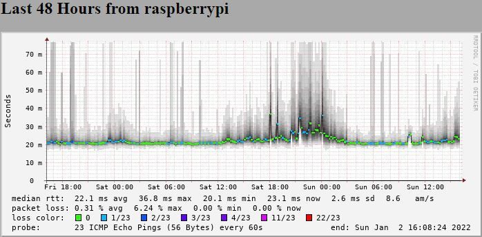

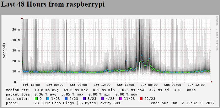

War die letzten Tage etwas unterwegs und habe daher nicht sonderlich mehr als die Graphen und vorher nur schnell noch im Smokeping als Target folgendes eingehakt: 88.134.192.0 / ip5886c000.static.kabel-deutschland.de
Scheint sich hinsichtlich Packetloss in Grenzen gehalten zu haben die letzten 48 Std., aber die Phasen gabs ja immer wieder - mal etwas besser mal sehr viel schlechter.
letzten 48h 88.134.192.0 / ip5886c000.static.kabel-deutschland.de
letzten 48h Google.de

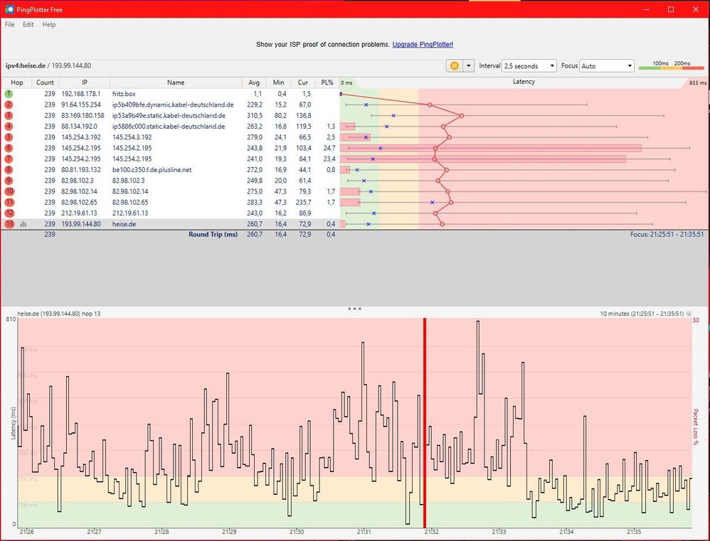

zeitgleiche Aufzeichnungen
Pingplotter auf Heise
Ping Tracer auf 88.134.192.0 / ip5886c000.static.kabel-deutschland.de
Smokeping 88.134.192.0 / ip5886c000.static.kabel-deutschland.de
iperf
Starting Test: protocol: TCP, 1 streams, 131072 byte blocks, omitting 0 seconds, 900 second test [ ID] Interval Transfer Bandwidth [ 4] 0.00-1.01 sec 768 KBytes 6.26 Mbits/sec [ 4] 1.01-2.01 sec 768 KBytes 6.25 Mbits/sec [ 4] 2.01-3.00 sec 1.50 MBytes 12.7 Mbits/sec [ 4] 3.00-4.01 sec 1.50 MBytes 12.5 Mbits/sec [ 4] 4.01-5.00 sec 1.00 MBytes 8.42 Mbits/sec [ 4] 5.00-6.01 sec 1.00 MBytes 8.35 Mbits/sec [ 4] 6.01-7.00 sec 1.12 MBytes 9.46 Mbits/sec [ 4] 7.00-8.01 sec 1.25 MBytes 10.5 Mbits/sec [ 4] 8.01-9.01 sec 1.00 MBytes 8.32 Mbits/sec [ 4] 9.01-10.01 sec 1.12 MBytes 9.49 Mbits/sec [ 4] 10.01-11.01 sec 1.62 MBytes 13.7 Mbits/sec [ 4] 11.01-12.01 sec 1.62 MBytes 13.5 Mbits/sec [ 4] 12.01-13.01 sec 768 KBytes 6.28 Mbits/sec [ 4] 13.01-14.00 sec 1.00 MBytes 8.49 Mbits/sec [ 4] 14.00-15.01 sec 1.38 MBytes 11.5 Mbits/sec [ 4] 15.01-16.00 sec 1.12 MBytes 9.50 Mbits/sec [ 4] 16.00-17.01 sec 1.00 MBytes 8.29 Mbits/sec [ 4] 17.01-18.00 sec 2.00 MBytes 16.9 Mbits/sec [ 4] 18.00-19.01 sec 1.25 MBytes 10.4 Mbits/sec [ 4] 19.01-20.01 sec 1.25 MBytes 10.5 Mbits/sec [ 4] 20.01-21.01 sec 1.25 MBytes 10.5 Mbits/sec [ 4] 21.01-22.00 sec 1.25 MBytes 10.6 Mbits/sec [ 4] 22.00-23.01 sec 1.50 MBytes 12.5 Mbits/sec [ 4] 23.01-24.01 sec 1.12 MBytes 9.42 Mbits/sec [ 4] 24.01-25.01 sec 1.12 MBytes 9.50 Mbits/sec [ 4] 25.01-26.01 sec 1.38 MBytes 11.4 Mbits/sec [ 4] 26.01-27.01 sec 1.62 MBytes 13.7 Mbits/sec [ 4] 27.01-28.00 sec 1.62 MBytes 13.7 Mbits/sec [ 4] 28.00-29.01 sec 1.62 MBytes 13.5 Mbits/sec [ 4] 29.01-30.01 sec 1.38 MBytes 11.6 Mbits/sec [ 4] 30.01-31.01 sec 1.62 MBytes 13.5 Mbits/sec [ 4] 31.01-32.00 sec 1.38 MBytes 11.7 Mbits/sec [ 4] 32.00-33.01 sec 1.25 MBytes 10.4 Mbits/sec [ 4] 33.01-34.01 sec 1.38 MBytes 11.6 Mbits/sec [ 4] 34.01-35.01 sec 1.12 MBytes 9.35 Mbits/sec [ 4] 35.01-36.00 sec 1.38 MBytes 11.7 Mbits/sec [ 4] 36.00-37.00 sec 1.12 MBytes 9.42 Mbits/sec [ 4] 37.00-38.01 sec 1.00 MBytes 8.31 Mbits/sec [ 4] 38.01-39.00 sec 1.25 MBytes 10.6 Mbits/sec [ 4] 39.00-40.01 sec 2.25 MBytes 18.8 Mbits/sec [ 4] 40.01-41.01 sec 2.50 MBytes 21.0 Mbits/sec [ 4] 41.01-42.01 sec 2.50 MBytes 20.8 Mbits/sec [ 4] 42.01-43.01 sec 1.75 MBytes 14.7 Mbits/sec [ 4] 43.01-44.00 sec 1.50 MBytes 12.7 Mbits/sec [ 4] 44.00-45.01 sec 1.50 MBytes 12.4 Mbits/sec [ 4] 45.01-46.01 sec 1.88 MBytes 15.8 Mbits/sec [ 4] 46.01-47.01 sec 1.75 MBytes 14.8 Mbits/sec [ 4] 47.01-48.00 sec 1.12 MBytes 9.46 Mbits/sec [ 4] 48.00-49.01 sec 896 KBytes 7.27 Mbits/sec [ 4] 49.01-50.01 sec 1.62 MBytes 13.6 Mbits/sec [ 4] 50.01-51.01 sec 1.50 MBytes 12.6 Mbits/sec [ 4] 51.01-52.01 sec 896 KBytes 7.36 Mbits/sec [ 4] 52.01-53.00 sec 1.25 MBytes 10.6 Mbits/sec [ 4] 53.00-54.01 sec 1.00 MBytes 8.33 Mbits/sec [ 4] 54.01-55.00 sec 1.12 MBytes 9.47 Mbits/sec [ 4] 55.00-56.02 sec 1.38 MBytes 11.4 Mbits/sec [ 4] 56.02-57.01 sec 1.12 MBytes 9.48 Mbits/sec [ 4] 57.01-58.01 sec 1.62 MBytes 13.7 Mbits/sec [ 4] 58.01-59.02 sec 1.75 MBytes 14.6 Mbits/sec [ 4] 59.02-60.01 sec 1.00 MBytes 8.44 Mbits/sec [ 4] 60.01-61.01 sec 1.25 MBytes 10.4 Mbits/sec [ 4] 61.01-62.01 sec 1.62 MBytes 13.8 Mbits/sec [ 4] 62.01-63.01 sec 2.00 MBytes 16.7 Mbits/sec [ 4] 63.01-64.00 sec 1.50 MBytes 12.7 Mbits/sec [ 4] 64.00-65.00 sec 1.38 MBytes 11.6 Mbits/sec [ 4] 65.00-66.01 sec 1.00 MBytes 8.29 Mbits/sec [ 4] 66.01-67.00 sec 1.62 MBytes 13.8 Mbits/sec [ 4] 67.00-68.01 sec 1.38 MBytes 11.5 Mbits/sec [ 4] 68.01-69.00 sec 1.75 MBytes 14.8 Mbits/sec [ 4] 69.00-70.01 sec 1.88 MBytes 15.6 Mbits/sec [ 4] 70.01-71.01 sec 1.88 MBytes 15.8 Mbits/sec [ 4] 71.01-72.00 sec 1.75 MBytes 14.7 Mbits/sec [ 4] 72.00-73.01 sec 1.88 MBytes 15.6 Mbits/sec [ 4] 73.01-74.00 sec 1.50 MBytes 12.7 Mbits/sec [ 4] 74.00-75.00 sec 1.38 MBytes 11.5 Mbits/sec [ 4] 75.00-76.01 sec 1.12 MBytes 9.34 Mbits/sec [ 4] 76.01-77.01 sec 1.88 MBytes 15.8 Mbits/sec [ 4] 77.01-78.01 sec 2.12 MBytes 17.9 Mbits/sec [ 4] 78.01-79.00 sec 2.00 MBytes 16.8 Mbits/sec [ 4] 79.00-80.01 sec 1.88 MBytes 15.6 Mbits/sec [ 4] 80.01-81.01 sec 1.75 MBytes 14.8 Mbits/sec [ 4] 81.01-82.01 sec 1.12 MBytes 9.35 Mbits/sec [ 4] 82.01-83.01 sec 1.75 MBytes 14.7 Mbits/sec [ 4] 83.01-84.01 sec 1.38 MBytes 11.5 Mbits/sec [ 4] 84.01-85.01 sec 1.38 MBytes 11.5 Mbits/sec [ 4] 85.01-86.01 sec 1.38 MBytes 11.5 Mbits/sec [ 4] 86.01-87.01 sec 1.12 MBytes 9.50 Mbits/sec [ 4] 87.01-88.00 sec 896 KBytes 7.37 Mbits/sec [ 4] 88.00-89.01 sec 1.00 MBytes 8.36 Mbits/sec [ 4] 89.01-90.00 sec 1.25 MBytes 10.5 Mbits/sec [ 4] 90.00-91.02 sec 1.38 MBytes 11.4 Mbits/sec [ 4] 91.02-92.01 sec 896 KBytes 7.38 Mbits/sec [ 4] 92.01-93.00 sec 1.38 MBytes 11.6 Mbits/sec [ 4] 93.00-94.00 sec 1.88 MBytes 15.7 Mbits/sec [ 4] 94.00-95.00 sec 1.75 MBytes 14.7 Mbits/sec [ 4] 95.00-96.01 sec 2.50 MBytes 20.8 Mbits/sec [ 4] 96.01-97.01 sec 2.50 MBytes 21.0 Mbits/sec [ 4] 97.01-98.01 sec 2.12 MBytes 17.7 Mbits/sec [ 4] 98.01-99.01 sec 1.50 MBytes 12.7 Mbits/sec [ 4] 99.01-100.00 sec 1.88 MBytes 15.8 Mbits/sec [ 4] 100.00-101.01 sec 2.62 MBytes 21.8 Mbits/sec [ 4] 101.01-102.01 sec 2.50 MBytes 21.1 Mbits/sec [ 4] 102.01-103.00 sec 2.12 MBytes 17.9 Mbits/sec [ 4] 103.00-104.01 sec 1.25 MBytes 10.4 Mbits/sec [ 4] 104.01-105.01 sec 896 KBytes 7.40 Mbits/sec [ 4] 105.01-106.01 sec 896 KBytes 7.29 Mbits/sec [ 4] 106.01-107.01 sec 1.25 MBytes 10.5 Mbits/sec [ 4] 107.01-108.00 sec 640 KBytes 5.28 Mbits/sec [ 4] 108.00-109.01 sec 1.12 MBytes 9.38 Mbits/sec [ 4] 109.01-110.00 sec 1.25 MBytes 10.6 Mbits/sec [ 4] 110.00-111.01 sec 1.38 MBytes 11.4 Mbits/sec [ 4] 111.01-112.01 sec 1.25 MBytes 10.4 Mbits/sec [ 4] 112.01-113.01 sec 1.12 MBytes 9.52 Mbits/sec [ 4] 113.01-114.00 sec 768 KBytes 6.31 Mbits/sec [ 4] 114.00-115.01 sec 1.25 MBytes 10.4 Mbits/sec [ 4] 115.01-116.01 sec 1.00 MBytes 8.34 Mbits/sec [ 4] 116.01-117.01 sec 1.25 MBytes 10.6 Mbits/sec [ 4] 117.01-118.01 sec 1.12 MBytes 9.38 Mbits/sec [ 4] 118.01-119.01 sec 1.62 MBytes 13.7 Mbits/sec [ 4] 119.01-120.00 sec 1.12 MBytes 9.47 Mbits/sec [ 4] 120.00-121.01 sec 1.12 MBytes 9.36 Mbits/sec [ 4] 121.01-122.01 sec 1.25 MBytes 10.5 Mbits/sec [ 4] 122.01-123.01 sec 1.00 MBytes 8.37 Mbits/sec [ 4] 123.01-124.01 sec 1.50 MBytes 12.7 Mbits/sec [ 4] 124.01-125.01 sec 2.75 MBytes 22.9 Mbits/sec [ 4] 125.01-126.01 sec 2.62 MBytes 22.1 Mbits/sec [ 4] 126.01-127.01 sec 2.75 MBytes 23.0 Mbits/sec [ 4] 127.01-128.00 sec 2.62 MBytes 22.2 Mbits/sec [ 4] 128.00-129.01 sec 2.62 MBytes 21.9 Mbits/sec [ 4] 129.01-130.00 sec 3.12 MBytes 26.4 Mbits/sec [ 4] 130.00-131.00 sec 2.00 MBytes 16.8 Mbits/sec [ 4] 131.00-132.01 sec 2.75 MBytes 22.9 Mbits/sec [ 4] 132.01-133.00 sec 2.75 MBytes 23.2 Mbits/sec [ 4] 133.00-134.01 sec 1.75 MBytes 14.6 Mbits/sec [ 4] 134.01-135.01 sec 1.38 MBytes 11.6 Mbits/sec [ 4] 135.01-136.01 sec 1.50 MBytes 12.5 Mbits/sec [ 4] 136.01-137.01 sec 1.88 MBytes 15.8 Mbits/sec [ 4] 137.01-138.01 sec 1.88 MBytes 15.6 Mbits/sec [ 4] 138.01-139.00 sec 1.25 MBytes 10.6 Mbits/sec [ 4] 139.00-140.01 sec 1.12 MBytes 9.34 Mbits/sec [ 4] 140.01-141.01 sec 640 KBytes 5.27 Mbits/sec [ 4] 141.01-142.00 sec 1.00 MBytes 8.45 Mbits/sec [ 4] 142.00-143.01 sec 768 KBytes 6.24 Mbits/sec [ 4] 143.01-144.02 sec 1.00 MBytes 8.34 Mbits/sec [ 4] 144.02-145.01 sec 1.12 MBytes 9.52 Mbits/sec [ 4] 145.01-146.02 sec 1.00 MBytes 8.32 Mbits/sec [ 4] 146.02-147.01 sec 1.00 MBytes 8.43 Mbits/sec [ 4] 147.01-148.00 sec 768 KBytes 6.33 Mbits/sec [ 4] 148.00-149.01 sec 1.00 MBytes 8.32 Mbits/sec [ 4] 149.01-150.01 sec 640 KBytes 5.26 Mbits/sec [ 4] 150.01-151.00 sec 896 KBytes 7.37 Mbits/sec [ 4] 151.00-152.00 sec 384 KBytes 3.15 Mbits/sec [ 4] 152.00-153.01 sec 512 KBytes 4.16 Mbits/sec [ 4] 153.01-154.00 sec 768 KBytes 6.35 Mbits/sec [ 4] 154.00-155.01 sec 384 KBytes 3.12 Mbits/sec [ 4] 155.01-156.00 sec 512 KBytes 4.21 Mbits/sec [ 4] 156.00-157.02 sec 512 KBytes 4.14 Mbits/sec [ 4] 157.02-158.01 sec 768 KBytes 6.32 Mbits/sec [ 4] 158.01-159.01 sec 640 KBytes 5.26 Mbits/sec [ 4] 159.01-160.01 sec 896 KBytes 7.35 Mbits/sec [ 4] 160.01-161.00 sec 896 KBytes 7.38 Mbits/sec [ 4] 161.00-162.00 sec 896 KBytes 7.33 Mbits/sec [ 4] 162.00-163.00 sec 384 KBytes 3.15 Mbits/sec [ 4] 163.00-164.01 sec 512 KBytes 4.15 Mbits/sec [ 4] 164.01-165.01 sec 1.12 MBytes 9.45 Mbits/sec [ 4] 165.01-166.01 sec 640 KBytes 5.25 Mbits/sec [ 4] 166.01-167.01 sec 640 KBytes 5.26 Mbits/sec [ 4] 167.01-168.00 sec 640 KBytes 5.26 Mbits/sec [ 4] 168.00-169.02 sec 1.12 MBytes 9.33 Mbits/sec [ 4] 169.02-170.01 sec 640 KBytes 5.27 Mbits/sec [ 4] 170.01-171.00 sec 512 KBytes 4.22 Mbits/sec [ 4] 171.00-172.01 sec 640 KBytes 5.21 Mbits/sec [ 4] 172.01-173.00 sec 768 KBytes 6.33 Mbits/sec [ 4] 173.00-174.01 sec 512 KBytes 4.16 Mbits/sec [ 4] 174.01-175.01 sec 384 KBytes 3.16 Mbits/sec [ 4] 175.01-176.01 sec 384 KBytes 3.15 Mbits/sec [ 4] 176.01-177.00 sec 768 KBytes 6.31 Mbits/sec [ 4] 177.00-178.01 sec 640 KBytes 5.20 Mbits/sec [ 4] 178.01-179.01 sec 512 KBytes 4.22 Mbits/sec [ 4] 179.01-180.01 sec 1.00 MBytes 8.33 Mbits/sec [ 4] 180.01-181.01 sec 896 KBytes 7.35 Mbits/sec [ 4] 181.01-182.01 sec 1.12 MBytes 9.49 Mbits/sec [ 4] 182.01-183.01 sec 768 KBytes 6.25 Mbits/sec [ 4] 183.01-184.01 sec 768 KBytes 6.34 Mbits/sec [ 4] 184.01-185.00 sec 640 KBytes 5.25 Mbits/sec [ 4] 185.00-186.01 sec 896 KBytes 7.30 Mbits/sec [ 4] 186.01-187.00 sec 512 KBytes 4.22 Mbits/sec [ 4] 187.00-188.01 sec 512 KBytes 4.15 Mbits/sec [ 4] 188.01-189.00 sec 640 KBytes 5.29 Mbits/sec [ 4] 189.00-190.01 sec 896 KBytes 7.27 Mbits/sec [ 4] 190.01-191.01 sec 640 KBytes 5.28 Mbits/sec [ 4] 191.01-192.02 sec 768 KBytes 6.24 Mbits/sec [ 4] 192.02-193.01 sec 896 KBytes 7.35 Mbits/sec [ 4] 193.01-194.01 sec 1.00 MBytes 8.43 Mbits/sec [ 4] 194.01-195.00 sec 640 KBytes 5.26 Mbits/sec [ 4] 195.00-196.01 sec 640 KBytes 5.19 Mbits/sec [ 4] 196.01-197.02 sec 512 KBytes 4.19 Mbits/sec [ 4] 197.02-198.01 sec 384 KBytes 3.17 Mbits/sec [ 4] 198.01-199.01 sec 768 KBytes 6.28 Mbits/sec [ 4] 199.01-200.01 sec 896 KBytes 7.37 Mbits/sec [ 4] 200.01-201.00 sec 640 KBytes 5.27 Mbits/sec [ 4] 201.00-202.00 sec 640 KBytes 5.24 Mbits/sec [ 4] 202.00-203.01 sec 768 KBytes 6.24 Mbits/sec [ 4] 203.01-204.00 sec 512 KBytes 4.22 Mbits/sec [ 4] 204.00-205.00 sec 512 KBytes 4.20 Mbits/sec [ 4] 205.00-206.02 sec 768 KBytes 6.21 Mbits/sec [ 4] 206.02-207.01 sec 896 KBytes 7.36 Mbits/sec [ 4] 207.01-208.01 sec 640 KBytes 5.25 Mbits/sec [ 4] 208.01-209.01 sec 512 KBytes 4.19 Mbits/sec [ 4] 209.01-210.01 sec 640 KBytes 5.26 Mbits/sec [ 4] 210.01-211.01 sec 640 KBytes 5.26 Mbits/sec [ 4] 211.01-212.00 sec 768 KBytes 6.31 Mbits/sec [ 4] 212.00-213.02 sec 384 KBytes 3.11 Mbits/sec [ 4] 213.02-214.01 sec 512 KBytes 4.21 Mbits/sec [ 4] 214.01-215.01 sec 640 KBytes 5.28 Mbits/sec [ 4] 215.01-216.01 sec 384 KBytes 3.13 Mbits/sec [ 4] 216.01-217.01 sec 384 KBytes 3.15 Mbits/sec [ 4] 217.01-218.02 sec 384 KBytes 3.13 Mbits/sec [ 4] 218.02-219.01 sec 384 KBytes 3.18 Mbits/sec [ 4] 219.01-220.01 sec 512 KBytes 4.17 Mbits/sec [ 4] 220.01-221.01 sec 384 KBytes 3.15 Mbits/sec [ 4] 221.01-222.01 sec 384 KBytes 3.16 Mbits/sec [ 4] 222.01-223.00 sec 640 KBytes 5.28 Mbits/sec [ 4] 223.00-224.01 sec 640 KBytes 5.20 Mbits/sec [ 4] 224.01-225.00 sec 512 KBytes 4.22 Mbits/sec [ 4] 225.00-226.01 sec 384 KBytes 3.13 Mbits/sec [ 4] 226.01-227.00 sec 384 KBytes 3.16 Mbits/sec [ 4] 227.00-228.01 sec 512 KBytes 4.17 Mbits/sec [ 4] 228.01-229.00 sec 640 KBytes 5.28 Mbits/sec [ 4] 229.00-230.01 sec 640 KBytes 5.19 Mbits/sec [ 4] 230.01-231.00 sec 768 KBytes 6.34 Mbits/sec [ 4] 231.00-232.02 sec 384 KBytes 3.11 Mbits/sec [ 4] 232.02-233.01 sec 512 KBytes 4.21 Mbits/sec [ 4] 233.01-234.00 sec 384 KBytes 3.18 Mbits/sec [ 4] 234.00-235.00 sec 384 KBytes 3.15 Mbits/sec [ 4] 235.00-236.01 sec 384 KBytes 3.11 Mbits/sec [ 4] 236.01-237.01 sec 512 KBytes 4.21 Mbits/sec [ 4] 237.01-238.00 sec 256 KBytes 2.11 Mbits/sec [ 4] 238.00-239.00 sec 512 KBytes 4.21 Mbits/sec [ 4] 239.00-240.01 sec 512 KBytes 4.17 Mbits/sec [ 4] 240.01-241.01 sec 384 KBytes 3.12 Mbits/sec [ 4] 241.01-242.01 sec 384 KBytes 3.14 Mbits/sec [ 4] 242.01-243.01 sec 512 KBytes 4.21 Mbits/sec [ 4] 243.01-244.01 sec 384 KBytes 3.14 Mbits/sec [ 4] 244.01-245.01 sec 384 KBytes 3.17 Mbits/sec [ 4] 245.01-246.01 sec 512 KBytes 4.20 Mbits/sec [ 4] 246.01-247.00 sec 512 KBytes 4.20 Mbits/sec [ 4] 247.00-248.01 sec 512 KBytes 4.16 Mbits/sec [ 4] 248.01-249.01 sec 896 KBytes 7.38 Mbits/sec [ 4] 249.01-250.02 sec 768 KBytes 6.23 Mbits/sec [ 4] 250.02-251.01 sec 768 KBytes 6.33 Mbits/sec [ 4] 251.01-252.02 sec 896 KBytes 7.30 Mbits/sec [ 4] 252.02-253.01 sec 640 KBytes 5.27 Mbits/sec [ 4] 253.01-254.00 sec 768 KBytes 6.35 Mbits/sec [ 4] 254.00-255.01 sec 768 KBytes 6.25 Mbits/sec [ 4] 255.01-256.00 sec 512 KBytes 4.21 Mbits/sec [ 4] 256.00-257.01 sec 384 KBytes 3.12 Mbits/sec [ 4] 257.01-258.00 sec 512 KBytes 4.24 Mbits/sec [ 4] 258.00-259.01 sec 512 KBytes 4.16 Mbits/sec [ 4] 259.01-260.01 sec 768 KBytes 6.32 Mbits/sec [ 4] 260.01-261.01 sec 512 KBytes 4.19 Mbits/sec [ 4] 261.01-262.01 sec 512 KBytes 4.17 Mbits/sec [ 4] 262.01-263.01 sec 384 KBytes 3.17 Mbits/sec [ 4] 263.01-264.01 sec 512 KBytes 4.16 Mbits/sec [ 4] 264.01-265.01 sec 768 KBytes 6.34 Mbits/sec [ 4] 265.01-266.00 sec 768 KBytes 6.31 Mbits/sec [ 4] 266.00-267.01 sec 640 KBytes 5.20 Mbits/sec [ 4] 267.01-268.01 sec 768 KBytes 6.32 Mbits/sec [ 4] 268.01-269.01 sec 896 KBytes 7.36 Mbits/sec [ 4] 269.01-270.00 sec 896 KBytes 7.36 Mbits/sec [ 4] 270.00-271.01 sec 1.25 MBytes 10.4 Mbits/sec [ 4] 271.01-272.01 sec 896 KBytes 7.35 Mbits/sec [ 4] 272.01-273.01 sec 896 KBytes 7.35 Mbits/sec [ 4] 273.01-274.01 sec 768 KBytes 6.29 Mbits/sec [ 4] 274.01-275.02 sec 512 KBytes 4.17 Mbits/sec [ 4] 275.02-276.01 sec 640 KBytes 5.27 Mbits/sec [ 4] 276.01-277.01 sec 384 KBytes 3.15 Mbits/sec [ 4] 277.01-278.01 sec 512 KBytes 4.21 Mbits/sec [ 4] 278.01-279.01 sec 512 KBytes 4.18 Mbits/sec [ 4] 279.01-280.01 sec 768 KBytes 6.27 Mbits/sec [ 4] 280.01-281.01 sec 640 KBytes 5.26 Mbits/sec [ 4] 281.01-282.01 sec 768 KBytes 6.30 Mbits/sec [ 4] 282.01-283.01 sec 896 KBytes 7.34 Mbits/sec [ 4] 283.01-284.01 sec 768 KBytes 6.27 Mbits/sec [ 4] 284.01-285.00 sec 768 KBytes 6.32 Mbits/sec [ 4] 285.00-286.01 sec 768 KBytes 6.25 Mbits/sec [ 4] 286.01-287.00 sec 640 KBytes 5.29 Mbits/sec [ 4] 287.00-288.01 sec 896 KBytes 7.26 Mbits/sec [ 4] 288.01-289.00 sec 1.12 MBytes 9.54 Mbits/sec [ 4] 289.00-290.01 sec 1.00 MBytes 8.36 Mbits/sec [ 4] 290.01-291.00 sec 768 KBytes 6.32 Mbits/sec [ 4] 291.00-292.01 sec 640 KBytes 5.19 Mbits/sec [ 4] 292.01-293.00 sec 768 KBytes 6.34 Mbits/sec [ 4] 293.00-294.01 sec 768 KBytes 6.23 Mbits/sec [ 4] 294.01-295.01 sec 1.12 MBytes 9.44 Mbits/sec [ 4] 295.01-296.01 sec 896 KBytes 7.36 Mbits/sec [ 4] 296.01-297.00 sec 1.00 MBytes 8.44 Mbits/sec [ 4] 297.00-298.00 sec 1.12 MBytes 9.47 Mbits/sec [ 4] 298.00-299.01 sec 1.12 MBytes 9.38 Mbits/sec [ 4] 299.01-300.00 sec 896 KBytes 7.37 Mbits/sec [ 4] 300.00-301.01 sec 768 KBytes 6.23 Mbits/sec [ 4] 301.01-302.01 sec 1.00 MBytes 8.40 Mbits/sec [ 4] 302.01-303.01 sec 1.12 MBytes 9.47 Mbits/sec [ 4] 303.01-304.01 sec 1.12 MBytes 9.38 Mbits/sec [ 4] 304.01-305.01 sec 1.00 MBytes 8.42 Mbits/sec [ 4] 305.01-306.00 sec 640 KBytes 5.29 Mbits/sec [ 4] 306.00-307.01 sec 1.00 MBytes 8.35 Mbits/sec [ 4] 307.01-308.00 sec 1.38 MBytes 11.6 Mbits/sec [ 4] 308.00-309.01 sec 1.38 MBytes 11.4 Mbits/sec [ 4] 309.01-310.01 sec 1.25 MBytes 10.5 Mbits/sec [ 4] 310.01-311.01 sec 1.00 MBytes 8.34 Mbits/sec [ 4] 311.01-312.01 sec 1.38 MBytes 11.6 Mbits/sec [ 4] 312.01-313.01 sec 1.25 MBytes 10.5 Mbits/sec [ 4] 313.01-314.00 sec 1.00 MBytes 8.46 Mbits/sec [ 4] 314.00-315.01 sec 1.38 MBytes 11.5 Mbits/sec [ 4] 315.01-316.01 sec 1.38 MBytes 11.4 Mbits/sec [ 4] 316.01-317.01 sec 1.88 MBytes 15.8 Mbits/sec [ 4] 317.01-318.01 sec 2.00 MBytes 16.8 Mbits/sec [ 4] 318.01-319.01 sec 2.25 MBytes 19.0 Mbits/sec [ 4] 319.01-320.00 sec 2.12 MBytes 17.9 Mbits/sec [ 4] 320.00-321.01 sec 1.62 MBytes 13.5 Mbits/sec [ 4] 321.01-322.01 sec 896 KBytes 7.33 Mbits/sec [ 4] 322.01-323.01 sec 1.00 MBytes 8.41 Mbits/sec [ 4] 323.01-324.00 sec 768 KBytes 6.34 Mbits/sec [ 4] 324.00-325.01 sec 1.25 MBytes 10.4 Mbits/sec [ 4] 325.01-326.00 sec 1.38 MBytes 11.6 Mbits/sec [ 4] 326.00-327.01 sec 1.62 MBytes 13.6 Mbits/sec [ 4] 327.01-328.01 sec 1.38 MBytes 11.6 Mbits/sec [ 4] 328.01-329.01 sec 1.38 MBytes 11.5 Mbits/sec [ 4] 329.01-330.01 sec 1.25 MBytes 10.5 Mbits/sec [ 4] 330.01-331.01 sec 1.12 MBytes 9.46 Mbits/sec [ 4] 331.01-332.01 sec 896 KBytes 7.35 Mbits/sec [ 4] 332.01-333.01 sec 1.00 MBytes 8.39 Mbits/sec [ 4] 333.01-334.01 sec 1.12 MBytes 9.37 Mbits/sec [ 4] 334.01-335.01 sec 1.00 MBytes 8.40 Mbits/sec [ 4] 335.01-336.01 sec 768 KBytes 6.30 Mbits/sec [ 4] 336.01-337.01 sec 640 KBytes 5.25 Mbits/sec [ 4] 337.01-338.01 sec 896 KBytes 7.35 Mbits/sec [ 4] 338.01-339.01 sec 768 KBytes 6.30 Mbits/sec [ 4] 339.01-340.00 sec 768 KBytes 6.31 Mbits/sec [ 4] 340.00-341.01 sec 896 KBytes 7.28 Mbits/sec [ 4] 341.01-342.00 sec 1.25 MBytes 10.6 Mbits/sec [ 4] 342.00-343.01 sec 1.25 MBytes 10.4 Mbits/sec [ 4] 343.01-344.01 sec 1.50 MBytes 12.6 Mbits/sec [ 4] 344.01-345.00 sec 1.25 MBytes 10.6 Mbits/sec [ 4] 345.00-346.00 sec 640 KBytes 5.25 Mbits/sec [ 4] 346.00-347.02 sec 1.00 MBytes 8.28 Mbits/sec [ 4] 347.02-348.01 sec 768 KBytes 6.31 Mbits/sec [ 4] 348.01-349.01 sec 768 KBytes 6.30 Mbits/sec [ 4] 349.01-350.01 sec 896 KBytes 7.37 Mbits/sec [ 4] 350.01-351.00 sec 896 KBytes 7.38 Mbits/sec [ 4] 351.00-352.01 sec 896 KBytes 7.31 Mbits/sec [ 4] 352.01-353.00 sec 768 KBytes 6.31 Mbits/sec [ 4] 353.00-354.01 sec 640 KBytes 5.21 Mbits/sec [ 4] 354.01-355.01 sec 1.12 MBytes 9.49 Mbits/sec [ 4] 355.01-356.01 sec 640 KBytes 5.20 Mbits/sec [ 4] 356.01-357.01 sec 1.00 MBytes 8.44 Mbits/sec [ 4] 357.01-358.01 sec 1.12 MBytes 9.41 Mbits/sec [ 4] 358.01-359.00 sec 1.12 MBytes 9.50 Mbits/sec [ 4] 359.00-360.01 sec 768 KBytes 6.25 Mbits/sec [ 4] 360.01-361.00 sec 1.12 MBytes 9.49 Mbits/sec [ 4] 361.00-362.01 sec 896 KBytes 7.27 Mbits/sec [ 4] 362.01-363.01 sec 896 KBytes 7.40 Mbits/sec [ 4] 363.01-364.00 sec 1.12 MBytes 9.46 Mbits/sec [ 4] 364.00-365.00 sec 896 KBytes 7.35 Mbits/sec [ 4] 365.00-366.00 sec 896 KBytes 7.36 Mbits/sec [ 4] 366.00-367.01 sec 1.00 MBytes 8.31 Mbits/sec [ 4] 367.01-368.01 sec 1.25 MBytes 10.5 Mbits/sec [ 4] 368.01-369.00 sec 1.62 MBytes 13.7 Mbits/sec [ 4] 369.00-370.01 sec 1.12 MBytes 9.35 Mbits/sec [ 4] 370.01-371.00 sec 768 KBytes 6.34 Mbits/sec [ 4] 371.00-372.01 sec 768 KBytes 6.25 Mbits/sec [ 4] 372.01-373.00 sec 768 KBytes 6.34 Mbits/sec [ 4] 373.00-374.01 sec 1.12 MBytes 9.36 Mbits/sec [ 4] 374.01-375.00 sec 1.12 MBytes 9.53 Mbits/sec [ 4] 375.00-376.01 sec 1.50 MBytes 12.5 Mbits/sec [ 4] 376.01-377.01 sec 1.12 MBytes 9.39 Mbits/sec [ 4] 377.01-378.01 sec 896 KBytes 7.34 Mbits/sec [ 4] 378.01-379.01 sec 896 KBytes 7.34 Mbits/sec [ 4] 379.01-380.01 sec 1.25 MBytes 10.5 Mbits/sec [ 4] 380.01-381.01 sec 1.12 MBytes 9.45 Mbits/sec [ 4] 381.01-382.01 sec 640 KBytes 5.23 Mbits/sec [ 4] 382.01-383.01 sec 640 KBytes 5.28 Mbits/sec [ 4] 383.01-384.01 sec 896 KBytes 7.31 Mbits/sec [ 4] 384.01-385.00 sec 896 KBytes 7.40 Mbits/sec [ 4] 385.00-386.01 sec 1.25 MBytes 10.5 Mbits/sec [ 4] 386.01-387.00 sec 896 KBytes 7.36 Mbits/sec [ 4] 387.00-388.00 sec 640 KBytes 5.24 Mbits/sec [ 4] 388.00-389.00 sec 640 KBytes 5.25 Mbits/sec [ 4] 389.00-390.01 sec 896 KBytes 7.26 Mbits/sec [ 4] 390.01-391.01 sec 1.12 MBytes 9.50 Mbits/sec [ 4] 391.01-392.01 sec 1.12 MBytes 9.38 Mbits/sec [ 4] 392.01-393.02 sec 1.25 MBytes 10.5 Mbits/sec [ 4] 393.02-394.01 sec 768 KBytes 6.32 Mbits/sec [ 4] 394.01-395.01 sec 512 KBytes 4.19 Mbits/sec [ 4] 395.01-396.01 sec 896 KBytes 7.36 Mbits/sec [ 4] 396.01-397.01 sec 640 KBytes 5.24 Mbits/sec [ 4] 397.01-398.01 sec 640 KBytes 5.22 Mbits/sec [ 4] 398.01-399.01 sec 256 KBytes 2.10 Mbits/sec [ 4] 399.01-400.01 sec 512 KBytes 4.19 Mbits/sec [ 4] 400.01-401.01 sec 512 KBytes 4.18 Mbits/sec [ 4] 401.01-402.01 sec 512 KBytes 4.21 Mbits/sec [ 4] 402.01-403.01 sec 256 KBytes 2.09 Mbits/sec [ 4] 403.01-404.01 sec 512 KBytes 4.20 Mbits/sec [ 4] 404.01-405.00 sec 512 KBytes 4.24 Mbits/sec [ 4] 405.00-406.01 sec 512 KBytes 4.16 Mbits/sec [ 4] 406.01-407.01 sec 256 KBytes 2.10 Mbits/sec [ 4] 407.01-408.01 sec 384 KBytes 3.15 Mbits/sec [ 4] 408.01-409.00 sec 384 KBytes 3.16 Mbits/sec [ 4] 409.00-410.00 sec 512 KBytes 4.19 Mbits/sec [ 4] 410.00-411.01 sec 640 KBytes 5.23 Mbits/sec [ 4] 411.01-412.01 sec 512 KBytes 4.18 Mbits/sec [ 4] 412.01-413.01 sec 768 KBytes 6.30 Mbits/sec [ 4] 413.01-414.01 sec 512 KBytes 4.20 Mbits/sec [ 4] 414.01-415.00 sec 896 KBytes 7.36 Mbits/sec [ 4] 415.00-416.01 sec 640 KBytes 5.24 Mbits/sec [ 4] 416.01-417.00 sec 896 KBytes 7.36 Mbits/sec [ 4] 417.00-418.01 sec 384 KBytes 3.12 Mbits/sec [ 4] 418.01-419.00 sec 384 KBytes 3.17 Mbits/sec [ 4] 419.00-420.01 sec 384 KBytes 3.11 Mbits/sec [ 4] 420.01-421.00 sec 384 KBytes 3.18 Mbits/sec [ 4] 421.00-422.01 sec 768 KBytes 6.26 Mbits/sec [ 4] 422.01-423.01 sec 768 KBytes 6.30 Mbits/sec [ 4] 423.01-424.00 sec 512 KBytes 4.22 Mbits/sec [ 4] 424.00-425.01 sec 640 KBytes 5.20 Mbits/sec [ 4] 425.01-426.01 sec 512 KBytes 4.20 Mbits/sec [ 4] 426.01-427.00 sec 640 KBytes 5.28 Mbits/sec [ 4] 427.00-428.01 sec 640 KBytes 5.21 Mbits/sec [ 4] 428.01-429.01 sec 896 KBytes 7.35 Mbits/sec [ 4] 429.01-430.01 sec 768 KBytes 6.25 Mbits/sec [ 4] 430.01-431.01 sec 896 KBytes 7.39 Mbits/sec [ 4] 431.01-432.01 sec 768 KBytes 6.30 Mbits/sec [ 4] 432.01-433.01 sec 896 KBytes 7.35 Mbits/sec [ 4] 433.01-434.00 sec 1.25 MBytes 10.5 Mbits/sec [ 4] 434.00-435.00 sec 640 KBytes 5.24 Mbits/sec [ 4] 435.00-436.01 sec 1.00 MBytes 8.31 Mbits/sec [ 4] 436.01-437.01 sec 1.38 MBytes 11.5 Mbits/sec [ 4] 437.01-438.01 sec 1.38 MBytes 11.6 Mbits/sec [ 4] 438.01-439.01 sec 896 KBytes 7.36 Mbits/sec [ 4] 439.01-440.01 sec 640 KBytes 5.25 Mbits/sec [ 4] 440.01-441.01 sec 1.00 MBytes 8.34 Mbits/sec [ 4] 441.01-442.01 sec 896 KBytes 7.38 Mbits/sec [ 4] 442.01-443.00 sec 1.00 MBytes 8.42 Mbits/sec [ 4] 443.00-444.01 sec 896 KBytes 7.27 Mbits/sec [ 4] 444.01-445.01 sec 1.00 MBytes 8.37 Mbits/sec [ 4] 445.01-446.01 sec 1.00 MBytes 8.42 Mbits/sec [ 4] 446.01-447.01 sec 1.25 MBytes 10.5 Mbits/sec [ 4] 447.01-448.01 sec 896 KBytes 7.31 Mbits/sec [ 4] 448.01-449.01 sec 768 KBytes 6.31 Mbits/sec [ 4] 449.01-450.01 sec 1.00 MBytes 8.38 Mbits/sec [ 4] 450.01-451.01 sec 640 KBytes 5.22 Mbits/sec [ 4] 451.01-452.01 sec 640 KBytes 5.25 Mbits/sec [ 4] 452.01-453.01 sec 768 KBytes 6.30 Mbits/sec [ 4] 453.01-454.00 sec 768 KBytes 6.34 Mbits/sec [ 4] 454.00-455.01 sec 1.00 MBytes 8.29 Mbits/sec [ 4] 455.01-456.01 sec 1.00 MBytes 8.45 Mbits/sec [ 4] 456.01-457.00 sec 640 KBytes 5.26 Mbits/sec [ 4] 457.00-458.01 sec 768 KBytes 6.23 Mbits/sec [ 4] 458.01-459.01 sec 640 KBytes 5.25 Mbits/sec [ 4] 459.01-460.01 sec 640 KBytes 5.25 Mbits/sec [ 4] 460.01-461.01 sec 1.00 MBytes 8.37 Mbits/sec [ 4] 461.01-462.01 sec 896 KBytes 7.37 Mbits/sec [ 4] 462.01-463.01 sec 768 KBytes 6.30 Mbits/sec [ 4] 463.01-464.01 sec 896 KBytes 7.35 Mbits/sec [ 4] 464.01-465.01 sec 896 KBytes 7.33 Mbits/sec [ 4] 465.01-466.01 sec 640 KBytes 5.22 Mbits/sec [ 4] 466.01-467.01 sec 896 KBytes 7.32 Mbits/sec [ 4] 467.01-468.01 sec 1.00 MBytes 8.44 Mbits/sec [ 4] 468.01-469.01 sec 896 KBytes 7.33 Mbits/sec [ 4] 469.01-470.01 sec 1.00 MBytes 8.35 Mbits/sec [ 4] 470.01-471.01 sec 1.12 MBytes 9.45 Mbits/sec [ 4] 471.01-472.01 sec 768 KBytes 6.29 Mbits/sec [ 4] 472.01-473.01 sec 896 KBytes 7.38 Mbits/sec [ 4] 473.01-474.00 sec 1.00 MBytes 8.42 Mbits/sec [ 4] 474.00-475.01 sec 896 KBytes 7.29 Mbits/sec [ 4] 475.01-476.00 sec 896 KBytes 7.38 Mbits/sec [ 4] 476.00-477.01 sec 896 KBytes 7.29 Mbits/sec [ 4] 477.01-478.00 sec 1.00 MBytes 8.46 Mbits/sec [ 4] 478.00-479.01 sec 1.38 MBytes 11.5 Mbits/sec [ 4] 479.01-480.00 sec 1.12 MBytes 9.50 Mbits/sec [ 4] 480.00-481.00 sec 1.25 MBytes 10.5 Mbits/sec [ 4] 481.00-482.00 sec 896 KBytes 7.32 Mbits/sec [ 4] 482.00-483.01 sec 640 KBytes 5.23 Mbits/sec [ 4] 483.01-484.01 sec 768 KBytes 6.25 Mbits/sec [ 4] 484.01-485.01 sec 512 KBytes 4.21 Mbits/sec [ 4] 485.01-486.01 sec 512 KBytes 4.20 Mbits/sec [ 4] 486.01-487.00 sec 640 KBytes 5.27 Mbits/sec [ 4] 487.00-488.01 sec 896 KBytes 7.32 Mbits/sec [ 4] 488.01-489.01 sec 768 KBytes 6.25 Mbits/sec [ 4] 489.01-490.01 sec 896 KBytes 7.38 Mbits/sec [ 4] 490.01-491.00 sec 768 KBytes 6.31 Mbits/sec [ 4] 491.00-492.00 sec 512 KBytes 4.19 Mbits/sec [ 4] 492.00-493.01 sec 384 KBytes 3.12 Mbits/sec [ 4] 493.01-494.00 sec 512 KBytes 4.23 Mbits/sec [ 4] 494.00-495.00 sec 896 KBytes 7.35 Mbits/sec [ 4] 495.00-496.00 sec 640 KBytes 5.23 Mbits/sec [ 4] 496.00-497.01 sec 768 KBytes 6.24 Mbits/sec [ 4] 497.01-498.01 sec 1.12 MBytes 9.44 Mbits/sec [ 4] 498.01-499.01 sec 640 KBytes 5.28 Mbits/sec [ 4] 499.01-500.00 sec 768 KBytes 6.30 Mbits/sec [ 4] 500.00-501.00 sec 896 KBytes 7.33 Mbits/sec [ 4] 501.00-502.01 sec 768 KBytes 6.24 Mbits/sec [ 4] 502.01-503.01 sec 640 KBytes 5.27 Mbits/sec [ 4] 503.01-504.01 sec 384 KBytes 3.15 Mbits/sec [ 4] 504.01-505.01 sec 768 KBytes 6.25 Mbits/sec [ 4] 505.01-506.01 sec 768 KBytes 6.32 Mbits/sec [ 4] 506.01-507.01 sec 1.00 MBytes 8.41 Mbits/sec [ 4] 507.01-508.01 sec 640 KBytes 5.24 Mbits/sec [ 4] 508.01-509.01 sec 896 KBytes 7.31 Mbits/sec [ 4] 509.01-510.02 sec 512 KBytes 4.18 Mbits/sec [ 4] 510.02-511.01 sec 768 KBytes 6.35 Mbits/sec [ 4] 511.01-512.00 sec 640 KBytes 5.25 Mbits/sec [ 4] 512.00-513.01 sec 640 KBytes 5.22 Mbits/sec [ 4] 513.01-514.01 sec 512 KBytes 4.17 Mbits/sec [ 4] 514.01-515.01 sec 512 KBytes 4.22 Mbits/sec [ 4] 515.01-516.00 sec 512 KBytes 4.21 Mbits/sec [ 4] 516.00-517.01 sec 640 KBytes 5.24 Mbits/sec [ 4] 517.01-518.00 sec 384 KBytes 3.15 Mbits/sec [ 4] 518.00-519.01 sec 640 KBytes 5.22 Mbits/sec [ 4] 519.01-520.00 sec 640 KBytes 5.28 Mbits/sec [ 4] 520.00-521.00 sec 640 KBytes 5.23 Mbits/sec [ 4] 521.00-522.01 sec 512 KBytes 4.16 Mbits/sec [ 4] 522.01-523.01 sec 640 KBytes 5.25 Mbits/sec [ 4] 523.01-524.01 sec 384 KBytes 3.16 Mbits/sec [ 4] 524.01-525.01 sec 384 KBytes 3.13 Mbits/sec [ 4] 525.01-526.00 sec 512 KBytes 4.23 Mbits/sec [ 4] 526.00-527.01 sec 640 KBytes 5.19 Mbits/sec [ 4] 527.01-528.00 sec 512 KBytes 4.24 Mbits/sec [ 4] 528.00-529.01 sec 512 KBytes 4.15 Mbits/sec [ 4] 529.01-530.01 sec 640 KBytes 5.25 Mbits/sec [ 4] 530.01-531.00 sec 768 KBytes 6.37 Mbits/sec [ 4] 531.00-532.01 sec 384 KBytes 3.12 Mbits/sec [ 4] 532.01-533.00 sec 512 KBytes 4.23 Mbits/sec [ 4] 533.00-534.01 sec 768 KBytes 6.24 Mbits/sec [ 4] 534.01-535.01 sec 512 KBytes 4.21 Mbits/sec [ 4] 535.01-536.02 sec 640 KBytes 5.19 Mbits/sec [ 4] 536.02-537.01 sec 256 KBytes 2.11 Mbits/sec [ 4] 537.01-538.02 sec 512 KBytes 4.17 Mbits/sec [ 4] 538.02-539.01 sec 512 KBytes 4.21 Mbits/sec [ 4] 539.01-540.00 sec 384 KBytes 3.17 Mbits/sec [ 4] 540.00-541.01 sec 384 KBytes 3.12 Mbits/sec [ 4] 541.01-542.01 sec 384 KBytes 3.17 Mbits/sec [ 4] 542.01-543.00 sec 256 KBytes 2.11 Mbits/sec [ 4] 543.00-544.01 sec 384 KBytes 3.12 Mbits/sec [ 4] 544.01-545.01 sec 512 KBytes 4.21 Mbits/sec [ 4] 545.01-546.01 sec 384 KBytes 3.12 Mbits/sec [ 4] 546.01-547.01 sec 384 KBytes 3.16 Mbits/sec [ 4] 547.01-548.00 sec 640 KBytes 5.29 Mbits/sec [ 4] 548.00-549.01 sec 640 KBytes 5.22 Mbits/sec [ 4] 549.01-550.00 sec 512 KBytes 4.21 Mbits/sec [ 4] 550.00-551.01 sec 640 KBytes 5.20 Mbits/sec [ 4] 551.01-552.01 sec 640 KBytes 5.25 Mbits/sec [ 4] 552.01-553.00 sec 896 KBytes 7.40 Mbits/sec [ 4] 553.00-554.01 sec 512 KBytes 4.17 Mbits/sec [ 4] 554.01-555.00 sec 256 KBytes 2.11 Mbits/sec [ 4] 555.00-556.01 sec 384 KBytes 3.11 Mbits/sec [ 4] 556.01-557.01 sec 512 KBytes 4.21 Mbits/sec [ 4] 557.01-558.01 sec 512 KBytes 4.19 Mbits/sec [ 4] 558.01-559.01 sec 512 KBytes 4.20 Mbits/sec [ 4] 559.01-560.01 sec 512 KBytes 4.20 Mbits/sec [ 4] 560.01-561.02 sec 768 KBytes 6.24 Mbits/sec [ 4] 561.02-562.01 sec 384 KBytes 3.17 Mbits/sec [ 4] 562.01-563.00 sec 384 KBytes 3.16 Mbits/sec [ 4] 563.00-564.00 sec 384 KBytes 3.15 Mbits/sec [ 4] 564.00-565.01 sec 640 KBytes 5.21 Mbits/sec [ 4] 565.01-566.00 sec 1.00 MBytes 8.43 Mbits/sec [ 4] 566.00-567.01 sec 768 KBytes 6.29 Mbits/sec [ 4] 567.01-568.01 sec 512 KBytes 4.16 Mbits/sec [ 4] 568.01-569.01 sec 896 KBytes 7.38 Mbits/sec [ 4] 569.01-570.01 sec 384 KBytes 3.13 Mbits/sec [ 4] 570.01-571.01 sec 512 KBytes 4.22 Mbits/sec [ 4] 571.01-572.01 sec 640 KBytes 5.20 Mbits/sec [ 4] 572.01-573.01 sec 1.12 MBytes 9.49 Mbits/sec [ 4] 573.01-574.00 sec 1.12 MBytes 9.51 Mbits/sec [ 4] 574.00-575.01 sec 896 KBytes 7.28 Mbits/sec [ 4] 575.01-576.00 sec 768 KBytes 6.34 Mbits/sec [ 4] 576.00-577.01 sec 1.12 MBytes 9.36 Mbits/sec [ 4] 577.01-578.01 sec 768 KBytes 6.28 Mbits/sec [ 4] 578.01-579.00 sec 768 KBytes 6.35 Mbits/sec [ 4] 579.00-580.01 sec 768 KBytes 6.27 Mbits/sec [ 4] 580.01-581.01 sec 1.12 MBytes 9.43 Mbits/sec [ 4] 581.01-582.01 sec 1.38 MBytes 11.5 Mbits/sec [ 4] 582.01-583.01 sec 1.38 MBytes 11.5 Mbits/sec [ 4] 583.01-584.00 sec 1.00 MBytes 8.46 Mbits/sec [ 4] 584.00-585.02 sec 1.00 MBytes 8.30 Mbits/sec [ 4] 585.02-586.01 sec 768 KBytes 6.32 Mbits/sec [ 4] 586.01-587.00 sec 640 KBytes 5.28 Mbits/sec [ 4] 587.00-588.01 sec 512 KBytes 4.15 Mbits/sec [ 4] 588.01-589.00 sec 512 KBytes 4.24 Mbits/sec [ 4] 589.00-590.01 sec 512 KBytes 4.16 Mbits/sec [ 4] 590.01-591.01 sec 768 KBytes 6.32 Mbits/sec [ 4] 591.01-592.01 sec 1.12 MBytes 9.38 Mbits/sec [ 4] 592.01-593.01 sec 1.25 MBytes 10.6 Mbits/sec [ 4] 593.01-594.00 sec 896 KBytes 7.37 Mbits/sec [ 4] 594.00-595.00 sec 768 KBytes 6.30 Mbits/sec [ 4] 595.00-596.01 sec 768 KBytes 6.23 Mbits/sec [ 4] 596.01-597.01 sec 640 KBytes 5.27 Mbits/sec [ 4] 597.01-598.00 sec 896 KBytes 7.38 Mbits/sec [ 4] 598.00-599.01 sec 512 KBytes 4.15 Mbits/sec [ 4] 599.01-600.00 sec 384 KBytes 3.17 Mbits/sec [ 4] 600.00-601.00 sec 512 KBytes 4.21 Mbits/sec [ 4] 601.00-602.00 sec 768 KBytes 6.29 Mbits/sec [ 4] 602.00-603.00 sec 896 KBytes 7.32 Mbits/sec [ 4] 603.00-604.01 sec 768 KBytes 6.23 Mbits/sec [ 4] 604.01-605.01 sec 768 KBytes 6.34 Mbits/sec [ 4] 605.01-606.01 sec 768 KBytes 6.27 Mbits/sec [ 4] 606.01-607.00 sec 640 KBytes 5.28 Mbits/sec [ 4] 607.00-608.01 sec 640 KBytes 5.21 Mbits/sec [ 4] 608.01-609.00 sec 640 KBytes 5.27 Mbits/sec [ 4] 609.00-610.01 sec 640 KBytes 5.19 Mbits/sec [ 4] 610.01-611.01 sec 512 KBytes 4.22 Mbits/sec [ 4] 611.01-612.00 sec 640 KBytes 5.28 Mbits/sec [ 4] 612.00-613.00 sec 768 KBytes 6.30 Mbits/sec [ 4] 613.00-614.01 sec 1.00 MBytes 8.32 Mbits/sec [ 4] 614.01-615.00 sec 1.25 MBytes 10.6 Mbits/sec [ 4] 615.00-616.01 sec 1.12 MBytes 9.32 Mbits/sec [ 4] 616.01-617.01 sec 1.25 MBytes 10.6 Mbits/sec [ 4] 617.01-618.02 sec 768 KBytes 6.23 Mbits/sec [ 4] 618.02-619.01 sec 768 KBytes 6.34 Mbits/sec [ 4] 619.01-620.00 sec 640 KBytes 5.27 Mbits/sec [ 4] 620.00-621.01 sec 768 KBytes 6.23 Mbits/sec [ 4] 621.01-622.00 sec 768 KBytes 6.34 Mbits/sec [ 4] 622.00-623.01 sec 640 KBytes 5.19 Mbits/sec [ 4] 623.01-624.01 sec 640 KBytes 5.29 Mbits/sec [ 4] 624.01-625.01 sec 768 KBytes 6.25 Mbits/sec [ 4] 625.01-626.01 sec 896 KBytes 7.36 Mbits/sec [ 4] 626.01-627.00 sec 512 KBytes 4.22 Mbits/sec [ 4] 627.00-628.01 sec 512 KBytes 4.16 Mbits/sec [ 4] 628.01-629.01 sec 512 KBytes 4.22 Mbits/sec [ 4] 629.01-630.01 sec 384 KBytes 3.13 Mbits/sec [ 4] 630.01-631.00 sec 768 KBytes 6.34 Mbits/sec [ 4] 631.00-632.01 sec 896 KBytes 7.28 Mbits/sec [ 4] 632.01-633.01 sec 768 KBytes 6.33 Mbits/sec [ 4] 633.01-634.01 sec 512 KBytes 4.17 Mbits/sec [ 4] 634.01-635.00 sec 512 KBytes 4.23 Mbits/sec [ 4] 635.00-636.01 sec 512 KBytes 4.16 Mbits/sec [ 4] 636.01-637.01 sec 384 KBytes 3.16 Mbits/sec [ 4] 637.01-638.01 sec 640 KBytes 5.20 Mbits/sec [ 4] 638.01-639.01 sec 768 KBytes 6.35 Mbits/sec [ 4] 639.01-640.01 sec 640 KBytes 5.20 Mbits/sec [ 4] 640.01-641.01 sec 640 KBytes 5.27 Mbits/sec [ 4] 641.01-642.00 sec 384 KBytes 3.17 Mbits/sec [ 4] 642.00-643.01 sec 256 KBytes 2.08 Mbits/sec [ 4] 643.01-644.01 sec 256 KBytes 2.10 Mbits/sec [ 4] 644.01-645.01 sec 256 KBytes 2.10 Mbits/sec [ 4] 645.01-646.02 sec 384 KBytes 3.11 Mbits/sec [ 4] 646.02-647.01 sec 512 KBytes 4.22 Mbits/sec [ 4] 647.01-648.00 sec 256 KBytes 2.11 Mbits/sec [ 4] 648.00-649.01 sec 640 KBytes 5.21 Mbits/sec [ 4] 649.01-650.01 sec 1.00 MBytes 8.36 Mbits/sec [ 4] 650.01-651.01 sec 1.12 MBytes 9.49 Mbits/sec [ 4] 651.01-652.02 sec 1.00 MBytes 8.31 Mbits/sec [ 4] 652.02-653.01 sec 768 KBytes 6.36 Mbits/sec [ 4] 653.01-654.01 sec 640 KBytes 5.23 Mbits/sec [ 4] 654.01-655.00 sec 384 KBytes 3.16 Mbits/sec [ 4] 655.00-656.02 sec 512 KBytes 4.14 Mbits/sec [ 4] 656.02-657.01 sec 384 KBytes 3.16 Mbits/sec [ 4] 657.01-658.01 sec 640 KBytes 5.25 Mbits/sec [ 4] 658.01-659.00 sec 256 KBytes 2.11 Mbits/sec [ 4] 659.00-660.01 sec 256 KBytes 2.08 Mbits/sec [ 4] 660.01-661.01 sec 768 KBytes 6.28 Mbits/sec [ 4] 661.01-662.01 sec 640 KBytes 5.27 Mbits/sec [ 4] 662.01-663.02 sec 1.25 MBytes 10.4 Mbits/sec [ 4] 663.02-664.01 sec 640 KBytes 5.27 Mbits/sec [ 4] 664.01-665.00 sec 640 KBytes 5.27 Mbits/sec [ 4] 665.00-666.01 sec 512 KBytes 4.15 Mbits/sec [ 4] 666.01-667.01 sec 256 KBytes 2.11 Mbits/sec [ 4] 667.01-668.00 sec 384 KBytes 3.17 Mbits/sec [ 4] 668.00-669.00 sec 512 KBytes 4.19 Mbits/sec [ 4] 669.00-670.01 sec 1.50 MBytes 12.5 Mbits/sec [ 4] 670.01-671.01 sec 1.38 MBytes 11.6 Mbits/sec [ 4] 671.01-672.01 sec 640 KBytes 5.25 Mbits/sec [ 4] 672.01-673.00 sec 512 KBytes 4.22 Mbits/sec [ 4] 673.00-674.01 sec 640 KBytes 5.18 Mbits/sec [ 4] 674.01-675.01 sec 384 KBytes 3.15 Mbits/sec [ 4] 675.01-676.01 sec 384 KBytes 3.16 Mbits/sec [ 4] 676.01-677.01 sec 768 KBytes 6.30 Mbits/sec [ 4] 677.01-678.00 sec 640 KBytes 5.27 Mbits/sec [ 4] 678.00-679.00 sec 640 KBytes 5.25 Mbits/sec [ 4] 679.00-680.01 sec 512 KBytes 4.17 Mbits/sec [ 4] 680.01-681.01 sec 640 KBytes 5.21 Mbits/sec [ 4] 681.01-682.01 sec 640 KBytes 5.28 Mbits/sec [ 4] 682.01-683.01 sec 512 KBytes 4.17 Mbits/sec [ 4] 683.01-684.01 sec 384 KBytes 3.16 Mbits/sec [ 4] 684.01-685.00 sec 384 KBytes 3.16 Mbits/sec [ 4] 685.00-686.00 sec 768 KBytes 6.29 Mbits/sec [ 4] 686.00-687.01 sec 896 KBytes 7.30 Mbits/sec [ 4] 687.01-688.00 sec 2.00 MBytes 16.8 Mbits/sec [ 4] 688.00-689.01 sec 2.00 MBytes 16.7 Mbits/sec [ 4] 689.01-690.00 sec 1.88 MBytes 15.8 Mbits/sec [ 4] 690.00-691.02 sec 1.25 MBytes 10.4 Mbits/sec [ 4] 691.02-692.01 sec 1.75 MBytes 14.8 Mbits/sec [ 4] 692.01-693.01 sec 1.00 MBytes 8.36 Mbits/sec [ 4] 693.01-694.01 sec 768 KBytes 6.30 Mbits/sec [ 4] 694.01-695.01 sec 768 KBytes 6.30 Mbits/sec [ 4] 695.01-696.01 sec 1.25 MBytes 10.5 Mbits/sec [ 4] 696.01-697.01 sec 896 KBytes 7.37 Mbits/sec [ 4] 697.01-698.01 sec 1.00 MBytes 8.34 Mbits/sec [ 4] 698.01-699.01 sec 1.00 MBytes 8.41 Mbits/sec [ 4] 699.01-700.01 sec 1.75 MBytes 14.8 Mbits/sec [ 4] 700.01-701.00 sec 1.75 MBytes 14.7 Mbits/sec [ 4] 701.00-702.00 sec 1.12 MBytes 9.47 Mbits/sec [ 4] 702.00-703.01 sec 2.00 MBytes 16.6 Mbits/sec [ 4] 703.01-704.00 sec 2.12 MBytes 18.0 Mbits/sec [ 4] 704.00-705.00 sec 2.25 MBytes 18.9 Mbits/sec [ 4] 705.00-706.01 sec 1.25 MBytes 10.4 Mbits/sec [ 4] 706.01-707.00 sec 512 KBytes 4.22 Mbits/sec [ 4] 707.00-708.01 sec 1.25 MBytes 10.4 Mbits/sec [ 4] 708.01-709.01 sec 768 KBytes 6.25 Mbits/sec [ 4] 709.01-710.01 sec 1.00 MBytes 8.37 Mbits/sec [ 4] 710.01-711.01 sec 1.88 MBytes 15.8 Mbits/sec [ 4] 711.01-712.00 sec 2.38 MBytes 20.1 Mbits/sec [ 4] 712.00-713.01 sec 1.75 MBytes 14.5 Mbits/sec [ 4] 713.01-714.01 sec 1.38 MBytes 11.6 Mbits/sec [ 4] 714.01-715.01 sec 1.38 MBytes 11.5 Mbits/sec [ 4] 715.01-716.00 sec 1.25 MBytes 10.6 Mbits/sec [ 4] 716.00-717.01 sec 1.50 MBytes 12.5 Mbits/sec [ 4] 717.01-718.01 sec 2.38 MBytes 19.8 Mbits/sec [ 4] 718.01-719.01 sec 1.50 MBytes 12.6 Mbits/sec [ 4] 719.01-720.01 sec 1.38 MBytes 11.6 Mbits/sec [ 4] 720.01-721.00 sec 1.50 MBytes 12.6 Mbits/sec [ 4] 721.00-722.01 sec 1.25 MBytes 10.5 Mbits/sec [ 4] 722.01-723.01 sec 1.25 MBytes 10.4 Mbits/sec [ 4] 723.01-724.02 sec 1.62 MBytes 13.6 Mbits/sec [ 4] 724.02-725.00 sec 1.75 MBytes 14.9 Mbits/sec [ 4] 725.00-726.01 sec 1.88 MBytes 15.5 Mbits/sec [ 4] 726.01-727.01 sec 1.50 MBytes 12.7 Mbits/sec [ 4] 727.01-728.01 sec 1.50 MBytes 12.5 Mbits/sec [ 4] 728.01-729.01 sec 1.62 MBytes 13.7 Mbits/sec [ 4] 729.01-730.02 sec 1.88 MBytes 15.6 Mbits/sec [ 4] 730.02-731.01 sec 1.50 MBytes 12.7 Mbits/sec [ 4] 731.01-732.00 sec 1.50 MBytes 12.7 Mbits/sec [ 4] 732.00-733.01 sec 1.62 MBytes 13.5 Mbits/sec [ 4] 733.01-734.00 sec 1.62 MBytes 13.7 Mbits/sec [ 4] 734.00-735.01 sec 1.12 MBytes 9.43 Mbits/sec [ 4] 735.01-736.01 sec 1.12 MBytes 9.36 Mbits/sec [ 4] 736.01-737.01 sec 1.00 MBytes 8.42 Mbits/sec [ 4] 737.01-738.00 sec 896 KBytes 7.37 Mbits/sec [ 4] 738.00-739.00 sec 1.50 MBytes 12.6 Mbits/sec [ 4] 739.00-740.00 sec 1.38 MBytes 11.5 Mbits/sec [ 4] 740.00-741.01 sec 2.12 MBytes 17.6 Mbits/sec [ 4] 741.01-742.00 sec 2.12 MBytes 18.1 Mbits/sec [ 4] 742.00-743.00 sec 1.88 MBytes 15.7 Mbits/sec [ 4] 743.00-744.01 sec 1.75 MBytes 14.6 Mbits/sec [ 4] 744.01-745.01 sec 1.50 MBytes 12.6 Mbits/sec [ 4] 745.01-746.01 sec 1.62 MBytes 13.6 Mbits/sec [ 4] 746.01-747.00 sec 2.12 MBytes 17.9 Mbits/sec [ 4] 747.00-748.01 sec 2.50 MBytes 20.9 Mbits/sec [ 4] 748.01-749.00 sec 1.75 MBytes 14.7 Mbits/sec [ 4] 749.00-750.01 sec 1.88 MBytes 15.7 Mbits/sec [ 4] 750.01-751.01 sec 1.88 MBytes 15.6 Mbits/sec [ 4] 751.01-752.01 sec 1.38 MBytes 11.6 Mbits/sec [ 4] 752.01-753.01 sec 1.75 MBytes 14.7 Mbits/sec [ 4] 753.01-754.01 sec 1.50 MBytes 12.6 Mbits/sec [ 4] 754.01-755.01 sec 1.25 MBytes 10.5 Mbits/sec [ 4] 755.01-756.01 sec 1.50 MBytes 12.5 Mbits/sec [ 4] 756.01-757.01 sec 896 KBytes 7.34 Mbits/sec [ 4] 757.01-758.01 sec 1.12 MBytes 9.44 Mbits/sec [ 4] 758.01-759.01 sec 1.00 MBytes 8.36 Mbits/sec [ 4] 759.01-760.01 sec 2.00 MBytes 16.8 Mbits/sec [ 4] 760.01-761.01 sec 1.25 MBytes 10.5 Mbits/sec [ 4] 761.01-762.01 sec 1.38 MBytes 11.5 Mbits/sec [ 4] 762.01-763.01 sec 1.12 MBytes 9.50 Mbits/sec [ 4] 763.01-764.01 sec 1.00 MBytes 8.32 Mbits/sec [ 4] 764.01-765.00 sec 1.75 MBytes 14.8 Mbits/sec [ 4] 765.00-766.01 sec 2.38 MBytes 19.8 Mbits/sec [ 4] 766.01-767.01 sec 1.88 MBytes 15.7 Mbits/sec [ 4] 767.01-768.01 sec 1.75 MBytes 14.7 Mbits/sec [ 4] 768.01-769.01 sec 1.50 MBytes 12.6 Mbits/sec [ 4] 769.01-770.01 sec 2.50 MBytes 21.0 Mbits/sec [ 4] 770.01-771.01 sec 2.38 MBytes 19.8 Mbits/sec [ 4] 771.01-772.01 sec 2.88 MBytes 24.2 Mbits/sec [ 4] 772.01-773.00 sec 1.50 MBytes 12.7 Mbits/sec [ 4] 773.00-774.00 sec 1.88 MBytes 15.7 Mbits/sec [ 4] 774.00-775.02 sec 2.38 MBytes 19.7 Mbits/sec [ 4] 775.02-776.01 sec 1.25 MBytes 10.6 Mbits/sec [ 4] 776.01-777.01 sec 1.00 MBytes 8.37 Mbits/sec [ 4] 777.01-778.00 sec 1.50 MBytes 12.7 Mbits/sec [ 4] 778.00-779.01 sec 1.62 MBytes 13.5 Mbits/sec [ 4] 779.01-780.01 sec 2.00 MBytes 16.7 Mbits/sec [ 4] 780.01-781.01 sec 1.25 MBytes 10.6 Mbits/sec [ 4] 781.01-782.01 sec 1.25 MBytes 10.4 Mbits/sec [ 4] 782.01-783.01 sec 1.62 MBytes 13.7 Mbits/sec [ 4] 783.01-784.00 sec 1.12 MBytes 9.48 Mbits/sec [ 4] 784.00-785.01 sec 1.25 MBytes 10.4 Mbits/sec [ 4] 785.01-786.01 sec 1.50 MBytes 12.6 Mbits/sec [ 4] 786.01-787.00 sec 1.25 MBytes 10.6 Mbits/sec [ 4] 787.00-788.01 sec 768 KBytes 6.23 Mbits/sec [ 4] 788.01-789.01 sec 1.00 MBytes 8.43 Mbits/sec [ 4] 789.01-790.00 sec 2.12 MBytes 17.9 Mbits/sec [ 4] 790.00-791.00 sec 2.62 MBytes 22.1 Mbits/sec [ 4] 791.00-792.01 sec 1.75 MBytes 14.6 Mbits/sec [ 4] 792.01-793.00 sec 1.62 MBytes 13.7 Mbits/sec [ 4] 793.00-794.01 sec 1.12 MBytes 9.36 Mbits/sec [ 4] 794.01-795.00 sec 1.62 MBytes 13.7 Mbits/sec [ 4] 795.00-796.01 sec 1.75 MBytes 14.6 Mbits/sec [ 4] 796.01-797.00 sec 1.00 MBytes 8.46 Mbits/sec [ 4] 797.00-798.01 sec 1.00 MBytes 8.34 Mbits/sec [ 4] 798.01-799.01 sec 1.75 MBytes 14.6 Mbits/sec [ 4] 799.01-800.00 sec 1.88 MBytes 15.9 Mbits/sec [ 4] 800.00-801.01 sec 1.38 MBytes 11.4 Mbits/sec [ 4] 801.01-802.01 sec 1.88 MBytes 15.8 Mbits/sec [ 4] 802.01-803.00 sec 1.12 MBytes 9.48 Mbits/sec [ 4] 803.00-804.01 sec 768 KBytes 6.27 Mbits/sec [ 4] 804.01-805.01 sec 1.38 MBytes 11.5 Mbits/sec [ 4] 805.01-806.01 sec 2.12 MBytes 17.8 Mbits/sec [ 4] 806.01-807.01 sec 2.50 MBytes 20.8 Mbits/sec [ 4] 807.01-808.01 sec 2.75 MBytes 23.2 Mbits/sec [ 4] 808.01-809.01 sec 2.00 MBytes 16.7 Mbits/sec [ 4] 809.01-810.01 sec 2.88 MBytes 24.2 Mbits/sec [ 4] 810.01-811.00 sec 2.88 MBytes 24.3 Mbits/sec [ 4] 811.00-812.01 sec 2.25 MBytes 18.8 Mbits/sec [ 4] 812.01-813.02 sec 2.00 MBytes 16.6 Mbits/sec [ 4] 813.02-814.01 sec 2.50 MBytes 21.0 Mbits/sec [ 4] 814.01-815.00 sec 2.62 MBytes 22.3 Mbits/sec [ 4] 815.00-816.01 sec 2.50 MBytes 20.7 Mbits/sec [ 4] 816.01-817.01 sec 1.38 MBytes 11.6 Mbits/sec [ 4] 817.01-818.00 sec 1.00 MBytes 8.43 Mbits/sec [ 4] 818.00-819.01 sec 1.25 MBytes 10.4 Mbits/sec [ 4] 819.01-820.00 sec 1.62 MBytes 13.7 Mbits/sec [ 4] 820.00-821.01 sec 1.12 MBytes 9.34 Mbits/sec [ 4] 821.01-822.00 sec 2.00 MBytes 16.9 Mbits/sec [ 4] 822.00-823.00 sec 2.25 MBytes 18.9 Mbits/sec [ 4] 823.00-824.01 sec 1.75 MBytes 14.5 Mbits/sec [ 4] 824.01-825.01 sec 1.88 MBytes 15.8 Mbits/sec [ 4] 825.01-826.02 sec 2.00 MBytes 16.6 Mbits/sec [ 4] 826.02-827.01 sec 1.12 MBytes 9.53 Mbits/sec [ 4] 827.01-828.01 sec 1.12 MBytes 9.40 Mbits/sec [ 4] 828.01-829.00 sec 1.88 MBytes 15.8 Mbits/sec [ 4] 829.00-830.00 sec 2.25 MBytes 18.9 Mbits/sec [ 4] 830.00-831.01 sec 2.12 MBytes 17.6 Mbits/sec [ 4] 831.01-832.01 sec 1.75 MBytes 14.7 Mbits/sec [ 4] 832.01-833.01 sec 1.50 MBytes 12.6 Mbits/sec [ 4] 833.01-834.00 sec 1.38 MBytes 11.6 Mbits/sec [ 4] 834.00-835.00 sec 1.12 MBytes 9.44 Mbits/sec [ 4] 835.00-836.01 sec 768 KBytes 6.22 Mbits/sec [ 4] 836.01-837.00 sec 1.00 MBytes 8.49 Mbits/sec [ 4] 837.00-838.01 sec 1.75 MBytes 14.5 Mbits/sec [ 4] 838.01-839.01 sec 1.38 MBytes 11.6 Mbits/sec [ 4] 839.01-840.00 sec 1.75 MBytes 14.8 Mbits/sec [ 4] 840.00-841.00 sec 1.12 MBytes 9.45 Mbits/sec [ 4] 841.00-842.01 sec 1.62 MBytes 13.5 Mbits/sec [ 4] 842.01-843.01 sec 1.62 MBytes 13.6 Mbits/sec [ 4] 843.01-844.01 sec 1.75 MBytes 14.8 Mbits/sec [ 4] 844.01-845.01 sec 1.38 MBytes 11.5 Mbits/sec [ 4] 845.01-846.02 sec 1.12 MBytes 9.36 Mbits/sec [ 4] 846.02-847.01 sec 1.00 MBytes 8.41 Mbits/sec [ 4] 847.01-848.01 sec 1.62 MBytes 13.6 Mbits/sec [ 4] 848.01-849.01 sec 2.00 MBytes 16.8 Mbits/sec [ 4] 849.01-850.00 sec 2.00 MBytes 16.9 Mbits/sec [ 4] 850.00-851.01 sec 1.50 MBytes 12.4 Mbits/sec [ 4] 851.01-852.01 sec 1.50 MBytes 12.7 Mbits/sec [ 4] 852.01-853.00 sec 2.50 MBytes 21.0 Mbits/sec [ 4] 853.00-854.01 sec 2.25 MBytes 18.7 Mbits/sec [ 4] 854.01-855.00 sec 1.75 MBytes 14.8 Mbits/sec [ 4] 855.00-856.01 sec 1.62 MBytes 13.5 Mbits/sec [ 4] 856.01-857.00 sec 1.50 MBytes 12.7 Mbits/sec [ 4] 857.00-858.01 sec 1.25 MBytes 10.4 Mbits/sec [ 4] 858.01-859.00 sec 1.00 MBytes 8.43 Mbits/sec [ 4] 859.00-860.01 sec 1.00 MBytes 8.32 Mbits/sec [ 4] 860.01-861.00 sec 1.38 MBytes 11.6 Mbits/sec [ 4] 861.00-862.01 sec 1.25 MBytes 10.4 Mbits/sec [ 4] 862.01-863.00 sec 1.75 MBytes 14.8 Mbits/sec [ 4] 863.00-864.00 sec 640 KBytes 5.24 Mbits/sec [ 4] 864.00-865.01 sec 896 KBytes 7.28 Mbits/sec [ 4] 865.01-866.01 sec 1.50 MBytes 12.6 Mbits/sec [ 4] 866.01-867.01 sec 896 KBytes 7.29 Mbits/sec [ 4] 867.01-868.01 sec 1.62 MBytes 13.7 Mbits/sec [ 4] 868.01-869.01 sec 1.25 MBytes 10.4 Mbits/sec [ 4] 869.01-870.01 sec 1.88 MBytes 15.9 Mbits/sec [ 4] 870.01-871.00 sec 1.25 MBytes 10.5 Mbits/sec [ 4] 871.00-872.01 sec 896 KBytes 7.29 Mbits/sec [ 4] 872.01-873.00 sec 1.62 MBytes 13.7 Mbits/sec [ 4] 873.00-874.01 sec 1.75 MBytes 14.6 Mbits/sec [ 4] 874.01-875.00 sec 1.25 MBytes 10.5 Mbits/sec [ 4] 875.00-876.01 sec 1.00 MBytes 8.31 Mbits/sec [ 4] 876.01-877.01 sec 512 KBytes 4.22 Mbits/sec [ 4] 877.01-878.01 sec 640 KBytes 5.23 Mbits/sec [ 4] 878.01-879.01 sec 640 KBytes 5.27 Mbits/sec [ 4] 879.01-880.00 sec 512 KBytes 4.22 Mbits/sec [ 4] 880.00-881.01 sec 1.12 MBytes 9.35 Mbits/sec [ 4] 881.01-882.01 sec 512 KBytes 4.18 Mbits/sec [ 4] 882.01-883.01 sec 256 KBytes 2.11 Mbits/sec [ 4] 883.01-884.01 sec 512 KBytes 4.18 Mbits/sec [ 4] 884.01-885.00 sec 640 KBytes 5.29 Mbits/sec [ 4] 885.00-886.01 sec 256 KBytes 2.08 Mbits/sec [ 4] 886.01-887.00 sec 384 KBytes 3.17 Mbits/sec [ 4] 887.00-888.01 sec 384 KBytes 3.13 Mbits/sec [ 4] 888.01-889.00 sec 384 KBytes 3.16 Mbits/sec [ 4] 889.00-890.01 sec 896 KBytes 7.31 Mbits/sec [ 4] 890.01-891.01 sec 512 KBytes 4.19 Mbits/sec [ 4] 891.01-892.00 sec 256 KBytes 2.11 Mbits/sec [ 4] 892.00-893.01 sec 640 KBytes 5.22 Mbits/sec [ 4] 893.01-894.01 sec 768 KBytes 6.26 Mbits/sec [ 4] 894.01-895.01 sec 1.00 MBytes 8.40 Mbits/sec [ 4] 895.01-896.00 sec 1.25 MBytes 10.5 Mbits/sec [ 4] 896.00-897.00 sec 1.00 MBytes 8.42 Mbits/sec [ 4] 897.00-898.01 sec 1.50 MBytes 12.5 Mbits/sec [ 4] 898.01-899.01 sec 1.62 MBytes 13.6 Mbits/sec [ 4] 899.01-900.01 sec 1.00 MBytes 8.44 Mbits/sec - - - - - - - - - - - - - - - - - - - - - - - - - Test Complete. Summary Results: [ ID] Interval Transfer Bandwidth [ 4] 0.00-900.01 sec 930 MBytes 8.67 Mbits/sec sender [ 4] 0.00-900.01 sec 930 MBytes 8.67 Mbits/sec receiver CPU Utilization: local/sender 0.2% (0.0%u/0.1%s), remote/receiver 1.4% (0.2%u/1.3%s) iperf Done.

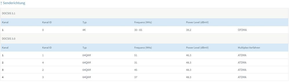

Kanalwerte

hier scheint schon etwas am Anschluss mit den Signalwerten nicht zu stimmen. Gern möchte ich mir das genauer anschauen. Steck dazu bitte unser Leihgerät an den Anschluss.
