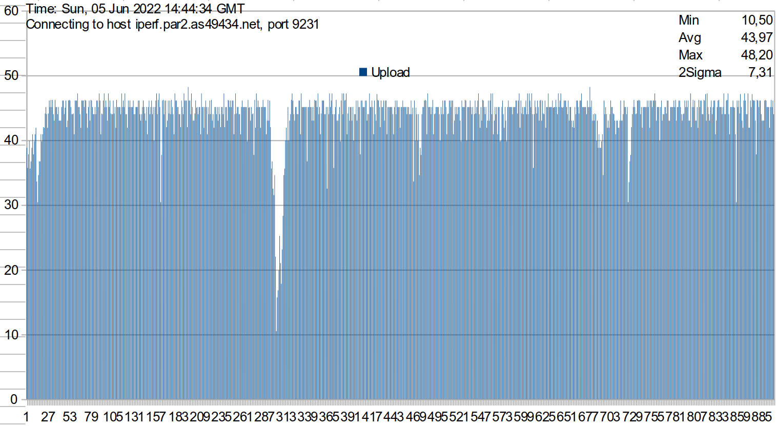

am 05.06.2022 17:18
Speedtest via iperf:
iperf 3.1.3 CYGWIN_NT-10.0 DESKTOP-P6SGV51 2.5.1(0.297/5/3) 2016-04-21 22:14 x86_64 Time: Sun, 05 Jun 2022 14:44:34 GMT Connecting to host iperf.par2.as49434.net, port 9231 Cookie: DESKTOP-P6SGV51.1654440274.392551.09 TCP MSS: 0 (default) [ 4] local 10.10.10.121 port 58782 connected to 193.177.162.41 port 9231 Starting Test: protocol: TCP, 1 streams, 131072 byte blocks, omitting 0 seconds, 900 second test [ ID] Interval Transfer Bandwidth [ 4] 0.00-1.00 sec 3.62 MBytes 30.4 Mbits/sec [ 4] 1.00-2.00 sec 4.62 MBytes 38.8 Mbits/sec [ 4] 2.00-3.00 sec 4.25 MBytes 35.7 Mbits/sec [ 4] 3.00-4.00 sec 4.50 MBytes 37.8 Mbits/sec [ 4] 4.00-5.00 sec 4.75 MBytes 39.9 Mbits/sec [ 4] 5.00-6.00 sec 4.25 MBytes 35.6 Mbits/sec [ 4] 6.00-7.00 sec 4.38 MBytes 36.7 Mbits/sec [ 4] 7.00-8.00 sec 4.62 MBytes 38.8 Mbits/sec [ 4] 8.00-9.00 sec 4.88 MBytes 40.9 Mbits/sec [ 4] 9.00-10.00 sec 4.50 MBytes 37.8 Mbits/sec [ 4] 10.00-11.00 sec 4.75 MBytes 39.8 Mbits/sec [ 4] 11.00-12.00 sec 4.88 MBytes 40.9 Mbits/sec [ 4] 12.00-13.00 sec 5.00 MBytes 41.9 Mbits/sec [ 4] 13.00-14.00 sec 4.00 MBytes 33.6 Mbits/sec [ 4] 14.00-15.00 sec 3.62 MBytes 30.4 Mbits/sec [ 4] 15.00-16.00 sec 4.12 MBytes 34.6 Mbits/sec [ 4] 16.00-17.00 sec 4.38 MBytes 36.7 Mbits/sec [ 4] 17.00-18.00 sec 4.38 MBytes 36.7 Mbits/sec [ 4] 18.00-19.00 sec 4.88 MBytes 40.9 Mbits/sec [ 4] 19.00-20.00 sec 4.75 MBytes 39.8 Mbits/sec [ 4] 20.00-21.00 sec 4.88 MBytes 40.9 Mbits/sec [ 4] 21.00-22.00 sec 5.00 MBytes 42.0 Mbits/sec [ 4] 22.00-23.00 sec 5.00 MBytes 41.9 Mbits/sec [ 4] 23.00-24.00 sec 5.25 MBytes 44.1 Mbits/sec [ 4] 24.00-25.00 sec 5.38 MBytes 45.1 Mbits/sec [ 4] 25.00-26.00 sec 5.25 MBytes 44.0 Mbits/sec [ 4] 26.00-27.00 sec 5.00 MBytes 41.9 Mbits/sec [ 4] 27.00-28.00 sec 5.25 MBytes 44.1 Mbits/sec [ 4] 28.00-29.00 sec 5.50 MBytes 46.1 Mbits/sec [ 4] 29.00-30.00 sec 5.38 MBytes 45.1 Mbits/sec [ 4] 30.00-31.00 sec 5.50 MBytes 46.2 Mbits/sec [ 4] 31.00-32.00 sec 5.38 MBytes 45.1 Mbits/sec [ 4] 32.00-33.00 sec 5.50 MBytes 46.2 Mbits/sec [ 4] 33.00-34.00 sec 5.25 MBytes 44.0 Mbits/sec [ 4] 34.00-35.00 sec 5.12 MBytes 43.0 Mbits/sec [ 4] 35.00-36.00 sec 5.50 MBytes 46.2 Mbits/sec [ 4] 36.00-37.00 sec 5.38 MBytes 45.1 Mbits/sec [ 4] 37.00-38.00 sec 5.38 MBytes 45.1 Mbits/sec [ 4] 38.00-39.00 sec 5.25 MBytes 44.0 Mbits/sec [ 4] 39.00-40.00 sec 5.38 MBytes 45.1 Mbits/sec [ 4] 40.00-41.00 sec 5.12 MBytes 43.0 Mbits/sec [ 4] 41.00-42.00 sec 5.12 MBytes 43.0 Mbits/sec [ 4] 42.00-43.00 sec 5.12 MBytes 43.0 Mbits/sec [ 4] 43.00-44.00 sec 5.38 MBytes 45.1 Mbits/sec [ 4] 44.00-45.00 sec 5.50 MBytes 46.1 Mbits/sec [ 4] 45.00-46.00 sec 5.50 MBytes 46.1 Mbits/sec [ 4] 46.00-47.00 sec 5.25 MBytes 44.0 Mbits/sec [ 4] 47.00-48.00 sec 5.38 MBytes 45.0 Mbits/sec [ 4] 48.00-49.00 sec 5.50 MBytes 46.1 Mbits/sec [ 4] 49.00-50.00 sec 5.00 MBytes 42.0 Mbits/sec [ 4] 50.00-51.00 sec 5.12 MBytes 43.0 Mbits/sec [ 4] 51.00-52.00 sec 5.50 MBytes 46.1 Mbits/sec [ 4] 52.00-53.00 sec 5.50 MBytes 46.2 Mbits/sec [ 4] 53.00-54.00 sec 5.50 MBytes 46.1 Mbits/sec [ 4] 54.00-55.00 sec 5.38 MBytes 45.1 Mbits/sec [ 4] 55.00-56.00 sec 5.25 MBytes 44.0 Mbits/sec [ 4] 56.00-57.00 sec 5.25 MBytes 44.0 Mbits/sec [ 4] 57.00-58.00 sec 5.25 MBytes 44.1 Mbits/sec [ 4] 58.00-59.00 sec 4.88 MBytes 40.9 Mbits/sec [ 4] 59.00-60.00 sec 5.50 MBytes 46.1 Mbits/sec [ 4] 60.00-61.00 sec 5.50 MBytes 46.1 Mbits/sec [ 4] 61.00-62.00 sec 5.50 MBytes 46.1 Mbits/sec [ 4] 62.00-63.00 sec 5.62 MBytes 47.2 Mbits/sec [ 4] 63.00-64.00 sec 5.38 MBytes 45.1 Mbits/sec [ 4] 64.00-65.00 sec 5.38 MBytes 45.1 Mbits/sec [ 4] 65.00-66.00 sec 5.25 MBytes 44.0 Mbits/sec [ 4] 66.00-67.00 sec 5.00 MBytes 41.9 Mbits/sec [ 4] 67.00-68.00 sec 5.50 MBytes 46.1 Mbits/sec [ 4] 68.00-69.00 sec 5.50 MBytes 46.1 Mbits/sec [ 4] 69.00-70.00 sec 5.50 MBytes 46.1 Mbits/sec [ 4] 70.00-71.00 sec 5.38 MBytes 45.1 Mbits/sec [ 4] 71.00-72.00 sec 5.50 MBytes 46.2 Mbits/sec [ 4] 72.00-73.00 sec 5.50 MBytes 46.1 Mbits/sec [ 4] 73.00-74.00 sec 5.25 MBytes 44.1 Mbits/sec [ 4] 74.00-75.00 sec 5.00 MBytes 41.9 Mbits/sec [ 4] 75.00-76.00 sec 5.38 MBytes 45.1 Mbits/sec [ 4] 76.00-77.00 sec 5.50 MBytes 46.1 Mbits/sec [ 4] 77.00-78.00 sec 5.12 MBytes 43.0 Mbits/sec [ 4] 78.00-79.00 sec 5.50 MBytes 46.2 Mbits/sec [ 4] 79.00-80.00 sec 5.50 MBytes 46.1 Mbits/sec [ 4] 80.00-81.00 sec 5.38 MBytes 45.1 Mbits/sec [ 4] 81.00-82.00 sec 5.25 MBytes 44.0 Mbits/sec [ 4] 82.00-83.00 sec 5.25 MBytes 44.0 Mbits/sec [ 4] 83.00-84.00 sec 5.38 MBytes 45.1 Mbits/sec [ 4] 84.00-85.00 sec 5.25 MBytes 44.0 Mbits/sec [ 4] 85.00-86.00 sec 5.50 MBytes 46.1 Mbits/sec [ 4] 86.00-87.00 sec 5.50 MBytes 46.1 Mbits/sec [ 4] 87.00-88.00 sec 5.38 MBytes 45.1 Mbits/sec [ 4] 88.00-89.00 sec 5.62 MBytes 47.2 Mbits/sec [ 4] 89.00-90.00 sec 5.50 MBytes 46.1 Mbits/sec [ 4] 90.00-91.00 sec 4.88 MBytes 40.9 Mbits/sec [ 4] 91.00-92.00 sec 5.25 MBytes 44.1 Mbits/sec [ 4] 92.00-93.00 sec 5.25 MBytes 44.0 Mbits/sec [ 4] 93.00-94.00 sec 5.50 MBytes 46.1 Mbits/sec [ 4] 94.00-95.00 sec 5.62 MBytes 47.2 Mbits/sec [ 4] 95.00-96.00 sec 5.38 MBytes 45.1 Mbits/sec [ 4] 96.00-97.00 sec 5.50 MBytes 46.1 Mbits/sec [ 4] 97.00-98.00 sec 5.38 MBytes 45.1 Mbits/sec [ 4] 98.00-99.00 sec 5.12 MBytes 43.0 Mbits/sec [ 4] 99.00-100.00 sec 5.62 MBytes 47.2 Mbits/sec [ 4] 100.00-101.00 sec 5.38 MBytes 45.1 Mbits/sec [ 4] 101.00-102.00 sec 5.50 MBytes 46.1 Mbits/sec [ 4] 102.00-103.00 sec 5.25 MBytes 44.1 Mbits/sec [ 4] 103.00-104.00 sec 5.25 MBytes 44.0 Mbits/sec [ 4] 104.00-105.00 sec 5.25 MBytes 44.0 Mbits/sec [ 4] 105.00-106.00 sec 5.50 MBytes 46.1 Mbits/sec [ 4] 106.00-107.00 sec 5.25 MBytes 44.1 Mbits/sec [ 4] 107.00-108.00 sec 5.38 MBytes 45.1 Mbits/sec [ 4] 108.00-109.00 sec 5.00 MBytes 41.9 Mbits/sec [ 4] 109.00-110.00 sec 5.50 MBytes 46.2 Mbits/sec [ 4] 110.00-111.00 sec 5.38 MBytes 45.1 Mbits/sec [ 4] 111.00-112.00 sec 5.38 MBytes 45.1 Mbits/sec [ 4] 112.00-113.00 sec 5.38 MBytes 45.1 Mbits/sec [ 4] 113.00-114.00 sec 5.38 MBytes 45.1 Mbits/sec [ 4] 114.00-115.00 sec 5.25 MBytes 44.0 Mbits/sec [ 4] 115.00-116.00 sec 5.62 MBytes 47.2 Mbits/sec [ 4] 116.00-117.00 sec 5.38 MBytes 45.1 Mbits/sec [ 4] 117.00-118.00 sec 5.50 MBytes 46.1 Mbits/sec [ 4] 118.00-119.00 sec 5.38 MBytes 45.1 Mbits/sec [ 4] 119.00-120.00 sec 5.62 MBytes 47.2 Mbits/sec [ 4] 120.00-121.00 sec 5.25 MBytes 44.0 Mbits/sec [ 4] 121.00-122.00 sec 5.25 MBytes 44.0 Mbits/sec [ 4] 122.00-123.00 sec 5.00 MBytes 41.9 Mbits/sec [ 4] 123.00-124.00 sec 5.50 MBytes 46.1 Mbits/sec [ 4] 124.00-125.00 sec 5.38 MBytes 45.1 Mbits/sec [ 4] 125.00-126.00 sec 5.50 MBytes 46.1 Mbits/sec [ 4] 126.00-127.00 sec 5.38 MBytes 45.1 Mbits/sec [ 4] 127.00-128.00 sec 5.38 MBytes 45.1 Mbits/sec [ 4] 128.00-129.00 sec 5.38 MBytes 45.1 Mbits/sec [ 4] 129.00-130.00 sec 5.50 MBytes 46.1 Mbits/sec [ 4] 130.00-131.00 sec 5.25 MBytes 44.0 Mbits/sec [ 4] 131.00-132.00 sec 5.25 MBytes 44.0 Mbits/sec [ 4] 132.00-133.00 sec 5.38 MBytes 45.1 Mbits/sec [ 4] 133.00-134.00 sec 5.38 MBytes 45.1 Mbits/sec [ 4] 134.00-135.00 sec 5.38 MBytes 45.1 Mbits/sec [ 4] 135.00-136.00 sec 5.50 MBytes 46.1 Mbits/sec [ 4] 136.00-137.00 sec 5.50 MBytes 46.1 Mbits/sec [ 4] 137.00-138.00 sec 5.25 MBytes 44.0 Mbits/sec [ 4] 138.00-139.00 sec 5.12 MBytes 43.0 Mbits/sec [ 4] 139.00-140.00 sec 5.25 MBytes 44.0 Mbits/sec [ 4] 140.00-141.00 sec 5.38 MBytes 45.1 Mbits/sec [ 4] 141.00-142.00 sec 5.50 MBytes 46.1 Mbits/sec [ 4] 142.00-143.00 sec 5.38 MBytes 45.1 Mbits/sec [ 4] 143.00-144.00 sec 5.25 MBytes 44.1 Mbits/sec [ 4] 144.00-145.00 sec 5.12 MBytes 43.0 Mbits/sec [ 4] 145.00-146.00 sec 5.38 MBytes 45.1 Mbits/sec [ 4] 146.00-147.00 sec 4.88 MBytes 40.9 Mbits/sec [ 4] 147.00-148.00 sec 5.38 MBytes 45.1 Mbits/sec [ 4] 148.00-149.00 sec 5.50 MBytes 46.1 Mbits/sec [ 4] 149.00-150.00 sec 5.25 MBytes 44.0 Mbits/sec [ 4] 150.00-151.00 sec 5.38 MBytes 45.1 Mbits/sec [ 4] 151.00-152.00 sec 5.50 MBytes 46.1 Mbits/sec [ 4] 152.00-153.00 sec 5.25 MBytes 44.0 Mbits/sec [ 4] 153.00-154.00 sec 5.38 MBytes 45.1 Mbits/sec [ 4] 154.00-155.00 sec 4.75 MBytes 39.9 Mbits/sec [ 4] 155.00-156.00 sec 5.38 MBytes 45.1 Mbits/sec [ 4] 156.00-157.00 sec 5.50 MBytes 46.1 Mbits/sec [ 4] 157.00-158.00 sec 5.62 MBytes 47.2 Mbits/sec [ 4] 158.00-159.00 sec 5.25 MBytes 44.0 Mbits/sec [ 4] 159.00-160.00 sec 5.50 MBytes 46.2 Mbits/sec [ 4] 160.00-161.00 sec 5.62 MBytes 47.2 Mbits/sec [ 4] 161.00-162.00 sec 5.38 MBytes 45.1 Mbits/sec [ 4] 162.00-163.00 sec 3.62 MBytes 30.4 Mbits/sec [ 4] 163.00-164.00 sec 4.50 MBytes 37.7 Mbits/sec [ 4] 164.00-165.00 sec 5.50 MBytes 46.1 Mbits/sec [ 4] 165.00-166.00 sec 5.50 MBytes 46.2 Mbits/sec [ 4] 166.00-167.00 sec 5.25 MBytes 44.0 Mbits/sec [ 4] 167.00-168.00 sec 5.50 MBytes 46.1 Mbits/sec [ 4] 168.00-169.00 sec 5.50 MBytes 46.1 Mbits/sec [ 4] 169.00-170.00 sec 5.00 MBytes 42.0 Mbits/sec [ 4] 170.00-171.00 sec 5.12 MBytes 43.0 Mbits/sec [ 4] 171.00-172.00 sec 5.50 MBytes 46.1 Mbits/sec [ 4] 172.00-173.00 sec 5.25 MBytes 44.1 Mbits/sec [ 4] 173.00-174.00 sec 5.50 MBytes 46.1 Mbits/sec [ 4] 174.00-175.00 sec 5.25 MBytes 44.0 Mbits/sec [ 4] 175.00-176.00 sec 5.50 MBytes 46.2 Mbits/sec [ 4] 176.00-177.00 sec 5.38 MBytes 45.1 Mbits/sec [ 4] 177.00-178.00 sec 5.25 MBytes 44.0 Mbits/sec [ 4] 178.00-179.00 sec 4.88 MBytes 40.9 Mbits/sec [ 4] 179.00-180.00 sec 5.62 MBytes 47.2 Mbits/sec [ 4] 180.00-181.00 sec 5.50 MBytes 46.1 Mbits/sec [ 4] 181.00-182.00 sec 5.50 MBytes 46.1 Mbits/sec [ 4] 182.00-183.00 sec 5.38 MBytes 45.1 Mbits/sec [ 4] 183.00-184.00 sec 5.38 MBytes 45.1 Mbits/sec [ 4] 184.00-185.00 sec 5.25 MBytes 44.0 Mbits/sec [ 4] 185.00-186.00 sec 5.25 MBytes 44.0 Mbits/sec [ 4] 186.00-187.00 sec 5.00 MBytes 42.0 Mbits/sec [ 4] 187.00-188.00 sec 5.50 MBytes 46.1 Mbits/sec [ 4] 188.00-189.00 sec 5.38 MBytes 45.1 Mbits/sec [ 4] 189.00-190.00 sec 5.25 MBytes 44.0 Mbits/sec [ 4] 190.00-191.00 sec 5.62 MBytes 47.2 Mbits/sec [ 4] 191.00-192.00 sec 5.50 MBytes 46.1 Mbits/sec [ 4] 192.00-193.00 sec 5.50 MBytes 46.1 Mbits/sec [ 4] 193.00-194.00 sec 5.50 MBytes 46.1 Mbits/sec [ 4] 194.00-195.00 sec 5.00 MBytes 42.0 Mbits/sec [ 4] 195.00-196.00 sec 5.75 MBytes 48.2 Mbits/sec [ 4] 196.00-197.00 sec 5.50 MBytes 46.1 Mbits/sec [ 4] 197.00-198.00 sec 5.50 MBytes 46.1 Mbits/sec [ 4] 198.00-199.00 sec 5.25 MBytes 44.0 Mbits/sec [ 4] 199.00-200.00 sec 5.62 MBytes 47.2 Mbits/sec [ 4] 200.00-201.00 sec 5.38 MBytes 45.1 Mbits/sec [ 4] 201.00-202.00 sec 5.12 MBytes 43.0 Mbits/sec [ 4] 202.00-203.00 sec 5.12 MBytes 43.0 Mbits/sec [ 4] 203.00-204.00 sec 5.25 MBytes 44.1 Mbits/sec [ 4] 204.00-205.00 sec 5.50 MBytes 46.1 Mbits/sec [ 4] 205.00-206.00 sec 5.38 MBytes 45.0 Mbits/sec [ 4] 206.00-207.00 sec 5.38 MBytes 45.1 Mbits/sec [ 4] 207.00-208.00 sec 5.25 MBytes 44.0 Mbits/sec [ 4] 208.00-209.00 sec 5.38 MBytes 45.1 Mbits/sec [ 4] 209.00-210.00 sec 5.38 MBytes 45.1 Mbits/sec [ 4] 210.00-211.00 sec 4.88 MBytes 40.9 Mbits/sec [ 4] 211.00-212.00 sec 5.62 MBytes 47.2 Mbits/sec [ 4] 212.00-213.00 sec 5.38 MBytes 45.1 Mbits/sec [ 4] 213.00-214.00 sec 5.38 MBytes 45.1 Mbits/sec [ 4] 214.00-215.00 sec 5.00 MBytes 41.9 Mbits/sec [ 4] 215.00-216.00 sec 5.38 MBytes 45.1 Mbits/sec [ 4] 216.00-217.00 sec 5.50 MBytes 46.1 Mbits/sec [ 4] 217.00-218.00 sec 5.38 MBytes 45.1 Mbits/sec [ 4] 218.00-219.00 sec 4.88 MBytes 40.9 Mbits/sec [ 4] 219.00-220.00 sec 5.38 MBytes 45.1 Mbits/sec [ 4] 220.00-221.00 sec 5.25 MBytes 44.0 Mbits/sec [ 4] 221.00-222.00 sec 5.50 MBytes 46.1 Mbits/sec [ 4] 222.00-223.00 sec 5.25 MBytes 44.0 Mbits/sec [ 4] 223.00-224.00 sec 5.50 MBytes 46.2 Mbits/sec [ 4] 224.00-225.00 sec 5.12 MBytes 43.0 Mbits/sec [ 4] 225.00-226.00 sec 5.25 MBytes 44.0 Mbits/sec [ 4] 226.00-227.00 sec 5.00 MBytes 41.9 Mbits/sec [ 4] 227.00-228.00 sec 5.38 MBytes 45.1 Mbits/sec [ 4] 228.00-229.00 sec 5.38 MBytes 45.1 Mbits/sec [ 4] 229.00-230.00 sec 5.25 MBytes 44.0 Mbits/sec [ 4] 230.00-231.00 sec 5.38 MBytes 45.1 Mbits/sec [ 4] 231.00-232.00 sec 5.12 MBytes 43.0 Mbits/sec [ 4] 232.00-233.00 sec 5.38 MBytes 45.1 Mbits/sec [ 4] 233.00-234.00 sec 5.25 MBytes 44.0 Mbits/sec [ 4] 234.00-235.00 sec 5.00 MBytes 42.0 Mbits/sec [ 4] 235.00-236.00 sec 5.38 MBytes 45.1 Mbits/sec [ 4] 236.00-237.00 sec 5.38 MBytes 45.1 Mbits/sec [ 4] 237.00-238.00 sec 5.25 MBytes 44.0 Mbits/sec [ 4] 238.00-239.00 sec 5.62 MBytes 47.2 Mbits/sec [ 4] 239.00-240.00 sec 5.00 MBytes 42.0 Mbits/sec [ 4] 240.00-241.00 sec 5.38 MBytes 45.1 Mbits/sec [ 4] 241.00-242.00 sec 5.38 MBytes 45.1 Mbits/sec [ 4] 242.00-243.00 sec 5.12 MBytes 43.0 Mbits/sec [ 4] 243.00-244.00 sec 5.50 MBytes 46.2 Mbits/sec [ 4] 244.00-245.00 sec 5.50 MBytes 46.1 Mbits/sec [ 4] 245.00-246.00 sec 5.38 MBytes 45.1 Mbits/sec [ 4] 246.00-247.00 sec 5.50 MBytes 46.1 Mbits/sec [ 4] 247.00-248.00 sec 5.38 MBytes 45.1 Mbits/sec [ 4] 248.00-249.00 sec 5.50 MBytes 46.1 Mbits/sec [ 4] 249.00-250.00 sec 5.50 MBytes 46.1 Mbits/sec [ 4] 250.00-251.00 sec 4.88 MBytes 40.9 Mbits/sec [ 4] 251.00-252.00 sec 5.25 MBytes 44.0 Mbits/sec [ 4] 252.00-253.00 sec 5.62 MBytes 47.2 Mbits/sec [ 4] 253.00-254.00 sec 5.25 MBytes 44.1 Mbits/sec [ 4] 254.00-255.00 sec 5.38 MBytes 45.1 Mbits/sec [ 4] 255.00-256.00 sec 5.38 MBytes 45.1 Mbits/sec [ 4] 256.00-257.00 sec 5.25 MBytes 44.0 Mbits/sec [ 4] 257.00-258.00 sec 5.25 MBytes 44.0 Mbits/sec [ 4] 258.00-259.00 sec 4.88 MBytes 40.9 Mbits/sec [ 4] 259.00-260.00 sec 5.38 MBytes 45.1 Mbits/sec [ 4] 260.00-261.00 sec 5.50 MBytes 46.1 Mbits/sec [ 4] 261.00-262.00 sec 5.38 MBytes 45.1 Mbits/sec [ 4] 262.00-263.00 sec 5.38 MBytes 45.1 Mbits/sec [ 4] 263.00-264.00 sec 5.38 MBytes 45.1 Mbits/sec [ 4] 264.00-265.00 sec 5.38 MBytes 45.1 Mbits/sec [ 4] 265.00-266.00 sec 5.38 MBytes 45.1 Mbits/sec [ 4] 266.00-267.00 sec 4.75 MBytes 39.8 Mbits/sec [ 4] 267.00-268.00 sec 5.50 MBytes 46.2 Mbits/sec [ 4] 268.00-269.00 sec 5.38 MBytes 45.0 Mbits/sec [ 4] 269.00-270.00 sec 5.38 MBytes 45.1 Mbits/sec [ 4] 270.00-271.00 sec 5.12 MBytes 43.0 Mbits/sec [ 4] 271.00-272.00 sec 5.38 MBytes 45.1 Mbits/sec [ 4] 272.00-273.00 sec 5.25 MBytes 44.0 Mbits/sec [ 4] 273.00-274.00 sec 5.25 MBytes 44.1 Mbits/sec [ 4] 274.00-275.00 sec 4.50 MBytes 37.7 Mbits/sec [ 4] 275.00-276.00 sec 5.50 MBytes 46.2 Mbits/sec [ 4] 276.00-277.00 sec 5.00 MBytes 41.9 Mbits/sec [ 4] 277.00-278.00 sec 5.62 MBytes 47.2 Mbits/sec [ 4] 278.00-279.00 sec 5.38 MBytes 45.1 Mbits/sec [ 4] 279.00-280.00 sec 5.50 MBytes 46.1 Mbits/sec [ 4] 280.00-281.00 sec 5.38 MBytes 45.1 Mbits/sec [ 4] 281.00-282.00 sec 5.38 MBytes 45.1 Mbits/sec [ 4] 282.00-283.00 sec 5.00 MBytes 41.9 Mbits/sec [ 4] 283.00-284.00 sec 5.38 MBytes 45.1 Mbits/sec [ 4] 284.00-285.00 sec 5.38 MBytes 45.1 Mbits/sec [ 4] 285.00-286.00 sec 5.50 MBytes 46.2 Mbits/sec [ 4] 286.00-287.00 sec 5.38 MBytes 45.1 Mbits/sec [ 4] 287.00-288.00 sec 5.38 MBytes 45.1 Mbits/sec [ 4] 288.00-289.00 sec 5.38 MBytes 45.1 Mbits/sec [ 4] 289.00-290.00 sec 4.88 MBytes 40.9 Mbits/sec [ 4] 290.00-291.00 sec 5.12 MBytes 43.0 Mbits/sec [ 4] 291.00-292.00 sec 5.50 MBytes 46.2 Mbits/sec [ 4] 292.00-293.00 sec 5.12 MBytes 43.0 Mbits/sec [ 4] 293.00-294.00 sec 5.50 MBytes 46.1 Mbits/sec [ 4] 294.00-295.00 sec 5.00 MBytes 42.0 Mbits/sec [ 4] 295.00-296.00 sec 4.25 MBytes 35.6 Mbits/sec [ 4] 296.00-297.00 sec 4.38 MBytes 36.7 Mbits/sec [ 4] 297.00-298.00 sec 3.88 MBytes 32.5 Mbits/sec [ 4] 298.00-299.00 sec 3.75 MBytes 31.5 Mbits/sec [ 4] 299.00-300.00 sec 4.12 MBytes 34.6 Mbits/sec [ 4] 300.00-301.00 sec 2.62 MBytes 22.0 Mbits/sec [ 4] 301.00-302.00 sec 1.25 MBytes 10.5 Mbits/sec [ 4] 302.00-303.00 sec 1.88 MBytes 15.7 Mbits/sec [ 4] 303.00-304.00 sec 2.00 MBytes 16.8 Mbits/sec [ 4] 304.00-305.00 sec 2.38 MBytes 19.9 Mbits/sec [ 4] 305.00-306.00 sec 3.00 MBytes 25.2 Mbits/sec [ 4] 306.00-307.00 sec 2.50 MBytes 21.0 Mbits/sec [ 4] 307.00-308.00 sec 2.12 MBytes 17.8 Mbits/sec [ 4] 308.00-309.00 sec 2.75 MBytes 23.1 Mbits/sec [ 4] 309.00-310.00 sec 3.38 MBytes 28.3 Mbits/sec [ 4] 310.00-311.00 sec 4.12 MBytes 34.6 Mbits/sec [ 4] 311.00-312.00 sec 4.25 MBytes 35.6 Mbits/sec [ 4] 312.00-313.00 sec 4.75 MBytes 39.9 Mbits/sec [ 4] 313.00-314.00 sec 5.00 MBytes 41.9 Mbits/sec [ 4] 314.00-315.00 sec 4.75 MBytes 39.9 Mbits/sec [ 4] 315.00-316.00 sec 5.38 MBytes 45.1 Mbits/sec [ 4] 316.00-317.00 sec 4.75 MBytes 39.9 Mbits/sec [ 4] 317.00-318.00 sec 5.12 MBytes 43.0 Mbits/sec [ 4] 318.00-319.00 sec 5.25 MBytes 44.0 Mbits/sec [ 4] 319.00-320.00 sec 5.50 MBytes 46.2 Mbits/sec [ 4] 320.00-321.00 sec 5.62 MBytes 47.2 Mbits/sec [ 4] 321.00-322.00 sec 5.50 MBytes 46.1 Mbits/sec [ 4] 322.00-323.00 sec 5.25 MBytes 44.0 Mbits/sec [ 4] 323.00-324.00 sec 5.12 MBytes 43.0 Mbits/sec [ 4] 324.00-325.00 sec 5.38 MBytes 45.1 Mbits/sec [ 4] 325.00-326.00 sec 5.38 MBytes 45.1 Mbits/sec [ 4] 326.00-327.00 sec 5.25 MBytes 44.0 Mbits/sec [ 4] 327.00-328.00 sec 5.25 MBytes 44.0 Mbits/sec [ 4] 328.00-329.00 sec 5.50 MBytes 46.1 Mbits/sec [ 4] 329.00-330.00 sec 5.50 MBytes 46.1 Mbits/sec [ 4] 330.00-331.00 sec 4.88 MBytes 40.9 Mbits/sec [ 4] 331.00-332.00 sec 5.62 MBytes 47.2 Mbits/sec [ 4] 332.00-333.00 sec 5.38 MBytes 45.1 Mbits/sec [ 4] 333.00-334.00 sec 5.38 MBytes 45.1 Mbits/sec [ 4] 334.00-335.00 sec 5.38 MBytes 45.1 Mbits/sec [ 4] 335.00-336.00 sec 5.38 MBytes 45.1 Mbits/sec [ 4] 336.00-337.00 sec 5.38 MBytes 45.1 Mbits/sec [ 4] 337.00-338.00 sec 5.38 MBytes 45.1 Mbits/sec [ 4] 338.00-339.00 sec 4.38 MBytes 36.7 Mbits/sec [ 4] 339.00-340.00 sec 5.38 MBytes 45.1 Mbits/sec [ 4] 340.00-341.00 sec 5.38 MBytes 45.1 Mbits/sec [ 4] 341.00-342.00 sec 5.50 MBytes 46.2 Mbits/sec [ 4] 342.00-343.00 sec 5.38 MBytes 45.1 Mbits/sec [ 4] 343.00-344.00 sec 5.38 MBytes 45.1 Mbits/sec [ 4] 344.00-345.00 sec 5.12 MBytes 43.0 Mbits/sec [ 4] 345.00-346.00 sec 5.38 MBytes 45.1 Mbits/sec [ 4] 346.00-347.00 sec 5.12 MBytes 43.0 Mbits/sec [ 4] 347.00-348.00 sec 5.50 MBytes 46.2 Mbits/sec [ 4] 348.00-349.00 sec 5.50 MBytes 46.1 Mbits/sec [ 4] 349.00-350.00 sec 5.50 MBytes 46.1 Mbits/sec [ 4] 350.00-351.00 sec 5.38 MBytes 45.1 Mbits/sec [ 4] 351.00-352.00 sec 5.62 MBytes 47.2 Mbits/sec [ 4] 352.00-353.00 sec 5.25 MBytes 44.0 Mbits/sec [ 4] 353.00-354.00 sec 5.38 MBytes 45.1 Mbits/sec [ 4] 354.00-355.00 sec 4.88 MBytes 40.9 Mbits/sec [ 4] 355.00-356.00 sec 5.25 MBytes 44.1 Mbits/sec [ 4] 356.00-357.00 sec 5.50 MBytes 46.1 Mbits/sec [ 4] 357.00-358.00 sec 5.50 MBytes 46.1 Mbits/sec [ 4] 358.00-359.00 sec 5.50 MBytes 46.1 Mbits/sec [ 4] 359.00-360.00 sec 5.25 MBytes 44.0 Mbits/sec [ 4] 360.00-361.00 sec 5.25 MBytes 44.0 Mbits/sec [ 4] 361.00-362.00 sec 5.38 MBytes 45.1 Mbits/sec [ 4] 362.00-363.00 sec 3.88 MBytes 32.5 Mbits/sec [ 4] 363.00-364.00 sec 5.38 MBytes 45.1 Mbits/sec [ 4] 364.00-365.00 sec 5.25 MBytes 44.0 Mbits/sec [ 4] 365.00-366.00 sec 5.62 MBytes 47.2 Mbits/sec [ 4] 366.00-367.00 sec 5.38 MBytes 45.1 Mbits/sec [ 4] 367.00-368.00 sec 5.50 MBytes 46.1 Mbits/sec [ 4] 368.00-369.00 sec 5.62 MBytes 47.2 Mbits/sec [ 4] 369.00-370.00 sec 5.25 MBytes 44.0 Mbits/sec [ 4] 370.00-371.00 sec 4.25 MBytes 35.7 Mbits/sec [ 4] 371.00-372.00 sec 5.25 MBytes 44.0 Mbits/sec [ 4] 372.00-373.00 sec 5.38 MBytes 45.1 Mbits/sec [ 4] 373.00-374.00 sec 5.50 MBytes 46.2 Mbits/sec [ 4] 374.00-375.00 sec 5.12 MBytes 43.0 Mbits/sec [ 4] 375.00-376.00 sec 5.12 MBytes 43.0 Mbits/sec [ 4] 376.00-377.00 sec 5.25 MBytes 44.0 Mbits/sec [ 4] 377.00-378.00 sec 5.38 MBytes 45.1 Mbits/sec [ 4] 378.00-379.00 sec 4.75 MBytes 39.8 Mbits/sec [ 4] 379.00-380.00 sec 5.50 MBytes 46.1 Mbits/sec [ 4] 380.00-381.00 sec 5.62 MBytes 47.2 Mbits/sec [ 4] 381.00-382.00 sec 5.25 MBytes 44.0 Mbits/sec [ 4] 382.00-383.00 sec 5.62 MBytes 47.2 Mbits/sec [ 4] 383.00-384.00 sec 5.50 MBytes 46.1 Mbits/sec [ 4] 384.00-385.00 sec 5.50 MBytes 46.2 Mbits/sec [ 4] 385.00-386.00 sec 5.62 MBytes 47.2 Mbits/sec [ 4] 386.00-387.00 sec 4.88 MBytes 40.9 Mbits/sec [ 4] 387.00-388.00 sec 5.25 MBytes 44.1 Mbits/sec [ 4] 388.00-389.00 sec 5.38 MBytes 45.1 Mbits/sec [ 4] 389.00-390.00 sec 5.12 MBytes 43.0 Mbits/sec [ 4] 390.00-391.00 sec 5.38 MBytes 45.1 Mbits/sec [ 4] 391.00-392.00 sec 5.38 MBytes 45.1 Mbits/sec [ 4] 392.00-393.00 sec 5.12 MBytes 43.0 Mbits/sec [ 4] 393.00-394.00 sec 5.38 MBytes 45.1 Mbits/sec [ 4] 394.00-395.00 sec 4.75 MBytes 39.9 Mbits/sec [ 4] 395.00-396.00 sec 5.25 MBytes 44.0 Mbits/sec [ 4] 396.00-397.00 sec 5.25 MBytes 44.0 Mbits/sec [ 4] 397.00-398.00 sec 5.50 MBytes 46.1 Mbits/sec [ 4] 398.00-399.00 sec 5.12 MBytes 43.0 Mbits/sec [ 4] 399.00-400.00 sec 5.50 MBytes 46.1 Mbits/sec [ 4] 400.00-401.00 sec 5.38 MBytes 45.1 Mbits/sec [ 4] 401.00-402.00 sec 5.38 MBytes 45.1 Mbits/sec [ 4] 402.00-403.00 sec 4.50 MBytes 37.8 Mbits/sec [ 4] 403.00-404.00 sec 5.50 MBytes 46.1 Mbits/sec [ 4] 404.00-405.00 sec 5.50 MBytes 46.1 Mbits/sec [ 4] 405.00-406.00 sec 5.38 MBytes 45.1 Mbits/sec [ 4] 406.00-407.00 sec 5.38 MBytes 45.1 Mbits/sec [ 4] 407.00-408.00 sec 5.38 MBytes 45.1 Mbits/sec [ 4] 408.00-409.00 sec 5.50 MBytes 46.1 Mbits/sec [ 4] 409.00-410.00 sec 5.50 MBytes 46.1 Mbits/sec [ 4] 410.00-411.00 sec 5.12 MBytes 43.0 Mbits/sec [ 4] 411.00-412.00 sec 5.25 MBytes 44.0 Mbits/sec [ 4] 412.00-413.00 sec 5.25 MBytes 44.0 Mbits/sec [ 4] 413.00-414.00 sec 5.62 MBytes 47.2 Mbits/sec [ 4] 414.00-415.00 sec 5.38 MBytes 45.1 Mbits/sec [ 4] 415.00-416.00 sec 5.38 MBytes 45.1 Mbits/sec [ 4] 416.00-417.00 sec 5.50 MBytes 46.1 Mbits/sec [ 4] 417.00-418.00 sec 5.38 MBytes 45.1 Mbits/sec [ 4] 418.00-419.00 sec 4.88 MBytes 40.9 Mbits/sec [ 4] 419.00-420.00 sec 5.50 MBytes 46.1 Mbits/sec [ 4] 420.00-421.00 sec 5.25 MBytes 44.0 Mbits/sec [ 4] 421.00-422.00 sec 5.12 MBytes 43.0 Mbits/sec [ 4] 422.00-423.00 sec 5.62 MBytes 47.1 Mbits/sec [ 4] 423.00-424.00 sec 5.50 MBytes 46.2 Mbits/sec [ 4] 424.00-425.00 sec 5.50 MBytes 46.1 Mbits/sec [ 4] 425.00-426.00 sec 5.38 MBytes 45.1 Mbits/sec [ 4] 426.00-427.00 sec 5.00 MBytes 42.0 Mbits/sec [ 4] 427.00-428.00 sec 5.50 MBytes 46.1 Mbits/sec [ 4] 428.00-429.00 sec 5.38 MBytes 45.1 Mbits/sec [ 4] 429.00-430.00 sec 5.38 MBytes 45.1 Mbits/sec [ 4] 430.00-431.00 sec 5.50 MBytes 46.1 Mbits/sec [ 4] 431.00-432.00 sec 5.12 MBytes 43.0 Mbits/sec [ 4] 432.00-433.00 sec 5.50 MBytes 46.1 Mbits/sec [ 4] 433.00-434.00 sec 5.50 MBytes 46.1 Mbits/sec [ 4] 434.00-435.00 sec 4.88 MBytes 40.9 Mbits/sec [ 4] 435.00-436.00 sec 5.38 MBytes 45.1 Mbits/sec [ 4] 436.00-437.00 sec 5.38 MBytes 45.1 Mbits/sec [ 4] 437.00-438.00 sec 5.38 MBytes 45.1 Mbits/sec [ 4] 438.00-439.00 sec 5.38 MBytes 45.1 Mbits/sec [ 4] 439.00-440.00 sec 5.38 MBytes 45.1 Mbits/sec [ 4] 440.00-441.00 sec 5.38 MBytes 45.1 Mbits/sec [ 4] 441.00-442.00 sec 5.25 MBytes 44.0 Mbits/sec [ 4] 442.00-443.00 sec 4.88 MBytes 40.9 Mbits/sec [ 4] 443.00-444.00 sec 5.38 MBytes 45.1 Mbits/sec [ 4] 444.00-445.00 sec 5.50 MBytes 46.1 Mbits/sec [ 4] 445.00-446.00 sec 5.25 MBytes 44.0 Mbits/sec [ 4] 446.00-447.00 sec 5.50 MBytes 46.1 Mbits/sec [ 4] 447.00-448.00 sec 5.38 MBytes 45.1 Mbits/sec [ 4] 448.00-449.00 sec 5.38 MBytes 45.1 Mbits/sec [ 4] 449.00-450.00 sec 5.38 MBytes 45.1 Mbits/sec [ 4] 450.00-451.00 sec 5.00 MBytes 41.9 Mbits/sec [ 4] 451.00-452.00 sec 5.38 MBytes 45.1 Mbits/sec [ 4] 452.00-453.00 sec 5.38 MBytes 45.1 Mbits/sec [ 4] 453.00-454.00 sec 5.50 MBytes 46.1 Mbits/sec [ 4] 454.00-455.00 sec 5.38 MBytes 45.1 Mbits/sec [ 4] 455.00-456.00 sec 5.38 MBytes 45.1 Mbits/sec [ 4] 456.00-457.00 sec 5.38 MBytes 45.1 Mbits/sec [ 4] 457.00-458.00 sec 5.38 MBytes 45.1 Mbits/sec [ 4] 458.00-459.00 sec 5.25 MBytes 44.0 Mbits/sec [ 4] 459.00-460.00 sec 5.38 MBytes 45.1 Mbits/sec [ 4] 460.00-461.00 sec 5.38 MBytes 45.1 Mbits/sec [ 4] 461.00-462.00 sec 5.25 MBytes 44.0 Mbits/sec [ 4] 462.00-463.00 sec 5.25 MBytes 44.0 Mbits/sec [ 4] 463.00-464.00 sec 5.50 MBytes 46.1 Mbits/sec [ 4] 464.00-465.00 sec 5.25 MBytes 44.0 Mbits/sec [ 4] 465.00-466.00 sec 5.38 MBytes 45.0 Mbits/sec [ 4] 466.00-467.00 sec 4.00 MBytes 33.6 Mbits/sec [ 4] 467.00-468.00 sec 5.50 MBytes 46.1 Mbits/sec [ 4] 468.00-469.00 sec 4.75 MBytes 39.9 Mbits/sec [ 4] 469.00-470.00 sec 5.38 MBytes 45.0 Mbits/sec [ 4] 470.00-471.00 sec 5.25 MBytes 44.0 Mbits/sec [ 4] 471.00-472.00 sec 4.75 MBytes 39.9 Mbits/sec [ 4] 472.00-473.00 sec 5.25 MBytes 44.0 Mbits/sec [ 4] 473.00-474.00 sec 4.12 MBytes 34.6 Mbits/sec [ 4] 474.00-475.00 sec 4.62 MBytes 38.8 Mbits/sec [ 4] 475.00-476.00 sec 4.50 MBytes 37.7 Mbits/sec [ 4] 476.00-477.00 sec 5.25 MBytes 44.0 Mbits/sec [ 4] 477.00-478.00 sec 5.38 MBytes 45.1 Mbits/sec [ 4] 478.00-479.00 sec 5.38 MBytes 45.1 Mbits/sec [ 4] 479.00-480.00 sec 5.50 MBytes 46.1 Mbits/sec [ 4] 480.00-481.00 sec 5.50 MBytes 46.2 Mbits/sec [ 4] 481.00-482.00 sec 5.50 MBytes 46.1 Mbits/sec [ 4] 482.00-483.00 sec 4.88 MBytes 40.9 Mbits/sec [ 4] 483.00-484.00 sec 5.62 MBytes 47.2 Mbits/sec [ 4] 484.00-485.00 sec 5.38 MBytes 45.1 Mbits/sec [ 4] 485.00-486.00 sec 5.38 MBytes 45.1 Mbits/sec [ 4] 486.00-487.00 sec 5.38 MBytes 45.1 Mbits/sec [ 4] 487.00-488.00 sec 5.25 MBytes 44.0 Mbits/sec [ 4] 488.00-489.00 sec 5.38 MBytes 45.1 Mbits/sec [ 4] 489.00-490.00 sec 5.50 MBytes 46.2 Mbits/sec [ 4] 490.00-491.00 sec 4.88 MBytes 40.9 Mbits/sec [ 4] 491.00-492.00 sec 5.25 MBytes 44.0 Mbits/sec [ 4] 492.00-493.00 sec 5.25 MBytes 44.1 Mbits/sec [ 4] 493.00-494.00 sec 5.38 MBytes 45.1 Mbits/sec [ 4] 494.00-495.00 sec 5.38 MBytes 45.1 Mbits/sec [ 4] 495.00-496.00 sec 5.38 MBytes 45.1 Mbits/sec [ 4] 496.00-497.00 sec 5.38 MBytes 45.1 Mbits/sec [ 4] 497.00-498.00 sec 5.25 MBytes 44.0 Mbits/sec [ 4] 498.00-499.00 sec 4.75 MBytes 39.9 Mbits/sec [ 4] 499.00-500.00 sec 5.38 MBytes 45.1 Mbits/sec [ 4] 500.00-501.00 sec 5.25 MBytes 44.0 Mbits/sec [ 4] 501.00-502.00 sec 5.50 MBytes 46.1 Mbits/sec [ 4] 502.00-503.00 sec 5.25 MBytes 44.0 Mbits/sec [ 4] 503.00-504.00 sec 5.50 MBytes 46.1 Mbits/sec [ 4] 504.00-505.00 sec 5.50 MBytes 46.1 Mbits/sec [ 4] 505.00-506.00 sec 5.38 MBytes 45.1 Mbits/sec [ 4] 506.00-507.00 sec 4.88 MBytes 40.9 Mbits/sec [ 4] 507.00-508.00 sec 5.25 MBytes 44.0 Mbits/sec [ 4] 508.00-509.00 sec 5.25 MBytes 44.1 Mbits/sec [ 4] 509.00-510.00 sec 5.50 MBytes 46.1 Mbits/sec [ 4] 510.00-511.00 sec 5.50 MBytes 46.1 Mbits/sec [ 4] 511.00-512.00 sec 5.38 MBytes 45.1 Mbits/sec [ 4] 512.00-513.00 sec 5.50 MBytes 46.1 Mbits/sec [ 4] 513.00-514.00 sec 5.50 MBytes 46.1 Mbits/sec [ 4] 514.00-515.00 sec 4.88 MBytes 40.9 Mbits/sec [ 4] 515.00-516.00 sec 5.12 MBytes 43.0 Mbits/sec [ 4] 516.00-517.00 sec 5.38 MBytes 45.1 Mbits/sec [ 4] 517.00-518.00 sec 5.25 MBytes 44.0 Mbits/sec [ 4] 518.00-519.00 sec 5.38 MBytes 45.1 Mbits/sec [ 4] 519.00-520.00 sec 5.25 MBytes 44.0 Mbits/sec [ 4] 520.00-521.00 sec 5.38 MBytes 45.1 Mbits/sec [ 4] 521.00-522.00 sec 5.38 MBytes 45.1 Mbits/sec [ 4] 522.00-523.00 sec 5.12 MBytes 43.0 Mbits/sec [ 4] 523.00-524.00 sec 4.75 MBytes 39.8 Mbits/sec [ 4] 524.00-525.00 sec 5.50 MBytes 46.1 Mbits/sec [ 4] 525.00-526.00 sec 5.38 MBytes 45.1 Mbits/sec [ 4] 526.00-527.00 sec 5.38 MBytes 45.1 Mbits/sec [ 4] 527.00-528.00 sec 5.38 MBytes 45.1 Mbits/sec [ 4] 528.00-529.00 sec 5.50 MBytes 46.2 Mbits/sec [ 4] 529.00-530.00 sec 5.50 MBytes 46.1 Mbits/sec [ 4] 530.00-531.00 sec 4.75 MBytes 39.9 Mbits/sec [ 4] 531.00-532.00 sec 5.38 MBytes 45.1 Mbits/sec [ 4] 532.00-533.00 sec 5.38 MBytes 45.1 Mbits/sec [ 4] 533.00-534.00 sec 5.38 MBytes 45.1 Mbits/sec [ 4] 534.00-535.00 sec 5.50 MBytes 46.1 Mbits/sec [ 4] 535.00-536.00 sec 5.38 MBytes 45.1 Mbits/sec [ 4] 536.00-537.00 sec 5.25 MBytes 44.0 Mbits/sec [ 4] 537.00-538.00 sec 5.38 MBytes 45.1 Mbits/sec [ 4] 538.00-539.00 sec 4.75 MBytes 39.9 Mbits/sec [ 4] 539.00-540.00 sec 5.25 MBytes 44.0 Mbits/sec [ 4] 540.00-541.00 sec 5.50 MBytes 46.1 Mbits/sec [ 4] 541.00-542.00 sec 5.25 MBytes 44.1 Mbits/sec [ 4] 542.00-543.00 sec 5.38 MBytes 45.1 Mbits/sec [ 4] 543.00-544.00 sec 5.50 MBytes 46.1 Mbits/sec [ 4] 544.00-545.00 sec 5.62 MBytes 47.2 Mbits/sec [ 4] 545.00-546.00 sec 5.25 MBytes 44.0 Mbits/sec [ 4] 546.00-547.00 sec 5.00 MBytes 41.9 Mbits/sec [ 4] 547.00-548.00 sec 5.38 MBytes 45.1 Mbits/sec [ 4] 548.00-549.00 sec 5.12 MBytes 43.0 Mbits/sec [ 4] 549.00-550.00 sec 5.50 MBytes 46.2 Mbits/sec [ 4] 550.00-551.00 sec 5.50 MBytes 46.1 Mbits/sec [ 4] 551.00-552.00 sec 5.38 MBytes 45.1 Mbits/sec [ 4] 552.00-553.00 sec 5.25 MBytes 44.0 Mbits/sec [ 4] 553.00-554.00 sec 5.38 MBytes 45.1 Mbits/sec [ 4] 554.00-555.00 sec 5.00 MBytes 41.9 Mbits/sec [ 4] 555.00-556.00 sec 5.12 MBytes 43.0 Mbits/sec [ 4] 556.00-557.00 sec 5.50 MBytes 46.1 Mbits/sec [ 4] 557.00-558.00 sec 5.12 MBytes 43.0 Mbits/sec [ 4] 558.00-559.00 sec 5.50 MBytes 46.1 Mbits/sec [ 4] 559.00-560.00 sec 5.62 MBytes 47.2 Mbits/sec [ 4] 560.00-561.00 sec 5.25 MBytes 44.0 Mbits/sec [ 4] 561.00-562.00 sec 5.62 MBytes 47.2 Mbits/sec [ 4] 562.00-563.00 sec 4.88 MBytes 40.9 Mbits/sec [ 4] 563.00-564.00 sec 5.12 MBytes 43.0 Mbits/sec [ 4] 564.00-565.00 sec 5.38 MBytes 45.1 Mbits/sec [ 4] 565.00-566.00 sec 5.25 MBytes 44.0 Mbits/sec [ 4] 566.00-567.00 sec 5.38 MBytes 45.1 Mbits/sec [ 4] 567.00-568.00 sec 4.88 MBytes 40.9 Mbits/sec [ 4] 568.00-569.00 sec 5.38 MBytes 45.1 Mbits/sec [ 4] 569.00-570.00 sec 5.38 MBytes 45.1 Mbits/sec [ 4] 570.00-571.00 sec 4.75 MBytes 39.8 Mbits/sec [ 4] 571.00-572.00 sec 4.75 MBytes 39.9 Mbits/sec [ 4] 572.00-573.00 sec 5.38 MBytes 45.1 Mbits/sec [ 4] 573.00-574.00 sec 5.50 MBytes 46.1 Mbits/sec [ 4] 574.00-575.00 sec 5.25 MBytes 44.0 Mbits/sec [ 4] 575.00-576.00 sec 5.00 MBytes 41.9 Mbits/sec [ 4] 576.00-577.00 sec 5.38 MBytes 45.1 Mbits/sec [ 4] 577.00-578.00 sec 5.12 MBytes 43.0 Mbits/sec [ 4] 578.00-579.00 sec 4.75 MBytes 39.8 Mbits/sec [ 4] 579.00-580.00 sec 5.38 MBytes 45.1 Mbits/sec [ 4] 580.00-581.00 sec 5.50 MBytes 46.1 Mbits/sec [ 4] 581.00-582.00 sec 5.38 MBytes 45.1 Mbits/sec [ 4] 582.00-583.00 sec 5.38 MBytes 45.1 Mbits/sec [ 4] 583.00-584.00 sec 5.38 MBytes 45.1 Mbits/sec [ 4] 584.00-585.00 sec 5.38 MBytes 45.1 Mbits/sec [ 4] 585.00-586.00 sec 5.25 MBytes 44.0 Mbits/sec [ 4] 586.00-587.00 sec 5.38 MBytes 45.1 Mbits/sec [ 4] 587.00-588.00 sec 5.38 MBytes 45.1 Mbits/sec [ 4] 588.00-589.00 sec 5.38 MBytes 45.1 Mbits/sec [ 4] 589.00-590.00 sec 5.50 MBytes 46.1 Mbits/sec [ 4] 590.00-591.00 sec 5.50 MBytes 46.1 Mbits/sec [ 4] 591.00-592.00 sec 5.25 MBytes 44.1 Mbits/sec [ 4] 592.00-593.00 sec 5.50 MBytes 46.1 Mbits/sec [ 4] 593.00-594.00 sec 5.62 MBytes 47.2 Mbits/sec [ 4] 594.00-595.00 sec 5.00 MBytes 41.9 Mbits/sec [ 4] 595.00-596.00 sec 5.50 MBytes 46.1 Mbits/sec [ 4] 596.00-597.00 sec 5.25 MBytes 44.1 Mbits/sec [ 4] 597.00-598.00 sec 5.38 MBytes 45.1 Mbits/sec [ 4] 598.00-599.00 sec 5.25 MBytes 44.0 Mbits/sec [ 4] 599.00-600.00 sec 5.38 MBytes 45.1 Mbits/sec [ 4] 600.00-601.00 sec 5.38 MBytes 45.1 Mbits/sec [ 4] 601.00-602.00 sec 5.50 MBytes 46.1 Mbits/sec [ 4] 602.00-603.00 sec 5.25 MBytes 44.0 Mbits/sec [ 4] 603.00-604.00 sec 5.62 MBytes 47.2 Mbits/sec [ 4] 604.00-605.00 sec 5.25 MBytes 44.0 Mbits/sec [ 4] 605.00-606.00 sec 5.62 MBytes 47.2 Mbits/sec [ 4] 606.00-607.00 sec 5.50 MBytes 46.1 Mbits/sec [ 4] 607.00-608.00 sec 5.38 MBytes 45.1 Mbits/sec [ 4] 608.00-609.00 sec 5.62 MBytes 47.2 Mbits/sec [ 4] 609.00-610.00 sec 5.25 MBytes 44.0 Mbits/sec [ 4] 610.00-611.00 sec 4.25 MBytes 35.7 Mbits/sec [ 4] 611.00-612.00 sec 5.25 MBytes 44.0 Mbits/sec [ 4] 612.00-613.00 sec 5.50 MBytes 46.1 Mbits/sec [ 4] 613.00-614.00 sec 5.38 MBytes 45.1 Mbits/sec [ 4] 614.00-615.00 sec 5.25 MBytes 44.1 Mbits/sec [ 4] 615.00-616.00 sec 5.50 MBytes 46.1 Mbits/sec [ 4] 616.00-617.00 sec 5.38 MBytes 45.1 Mbits/sec [ 4] 617.00-618.00 sec 5.12 MBytes 43.0 Mbits/sec [ 4] 618.00-619.00 sec 5.50 MBytes 46.1 Mbits/sec [ 4] 619.00-620.00 sec 5.50 MBytes 46.2 Mbits/sec [ 4] 620.00-621.00 sec 5.12 MBytes 43.0 Mbits/sec [ 4] 621.00-622.00 sec 5.50 MBytes 46.1 Mbits/sec [ 4] 622.00-623.00 sec 5.25 MBytes 44.1 Mbits/sec [ 4] 623.00-624.00 sec 5.25 MBytes 44.0 Mbits/sec [ 4] 624.00-625.00 sec 5.50 MBytes 46.1 Mbits/sec [ 4] 625.00-626.00 sec 5.00 MBytes 41.9 Mbits/sec [ 4] 626.00-627.00 sec 5.38 MBytes 45.1 Mbits/sec [ 4] 627.00-628.00 sec 5.38 MBytes 45.1 Mbits/sec [ 4] 628.00-629.00 sec 5.62 MBytes 47.2 Mbits/sec [ 4] 629.00-630.00 sec 5.38 MBytes 45.1 Mbits/sec [ 4] 630.00-631.00 sec 5.38 MBytes 45.1 Mbits/sec [ 4] 631.00-632.00 sec 5.38 MBytes 45.1 Mbits/sec [ 4] 632.00-633.00 sec 5.38 MBytes 45.1 Mbits/sec [ 4] 633.00-634.00 sec 5.50 MBytes 46.1 Mbits/sec [ 4] 634.00-635.00 sec 5.38 MBytes 45.0 Mbits/sec [ 4] 635.00-636.00 sec 5.38 MBytes 45.1 Mbits/sec [ 4] 636.00-637.00 sec 5.38 MBytes 45.1 Mbits/sec [ 4] 637.00-638.00 sec 5.50 MBytes 46.2 Mbits/sec [ 4] 638.00-639.00 sec 5.38 MBytes 45.1 Mbits/sec [ 4] 639.00-640.00 sec 5.25 MBytes 44.0 Mbits/sec [ 4] 640.00-641.00 sec 5.62 MBytes 47.2 Mbits/sec [ 4] 641.00-642.00 sec 5.38 MBytes 45.1 Mbits/sec [ 4] 642.00-643.00 sec 5.50 MBytes 46.1 Mbits/sec [ 4] 643.00-644.00 sec 5.62 MBytes 47.2 Mbits/sec [ 4] 644.00-645.00 sec 5.38 MBytes 45.1 Mbits/sec [ 4] 645.00-646.00 sec 5.38 MBytes 45.0 Mbits/sec [ 4] 646.00-647.00 sec 5.38 MBytes 45.1 Mbits/sec [ 4] 647.00-648.00 sec 5.50 MBytes 46.1 Mbits/sec [ 4] 648.00-649.00 sec 5.50 MBytes 46.1 Mbits/sec [ 4] 649.00-650.00 sec 5.50 MBytes 46.1 Mbits/sec [ 4] 650.00-651.00 sec 5.38 MBytes 45.1 Mbits/sec [ 4] 651.00-652.00 sec 5.25 MBytes 44.0 Mbits/sec [ 4] 652.00-653.00 sec 5.50 MBytes 46.1 Mbits/sec [ 4] 653.00-654.00 sec 5.12 MBytes 43.0 Mbits/sec [ 4] 654.00-655.00 sec 5.38 MBytes 45.1 Mbits/sec [ 4] 655.00-656.00 sec 5.38 MBytes 45.1 Mbits/sec [ 4] 656.00-657.00 sec 5.12 MBytes 43.0 Mbits/sec [ 4] 657.00-658.00 sec 5.00 MBytes 42.0 Mbits/sec [ 4] 658.00-659.00 sec 5.12 MBytes 43.0 Mbits/sec [ 4] 659.00-660.00 sec 5.00 MBytes 41.9 Mbits/sec [ 4] 660.00-661.00 sec 5.38 MBytes 45.1 Mbits/sec [ 4] 661.00-662.00 sec 5.25 MBytes 44.0 Mbits/sec [ 4] 662.00-663.00 sec 5.50 MBytes 46.1 Mbits/sec [ 4] 663.00-664.00 sec 5.50 MBytes 46.1 Mbits/sec [ 4] 664.00-665.00 sec 5.38 MBytes 45.1 Mbits/sec [ 4] 665.00-666.00 sec 5.25 MBytes 44.1 Mbits/sec [ 4] 666.00-667.00 sec 5.50 MBytes 46.1 Mbits/sec [ 4] 667.00-668.00 sec 5.50 MBytes 46.1 Mbits/sec [ 4] 668.00-669.00 sec 5.62 MBytes 47.2 Mbits/sec [ 4] 669.00-670.00 sec 5.38 MBytes 45.1 Mbits/sec [ 4] 670.00-671.00 sec 5.38 MBytes 45.1 Mbits/sec [ 4] 671.00-672.00 sec 5.38 MBytes 45.1 Mbits/sec [ 4] 672.00-673.00 sec 5.38 MBytes 45.1 Mbits/sec [ 4] 673.00-674.00 sec 5.38 MBytes 45.1 Mbits/sec [ 4] 674.00-675.00 sec 5.25 MBytes 44.0 Mbits/sec [ 4] 675.00-676.00 sec 5.50 MBytes 46.1 Mbits/sec [ 4] 676.00-677.00 sec 5.38 MBytes 45.1 Mbits/sec [ 4] 677.00-678.00 sec 5.38 MBytes 45.1 Mbits/sec [ 4] 678.00-679.00 sec 5.75 MBytes 48.2 Mbits/sec [ 4] 679.00-680.00 sec 5.38 MBytes 45.1 Mbits/sec [ 4] 680.00-681.00 sec 5.50 MBytes 46.1 Mbits/sec [ 4] 681.00-682.00 sec 5.12 MBytes 43.0 Mbits/sec [ 4] 682.00-683.00 sec 5.25 MBytes 44.0 Mbits/sec [ 4] 683.00-684.00 sec 5.12 MBytes 43.0 Mbits/sec [ 4] 684.00-685.00 sec 5.25 MBytes 44.1 Mbits/sec [ 4] 685.00-686.00 sec 5.25 MBytes 44.0 Mbits/sec [ 4] 686.00-687.00 sec 4.75 MBytes 39.9 Mbits/sec [ 4] 687.00-688.00 sec 5.12 MBytes 43.0 Mbits/sec [ 4] 688.00-689.00 sec 4.62 MBytes 38.8 Mbits/sec [ 4] 689.00-690.00 sec 4.88 MBytes 40.9 Mbits/sec [ 4] 690.00-691.00 sec 4.62 MBytes 38.8 Mbits/sec [ 4] 691.00-692.00 sec 4.62 MBytes 38.8 Mbits/sec [ 4] 692.00-693.00 sec 4.75 MBytes 39.8 Mbits/sec [ 4] 693.00-694.00 sec 4.88 MBytes 40.9 Mbits/sec [ 4] 694.00-695.00 sec 4.12 MBytes 34.6 Mbits/sec [ 4] 695.00-696.00 sec 5.50 MBytes 46.1 Mbits/sec [ 4] 696.00-697.00 sec 5.25 MBytes 44.0 Mbits/sec [ 4] 697.00-698.00 sec 5.38 MBytes 45.1 Mbits/sec [ 4] 698.00-699.00 sec 5.25 MBytes 44.0 Mbits/sec [ 4] 699.00-700.00 sec 5.00 MBytes 41.9 Mbits/sec [ 4] 700.00-701.00 sec 5.12 MBytes 43.0 Mbits/sec [ 4] 701.00-702.00 sec 5.00 MBytes 41.9 Mbits/sec [ 4] 702.00-703.00 sec 5.25 MBytes 44.0 Mbits/sec [ 4] 703.00-704.00 sec 5.50 MBytes 46.1 Mbits/sec [ 4] 704.00-705.00 sec 5.38 MBytes 45.1 Mbits/sec [ 4] 705.00-706.00 sec 5.38 MBytes 45.1 Mbits/sec [ 4] 706.00-707.00 sec 5.25 MBytes 44.1 Mbits/sec [ 4] 707.00-708.00 sec 5.25 MBytes 44.0 Mbits/sec [ 4] 708.00-709.00 sec 5.12 MBytes 43.0 Mbits/sec [ 4] 709.00-710.00 sec 4.88 MBytes 40.9 Mbits/sec [ 4] 710.00-711.00 sec 5.12 MBytes 43.0 Mbits/sec [ 4] 711.00-712.00 sec 5.12 MBytes 43.0 Mbits/sec [ 4] 712.00-713.00 sec 5.00 MBytes 41.9 Mbits/sec [ 4] 713.00-714.00 sec 5.00 MBytes 41.9 Mbits/sec [ 4] 714.00-715.00 sec 5.12 MBytes 43.0 Mbits/sec [ 4] 715.00-716.00 sec 5.50 MBytes 46.1 Mbits/sec [ 4] 716.00-717.00 sec 5.12 MBytes 43.0 Mbits/sec [ 4] 717.00-718.00 sec 5.12 MBytes 43.0 Mbits/sec [ 4] 718.00-719.00 sec 5.25 MBytes 44.0 Mbits/sec [ 4] 719.00-720.00 sec 5.50 MBytes 46.1 Mbits/sec [ 4] 720.00-721.00 sec 5.38 MBytes 45.1 Mbits/sec [ 4] 721.00-722.00 sec 5.38 MBytes 45.1 Mbits/sec [ 4] 722.00-723.00 sec 5.25 MBytes 44.0 Mbits/sec [ 4] 723.00-724.00 sec 5.38 MBytes 45.1 Mbits/sec [ 4] 724.00-725.00 sec 3.62 MBytes 30.4 Mbits/sec [ 4] 725.00-726.00 sec 4.00 MBytes 33.5 Mbits/sec [ 4] 726.00-727.00 sec 4.38 MBytes 36.7 Mbits/sec [ 4] 727.00-728.00 sec 4.50 MBytes 37.7 Mbits/sec [ 4] 728.00-729.00 sec 5.00 MBytes 42.0 Mbits/sec [ 4] 729.00-730.00 sec 5.25 MBytes 44.0 Mbits/sec [ 4] 730.00-731.00 sec 5.38 MBytes 45.1 Mbits/sec [ 4] 731.00-732.00 sec 5.50 MBytes 46.2 Mbits/sec [ 4] 732.00-733.00 sec 5.38 MBytes 45.1 Mbits/sec [ 4] 733.00-734.00 sec 5.25 MBytes 44.0 Mbits/sec [ 4] 734.00-735.00 sec 5.25 MBytes 44.1 Mbits/sec [ 4] 735.00-736.00 sec 5.50 MBytes 46.1 Mbits/sec [ 4] 736.00-737.00 sec 5.50 MBytes 46.1 Mbits/sec [ 4] 737.00-738.00 sec 5.50 MBytes 46.2 Mbits/sec [ 4] 738.00-739.00 sec 5.50 MBytes 46.1 Mbits/sec [ 4] 739.00-740.00 sec 5.25 MBytes 44.0 Mbits/sec [ 4] 740.00-741.00 sec 5.38 MBytes 45.1 Mbits/sec [ 4] 741.00-742.00 sec 5.00 MBytes 41.9 Mbits/sec [ 4] 742.00-743.00 sec 5.38 MBytes 45.1 Mbits/sec [ 4] 743.00-744.00 sec 5.38 MBytes 45.1 Mbits/sec [ 4] 744.00-745.00 sec 5.38 MBytes 45.1 Mbits/sec [ 4] 745.00-746.00 sec 5.38 MBytes 45.1 Mbits/sec [ 4] 746.00-747.00 sec 5.38 MBytes 45.1 Mbits/sec [ 4] 747.00-748.00 sec 5.50 MBytes 46.1 Mbits/sec [ 4] 748.00-749.00 sec 5.38 MBytes 45.1 Mbits/sec [ 4] 749.00-750.00 sec 5.50 MBytes 46.1 Mbits/sec [ 4] 750.00-751.00 sec 5.00 MBytes 41.9 Mbits/sec [ 4] 751.00-752.00 sec 5.50 MBytes 46.1 Mbits/sec [ 4] 752.00-753.00 sec 5.50 MBytes 46.1 Mbits/sec [ 4] 753.00-754.00 sec 5.38 MBytes 45.1 Mbits/sec [ 4] 754.00-755.00 sec 5.50 MBytes 46.1 Mbits/sec [ 4] 755.00-756.00 sec 5.50 MBytes 46.1 Mbits/sec [ 4] 756.00-757.00 sec 5.62 MBytes 47.2 Mbits/sec [ 4] 757.00-758.00 sec 5.50 MBytes 46.1 Mbits/sec [ 4] 758.00-759.00 sec 5.12 MBytes 43.0 Mbits/sec [ 4] 759.00-760.00 sec 5.38 MBytes 45.1 Mbits/sec [ 4] 760.00-761.00 sec 5.38 MBytes 45.1 Mbits/sec [ 4] 761.00-762.00 sec 5.38 MBytes 45.1 Mbits/sec [ 4] 762.00-763.00 sec 4.75 MBytes 39.9 Mbits/sec [ 4] 763.00-764.00 sec 5.38 MBytes 45.1 Mbits/sec [ 4] 764.00-765.00 sec 5.50 MBytes 46.1 Mbits/sec [ 4] 765.00-766.00 sec 5.12 MBytes 43.0 Mbits/sec [ 4] 766.00-767.00 sec 5.25 MBytes 44.0 Mbits/sec [ 4] 767.00-768.00 sec 5.25 MBytes 44.0 Mbits/sec [ 4] 768.00-769.00 sec 5.38 MBytes 45.1 Mbits/sec [ 4] 769.00-770.00 sec 5.38 MBytes 45.1 Mbits/sec [ 4] 770.00-771.00 sec 5.25 MBytes 44.1 Mbits/sec [ 4] 771.00-772.00 sec 5.50 MBytes 46.1 Mbits/sec [ 4] 772.00-773.00 sec 5.50 MBytes 46.1 Mbits/sec [ 4] 773.00-774.00 sec 5.12 MBytes 43.0 Mbits/sec [ 4] 774.00-775.00 sec 5.12 MBytes 43.0 Mbits/sec [ 4] 775.00-776.00 sec 5.38 MBytes 45.1 Mbits/sec [ 4] 776.00-777.00 sec 5.38 MBytes 45.1 Mbits/sec [ 4] 777.00-778.00 sec 5.38 MBytes 45.1 Mbits/sec [ 4] 778.00-779.00 sec 5.38 MBytes 45.1 Mbits/sec [ 4] 779.00-780.00 sec 5.50 MBytes 46.1 Mbits/sec [ 4] 780.00-781.00 sec 5.38 MBytes 45.1 Mbits/sec [ 4] 781.00-782.00 sec 5.50 MBytes 46.2 Mbits/sec [ 4] 782.00-783.00 sec 5.12 MBytes 43.0 Mbits/sec [ 4] 783.00-784.00 sec 5.38 MBytes 45.1 Mbits/sec [ 4] 784.00-785.00 sec 5.38 MBytes 45.1 Mbits/sec [ 4] 785.00-786.00 sec 5.50 MBytes 46.1 Mbits/sec [ 4] 786.00-787.00 sec 5.50 MBytes 46.1 Mbits/sec [ 4] 787.00-788.00 sec 5.38 MBytes 45.1 Mbits/sec [ 4] 788.00-789.00 sec 5.25 MBytes 44.0 Mbits/sec [ 4] 789.00-790.00 sec 5.12 MBytes 43.0 Mbits/sec [ 4] 790.00-791.00 sec 5.25 MBytes 44.0 Mbits/sec [ 4] 791.00-792.00 sec 5.25 MBytes 44.1 Mbits/sec [ 4] 792.00-793.00 sec 5.50 MBytes 46.1 Mbits/sec [ 4] 793.00-794.00 sec 5.38 MBytes 45.1 Mbits/sec [ 4] 794.00-795.00 sec 5.50 MBytes 46.1 Mbits/sec [ 4] 795.00-796.00 sec 5.38 MBytes 45.1 Mbits/sec [ 4] 796.00-797.00 sec 5.50 MBytes 46.1 Mbits/sec [ 4] 797.00-798.00 sec 5.12 MBytes 43.0 Mbits/sec [ 4] 798.00-799.00 sec 5.12 MBytes 43.0 Mbits/sec [ 4] 799.00-800.00 sec 5.62 MBytes 47.2 Mbits/sec [ 4] 800.00-801.00 sec 5.00 MBytes 42.0 Mbits/sec [ 4] 801.00-802.00 sec 5.38 MBytes 45.1 Mbits/sec [ 4] 802.00-803.00 sec 5.50 MBytes 46.2 Mbits/sec [ 4] 803.00-804.00 sec 5.38 MBytes 45.1 Mbits/sec [ 4] 804.00-805.00 sec 5.50 MBytes 46.1 Mbits/sec [ 4] 805.00-806.00 sec 5.12 MBytes 43.0 Mbits/sec [ 4] 806.00-807.00 sec 5.12 MBytes 43.0 Mbits/sec [ 4] 807.00-808.00 sec 5.38 MBytes 45.1 Mbits/sec [ 4] 808.00-809.00 sec 5.00 MBytes 41.9 Mbits/sec [ 4] 809.00-810.00 sec 5.50 MBytes 46.2 Mbits/sec [ 4] 810.00-811.00 sec 5.38 MBytes 45.1 Mbits/sec [ 4] 811.00-812.00 sec 5.50 MBytes 46.1 Mbits/sec [ 4] 812.00-813.00 sec 5.50 MBytes 46.1 Mbits/sec [ 4] 813.00-814.00 sec 5.25 MBytes 44.0 Mbits/sec [ 4] 814.00-815.00 sec 5.25 MBytes 44.0 Mbits/sec [ 4] 815.00-816.00 sec 5.50 MBytes 46.2 Mbits/sec [ 4] 816.00-817.00 sec 5.50 MBytes 46.1 Mbits/sec [ 4] 817.00-818.00 sec 5.62 MBytes 47.1 Mbits/sec [ 4] 818.00-819.00 sec 5.12 MBytes 43.0 Mbits/sec [ 4] 819.00-820.00 sec 5.62 MBytes 47.2 Mbits/sec [ 4] 820.00-821.00 sec 5.38 MBytes 45.1 Mbits/sec [ 4] 821.00-822.00 sec 5.25 MBytes 44.0 Mbits/sec [ 4] 822.00-823.00 sec 5.12 MBytes 43.0 Mbits/sec [ 4] 823.00-824.00 sec 5.38 MBytes 45.1 Mbits/sec [ 4] 824.00-825.00 sec 5.50 MBytes 46.1 Mbits/sec [ 4] 825.00-826.00 sec 5.25 MBytes 44.0 Mbits/sec [ 4] 826.00-827.00 sec 5.38 MBytes 45.1 Mbits/sec [ 4] 827.00-828.00 sec 5.50 MBytes 46.1 Mbits/sec [ 4] 828.00-829.00 sec 5.50 MBytes 46.1 Mbits/sec [ 4] 829.00-830.00 sec 4.88 MBytes 40.9 Mbits/sec [ 4] 830.00-831.00 sec 5.12 MBytes 43.0 Mbits/sec [ 4] 831.00-832.00 sec 5.38 MBytes 45.1 Mbits/sec [ 4] 832.00-833.00 sec 5.50 MBytes 46.1 Mbits/sec [ 4] 833.00-834.00 sec 5.50 MBytes 46.2 Mbits/sec [ 4] 834.00-835.00 sec 5.38 MBytes 45.1 Mbits/sec [ 4] 835.00-836.00 sec 5.38 MBytes 45.1 Mbits/sec [ 4] 836.00-837.00 sec 5.38 MBytes 45.1 Mbits/sec [ 4] 837.00-838.00 sec 5.25 MBytes 44.0 Mbits/sec [ 4] 838.00-839.00 sec 5.38 MBytes 45.1 Mbits/sec [ 4] 839.00-840.00 sec 5.62 MBytes 47.2 Mbits/sec [ 4] 840.00-841.00 sec 5.25 MBytes 44.0 Mbits/sec [ 4] 841.00-842.00 sec 5.25 MBytes 44.0 Mbits/sec [ 4] 842.00-843.00 sec 5.50 MBytes 46.1 Mbits/sec [ 4] 843.00-844.00 sec 5.50 MBytes 46.2 Mbits/sec [ 4] 844.00-845.00 sec 5.62 MBytes 47.2 Mbits/sec [ 4] 845.00-846.00 sec 5.25 MBytes 44.0 Mbits/sec [ 4] 846.00-847.00 sec 4.88 MBytes 40.9 Mbits/sec [ 4] 847.00-848.00 sec 5.38 MBytes 45.1 Mbits/sec [ 4] 848.00-849.00 sec 5.38 MBytes 45.1 Mbits/sec [ 4] 849.00-850.00 sec 5.38 MBytes 45.1 Mbits/sec [ 4] 850.00-851.00 sec 5.50 MBytes 46.1 Mbits/sec [ 4] 851.00-852.00 sec 5.38 MBytes 45.1 Mbits/sec [ 4] 852.00-853.00 sec 5.38 MBytes 45.0 Mbits/sec [ 4] 853.00-854.00 sec 4.88 MBytes 40.9 Mbits/sec [ 4] 854.00-855.00 sec 3.62 MBytes 30.4 Mbits/sec [ 4] 855.00-856.00 sec 5.50 MBytes 46.1 Mbits/sec [ 4] 856.00-857.00 sec 5.38 MBytes 45.1 Mbits/sec [ 4] 857.00-858.00 sec 5.50 MBytes 46.1 Mbits/sec [ 4] 858.00-859.00 sec 5.25 MBytes 44.1 Mbits/sec [ 4] 859.00-860.00 sec 5.62 MBytes 47.1 Mbits/sec [ 4] 860.00-861.00 sec 5.38 MBytes 45.1 Mbits/sec [ 4] 861.00-862.00 sec 5.12 MBytes 43.0 Mbits/sec [ 4] 862.00-863.00 sec 5.00 MBytes 41.9 Mbits/sec [ 4] 863.00-864.00 sec 5.50 MBytes 46.1 Mbits/sec [ 4] 864.00-865.00 sec 5.62 MBytes 47.2 Mbits/sec [ 4] 865.00-866.00 sec 5.50 MBytes 46.1 Mbits/sec [ 4] 866.00-867.00 sec 5.25 MBytes 44.0 Mbits/sec [ 4] 867.00-868.00 sec 5.25 MBytes 44.0 Mbits/sec [ 4] 868.00-869.00 sec 5.62 MBytes 47.2 Mbits/sec [ 4] 869.00-870.00 sec 5.00 MBytes 41.9 Mbits/sec [ 4] 870.00-871.00 sec 5.00 MBytes 41.9 Mbits/sec [ 4] 871.00-872.00 sec 5.50 MBytes 46.1 Mbits/sec [ 4] 872.00-873.00 sec 5.38 MBytes 45.1 Mbits/sec [ 4] 873.00-874.00 sec 5.62 MBytes 47.1 Mbits/sec [ 4] 874.00-875.00 sec 5.50 MBytes 46.2 Mbits/sec [ 4] 875.00-876.00 sec 5.50 MBytes 46.1 Mbits/sec [ 4] 876.00-877.00 sec 5.50 MBytes 46.1 Mbits/sec [ 4] 877.00-878.00 sec 5.12 MBytes 43.0 Mbits/sec [ 4] 878.00-879.00 sec 4.50 MBytes 37.8 Mbits/sec [ 4] 879.00-880.00 sec 5.50 MBytes 46.2 Mbits/sec [ 4] 880.00-881.00 sec 5.50 MBytes 46.1 Mbits/sec [ 4] 881.00-882.00 sec 5.38 MBytes 45.1 Mbits/sec [ 4] 882.00-883.00 sec 5.50 MBytes 46.1 Mbits/sec [ 4] 883.00-884.00 sec 5.50 MBytes 46.1 Mbits/sec [ 4] 884.00-885.00 sec 5.25 MBytes 44.0 Mbits/sec [ 4] 885.00-886.00 sec 5.12 MBytes 43.0 Mbits/sec [ 4] 886.00-887.00 sec 5.12 MBytes 43.0 Mbits/sec [ 4] 887.00-888.00 sec 5.12 MBytes 43.0 Mbits/sec [ 4] 888.00-889.00 sec 5.50 MBytes 46.1 Mbits/sec [ 4] 889.00-890.00 sec 5.50 MBytes 46.2 Mbits/sec [ 4] 890.00-891.00 sec 5.50 MBytes 46.1 Mbits/sec [ 4] 891.00-892.00 sec 5.38 MBytes 45.1 Mbits/sec [ 4] 892.00-893.00 sec 5.38 MBytes 45.1 Mbits/sec [ 4] 893.00-894.00 sec 5.38 MBytes 45.1 Mbits/sec [ 4] 894.00-895.00 sec 5.00 MBytes 41.9 Mbits/sec [ 4] 895.00-896.00 sec 5.38 MBytes 45.1 Mbits/sec [ 4] 896.00-897.00 sec 5.50 MBytes 46.2 Mbits/sec [ 4] 897.00-898.00 sec 5.38 MBytes 45.1 Mbits/sec [ 4] 898.00-899.00 sec 5.50 MBytes 46.1 Mbits/sec [ 4] 899.00-900.00 sec 5.25 MBytes 44.0 Mbits/sec - - - - - - - - - - - - - - - - - - - - - - - - - Test Complete. Summary Results: [ ID] Interval Transfer Bandwidth [ 4] 0.00-900.00 sec 4.61 GBytes 44.0 Mbits/sec sender [ 4] 0.00-900.00 sec 4.61 GBytes 44.0 Mbits/sec receiver CPU Utilization: local/sender 0.7% (0.1%u/0.6%s), remote/receiver 6.8% (0.9%u/5.8%s) iperf Done.

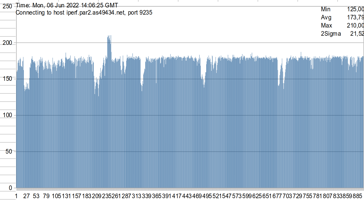

am 06.06.2022 16:40
TCP Download Test:
iperf 3.1.3 CYGWIN_NT-10.0 DESKTOP-P6SGV51 2.5.1(0.297/5/3) 2016-04-21 22:14 x86_64 Time: Mon, 06 Jun 2022 14:06:25 GMT Connecting to host iperf.par2.as49434.net, port 9235 Reverse mode, remote host iperf.par2.as49434.net is sending Cookie: DESKTOP-P6SGV51.1654524385.157841.0d TCP MSS: 0 (default) [ 4] local 10.10.10.121 port 58377 connected to 193.177.162.41 port 9235 [ 6] local 10.10.10.121 port 58378 connected to 193.177.162.41 port 9235 [ 8] local 10.10.10.121 port 58379 connected to 193.177.162.41 port 9235 [ 10] local 10.10.10.121 port 58380 connected to 193.177.162.41 port 9235 Starting Test: protocol: TCP, 4 streams, 131072 byte blocks, omitting 0 seconds, 900 second test [ ID] Interval Transfer Bandwidth [ 4] 0.00-1.00 sec 2.07 MBytes 17.4 Mbits/sec [ 6] 0.00-1.00 sec 2.89 MBytes 24.2 Mbits/sec [ 8] 0.00-1.00 sec 4.83 MBytes 40.5 Mbits/sec [ 10] 0.00-1.00 sec 5.08 MBytes 42.6 Mbits/sec [SUM] 0.00-1.00 sec 14.9 MBytes 125 Mbits/sec - - - - - - - - - - - - - - - - - - - - - - - - - [ 4] 1.00-2.00 sec 1.86 MBytes 15.6 Mbits/sec [ 6] 1.00-2.00 sec 4.90 MBytes 41.1 Mbits/sec [ 8] 1.00-2.00 sec 5.13 MBytes 43.0 Mbits/sec [ 10] 1.00-2.00 sec 5.81 MBytes 48.7 Mbits/sec [SUM] 1.00-2.00 sec 17.7 MBytes 148 Mbits/sec - - - - - - - - - - - - - - - - - - - - - - - - - [ 4] 2.00-3.00 sec 3.02 MBytes 25.3 Mbits/sec [ 6] 2.00-3.00 sec 4.90 MBytes 41.1 Mbits/sec [ 8] 2.00-3.00 sec 5.36 MBytes 44.9 Mbits/sec [ 10] 2.00-3.00 sec 5.79 MBytes 48.6 Mbits/sec [SUM] 2.00-3.00 sec 19.1 MBytes 160 Mbits/sec - - - - - - - - - - - - - - - - - - - - - - - - - [ 4] 3.00-4.00 sec 3.58 MBytes 30.0 Mbits/sec [ 6] 3.00-4.00 sec 5.11 MBytes 42.8 Mbits/sec [ 8] 3.00-4.00 sec 5.04 MBytes 42.3 Mbits/sec [ 10] 3.00-4.00 sec 5.33 MBytes 44.7 Mbits/sec [SUM] 3.00-4.00 sec 19.1 MBytes 160 Mbits/sec - - - - - - - - - - - - - - - - - - - - - - - - - [ 4] 4.00-5.00 sec 4.07 MBytes 34.1 Mbits/sec [ 6] 4.00-5.00 sec 4.24 MBytes 35.6 Mbits/sec [ 8] 4.00-5.00 sec 5.26 MBytes 44.1 Mbits/sec [ 10] 4.00-5.00 sec 5.70 MBytes 47.8 Mbits/sec [SUM] 4.00-5.00 sec 19.3 MBytes 162 Mbits/sec - - - - - - - - - - - - - - - - - - - - - - - - - [ 4] 5.00-6.00 sec 4.28 MBytes 35.9 Mbits/sec [ 6] 5.00-6.00 sec 5.13 MBytes 43.0 Mbits/sec [ 8] 5.00-6.00 sec 5.36 MBytes 45.0 Mbits/sec [ 10] 5.00-6.00 sec 5.76 MBytes 48.3 Mbits/sec [SUM] 5.00-6.00 sec 20.5 MBytes 172 Mbits/sec - - - - - - - - - - - - - - - - - - - - - - - - - [ 4] 6.00-7.00 sec 4.08 MBytes 34.3 Mbits/sec [ 6] 6.00-7.00 sec 5.48 MBytes 45.9 Mbits/sec [ 8] 6.00-7.00 sec 5.49 MBytes 46.1 Mbits/sec [ 10] 6.00-7.00 sec 5.79 MBytes 48.6 Mbits/sec [SUM] 6.00-7.00 sec 20.8 MBytes 175 Mbits/sec - - - - - - - - - - - - - - - - - - - - - - - - - [ 4] 7.00-8.00 sec 4.18 MBytes 35.1 Mbits/sec [ 6] 7.00-8.00 sec 5.63 MBytes 47.2 Mbits/sec [ 8] 7.00-8.00 sec 5.44 MBytes 45.6 Mbits/sec [ 10] 7.00-8.00 sec 5.69 MBytes 47.7 Mbits/sec [SUM] 7.00-8.00 sec 20.9 MBytes 176 Mbits/sec - - - - - - - - - - - - - - - - - - - - - - - - - [ 4] 8.00-9.00 sec 3.99 MBytes 33.4 Mbits/sec [ 6] 8.00-9.00 sec 5.72 MBytes 48.0 Mbits/sec [ 8] 8.00-9.00 sec 5.36 MBytes 44.9 Mbits/sec [ 10] 8.00-9.00 sec 5.42 MBytes 45.4 Mbits/sec [SUM] 8.00-9.00 sec 20.5 MBytes 172 Mbits/sec - - - - - - - - - - - - - - - - - - - - - - - - - [ 4] 9.00-10.00 sec 4.07 MBytes 34.1 Mbits/sec [ 6] 9.00-10.00 sec 5.64 MBytes 47.3 Mbits/sec [ 8] 9.00-10.00 sec 5.42 MBytes 45.5 Mbits/sec [ 10] 9.00-10.00 sec 4.87 MBytes 40.9 Mbits/sec [SUM] 9.00-10.00 sec 20.0 MBytes 168 Mbits/sec - - - - - - - - - - - - - - - - - - - - - - - - - [ 4] 10.00-11.00 sec 4.33 MBytes 36.4 Mbits/sec [ 6] 10.00-11.00 sec 5.67 MBytes 47.6 Mbits/sec [ 8] 10.00-11.00 sec 5.45 MBytes 45.8 Mbits/sec [ 10] 10.00-11.00 sec 5.65 MBytes 47.4 Mbits/sec [SUM] 10.00-11.00 sec 21.1 MBytes 177 Mbits/sec - - - - - - - - - - - - - - - - - - - - - - - - - [ 4] 11.00-12.00 sec 4.17 MBytes 35.0 Mbits/sec [ 6] 11.00-12.00 sec 5.79 MBytes 48.6 Mbits/sec [ 8] 11.00-12.00 sec 5.56 MBytes 46.6 Mbits/sec [ 10] 11.00-12.00 sec 5.89 MBytes 49.3 Mbits/sec [SUM] 11.00-12.00 sec 21.4 MBytes 179 Mbits/sec - - - - - - - - - - - - - - - - - - - - - - - - - [ 4] 12.00-13.00 sec 4.28 MBytes 35.9 Mbits/sec [ 6] 12.00-13.00 sec 5.39 MBytes 45.3 Mbits/sec [ 8] 12.00-13.00 sec 5.58 MBytes 46.8 Mbits/sec [ 10] 12.00-13.00 sec 5.80 MBytes 48.7 Mbits/sec [SUM] 12.00-13.00 sec 21.0 MBytes 177 Mbits/sec - - - - - - - - - - - - - - - - - - - - - - - - - [ 4] 13.00-14.00 sec 4.02 MBytes 33.7 Mbits/sec [ 6] 13.00-14.00 sec 4.64 MBytes 39.0 Mbits/sec [ 8] 13.00-14.00 sec 5.58 MBytes 46.8 Mbits/sec [ 10] 13.00-14.00 sec 5.79 MBytes 48.5 Mbits/sec [SUM] 13.00-14.00 sec 20.0 MBytes 168 Mbits/sec - - - - - - - - - - - - - - - - - - - - - - - - - [ 4] 14.00-15.00 sec 4.16 MBytes 34.9 Mbits/sec [ 6] 14.00-15.00 sec 4.48 MBytes 37.6 Mbits/sec [ 8] 14.00-15.00 sec 5.54 MBytes 46.5 Mbits/sec [ 10] 14.00-15.00 sec 5.73 MBytes 48.1 Mbits/sec [SUM] 14.00-15.00 sec 19.9 MBytes 167 Mbits/sec - - - - - - - - - - - - - - - - - - - - - - - - - [ 4] 15.00-16.00 sec 3.86 MBytes 32.3 Mbits/sec [ 6] 15.00-16.00 sec 5.06 MBytes 42.4 Mbits/sec [ 8] 15.00-16.00 sec 5.34 MBytes 44.8 Mbits/sec [ 10] 15.00-16.00 sec 5.70 MBytes 47.8 Mbits/sec [SUM] 15.00-16.00 sec 20.0 MBytes 167 Mbits/sec - - - - - - - - - - - - - - - - - - - - - - - - - [ 4] 16.00-17.00 sec 3.82 MBytes 32.0 Mbits/sec [ 6] 16.00-17.00 sec 5.37 MBytes 45.1 Mbits/sec [ 8] 16.00-17.00 sec 5.03 MBytes 42.2 Mbits/sec [ 10] 16.00-17.00 sec 5.59 MBytes 46.9 Mbits/sec [SUM] 16.00-17.00 sec 19.8 MBytes 166 Mbits/sec - - - - - - - - - - - - - - - - - - - - - - - - - [ 4] 17.00-18.00 sec 4.02 MBytes 33.7 Mbits/sec [ 6] 17.00-18.00 sec 5.49 MBytes 46.1 Mbits/sec [ 8] 17.00-18.00 sec 5.57 MBytes 46.7 Mbits/sec [ 10] 17.00-18.00 sec 5.66 MBytes 47.4 Mbits/sec [SUM] 17.00-18.00 sec 20.7 MBytes 174 Mbits/sec - - - - - - - - - - - - - - - - - - - - - - - - - [ 4] 18.00-19.00 sec 4.19 MBytes 35.2 Mbits/sec [ 6] 18.00-19.00 sec 5.67 MBytes 47.5 Mbits/sec [ 8] 18.00-19.00 sec 5.49 MBytes 46.1 Mbits/sec [ 10] 18.00-19.00 sec 5.55 MBytes 46.6 Mbits/sec [SUM] 18.00-19.00 sec 20.9 MBytes 175 Mbits/sec - - - - - - - - - - - - - - - - - - - - - - - - - [ 4] 19.00-20.00 sec 4.21 MBytes 35.3 Mbits/sec [ 6] 19.00-20.00 sec 5.79 MBytes 48.6 Mbits/sec [ 8] 19.00-20.00 sec 5.64 MBytes 47.3 Mbits/sec [ 10] 19.00-20.00 sec 5.80 MBytes 48.6 Mbits/sec [SUM] 19.00-20.00 sec 21.4 MBytes 180 Mbits/sec - - - - - - - - - - - - - - - - - - - - - - - - - [ 4] 20.00-21.00 sec 3.10 MBytes 26.0 Mbits/sec [ 6] 20.00-21.00 sec 5.69 MBytes 47.7 Mbits/sec [ 8] 20.00-21.00 sec 5.37 MBytes 45.1 Mbits/sec [ 10] 20.00-21.00 sec 5.17 MBytes 43.4 Mbits/sec [SUM] 20.00-21.00 sec 19.3 MBytes 162 Mbits/sec - - - - - - - - - - - - - - - - - - - - - - - - - [ 4] 21.00-22.00 sec 3.41 MBytes 28.6 Mbits/sec [ 6] 21.00-22.00 sec 5.65 MBytes 47.4 Mbits/sec [ 8] 21.00-22.00 sec 5.57 MBytes 46.7 Mbits/sec [ 10] 21.00-22.00 sec 2.23 MBytes 18.7 Mbits/sec [SUM] 21.00-22.00 sec 16.9 MBytes 141 Mbits/sec - - - - - - - - - - - - - - - - - - - - - - - - - [ 4] 22.00-23.00 sec 3.08 MBytes 25.9 Mbits/sec [ 6] 22.00-23.00 sec 5.66 MBytes 47.4 Mbits/sec [ 8] 22.00-23.00 sec 5.43 MBytes 45.5 Mbits/sec [ 10] 22.00-23.00 sec 2.04 MBytes 17.1 Mbits/sec [SUM] 22.00-23.00 sec 16.2 MBytes 136 Mbits/sec - - - - - - - - - - - - - - - - - - - - - - - - - [ 4] 23.00-24.00 sec 2.75 MBytes 23.1 Mbits/sec [ 6] 23.00-24.00 sec 5.72 MBytes 48.0 Mbits/sec [ 8] 23.00-24.00 sec 5.55 MBytes 46.6 Mbits/sec [ 10] 23.00-24.00 sec 1.82 MBytes 15.3 Mbits/sec [SUM] 23.00-24.00 sec 15.8 MBytes 133 Mbits/sec - - - - - - - - - - - - - - - - - - - - - - - - - [ 4] 24.00-25.00 sec 3.43 MBytes 28.7 Mbits/sec [ 6] 24.00-25.00 sec 5.80 MBytes 48.6 Mbits/sec [ 8] 24.00-25.00 sec 5.49 MBytes 46.0 Mbits/sec [ 10] 24.00-25.00 sec 1.87 MBytes 15.7 Mbits/sec [SUM] 24.00-25.00 sec 16.6 MBytes 139 Mbits/sec - - - - - - - - - - - - - - - - - - - - - - - - - [ 4] 25.00-26.00 sec 3.52 MBytes 29.5 Mbits/sec [ 6] 25.00-26.00 sec 5.56 MBytes 46.6 Mbits/sec [ 8] 25.00-26.00 sec 5.39 MBytes 45.2 Mbits/sec [ 10] 25.00-26.00 sec 1.65 MBytes 13.9 Mbits/sec [SUM] 25.00-26.00 sec 16.1 MBytes 135 Mbits/sec - - - - - - - - - - - - - - - - - - - - - - - - - [ 4] 26.00-27.00 sec 3.71 MBytes 31.1 Mbits/sec [ 6] 26.00-27.00 sec 5.26 MBytes 44.1 Mbits/sec [ 8] 26.00-27.00 sec 5.46 MBytes 45.8 Mbits/sec [ 10] 26.00-27.00 sec 1.83 MBytes 15.3 Mbits/sec [SUM] 26.00-27.00 sec 16.3 MBytes 136 Mbits/sec - - - - - - - - - - - - - - - - - - - - - - - - - [ 4] 27.00-28.00 sec 4.01 MBytes 33.6 Mbits/sec [ 6] 27.00-28.00 sec 5.44 MBytes 45.7 Mbits/sec [ 8] 27.00-28.00 sec 5.68 MBytes 47.7 Mbits/sec [ 10] 27.00-28.00 sec 2.14 MBytes 18.0 Mbits/sec [SUM] 27.00-28.00 sec 17.3 MBytes 145 Mbits/sec - - - - - - - - - - - - - - - - - - - - - - - - - [ 4] 28.00-29.00 sec 4.20 MBytes 35.2 Mbits/sec [ 6] 28.00-29.00 sec 4.82 MBytes 40.4 Mbits/sec [ 8] 28.00-29.00 sec 5.79 MBytes 48.6 Mbits/sec [ 10] 28.00-29.00 sec 1.82 MBytes 15.2 Mbits/sec [SUM] 28.00-29.00 sec 16.6 MBytes 139 Mbits/sec - - - - - - - - - - - - - - - - - - - - - - - - - [ 4] 29.00-30.00 sec 3.79 MBytes 31.8 Mbits/sec [ 6] 29.00-30.00 sec 5.26 MBytes 44.1 Mbits/sec [ 8] 29.00-30.00 sec 5.59 MBytes 46.9 Mbits/sec [ 10] 29.00-30.00 sec 1.53 MBytes 12.9 Mbits/sec [SUM] 29.00-30.00 sec 16.2 MBytes 136 Mbits/sec - - - - - - - - - - - - - - - - - - - - - - - - - [ 4] 30.00-31.00 sec 4.18 MBytes 35.1 Mbits/sec [ 6] 30.00-31.00 sec 5.48 MBytes 45.9 Mbits/sec [ 8] 30.00-31.00 sec 5.60 MBytes 47.0 Mbits/sec [ 10] 30.00-31.00 sec 1.75 MBytes 14.7 Mbits/sec [SUM] 30.00-31.00 sec 17.0 MBytes 143 Mbits/sec - - - - - - - - - - - - - - - - - - - - - - - - - [ 4] 31.00-32.00 sec 3.95 MBytes 33.2 Mbits/sec [ 6] 31.00-32.00 sec 5.78 MBytes 48.5 Mbits/sec [ 8] 31.00-32.00 sec 5.65 MBytes 47.4 Mbits/sec [ 10] 31.00-32.00 sec 1.80 MBytes 15.1 Mbits/sec [SUM] 31.00-32.00 sec 17.2 MBytes 144 Mbits/sec - - - - - - - - - - - - - - - - - - - - - - - - - [ 4] 32.00-33.00 sec 3.13 MBytes 26.3 Mbits/sec [ 6] 32.00-33.00 sec 5.73 MBytes 48.1 Mbits/sec [ 8] 32.00-33.00 sec 5.64 MBytes 47.3 Mbits/sec [ 10] 32.00-33.00 sec 1.81 MBytes 15.2 Mbits/sec [SUM] 32.00-33.00 sec 16.3 MBytes 137 Mbits/sec - - - - - - - - - - - - - - - - - - - - - - - - - [ 4] 33.00-34.00 sec 2.94 MBytes 24.6 Mbits/sec [ 6] 33.00-34.00 sec 5.72 MBytes 47.9 Mbits/sec [ 8] 33.00-34.00 sec 5.59 MBytes 46.8 Mbits/sec [ 10] 33.00-34.00 sec 1.97 MBytes 16.5 Mbits/sec [SUM] 33.00-34.00 sec 16.2 MBytes 136 Mbits/sec - - - - - - - - - - - - - - - - - - - - - - - - - [ 4] 34.00-35.00 sec 3.43 MBytes 28.8 Mbits/sec [ 6] 34.00-35.00 sec 5.54 MBytes 46.4 Mbits/sec [ 8] 34.00-35.00 sec 5.42 MBytes 45.5 Mbits/sec [ 10] 34.00-35.00 sec 1.72 MBytes 14.5 Mbits/sec [SUM] 34.00-35.00 sec 16.1 MBytes 135 Mbits/sec - - - - - - - - - - - - - - - - - - - - - - - - - [ 4] 35.00-36.00 sec 4.15 MBytes 34.8 Mbits/sec [ 6] 35.00-36.00 sec 5.87 MBytes 49.3 Mbits/sec [ 8] 35.00-36.00 sec 5.64 MBytes 47.3 Mbits/sec [ 10] 35.00-36.00 sec 2.38 MBytes 20.0 Mbits/sec [SUM] 35.00-36.00 sec 18.0 MBytes 151 Mbits/sec - - - - - - - - - - - - - - - - - - - - - - - - - [ 4] 36.00-37.00 sec 4.31 MBytes 36.1 Mbits/sec [ 6] 36.00-37.00 sec 5.90 MBytes 49.5 Mbits/sec [ 8] 36.00-37.00 sec 5.57 MBytes 46.7 Mbits/sec [ 10] 36.00-37.00 sec 3.98 MBytes 33.4 Mbits/sec [SUM] 36.00-37.00 sec 19.8 MBytes 166 Mbits/sec - - - - - - - - - - - - - - - - - - - - - - - - - [ 4] 37.00-38.00 sec 4.12 MBytes 34.5 Mbits/sec [ 6] 37.00-38.00 sec 5.67 MBytes 47.5 Mbits/sec [ 8] 37.00-38.00 sec 5.56 MBytes 46.7 Mbits/sec [ 10] 37.00-38.00 sec 4.32 MBytes 36.2 Mbits/sec [SUM] 37.00-38.00 sec 19.7 MBytes 165 Mbits/sec - - - - - - - - - - - - - - - - - - - - - - - - - [ 4] 38.00-39.00 sec 4.20 MBytes 35.2 Mbits/sec [ 6] 38.00-39.00 sec 5.73 MBytes 48.0 Mbits/sec [ 8] 38.00-39.00 sec 5.58 MBytes 46.8 Mbits/sec [ 10] 38.00-39.00 sec 5.00 MBytes 41.9 Mbits/sec [SUM] 38.00-39.00 sec 20.5 MBytes 172 Mbits/sec - - - - - - - - - - - - - - - - - - - - - - - - - [ 4] 39.00-40.00 sec 4.16 MBytes 34.9 Mbits/sec [ 6] 39.00-40.00 sec 5.39 MBytes 45.3 Mbits/sec [ 8] 39.00-40.00 sec 5.36 MBytes 45.0 Mbits/sec [ 10] 39.00-40.00 sec 5.32 MBytes 44.6 Mbits/sec [SUM] 39.00-40.00 sec 20.2 MBytes 170 Mbits/sec - - - - - - - - - - - - - - - - - - - - - - - - - [ 4] 40.00-41.00 sec 4.09 MBytes 34.3 Mbits/sec [ 6] 40.00-41.00 sec 5.66 MBytes 47.5 Mbits/sec [ 8] 40.00-41.00 sec 5.60 MBytes 47.0 Mbits/sec [ 10] 40.00-41.00 sec 5.78 MBytes 48.5 Mbits/sec [SUM] 40.00-41.00 sec 21.1 MBytes 177 Mbits/sec - - - - - - - - - - - - - - - - - - - - - - - - - [ 4] 41.00-42.00 sec 3.93 MBytes 32.9 Mbits/sec [ 6] 41.00-42.00 sec 5.77 MBytes 48.4 Mbits/sec [ 8] 41.00-42.00 sec 5.58 MBytes 46.8 Mbits/sec [ 10] 41.00-42.00 sec 6.00 MBytes 50.3 Mbits/sec [SUM] 41.00-42.00 sec 21.3 MBytes 178 Mbits/sec - - - - - - - - - - - - - - - - - - - - - - - - - [ 4] 42.00-43.00 sec 4.25 MBytes 35.6 Mbits/sec [ 6] 42.00-43.00 sec 5.82 MBytes 48.8 Mbits/sec [ 8] 42.00-43.00 sec 5.58 MBytes 46.8 Mbits/sec [ 10] 42.00-43.00 sec 5.90 MBytes 49.5 Mbits/sec [SUM] 42.00-43.00 sec 21.5 MBytes 181 Mbits/sec - - - - - - - - - - - - - - - - - - - - - - - - - [ 4] 43.00-44.00 sec 4.06 MBytes 34.1 Mbits/sec [ 6] 43.00-44.00 sec 5.62 MBytes 47.1 Mbits/sec [ 8] 43.00-44.00 sec 5.43 MBytes 45.5 Mbits/sec [ 10] 43.00-44.00 sec 5.88 MBytes 49.3 Mbits/sec [SUM] 43.00-44.00 sec 21.0 MBytes 176 Mbits/sec - - - - - - - - - - - - - - - - - - - - - - - - - [ 4] 44.00-45.00 sec 3.75 MBytes 31.4 Mbits/sec [ 6] 44.00-45.00 sec 5.79 MBytes 48.6 Mbits/sec [ 8] 44.00-45.00 sec 5.59 MBytes 46.9 Mbits/sec [ 10] 44.00-45.00 sec 5.81 MBytes 48.8 Mbits/sec [SUM] 44.00-45.00 sec 20.9 MBytes 176 Mbits/sec - - - - - - - - - - - - - - - - - - - - - - - - - [ 4] 45.00-46.00 sec 3.74 MBytes 31.4 Mbits/sec [ 6] 45.00-46.00 sec 5.61 MBytes 47.1 Mbits/sec [ 8] 45.00-46.00 sec 5.58 MBytes 46.8 Mbits/sec [ 10] 45.00-46.00 sec 5.66 MBytes 47.5 Mbits/sec [SUM] 45.00-46.00 sec 20.6 MBytes 173 Mbits/sec - - - - - - - - - - - - - - - - - - - - - - - - - [ 4] 46.00-47.00 sec 4.18 MBytes 35.0 Mbits/sec [ 6] 46.00-47.00 sec 5.91 MBytes 49.6 Mbits/sec [ 8] 46.00-47.00 sec 5.79 MBytes 48.5 Mbits/sec [ 10] 46.00-47.00 sec 4.91 MBytes 41.2 Mbits/sec [SUM] 46.00-47.00 sec 20.8 MBytes 174 Mbits/sec - - - - - - - - - - - - - - - - - - - - - - - - - [ 4] 47.00-48.00 sec 3.82 MBytes 32.0 Mbits/sec [ 6] 47.00-48.00 sec 5.80 MBytes 48.7 Mbits/sec [ 8] 47.00-48.00 sec 5.57 MBytes 46.7 Mbits/sec [ 10] 47.00-48.00 sec 5.32 MBytes 44.6 Mbits/sec [SUM] 47.00-48.00 sec 20.5 MBytes 172 Mbits/sec - - - - - - - - - - - - - - - - - - - - - - - - - [ 4] 48.00-49.00 sec 3.63 MBytes 30.5 Mbits/sec [ 6] 48.00-49.00 sec 5.72 MBytes 48.0 Mbits/sec [ 8] 48.00-49.00 sec 5.56 MBytes 46.7 Mbits/sec [ 10] 48.00-49.00 sec 5.83 MBytes 48.9 Mbits/sec [SUM] 48.00-49.00 sec 20.7 MBytes 174 Mbits/sec - - - - - - - - - - - - - - - - - - - - - - - - - [ 4] 49.00-50.00 sec 3.42 MBytes 28.7 Mbits/sec [ 6] 49.00-50.00 sec 5.66 MBytes 47.5 Mbits/sec [ 8] 49.00-50.00 sec 5.65 MBytes 47.4 Mbits/sec [ 10] 49.00-50.00 sec 6.07 MBytes 50.9 Mbits/sec [SUM] 49.00-50.00 sec 20.8 MBytes 174 Mbits/sec - - - - - - - - - - - - - - - - - - - - - - - - - [ 4] 50.00-51.00 sec 3.82 MBytes 32.0 Mbits/sec [ 6] 50.00-51.00 sec 4.46 MBytes 37.4 Mbits/sec [ 8] 50.00-51.00 sec 5.95 MBytes 49.9 Mbits/sec [ 10] 50.00-51.00 sec 6.15 MBytes 51.6 Mbits/sec [SUM] 50.00-51.00 sec 20.4 MBytes 171 Mbits/sec - - - - - - - - - - - - - - - - - - - - - - - - - [ 4] 51.00-52.00 sec 3.28 MBytes 27.5 Mbits/sec [ 6] 51.00-52.00 sec 4.86 MBytes 40.7 Mbits/sec [ 8] 51.00-52.00 sec 5.64 MBytes 47.3 Mbits/sec [ 10] 51.00-52.00 sec 5.55 MBytes 46.6 Mbits/sec [SUM] 51.00-52.00 sec 19.3 MBytes 162 Mbits/sec - - - - - - - - - - - - - - - - - - - - - - - - - [ 4] 52.00-53.00 sec 3.40 MBytes 28.5 Mbits/sec [ 6] 52.00-53.00 sec 5.19 MBytes 43.5 Mbits/sec [ 8] 52.00-53.00 sec 5.72 MBytes 48.0 Mbits/sec [ 10] 52.00-53.00 sec 5.52 MBytes 46.3 Mbits/sec [SUM] 52.00-53.00 sec 19.8 MBytes 166 Mbits/sec - - - - - - - - - - - - - - - - - - - - - - - - - [ 4] 53.00-54.00 sec 2.59 MBytes 21.7 Mbits/sec [ 6] 53.00-54.00 sec 5.42 MBytes 45.5 Mbits/sec [ 8] 53.00-54.00 sec 5.63 MBytes 47.2 Mbits/sec [ 10] 53.00-54.00 sec 5.47 MBytes 45.9 Mbits/sec [SUM] 53.00-54.00 sec 19.1 MBytes 160 Mbits/sec - - - - - - - - - - - - - - - - - - - - - - - - - [ 4] 54.00-55.00 sec 3.01 MBytes 25.2 Mbits/sec [ 6] 54.00-55.00 sec 5.56 MBytes 46.6 Mbits/sec [ 8] 54.00-55.00 sec 5.38 MBytes 45.1 Mbits/sec [ 10] 54.00-55.00 sec 5.31 MBytes 44.5 Mbits/sec [SUM] 54.00-55.00 sec 19.3 MBytes 162 Mbits/sec - - - - - - - - - - - - - - - - - - - - - - - - - [ 4] 55.00-56.00 sec 3.68 MBytes 30.9 Mbits/sec [ 6] 55.00-56.00 sec 5.64 MBytes 47.3 Mbits/sec [ 8] 55.00-56.00 sec 5.54 MBytes 46.5 Mbits/sec [ 10] 55.00-56.00 sec 5.92 MBytes 49.7 Mbits/sec [SUM] 55.00-56.00 sec 20.8 MBytes 174 Mbits/sec - - - - - - - - - - - - - - - - - - - - - - - - - [ 4] 56.00-57.00 sec 3.58 MBytes 30.0 Mbits/sec [ 6] 56.00-57.00 sec 5.81 MBytes 48.7 Mbits/sec [ 8] 56.00-57.00 sec 5.59 MBytes 46.9 Mbits/sec [ 10] 56.00-57.00 sec 5.01 MBytes 42.0 Mbits/sec [SUM] 56.00-57.00 sec 20.0 MBytes 168 Mbits/sec - - - - - - - - - - - - - - - - - - - - - - - - - [ 4] 57.00-58.00 sec 3.22 MBytes 27.0 Mbits/sec [ 6] 57.00-58.00 sec 5.18 MBytes 43.5 Mbits/sec [ 8] 57.00-58.00 sec 5.01 MBytes 42.0 Mbits/sec [ 10] 57.00-58.00 sec 5.37 MBytes 45.1 Mbits/sec [SUM] 57.00-58.00 sec 18.8 MBytes 158 Mbits/sec - - - - - - - - - - - - - - - - - - - - - - - - - [ 4] 58.00-59.00 sec 3.61 MBytes 30.3 Mbits/sec [ 6] 58.00-59.00 sec 4.65 MBytes 39.0 Mbits/sec [ 8] 58.00-59.00 sec 4.43 MBytes 37.2 Mbits/sec [ 10] 58.00-59.00 sec 5.29 MBytes 44.4 Mbits/sec [SUM] 58.00-59.00 sec 18.0 MBytes 151 Mbits/sec - - - - - - - - - - - - - - - - - - - - - - - - - [ 4] 59.00-60.00 sec 4.00 MBytes 33.6 Mbits/sec [ 6] 59.00-60.00 sec 5.31 MBytes 44.5 Mbits/sec [ 8] 59.00-60.00 sec 4.96 MBytes 41.6 Mbits/sec [ 10] 59.00-60.00 sec 5.91 MBytes 49.5 Mbits/sec [SUM] 59.00-60.00 sec 20.2 MBytes 169 Mbits/sec - - - - - - - - - - - - - - - - - - - - - - - - - [ 4] 60.00-61.00 sec 3.98 MBytes 33.4 Mbits/sec [ 6] 60.00-61.00 sec 5.64 MBytes 47.3 Mbits/sec [ 8] 60.00-61.00 sec 5.48 MBytes 46.0 Mbits/sec [ 10] 60.00-61.00 sec 5.86 MBytes 49.1 Mbits/sec [SUM] 60.00-61.00 sec 21.0 MBytes 176 Mbits/sec - - - - - - - - - - - - - - - - - - - - - - - - - [ 4] 61.00-62.00 sec 2.97 MBytes 24.9 Mbits/sec [ 6] 61.00-62.00 sec 5.72 MBytes 48.0 Mbits/sec [ 8] 61.00-62.00 sec 5.34 MBytes 44.8 Mbits/sec [ 10] 61.00-62.00 sec 5.83 MBytes 48.9 Mbits/sec [SUM] 61.00-62.00 sec 19.9 MBytes 167 Mbits/sec - - - - - - - - - - - - - - - - - - - - - - - - - [ 4] 62.00-63.00 sec 4.09 MBytes 34.3 Mbits/sec [ 6] 62.00-63.00 sec 5.60 MBytes 46.9 Mbits/sec [ 8] 62.00-63.00 sec 5.47 MBytes 45.9 Mbits/sec [ 10] 62.00-63.00 sec 5.95 MBytes 49.9 Mbits/sec [SUM] 62.00-63.00 sec 21.1 MBytes 177 Mbits/sec - - - - - - - - - - - - - - - - - - - - - - - - - [ 4] 63.00-64.00 sec 4.20 MBytes 35.3 Mbits/sec [ 6] 63.00-64.00 sec 5.60 MBytes 47.0 Mbits/sec [ 8] 63.00-64.00 sec 5.42 MBytes 45.5 Mbits/sec [ 10] 63.00-64.00 sec 5.68 MBytes 47.7 Mbits/sec [SUM] 63.00-64.00 sec 20.9 MBytes 175 Mbits/sec - - - - - - - - - - - - - - - - - - - - - - - - - [ 4] 64.00-65.00 sec 3.76 MBytes 31.5 Mbits/sec [ 6] 64.00-65.00 sec 5.83 MBytes 48.9 Mbits/sec [ 8] 64.00-65.00 sec 5.77 MBytes 48.4 Mbits/sec [ 10] 64.00-65.00 sec 6.06 MBytes 50.8 Mbits/sec [SUM] 64.00-65.00 sec 21.4 MBytes 180 Mbits/sec - - - - - - - - - - - - - - - - - - - - - - - - - [ 4] 65.00-66.00 sec 3.76 MBytes 31.5 Mbits/sec [ 6] 65.00-66.00 sec 5.42 MBytes 45.5 Mbits/sec [ 8] 65.00-66.00 sec 5.58 MBytes 46.8 Mbits/sec [ 10] 65.00-66.00 sec 5.80 MBytes 48.6 Mbits/sec [SUM] 65.00-66.00 sec 20.5 MBytes 172 Mbits/sec - - - - - - - - - - - - - - - - - - - - - - - - - [ 4] 66.00-67.00 sec 4.02 MBytes 33.7 Mbits/sec [ 6] 66.00-67.00 sec 5.56 MBytes 46.6 Mbits/sec [ 8] 66.00-67.00 sec 5.41 MBytes 45.4 Mbits/sec [ 10] 66.00-67.00 sec 5.76 MBytes 48.3 Mbits/sec [SUM] 66.00-67.00 sec 20.7 MBytes 174 Mbits/sec - - - - - - - - - - - - - - - - - - - - - - - - - [ 4] 67.00-68.00 sec 4.07 MBytes 34.2 Mbits/sec [ 6] 67.00-68.00 sec 5.72 MBytes 48.0 Mbits/sec [ 8] 67.00-68.00 sec 5.59 MBytes 46.9 Mbits/sec [ 10] 67.00-68.00 sec 5.70 MBytes 47.9 Mbits/sec [SUM] 67.00-68.00 sec 21.1 MBytes 177 Mbits/sec - - - - - - - - - - - - - - - - - - - - - - - - - [ 4] 68.00-69.00 sec 4.22 MBytes 35.4 Mbits/sec [ 6] 68.00-69.00 sec 5.65 MBytes 47.4 Mbits/sec [ 8] 68.00-69.00 sec 5.64 MBytes 47.3 Mbits/sec [ 10] 68.00-69.00 sec 5.77 MBytes 48.4 Mbits/sec [SUM] 68.00-69.00 sec 21.3 MBytes 179 Mbits/sec - - - - - - - - - - - - - - - - - - - - - - - - - [ 4] 69.00-70.00 sec 4.07 MBytes 34.1 Mbits/sec [ 6] 69.00-70.00 sec 5.44 MBytes 45.7 Mbits/sec [ 8] 69.00-70.00 sec 5.52 MBytes 46.3 Mbits/sec [ 10] 69.00-70.00 sec 5.76 MBytes 48.3 Mbits/sec [SUM] 69.00-70.00 sec 20.8 MBytes 174 Mbits/sec - - - - - - - - - - - - - - - - - - - - - - - - - [ 4] 70.00-71.00 sec 3.95 MBytes 33.1 Mbits/sec [ 6] 70.00-71.00 sec 4.82 MBytes 40.5 Mbits/sec [ 8] 70.00-71.00 sec 5.53 MBytes 46.4 Mbits/sec [ 10] 70.00-71.00 sec 5.78 MBytes 48.5 Mbits/sec [SUM] 70.00-71.00 sec 20.1 MBytes 168 Mbits/sec - - - - - - - - - - - - - - - - - - - - - - - - - [ 4] 71.00-72.00 sec 3.92 MBytes 32.9 Mbits/sec [ 6] 71.00-72.00 sec 4.84 MBytes 40.6 Mbits/sec [ 8] 71.00-72.00 sec 5.60 MBytes 47.0 Mbits/sec [ 10] 71.00-72.00 sec 4.93 MBytes 41.4 Mbits/sec [SUM] 71.00-72.00 sec 19.3 MBytes 162 Mbits/sec - - - - - - - - - - - - - - - - - - - - - - - - - [ 4] 72.00-73.00 sec 3.12 MBytes 26.2 Mbits/sec [ 6] 72.00-73.00 sec 5.42 MBytes 45.5 Mbits/sec [ 8] 72.00-73.00 sec 5.55 MBytes 46.6 Mbits/sec [ 10] 72.00-73.00 sec 5.68 MBytes 47.7 Mbits/sec [SUM] 72.00-73.00 sec 19.8 MBytes 166 Mbits/sec - - - - - - - - - - - - - - - - - - - - - - - - - [ 4] 73.00-74.00 sec 2.74 MBytes 23.0 Mbits/sec [ 6] 73.00-74.00 sec 5.57 MBytes 46.7 Mbits/sec [ 8] 73.00-74.00 sec 5.42 MBytes 45.5 Mbits/sec [ 10] 73.00-74.00 sec 5.71 MBytes 47.9 Mbits/sec [SUM] 73.00-74.00 sec 19.4 MBytes 163 Mbits/sec - - - - - - - - - - - - - - - - - - - - - - - - - [ 4] 74.00-75.00 sec 3.44 MBytes 28.8 Mbits/sec [ 6] 74.00-75.00 sec 5.73 MBytes 48.1 Mbits/sec [ 8] 74.00-75.00 sec 5.55 MBytes 46.6 Mbits/sec [ 10] 74.00-75.00 sec 5.85 MBytes 49.1 Mbits/sec [SUM] 74.00-75.00 sec 20.6 MBytes 173 Mbits/sec - - - - - - - - - - - - - - - - - - - - - - - - - [ 4] 75.00-76.00 sec 3.81 MBytes 31.9 Mbits/sec [ 6] 75.00-76.00 sec 4.37 MBytes 36.6 Mbits/sec [ 8] 75.00-76.00 sec 5.58 MBytes 46.8 Mbits/sec [ 10] 75.00-76.00 sec 5.84 MBytes 49.0 Mbits/sec [SUM] 75.00-76.00 sec 19.6 MBytes 164 Mbits/sec - - - - - - - - - - - - - - - - - - - - - - - - - [ 4] 76.00-77.00 sec 4.04 MBytes 33.9 Mbits/sec [ 6] 76.00-77.00 sec 5.04 MBytes 42.3 Mbits/sec [ 8] 76.00-77.00 sec 5.66 MBytes 47.5 Mbits/sec [ 10] 76.00-77.00 sec 6.07 MBytes 50.9 Mbits/sec [SUM] 76.00-77.00 sec 20.8 MBytes 175 Mbits/sec - - - - - - - - - - - - - - - - - - - - - - - - - [ 4] 77.00-78.00 sec 3.66 MBytes 30.7 Mbits/sec [ 6] 77.00-78.00 sec 5.30 MBytes 44.4 Mbits/sec [ 8] 77.00-78.00 sec 5.58 MBytes 46.8 Mbits/sec [ 10] 77.00-78.00 sec 5.94 MBytes 49.9 Mbits/sec [SUM] 77.00-78.00 sec 20.5 MBytes 172 Mbits/sec - - - - - - - - - - - - - - - - - - - - - - - - - [ 4] 78.00-79.00 sec 3.82 MBytes 32.0 Mbits/sec [ 6] 78.00-79.00 sec 5.51 MBytes 46.2 Mbits/sec [ 8] 78.00-79.00 sec 5.54 MBytes 46.5 Mbits/sec [ 10] 78.00-79.00 sec 5.86 MBytes 49.2 Mbits/sec [SUM] 78.00-79.00 sec 20.7 MBytes 174 Mbits/sec - - - - - - - - - - - - - - - - - - - - - - - - - [ 4] 79.00-80.00 sec 3.43 MBytes 28.8 Mbits/sec [ 6] 79.00-80.00 sec 5.53 MBytes 46.4 Mbits/sec [ 8] 79.00-80.00 sec 5.31 MBytes 44.5 Mbits/sec [ 10] 79.00-80.00 sec 5.72 MBytes 48.0 Mbits/sec [SUM] 79.00-80.00 sec 20.0 MBytes 168 Mbits/sec - - - - - - - - - - - - - - - - - - - - - - - - - [ 4] 80.00-81.00 sec 3.12 MBytes 26.2 Mbits/sec [ 6] 80.00-81.00 sec 5.23 MBytes 43.8 Mbits/sec [ 8] 80.00-81.00 sec 5.61 MBytes 47.0 Mbits/sec [ 10] 80.00-81.00 sec 5.72 MBytes 47.9 Mbits/sec [SUM] 80.00-81.00 sec 19.7 MBytes 165 Mbits/sec - - - - - - - - - - - - - - - - - - - - - - - - - [ 4] 81.00-82.00 sec 2.68 MBytes 22.5 Mbits/sec [ 6] 81.00-82.00 sec 5.74 MBytes 48.2 Mbits/sec [ 8] 81.00-82.00 sec 5.03 MBytes 42.2 Mbits/sec [ 10] 81.00-82.00 sec 5.92 MBytes 49.7 Mbits/sec [SUM] 81.00-82.00 sec 19.4 MBytes 163 Mbits/sec - - - - - - - - - - - - - - - - - - - - - - - - - [ 4] 82.00-83.00 sec 3.26 MBytes 27.3 Mbits/sec [ 6] 82.00-83.00 sec 5.70 MBytes 47.8 Mbits/sec [ 8] 82.00-83.00 sec 4.74 MBytes 39.8 Mbits/sec [ 10] 82.00-83.00 sec 5.82 MBytes 48.8 Mbits/sec [SUM] 82.00-83.00 sec 19.5 MBytes 164 Mbits/sec - - - - - - - - - - - - - - - - - - - - - - - - - [ 4] 83.00-84.00 sec 3.63 MBytes 30.4 Mbits/sec [ 6] 83.00-84.00 sec 5.81 MBytes 48.8 Mbits/sec [ 8] 83.00-84.00 sec 5.37 MBytes 45.1 Mbits/sec [ 10] 83.00-84.00 sec 5.95 MBytes 49.9 Mbits/sec [SUM] 83.00-84.00 sec 20.8 MBytes 174 Mbits/sec - - - - - - - - - - - - - - - - - - - - - - - - - [ 4] 84.00-85.00 sec 4.07 MBytes 34.2 Mbits/sec [ 6] 84.00-85.00 sec 5.49 MBytes 46.1 Mbits/sec [ 8] 84.00-85.00 sec 5.51 MBytes 46.2 Mbits/sec [ 10] 84.00-85.00 sec 5.87 MBytes 49.2 Mbits/sec [SUM] 84.00-85.00 sec 20.9 MBytes 176 Mbits/sec - - - - - - - - - - - - - - - - - - - - - - - - - [ 4] 85.00-86.00 sec 2.81 MBytes 23.5 Mbits/sec [ 6] 85.00-86.00 sec 5.61 MBytes 47.1 Mbits/sec [ 8] 85.00-86.00 sec 5.54 MBytes 46.5 Mbits/sec [ 10] 85.00-86.00 sec 5.60 MBytes 47.0 Mbits/sec [SUM] 85.00-86.00 sec 19.6 MBytes 164 Mbits/sec - - - - - - - - - - - - - - - - - - - - - - - - - [ 4] 86.00-87.00 sec 3.22 MBytes 27.1 Mbits/sec [ 6] 86.00-87.00 sec 5.63 MBytes 47.2 Mbits/sec [ 8] 86.00-87.00 sec 5.61 MBytes 47.1 Mbits/sec [ 10] 86.00-87.00 sec 5.86 MBytes 49.2 Mbits/sec [SUM] 86.00-87.00 sec 20.3 MBytes 171 Mbits/sec - - - - - - - - - - - - - - - - - - - - - - - - - [ 4] 87.00-88.00 sec 3.85 MBytes 32.3 Mbits/sec [ 6] 87.00-88.00 sec 5.58 MBytes 46.8 Mbits/sec [ 8] 87.00-88.00 sec 5.42 MBytes 45.5 Mbits/sec [ 10] 87.00-88.00 sec 5.78 MBytes 48.4 Mbits/sec [SUM] 87.00-88.00 sec 20.6 MBytes 173 Mbits/sec - - - - - - - - - - - - - - - - - - - - - - - - - [ 4] 88.00-89.00 sec 3.29 MBytes 27.6 Mbits/sec [ 6] 88.00-89.00 sec 5.60 MBytes 47.0 Mbits/sec [ 8] 88.00-89.00 sec 5.56 MBytes 46.7 Mbits/sec [ 10] 88.00-89.00 sec 5.83 MBytes 48.9 Mbits/sec [SUM] 88.00-89.00 sec 20.3 MBytes 170 Mbits/sec - - - - - - - - - - - - - - - - - - - - - - - - - [ 4] 89.00-90.00 sec 2.68 MBytes 22.5 Mbits/sec [ 6] 89.00-90.00 sec 5.73 MBytes 48.1 Mbits/sec [ 8] 89.00-90.00 sec 5.57 MBytes 46.7 Mbits/sec [ 10] 89.00-90.00 sec 5.60 MBytes 47.0 Mbits/sec [SUM] 89.00-90.00 sec 19.6 MBytes 164 Mbits/sec - - - - - - - - - - - - - - - - - - - - - - - - - [ 4] 90.00-91.00 sec 3.55 MBytes 29.8 Mbits/sec [ 6] 90.00-91.00 sec 5.43 MBytes 45.6 Mbits/sec [ 8] 90.00-91.00 sec 5.42 MBytes 45.5 Mbits/sec [ 10] 90.00-91.00 sec 5.75 MBytes 48.3 Mbits/sec [SUM] 90.00-91.00 sec 20.2 MBytes 169 Mbits/sec - - - - - - - - - - - - - - - - - - - - - - - - - [ 4] 91.00-92.00 sec 3.41 MBytes 28.6 Mbits/sec [ 6] 91.00-92.00 sec 5.58 MBytes 46.7 Mbits/sec [ 8] 91.00-92.00 sec 5.67 MBytes 47.6 Mbits/sec [ 10] 91.00-92.00 sec 4.73 MBytes 39.7 Mbits/sec [SUM] 91.00-92.00 sec 19.4 MBytes 163 Mbits/sec - - - - - - - - - - - - - - - - - - - - - - - - - [ 4] 92.00-93.00 sec 3.30 MBytes 27.7 Mbits/sec [ 6] 92.00-93.00 sec 5.47 MBytes 45.9 Mbits/sec [ 8] 92.00-93.00 sec 5.61 MBytes 47.1 Mbits/sec [ 10] 92.00-93.00 sec 4.75 MBytes 39.8 Mbits/sec [SUM] 92.00-93.00 sec 19.1 MBytes 160 Mbits/sec - - - - - - - - - - - - - - - - - - - - - - - - - [ 4] 93.00-94.00 sec 2.50 MBytes 21.0 Mbits/sec [ 6] 93.00-94.00 sec 5.56 MBytes 46.7 Mbits/sec [ 8] 93.00-94.00 sec 5.42 MBytes 45.5 Mbits/sec [ 10] 93.00-94.00 sec 5.27 MBytes 44.2 Mbits/sec [SUM] 93.00-94.00 sec 18.8 MBytes 157 Mbits/sec - - - - - - - - - - - - - - - - - - - - - - - - - [ 4] 94.00-95.00 sec 3.15 MBytes 26.4 Mbits/sec [ 6] 94.00-95.00 sec 5.69 MBytes 47.7 Mbits/sec [ 8] 94.00-95.00 sec 5.53 MBytes 46.3 Mbits/sec [ 10] 94.00-95.00 sec 5.74 MBytes 48.1 Mbits/sec [SUM] 94.00-95.00 sec 20.1 MBytes 169 Mbits/sec - - - - - - - - - - - - - - - - - - - - - - - - - [ 4] 95.00-96.00 sec 4.09 MBytes 34.3 Mbits/sec [ 6] 95.00-96.00 sec 5.73 MBytes 48.1 Mbits/sec [ 8] 95.00-96.00 sec 5.59 MBytes 46.9 Mbits/sec [ 10] 95.00-96.00 sec 5.98 MBytes 50.2 Mbits/sec [SUM] 95.00-96.00 sec 21.4 MBytes 179 Mbits/sec - - - - - - - - - - - - - - - - - - - - - - - - - [ 4] 96.00-97.00 sec 3.20 MBytes 26.8 Mbits/sec [ 6] 96.00-97.00 sec 5.18 MBytes 43.5 Mbits/sec [ 8] 96.00-97.00 sec 5.49 MBytes 46.1 Mbits/sec [ 10] 96.00-97.00 sec 5.95 MBytes 49.9 Mbits/sec [SUM] 96.00-97.00 sec 19.8 MBytes 166 Mbits/sec - - - - - - - - - - - - - - - - - - - - - - - - - [ 4] 97.00-98.00 sec 3.40 MBytes 28.5 Mbits/sec [ 6] 97.00-98.00 sec 5.49 MBytes 46.1 Mbits/sec [ 8] 97.00-98.00 sec 5.59 MBytes 46.9 Mbits/sec [ 10] 97.00-98.00 sec 5.84 MBytes 49.0 Mbits/sec [SUM] 97.00-98.00 sec 20.3 MBytes 170 Mbits/sec - - - - - - - - - - - - - - - - - - - - - - - - - [ 4] 98.00-99.00 sec 3.82 MBytes 32.1 Mbits/sec [ 6] 98.00-99.00 sec 5.51 MBytes 46.2 Mbits/sec [ 8] 98.00-99.00 sec 5.49 MBytes 46.1 Mbits/sec [ 10] 98.00-99.00 sec 5.64 MBytes 47.3 Mbits/sec [SUM] 98.00-99.00 sec 20.5 MBytes 172 Mbits/sec - - - - - - - - - - - - - - - - - - - - - - - - - [ 4] 99.00-100.00 sec 3.71 MBytes 31.1 Mbits/sec [ 6] 99.00-100.00 sec 5.64 MBytes 47.3 Mbits/sec [ 8] 99.00-100.00 sec 5.51 MBytes 46.3 Mbits/sec [ 10] 99.00-100.00 sec 5.87 MBytes 49.3 Mbits/sec [SUM] 99.00-100.00 sec 20.7 MBytes 174 Mbits/sec - - - - - - - - - - - - - - - - - - - - - - - - - [ 4] 100.00-101.00 sec 3.65 MBytes 30.6 Mbits/sec [ 6] 100.00-101.00 sec 5.66 MBytes 47.4 Mbits/sec [ 8] 100.00-101.00 sec 5.44 MBytes 45.6 Mbits/sec [ 10] 100.00-101.00 sec 5.77 MBytes 48.4 Mbits/sec [SUM] 100.00-101.00 sec 20.5 MBytes 172 Mbits/sec - - - - - - - - - - - - - - - - - - - - - - - - - [ 4] 101.00-102.00 sec 2.89 MBytes 24.3 Mbits/sec [ 6] 101.00-102.00 sec 5.38 MBytes 45.1 Mbits/sec [ 8] 101.00-102.00 sec 5.56 MBytes 46.6 Mbits/sec [ 10] 101.00-102.00 sec 5.96 MBytes 50.0 Mbits/sec [SUM] 101.00-102.00 sec 19.8 MBytes 166 Mbits/sec - - - - - - - - - - - - - - - - - - - - - - - - - [ 4] 102.00-103.00 sec 3.19 MBytes 26.8 Mbits/sec [ 6] 102.00-103.00 sec 5.24 MBytes 44.0 Mbits/sec [ 8] 102.00-103.00 sec 5.59 MBytes 47.0 Mbits/sec [ 10] 102.00-103.00 sec 6.00 MBytes 50.3 Mbits/sec [SUM] 102.00-103.00 sec 20.0 MBytes 168 Mbits/sec - - - - - - - - - - - - - - - - - - - - - - - - - [ 4] 103.00-104.00 sec 3.64 MBytes 30.5 Mbits/sec [ 6] 103.00-104.00 sec 5.65 MBytes 47.4 Mbits/sec [ 8] 103.00-104.00 sec 5.34 MBytes 44.8 Mbits/sec [ 10] 103.00-104.00 sec 5.66 MBytes 47.5 Mbits/sec [SUM] 103.00-104.00 sec 20.3 MBytes 170 Mbits/sec - - - - - - - - - - - - - - - - - - - - - - - - - [ 4] 104.00-105.00 sec 3.13 MBytes 26.3 Mbits/sec [ 6] 104.00-105.00 sec 5.64 MBytes 47.3 Mbits/sec [ 8] 104.00-105.00 sec 5.62 MBytes 47.2 Mbits/sec [ 10] 104.00-105.00 sec 5.81 MBytes 48.7 Mbits/sec [SUM] 104.00-105.00 sec 20.2 MBytes 169 Mbits/sec - - - - - - - - - - - - - - - - - - - - - - - - - [ 4] 105.00-106.00 sec 2.36 MBytes 19.8 Mbits/sec [ 6] 105.00-106.00 sec 5.64 MBytes 47.3 Mbits/sec [ 8] 105.00-106.00 sec 5.45 MBytes 45.7 Mbits/sec [ 10] 105.00-106.00 sec 5.81 MBytes 48.7 Mbits/sec [SUM] 105.00-106.00 sec 19.3 MBytes 161 Mbits/sec - - - - - - - - - - - - - - - - - - - - - - - - - [ 4] 106.00-107.00 sec 2.86 MBytes 24.0 Mbits/sec [ 6] 106.00-107.00 sec 5.46 MBytes 45.8 Mbits/sec [ 8] 106.00-107.00 sec 5.50 MBytes 46.1 Mbits/sec [ 10] 106.00-107.00 sec 5.85 MBytes 49.1 Mbits/sec [SUM] 106.00-107.00 sec 19.7 MBytes 165 Mbits/sec - - - - - - - - - - - - - - - - - - - - - - - - - [ 4] 107.00-108.00 sec 3.23 MBytes 27.1 Mbits/sec [ 6] 107.00-108.00 sec 5.59 MBytes 46.9 Mbits/sec [ 8] 107.00-108.00 sec 5.52 MBytes 46.3 Mbits/sec [ 10] 107.00-108.00 sec 5.84 MBytes 49.1 Mbits/sec [SUM] 107.00-108.00 sec 20.2 MBytes 169 Mbits/sec - - - - - - - - - - - - - - - - - - - - - - - - - [ 4] 108.00-109.00 sec 3.38 MBytes 28.3 Mbits/sec [ 6] 108.00-109.00 sec 5.61 MBytes 47.0 Mbits/sec [ 8] 108.00-109.00 sec 5.59 MBytes 46.9 Mbits/sec [ 10] 108.00-109.00 sec 5.88 MBytes 49.3 Mbits/sec [SUM] 108.00-109.00 sec 20.5 MBytes 172 Mbits/sec - - - - - - - - - - - - - - - - - - - - - - - - - [ 4] 109.00-110.00 sec 3.58 MBytes 30.0 Mbits/sec [ 6] 109.00-110.00 sec 5.78 MBytes 48.5 Mbits/sec [ 8] 109.00-110.00 sec 5.61 MBytes 47.1 Mbits/sec [ 10] 109.00-110.00 sec 5.87 MBytes 49.2 Mbits/sec [SUM] 109.00-110.00 sec 20.8 MBytes 175 Mbits/sec - - - - - - - - - - - - - - - - - - - - - - - - - [ 4] 110.00-111.00 sec 3.29 MBytes 27.6 Mbits/sec [ 6] 110.00-111.00 sec 5.76 MBytes 48.3 Mbits/sec [ 8] 110.00-111.00 sec 5.43 MBytes 45.6 Mbits/sec [ 10] 110.00-111.00 sec 5.83 MBytes 48.9 Mbits/sec [SUM] 110.00-111.00 sec 20.3 MBytes 170 Mbits/sec - - - - - - - - - - - - - - - - - - - - - - - - - [ 4] 111.00-112.00 sec 3.82 MBytes 32.0 Mbits/sec [ 6] 111.00-112.00 sec 5.64 MBytes 47.3 Mbits/sec [ 8] 111.00-112.00 sec 5.59 MBytes 46.9 Mbits/sec [ 10] 111.00-112.00 sec 5.91 MBytes 49.6 Mbits/sec [SUM] 111.00-112.00 sec 21.0 MBytes 176 Mbits/sec - - - - - - - - - - - - - - - - - - - - - - - - - [ 4] 112.00-113.00 sec 3.73 MBytes 31.3 Mbits/sec [ 6] 112.00-113.00 sec 5.69 MBytes 47.7 Mbits/sec [ 8] 112.00-113.00 sec 5.56 MBytes 46.6 Mbits/sec [ 10] 112.00-113.00 sec 5.90 MBytes 49.5 Mbits/sec [SUM] 112.00-113.00 sec 20.9 MBytes 175 Mbits/sec - - - - - - - - - - - - - - - - - - - - - - - - - [ 4] 113.00-114.00 sec 3.24 MBytes 27.1 Mbits/sec [ 6] 113.00-114.00 sec 5.26 MBytes 44.1 Mbits/sec [ 8] 113.00-114.00 sec 5.56 MBytes 46.6 Mbits/sec [ 10] 113.00-114.00 sec 5.85 MBytes 49.1 Mbits/sec [SUM] 113.00-114.00 sec 19.9 MBytes 167 Mbits/sec - - - - - - - - - - - - - - - - - - - - - - - - - [ 4] 114.00-115.00 sec 3.93 MBytes 33.0 Mbits/sec [ 6] 114.00-115.00 sec 4.32 MBytes 36.3 Mbits/sec [ 8] 114.00-115.00 sec 5.74 MBytes 48.1 Mbits/sec [ 10] 114.00-115.00 sec 6.02 MBytes 50.5 Mbits/sec [SUM] 114.00-115.00 sec 20.0 MBytes 168 Mbits/sec - - - - - - - - - - - - - - - - - - - - - - - - - [ 4] 115.00-116.00 sec 3.77 MBytes 31.6 Mbits/sec [ 6] 115.00-116.00 sec 4.79 MBytes 40.2 Mbits/sec [ 8] 115.00-116.00 sec 5.58 MBytes 46.8 Mbits/sec [ 10] 115.00-116.00 sec 5.91 MBytes 49.6 Mbits/sec [SUM] 115.00-116.00 sec 20.1 MBytes 168 Mbits/sec - - - - - - - - - - - - - - - - - - - - - - - - - [ 4] 116.00-117.00 sec 3.84 MBytes 32.2 Mbits/sec [ 6] 116.00-117.00 sec 5.41 MBytes 45.4 Mbits/sec [ 8] 116.00-117.00 sec 5.57 MBytes 46.7 Mbits/sec [ 10] 116.00-117.00 sec 5.83 MBytes 48.9 Mbits/sec [SUM] 116.00-117.00 sec 20.6 MBytes 173 Mbits/sec - - - - - - - - - - - - - - - - - - - - - - - - - [ 4] 117.00-118.00 sec 3.93 MBytes 33.0 Mbits/sec [ 6] 117.00-118.00 sec 5.60 MBytes 47.0 Mbits/sec [ 8] 117.00-118.00 sec 5.63 MBytes 47.3 Mbits/sec [ 10] 117.00-118.00 sec 5.93 MBytes 49.8 Mbits/sec [SUM] 117.00-118.00 sec 21.1 MBytes 177 Mbits/sec - - - - - - - - - - - - - - - - - - - - - - - - - [ 4] 118.00-119.00 sec 4.08 MBytes 34.2 Mbits/sec [ 6] 118.00-119.00 sec 5.74 MBytes 48.1 Mbits/sec [ 8] 118.00-119.00 sec 5.54 MBytes 46.4 Mbits/sec [ 10] 118.00-119.00 sec 5.80 MBytes 48.7 Mbits/sec [SUM] 118.00-119.00 sec 21.2 MBytes 177 Mbits/sec - - - - - - - - - - - - - - - - - - - - - - - - - [ 4] 119.00-120.00 sec 3.93 MBytes 33.0 Mbits/sec [ 6] 119.00-120.00 sec 5.82 MBytes 48.9 Mbits/sec [ 8] 119.00-120.00 sec 5.56 MBytes 46.7 Mbits/sec [ 10] 119.00-120.00 sec 5.86 MBytes 49.2 Mbits/sec [SUM] 119.00-120.00 sec 21.2 MBytes 178 Mbits/sec - - - - - - - - - - - - - - - - - - - - - - - - - [ 4] 120.00-121.00 sec 4.08 MBytes 34.2 Mbits/sec [ 6] 120.00-121.00 sec 5.22 MBytes 43.8 Mbits/sec [ 8] 120.00-121.00 sec 5.63 MBytes 47.2 Mbits/sec [ 10] 120.00-121.00 sec 5.98 MBytes 50.1 Mbits/sec [SUM] 120.00-121.00 sec 20.9 MBytes 175 Mbits/sec - - - - - - - - - - - - - - - - - - - - - - - - - [ 4] 121.00-122.00 sec 3.81 MBytes 31.9 Mbits/sec [ 6] 121.00-122.00 sec 4.59 MBytes 38.5 Mbits/sec [ 8] 121.00-122.00 sec 5.56 MBytes 46.6 Mbits/sec [ 10] 121.00-122.00 sec 5.88 MBytes 49.3 Mbits/sec [SUM] 121.00-122.00 sec 19.8 MBytes 166 Mbits/sec - - - - - - - - - - - - - - - - - - - - - - - - - [ 4] 122.00-123.00 sec 4.04 MBytes 33.9 Mbits/sec [ 6] 122.00-123.00 sec 4.95 MBytes 41.6 Mbits/sec [ 8] 122.00-123.00 sec 5.54 MBytes 46.5 Mbits/sec [ 10] 122.00-123.00 sec 5.99 MBytes 50.2 Mbits/sec [SUM] 122.00-123.00 sec 20.5 MBytes 172 Mbits/sec - - - - - - - - - - - - - - - - - - - - - - - - - [ 4] 123.00-124.00 sec 3.83 MBytes 32.1 Mbits/sec [ 6] 123.00-124.00 sec 5.57 MBytes 46.8 Mbits/sec [ 8] 123.00-124.00 sec 5.41 MBytes 45.4 Mbits/sec [ 10] 123.00-124.00 sec 5.85 MBytes 49.1 Mbits/sec [SUM] 123.00-124.00 sec 20.7 MBytes 173 Mbits/sec - - - - - - - - - - - - - - - - - - - - - - - - - [ 4] 124.00-125.00 sec 2.81 MBytes 23.5 Mbits/sec [ 6] 124.00-125.00 sec 5.79 MBytes 48.6 Mbits/sec [ 8] 124.00-125.00 sec 5.58 MBytes 46.8 Mbits/sec [ 10] 124.00-125.00 sec 5.83 MBytes 48.9 Mbits/sec [SUM] 124.00-125.00 sec 20.0 MBytes 168 Mbits/sec - - - - - - - - - - - - - - - - - - - - - - - - - [ 4] 125.00-126.00 sec 2.93 MBytes 24.6 Mbits/sec [ 6] 125.00-126.00 sec 5.41 MBytes 45.4 Mbits/sec [ 8] 125.00-126.00 sec 5.63 MBytes 47.2 Mbits/sec [ 10] 125.00-126.00 sec 5.99 MBytes 50.2 Mbits/sec [SUM] 125.00-126.00 sec 20.0 MBytes 167 Mbits/sec - - - - - - - - - - - - - - - - - - - - - - - - - [ 4] 126.00-127.00 sec 3.94 MBytes 33.0 Mbits/sec [ 6] 126.00-127.00 sec 4.28 MBytes 35.9 Mbits/sec [ 8] 126.00-127.00 sec 5.52 MBytes 46.3 Mbits/sec [ 10] 126.00-127.00 sec 5.81 MBytes 48.7 Mbits/sec [SUM] 126.00-127.00 sec 19.5 MBytes 164 Mbits/sec - - - - - - - - - - - - - - - - - - - - - - - - - [ 4] 127.00-128.00 sec 4.21 MBytes 35.3 Mbits/sec [ 6] 127.00-128.00 sec 4.88 MBytes 41.0 Mbits/sec [ 8] 127.00-128.00 sec 5.55 MBytes 46.6 Mbits/sec [ 10] 127.00-128.00 sec 5.90 MBytes 49.5 Mbits/sec [SUM] 127.00-128.00 sec 20.6 MBytes 172 Mbits/sec - - - - - - - - - - - - - - - - - - - - - - - - - [ 4] 128.00-129.00 sec 4.24 MBytes 35.6 Mbits/sec [ 6] 128.00-129.00 sec 5.59 MBytes 46.9 Mbits/sec [ 8] 128.00-129.00 sec 5.57 MBytes 46.7 Mbits/sec [ 10] 128.00-129.00 sec 5.90 MBytes 49.5 Mbits/sec [SUM] 128.00-129.00 sec 21.3 MBytes 179 Mbits/sec - - - - - - - - - - - - - - - - - - - - - - - - - [ 4] 129.00-130.00 sec 4.41 MBytes 37.0 Mbits/sec [ 6] 129.00-130.00 sec 5.86 MBytes 49.2 Mbits/sec [ 8] 129.00-130.00 sec 5.76 MBytes 48.3 Mbits/sec [ 10] 129.00-130.00 sec 6.12 MBytes 51.4 Mbits/sec [SUM] 129.00-130.00 sec 22.1 MBytes 186 Mbits/sec - - - - - - - - - - - - - - - - - - - - - - - - - [ 4] 130.00-131.00 sec 4.25 MBytes 35.6 Mbits/sec [ 6] 130.00-131.00 sec 5.80 MBytes 48.7 Mbits/sec [ 8] 130.00-131.00 sec 5.57 MBytes 46.7 Mbits/sec [ 10] 130.00-131.00 sec 5.88 MBytes 49.3 Mbits/sec [SUM] 130.00-131.00 sec 21.5 MBytes 180 Mbits/sec - - - - - - - - - - - - - - - - - - - - - - - - - [ 4] 131.00-132.00 sec 4.38 MBytes 36.7 Mbits/sec [ 6] 131.00-132.00 sec 5.68 MBytes 47.6 Mbits/sec [ 8] 131.00-132.00 sec 5.41 MBytes 45.4 Mbits/sec [ 10] 131.00-132.00 sec 5.78 MBytes 48.5 Mbits/sec [SUM] 131.00-132.00 sec 21.2 MBytes 178 Mbits/sec - - - - - - - - - - - - - - - - - - - - - - - - - [ 4] 132.00-133.00 sec 4.23 MBytes 35.5 Mbits/sec [ 6] 132.00-133.00 sec 5.63 MBytes 47.3 Mbits/sec [ 8] 132.00-133.00 sec 5.63 MBytes 47.2 Mbits/sec [ 10] 132.00-133.00 sec 5.74 MBytes 48.2 Mbits/sec [SUM] 132.00-133.00 sec 21.2 MBytes 178 Mbits/sec - - - - - - - - - - - - - - - - - - - - - - - - - [ 4] 133.00-134.00 sec 4.13 MBytes 34.6 Mbits/sec [ 6] 133.00-134.00 sec 5.71 MBytes 47.9 Mbits/sec [ 8] 133.00-134.00 sec 5.42 MBytes 45.5 Mbits/sec [ 10] 133.00-134.00 sec 5.76 MBytes 48.3 Mbits/sec [SUM] 133.00-134.00 sec 21.0 MBytes 176 Mbits/sec - - - - - - - - - - - - - - - - - - - - - - - - - [ 4] 134.00-135.00 sec 4.28 MBytes 35.9 Mbits/sec [ 6] 134.00-135.00 sec 5.55 MBytes 46.6 Mbits/sec [ 8] 134.00-135.00 sec 5.55 MBytes 46.5 Mbits/sec [ 10] 134.00-135.00 sec 5.73 MBytes 48.0 Mbits/sec [SUM] 134.00-135.00 sec 21.1 MBytes 177 Mbits/sec - - - - - - - - - - - - - - - - - - - - - - - - - [ 4] 135.00-136.00 sec 4.22 MBytes 35.4 Mbits/sec [ 6] 135.00-136.00 sec 5.70 MBytes 47.8 Mbits/sec [ 8] 135.00-136.00 sec 5.45 MBytes 45.7 Mbits/sec [ 10] 135.00-136.00 sec 5.68 MBytes 47.6 Mbits/sec [SUM] 135.00-136.00 sec 21.0 MBytes 177 Mbits/sec - - - - - - - - - - - - - - - - - - - - - - - - - [ 4] 136.00-137.00 sec 4.21 MBytes 35.3 Mbits/sec [ 6] 136.00-137.00 sec 5.63 MBytes 47.2 Mbits/sec [ 8] 136.00-137.00 sec 5.55 MBytes 46.6 Mbits/sec [ 10] 136.00-137.00 sec 5.75 MBytes 48.2 Mbits/sec [SUM] 136.00-137.00 sec 21.1 MBytes 177 Mbits/sec - - - - - - - - - - - - - - - - - - - - - - - - - [ 4] 137.00-138.00 sec 4.27 MBytes 35.8 Mbits/sec [ 6] 137.00-138.00 sec 5.76 MBytes 48.3 Mbits/sec [ 8] 137.00-138.00 sec 5.50 MBytes 46.1 Mbits/sec [ 10] 137.00-138.00 sec 5.70 MBytes 47.8 Mbits/sec [SUM] 137.00-138.00 sec 21.2 MBytes 178 Mbits/sec - - - - - - - - - - - - - - - - - - - - - - - - - [ 4] 138.00-139.00 sec 4.24 MBytes 35.6 Mbits/sec [ 6] 138.00-139.00 sec 5.72 MBytes 48.0 Mbits/sec [ 8] 138.00-139.00 sec 5.53 MBytes 46.4 Mbits/sec [ 10] 138.00-139.00 sec 5.79 MBytes 48.6 Mbits/sec [SUM] 138.00-139.00 sec 21.3 MBytes 178 Mbits/sec - - - - - - - - - - - - - - - - - - - - - - - - - [ 4] 139.00-140.00 sec 4.36 MBytes 36.6 Mbits/sec [ 6] 139.00-140.00 sec 5.71 MBytes 47.9 Mbits/sec [ 8] 139.00-140.00 sec 5.59 MBytes 46.9 Mbits/sec [ 10] 139.00-140.00 sec 5.72 MBytes 48.0 Mbits/sec [SUM] 139.00-140.00 sec 21.4 MBytes 179 Mbits/sec - - - - - - - - - - - - - - - - - - - - - - - - - [ 4] 140.00-141.00 sec 4.21 MBytes 35.4 Mbits/sec [ 6] 140.00-141.00 sec 5.40 MBytes 45.3 Mbits/sec [ 8] 140.00-141.00 sec 5.44 MBytes 45.7 Mbits/sec [ 10] 140.00-141.00 sec 5.77 MBytes 48.4 Mbits/sec [SUM] 140.00-141.00 sec 20.8 MBytes 175 Mbits/sec - - - - - - - - - - - - - - - - - - - - - - - - - [ 4] 141.00-142.00 sec 4.39 MBytes 36.8 Mbits/sec [ 6] 141.00-142.00 sec 5.82 MBytes 48.8 Mbits/sec [ 8] 141.00-142.00 sec 5.72 MBytes 48.0 Mbits/sec [ 10] 141.00-142.00 sec 5.81 MBytes 48.7 Mbits/sec [SUM] 141.00-142.00 sec 21.8 MBytes 182 Mbits/sec - - - - - - - - - - - - - - - - - - - - - - - - - [ 4] 142.00-143.00 sec 4.31 MBytes 36.2 Mbits/sec [ 6] 142.00-143.00 sec 5.54 MBytes 46.5 Mbits/sec [ 8] 142.00-143.00 sec 5.47 MBytes 45.9 Mbits/sec [ 10] 142.00-143.00 sec 5.69 MBytes 47.7 Mbits/sec [SUM] 142.00-143.00 sec 21.0 MBytes 176 Mbits/sec - - - - - - - - - - - - - - - - - - - - - - - - - [ 4] 143.00-144.00 sec 3.99 MBytes 33.5 Mbits/sec [ 6] 143.00-144.00 sec 5.52 MBytes 46.3 Mbits/sec [ 8] 143.00-144.00 sec 5.57 MBytes 46.7 Mbits/sec [ 10] 143.00-144.00 sec 5.70 MBytes 47.8 Mbits/sec [SUM] 143.00-144.00 sec 20.8 MBytes 174 Mbits/sec - - - - - - - - - - - - - - - - - - - - - - - - - [ 4] 144.00-145.00 sec 4.22 MBytes 35.4 Mbits/sec [ 6] 144.00-145.00 sec 5.46 MBytes 45.8 Mbits/sec [ 8] 144.00-145.00 sec 5.40 MBytes 45.3 Mbits/sec [ 10] 144.00-145.00 sec 5.72 MBytes 48.0 Mbits/sec [SUM] 144.00-145.00 sec 20.8 MBytes 175 Mbits/sec - - - - - - - - - - - - - - - - - - - - - - - - - [ 4] 145.00-146.00 sec 3.54 MBytes 29.7 Mbits/sec [ 6] 145.00-146.00 sec 5.61 MBytes 47.1 Mbits/sec [ 8] 145.00-146.00 sec 5.55 MBytes 46.5 Mbits/sec [ 10] 145.00-146.00 sec 5.71 MBytes 47.9 Mbits/sec [SUM] 145.00-146.00 sec 20.4 MBytes 171 Mbits/sec - - - - - - - - - - - - - - - - - - - - - - - - - [ 4] 146.00-147.00 sec 3.61 MBytes 30.3 Mbits/sec [ 6] 146.00-147.00 sec 5.71 MBytes 47.9 Mbits/sec [ 8] 146.00-147.00 sec 5.41 MBytes 45.4 Mbits/sec [ 10] 146.00-147.00 sec 5.78 MBytes 48.5 Mbits/sec [SUM] 146.00-147.00 sec 20.5 MBytes 172 Mbits/sec - - - - - - - - - - - - - - - - - - - - - - - - - [ 4] 147.00-148.00 sec 4.17 MBytes 35.0 Mbits/sec [ 6] 147.00-148.00 sec 5.49 MBytes 46.0 Mbits/sec [ 8] 147.00-148.00 sec 5.38 MBytes 45.1 Mbits/sec [ 10] 147.00-148.00 sec 5.88 MBytes 49.3 Mbits/sec [SUM] 147.00-148.00 sec 20.9 MBytes 175 Mbits/sec - - - - - - - - - - - - - - - - - - - - - - - - - [ 4] 148.00-149.00 sec 3.88 MBytes 32.5 Mbits/sec [ 6] 148.00-149.00 sec 5.29 MBytes 44.4 Mbits/sec [ 8] 148.00-149.00 sec 5.61 MBytes 47.0 Mbits/sec [ 10] 148.00-149.00 sec 5.88 MBytes 49.3 Mbits/sec [SUM] 148.00-149.00 sec 20.7 MBytes 173 Mbits/sec - - - - - - - - - - - - - - - - - - - - - - - - - [ 4] 149.00-150.00 sec 3.25 MBytes 27.2 Mbits/sec [ 6] 149.00-150.00 sec 5.56 MBytes 46.6 Mbits/sec [ 8] 149.00-150.00 sec 5.56 MBytes 46.6 Mbits/sec [ 10] 149.00-150.00 sec 5.94 MBytes 49.8 Mbits/sec [SUM] 149.00-150.00 sec 20.3 MBytes 170 Mbits/sec - - - - - - - - - - - - - - - - - - - - - - - - - [ 4] 150.00-151.00 sec 3.62 MBytes 30.4 Mbits/sec [ 6] 150.00-151.00 sec 5.73 MBytes 48.1 Mbits/sec [ 8] 150.00-151.00 sec 5.45 MBytes 45.7 Mbits/sec [ 10] 150.00-151.00 sec 5.83 MBytes 48.9 Mbits/sec [SUM] 150.00-151.00 sec 20.6 MBytes 173 Mbits/sec - - - - - - - - - - - - - - - - - - - - - - - - - [ 4] 151.00-152.00 sec 3.77 MBytes 31.6 Mbits/sec [ 6] 151.00-152.00 sec 5.41 MBytes 45.4 Mbits/sec [ 8] 151.00-152.00 sec 5.45 MBytes 45.7 Mbits/sec [ 10] 151.00-152.00 sec 5.75 MBytes 48.3 Mbits/sec [SUM] 151.00-152.00 sec 20.4 MBytes 171 Mbits/sec - - - - - - - - - - - - - - - - - - - - - - - - - [ 4] 152.00-153.00 sec 4.24 MBytes 35.5 Mbits/sec [ 6] 152.00-153.00 sec 5.73 MBytes 48.0 Mbits/sec [ 8] 152.00-153.00 sec 5.60 MBytes 46.9 Mbits/sec [ 10] 152.00-153.00 sec 6.04 MBytes 50.7 Mbits/sec [SUM] 152.00-153.00 sec 21.6 MBytes 181 Mbits/sec - - - - - - - - - - - - - - - - - - - - - - - - - [ 4] 153.00-154.00 sec 4.32 MBytes 36.2 Mbits/sec [ 6] 153.00-154.00 sec 5.61 MBytes 47.1 Mbits/sec [ 8] 153.00-154.00 sec 5.50 MBytes 46.2 Mbits/sec [ 10] 153.00-154.00 sec 5.80 MBytes 48.7 Mbits/sec [SUM] 153.00-154.00 sec 21.2 MBytes 178 Mbits/sec - - - - - - - - - - - - - - - - - - - - - - - - - [ 4] 154.00-155.00 sec 4.24 MBytes 35.6 Mbits/sec [ 6] 154.00-155.00 sec 5.70 MBytes 47.9 Mbits/sec [ 8] 154.00-155.00 sec 5.46 MBytes 45.8 Mbits/sec [ 10] 154.00-155.00 sec 5.81 MBytes 48.8 Mbits/sec [SUM] 154.00-155.00 sec 21.2 MBytes 178 Mbits/sec - - - - - - - - - - - - - - - - - - - - - - - - - [ 4] 155.00-156.00 sec 3.28 MBytes 27.6 Mbits/sec [ 6] 155.00-156.00 sec 5.50 MBytes 46.1 Mbits/sec [ 8] 155.00-156.00 sec 4.53 MBytes 38.0 Mbits/sec [ 10] 155.00-156.00 sec 4.66 MBytes 39.1 Mbits/sec [SUM] 155.00-156.00 sec 18.0 MBytes 151 Mbits/sec - - - - - - - - - - - - - - - - - - - - - - - - - [ 4] 156.00-157.00 sec 3.93 MBytes 33.0 Mbits/sec [ 6] 156.00-157.00 sec 5.75 MBytes 48.3 Mbits/sec [ 8] 156.00-157.00 sec 4.95 MBytes 41.6 Mbits/sec [ 10] 156.00-157.00 sec 5.26 MBytes 44.2 Mbits/sec [SUM] 156.00-157.00 sec 19.9 MBytes 167 Mbits/sec - - - - - - - - - - - - - - - - - - - - - - - - - [ 4] 157.00-158.00 sec 4.16 MBytes 34.9 Mbits/sec [ 6] 157.00-158.00 sec 5.54 MBytes 46.5 Mbits/sec [ 8] 157.00-158.00 sec 5.46 MBytes 45.8 Mbits/sec [ 10] 157.00-158.00 sec 5.85 MBytes 49.1 Mbits/sec [SUM] 157.00-158.00 sec 21.0 MBytes 176 Mbits/sec - - - - - - - - - - - - - - - - - - - - - - - - - [ 4] 158.00-159.00 sec 4.39 MBytes 36.8 Mbits/sec [ 6] 158.00-159.00 sec 5.32 MBytes 44.6 Mbits/sec [ 8] 158.00-159.00 sec 5.51 MBytes 46.2 Mbits/sec [ 10] 158.00-159.00 sec 5.85 MBytes 49.0 Mbits/sec [SUM] 158.00-159.00 sec 21.1 MBytes 177 Mbits/sec - - - - - - - - - - - - - - - - - - - - - - - - - [ 4] 159.00-160.00 sec 4.38 MBytes 36.8 Mbits/sec [ 6] 159.00-160.00 sec 5.23 MBytes 43.9 Mbits/sec [ 8] 159.00-160.00 sec 4.42 MBytes 37.1 Mbits/sec [ 10] 159.00-160.00 sec 6.05 MBytes 50.8 Mbits/sec [SUM] 159.00-160.00 sec 20.1 MBytes 168 Mbits/sec - - - - - - - - - - - - - - - - - - - - - - - - - [ 4] 160.00-161.00 sec 4.22 MBytes 35.4 Mbits/sec [ 6] 160.00-161.00 sec 5.64 MBytes 47.3 Mbits/sec [ 8] 160.00-161.00 sec 5.10 MBytes 42.8 Mbits/sec [ 10] 160.00-161.00 sec 5.77 MBytes 48.4 Mbits/sec [SUM] 160.00-161.00 sec 20.7 MBytes 174 Mbits/sec - - - - - - - - - - - - - - - - - - - - - - - - - [ 4] 161.00-162.00 sec 4.08 MBytes 34.2 Mbits/sec [ 6] 161.00-162.00 sec 5.59 MBytes 46.9 Mbits/sec [ 8] 161.00-162.00 sec 5.31 MBytes 44.6 Mbits/sec [ 10] 161.00-162.00 sec 5.91 MBytes 49.6 Mbits/sec [SUM] 161.00-162.00 sec 20.9 MBytes 175 Mbits/sec - - - - - - - - - - - - - - - - - - - - - - - - - [ 4] 162.00-163.00 sec 4.31 MBytes 36.1 Mbits/sec [ 6] 162.00-163.00 sec 5.67 MBytes 47.5 Mbits/sec [ 8] 162.00-163.00 sec 5.43 MBytes 45.6 Mbits/sec [ 10] 162.00-163.00 sec 5.77 MBytes 48.4 Mbits/sec [SUM] 162.00-163.00 sec 21.2 MBytes 178 Mbits/sec - - - - - - - - - - - - - - - - - - - - - - - - - [ 4] 163.00-164.00 sec 4.26 MBytes 35.7 Mbits/sec [ 6] 163.00-164.00 sec 5.66 MBytes 47.5 Mbits/sec [ 8] 163.00-164.00 sec 5.40 MBytes 45.3 Mbits/sec [ 10] 163.00-164.00 sec 5.91 MBytes 49.6 Mbits/sec [SUM] 163.00-164.00 sec 21.2 MBytes 178 Mbits/sec - - - - - - - - - - - - - - - - - - - - - - - - - [ 4] 164.00-165.00 sec 4.27 MBytes 35.9 Mbits/sec [ 6] 164.00-165.00 sec 5.64 MBytes 47.4 Mbits/sec [ 8] 164.00-165.00 sec 5.61 MBytes 47.0 Mbits/sec [ 10] 164.00-165.00 sec 5.83 MBytes 48.9 Mbits/sec [SUM] 164.00-165.00 sec 21.3 MBytes 179 Mbits/sec - - - - - - - - - - - - - - - - - - - - - - - - - [ 4] 165.00-166.00 sec 4.26 MBytes 35.8 Mbits/sec [ 6] 165.00-166.00 sec 5.72 MBytes 48.0 Mbits/sec [ 8] 165.00-166.00 sec 5.01 MBytes 42.0 Mbits/sec [ 10] 165.00-166.00 sec 5.89 MBytes 49.4 Mbits/sec [SUM] 165.00-166.00 sec 20.9 MBytes 175 Mbits/sec - - - - - - - - - - - - - - - - - - - - - - - - - [ 4] 166.00-167.00 sec 4.36 MBytes 36.6 Mbits/sec [ 6] 166.00-167.00 sec 5.68 MBytes 47.6 Mbits/sec [ 8] 166.00-167.00 sec 4.05 MBytes 34.0 Mbits/sec [ 10] 166.00-167.00 sec 5.87 MBytes 49.3 Mbits/sec [SUM] 166.00-167.00 sec 20.0 MBytes 167 Mbits/sec - - - - - - - - - - - - - - - - - - - - - - - - - [ 4] 167.00-168.00 sec 4.25 MBytes 35.7 Mbits/sec [ 6] 167.00-168.00 sec 5.69 MBytes 47.7 Mbits/sec [ 8] 167.00-168.00 sec 5.53 MBytes 46.4 Mbits/sec [ 10] 167.00-168.00 sec 5.90 MBytes 49.5 Mbits/sec [SUM] 167.00-168.00 sec 21.4 MBytes 179 Mbits/sec - - - - - - - - - - - - - - - - - - - - - - - - - [ 4] 168.00-169.00 sec 4.28 MBytes 35.9 Mbits/sec [ 6] 168.00-169.00 sec 5.59 MBytes 46.9 Mbits/sec [ 8] 168.00-169.00 sec 5.58 MBytes 46.9 Mbits/sec [ 10] 168.00-169.00 sec 5.85 MBytes 49.1 Mbits/sec [SUM] 168.00-169.00 sec 21.3 MBytes 179 Mbits/sec - - - - - - - - - - - - - - - - - - - - - - - - - [ 4] 169.00-170.00 sec 4.31 MBytes 36.2 Mbits/sec [ 6] 169.00-170.00 sec 5.78 MBytes 48.5 Mbits/sec [ 8] 169.00-170.00 sec 5.59 MBytes 46.9 Mbits/sec [ 10] 169.00-170.00 sec 5.84 MBytes 49.0 Mbits/sec [SUM] 169.00-170.00 sec 21.5 MBytes 181 Mbits/sec - - - - - - - - - - - - - - - - - - - - - - - - - [ 4] 170.00-171.00 sec 4.14 MBytes 34.7 Mbits/sec [ 6] 170.00-171.00 sec 5.41 MBytes 45.4 Mbits/sec [ 8] 170.00-171.00 sec 5.39 MBytes 45.2 Mbits/sec [ 10] 170.00-171.00 sec 5.57 MBytes 46.7 Mbits/sec [SUM] 170.00-171.00 sec 20.5 MBytes 172 Mbits/sec - - - - - - - - - - - - - - - - - - - - - - - - - [ 4] 171.00-172.00 sec 4.24 MBytes 35.5 Mbits/sec [ 6] 171.00-172.00 sec 5.75 MBytes 48.2 Mbits/sec [ 8] 171.00-172.00 sec 4.94 MBytes 41.5 Mbits/sec [ 10] 171.00-172.00 sec 5.97 MBytes 50.0 Mbits/sec [SUM] 171.00-172.00 sec 20.9 MBytes 175 Mbits/sec - - - - - - - - - - - - - - - - - - - - - - - - - [ 4] 172.00-173.00 sec 4.44 MBytes 37.3 Mbits/sec [ 6] 172.00-173.00 sec 5.97 MBytes 50.1 Mbits/sec [ 8] 172.00-173.00 sec 4.76 MBytes 39.9 Mbits/sec [ 10] 172.00-173.00 sec 6.02 MBytes 50.5 Mbits/sec [SUM] 172.00-173.00 sec 21.2 MBytes 178 Mbits/sec - - - - - - - - - - - - - - - - - - - - - - - - - [ 4] 173.00-174.00 sec 4.03 MBytes 33.8 Mbits/sec [ 6] 173.00-174.00 sec 5.64 MBytes 47.3 Mbits/sec [ 8] 173.00-174.00 sec 5.23 MBytes 43.9 Mbits/sec [ 10] 173.00-174.00 sec 5.84 MBytes 49.0 Mbits/sec [SUM] 173.00-174.00 sec 20.7 MBytes 174 Mbits/sec - - - - - - - - - - - - - - - - - - - - - - - - - [ 4] 174.00-175.00 sec 4.23 MBytes 35.5 Mbits/sec [ 6] 174.00-175.00 sec 5.51 MBytes 46.2 Mbits/sec [ 8] 174.00-175.00 sec 5.37 MBytes 45.0 Mbits/sec [ 10] 174.00-175.00 sec 5.73 MBytes 48.0 Mbits/sec [SUM] 174.00-175.00 sec 20.8 MBytes 175 Mbits/sec - - - - - - - - - - - - - - - - - - - - - - - - - [ 4] 175.00-176.00 sec 4.33 MBytes 36.3 Mbits/sec [ 6] 175.00-176.00 sec 5.71 MBytes 47.9 Mbits/sec [ 8] 175.00-176.00 sec 5.44 MBytes 45.6 Mbits/sec [ 10] 175.00-176.00 sec 5.94 MBytes 49.8 Mbits/sec [SUM] 175.00-176.00 sec 21.4 MBytes 180 Mbits/sec - - - - - - - - - - - - - - - - - - - - - - - - - [ 4] 176.00-177.00 sec 4.23 MBytes 35.5 Mbits/sec [ 6] 176.00-177.00 sec 5.61 MBytes 47.1 Mbits/sec [ 8] 176.00-177.00 sec 5.50 MBytes 46.2 Mbits/sec [ 10] 176.00-177.00 sec 5.64 MBytes 47.3 Mbits/sec [SUM] 176.00-177.00 sec 21.0 MBytes 176 Mbits/sec - - - - - - - - - - - - - - - - - - - - - - - - - [ 4] 177.00-178.00 sec 4.27 MBytes 35.8 Mbits/sec [ 6] 177.00-178.00 sec 5.65 MBytes 47.4 Mbits/sec [ 8] 177.00-178.00 sec 5.55 MBytes 46.6 Mbits/sec [ 10] 177.00-178.00 sec 5.64 MBytes 47.3 Mbits/sec [SUM] 177.00-178.00 sec 21.1 MBytes 177 Mbits/sec - - - - - - - - - - - - - - - - - - - - - - - - - [ 4] 178.00-179.00 sec 4.20 MBytes 35.3 Mbits/sec [ 6] 178.00-179.00 sec 5.76 MBytes 48.3 Mbits/sec [ 8] 178.00-179.00 sec 5.55 MBytes 46.6 Mbits/sec [ 10] 178.00-179.00 sec 5.73 MBytes 48.1 Mbits/sec [SUM] 178.00-179.00 sec 21.2 MBytes 178 Mbits/sec - - - - - - - - - - - - - - - - - - - - - - - - - [ 4] 179.00-180.00 sec 3.99 MBytes 33.5 Mbits/sec [ 6] 179.00-180.00 sec 5.48 MBytes 45.9 Mbits/sec [ 8] 179.00-180.00 sec 5.45 MBytes 45.7 Mbits/sec [ 10] 179.00-180.00 sec 5.75 MBytes 48.2 Mbits/sec [SUM] 179.00-180.00 sec 20.7 MBytes 173 Mbits/sec - - - - - - - - - - - - - - - - - - - - - - - - - [ 4] 180.00-181.00 sec 4.23 MBytes 35.5 Mbits/sec [ 6] 180.00-181.00 sec 5.61 MBytes 47.1 Mbits/sec [ 8] 180.00-181.00 sec 5.52 MBytes 46.3 Mbits/sec [ 10] 180.00-181.00 sec 5.66 MBytes 47.5 Mbits/sec [SUM] 180.00-181.00 sec 21.0 MBytes 176 Mbits/sec - - - - - - - - - - - - - - - - - - - - - - - - - [ 4] 181.00-182.00 sec 4.22 MBytes 35.4 Mbits/sec [ 6] 181.00-182.00 sec 5.68 MBytes 47.6 Mbits/sec [ 8] 181.00-182.00 sec 4.95 MBytes 41.5 Mbits/sec [ 10] 181.00-182.00 sec 5.59 MBytes 46.9 Mbits/sec [SUM] 181.00-182.00 sec 20.4 MBytes 172 Mbits/sec - - - - - - - - - - - - - - - - - - - - - - - - - [ 4] 182.00-183.00 sec 4.25 MBytes 35.6 Mbits/sec [ 6] 182.00-183.00 sec 5.74 MBytes 48.2 Mbits/sec [ 8] 182.00-183.00 sec 4.56 MBytes 38.3 Mbits/sec [ 10] 182.00-183.00 sec 5.84 MBytes 49.0 Mbits/sec [SUM] 182.00-183.00 sec 20.4 MBytes 171 Mbits/sec - - - - - - - - - - - - - - - - - - - - - - - - - [ 4] 183.00-184.00 sec 4.23 MBytes 35.4 Mbits/sec [ 6] 183.00-184.00 sec 5.62 MBytes 47.2 Mbits/sec [ 8] 183.00-184.00 sec 5.15 MBytes 43.2 Mbits/sec [ 10] 183.00-184.00 sec 5.77 MBytes 48.4 Mbits/sec [SUM] 183.00-184.00 sec 20.8 MBytes 174 Mbits/sec - - - - - - - - - - - - - - - - - - - - - - - - - [ 4] 184.00-185.00 sec 4.02 MBytes 33.7 Mbits/sec [ 6] 184.00-185.00 sec 5.77 MBytes 48.4 Mbits/sec [ 8] 184.00-185.00 sec 5.34 MBytes 44.8 Mbits/sec [ 10] 184.00-185.00 sec 5.89 MBytes 49.4 Mbits/sec [SUM] 184.00-185.00 sec 21.0 MBytes 176 Mbits/sec - - - - - - - - - - - - - - - - - - - - - - - - - [ 4] 185.00-186.00 sec 3.96 MBytes 33.2 Mbits/sec [ 6] 185.00-186.00 sec 5.64 MBytes 47.3 Mbits/sec [ 8] 185.00-186.00 sec 5.31 MBytes 44.5 Mbits/sec [ 10] 185.00-186.00 sec 5.77 MBytes 48.4 Mbits/sec [SUM] 185.00-186.00 sec 20.7 MBytes 173 Mbits/sec - - - - - - - - - - - - - - - - - - - - - - - - - [ 4] 186.00-187.00 sec 4.33 MBytes 36.4 Mbits/sec [ 6] 186.00-187.00 sec 5.71 MBytes 47.9 Mbits/sec [ 8] 186.00-187.00 sec 5.58 MBytes 46.8 Mbits/sec [ 10] 186.00-187.00 sec 5.83 MBytes 48.9 Mbits/sec [SUM] 186.00-187.00 sec 21.4 MBytes 180 Mbits/sec - - - - - - - - - - - - - - - - - - - - - - - - - [ 4] 187.00-188.00 sec 4.24 MBytes 35.6 Mbits/sec [ 6] 187.00-188.00 sec 5.13 MBytes 43.0 Mbits/sec [ 8] 187.00-188.00 sec 5.53 MBytes 46.4 Mbits/sec [ 10] 187.00-188.00 sec 5.74 MBytes 48.2 Mbits/sec [SUM] 187.00-188.00 sec 20.6 MBytes 173 Mbits/sec - - - - - - - - - - - - - - - - - - - - - - - - - [ 4] 188.00-189.00 sec 4.26 MBytes 35.7 Mbits/sec [ 6] 188.00-189.00 sec 5.01 MBytes 42.0 Mbits/sec [ 8] 188.00-189.00 sec 5.40 MBytes 45.3 Mbits/sec [ 10] 188.00-189.00 sec 5.83 MBytes 48.9 Mbits/sec [SUM] 188.00-189.00 sec 20.5 MBytes 172 Mbits/sec - - - - - - - - - - - - - - - - - - - - - - - - - [ 4] 189.00-190.00 sec 4.38 MBytes 36.8 Mbits/sec [ 6] 189.00-190.00 sec 5.86 MBytes 49.1 Mbits/sec [ 8] 189.00-190.00 sec 5.63 MBytes 47.2 Mbits/sec [ 10] 189.00-190.00 sec 5.92 MBytes 49.7 Mbits/sec [SUM] 189.00-190.00 sec 21.8 MBytes 183 Mbits/sec - - - - - - - - - - - - - - - - - - - - - - - - - [ 4] 190.00-191.00 sec 4.29 MBytes 36.0 Mbits/sec [ 6] 190.00-191.00 sec 5.76 MBytes 48.3 Mbits/sec [ 8] 190.00-191.00 sec 5.58 MBytes 46.8 Mbits/sec [ 10] 190.00-191.00 sec 5.83 MBytes 48.9 Mbits/sec [SUM] 190.00-191.00 sec 21.5 MBytes 180 Mbits/sec - - - - - - - - - - - - - - - - - - - - - - - - - [ 4] 191.00-192.00 sec 4.28 MBytes 35.9 Mbits/sec [ 6] 191.00-192.00 sec 5.73 MBytes 48.1 Mbits/sec [ 8] 191.00-192.00 sec 5.59 MBytes 46.9 Mbits/sec [ 10] 191.00-192.00 sec 5.81 MBytes 48.8 Mbits/sec [SUM] 191.00-192.00 sec 21.4 MBytes 180 Mbits/sec - - - - - - - - - - - - - - - - - - - - - - - - - [ 4] 192.00-193.00 sec 4.22 MBytes 35.4 Mbits/sec [ 6] 192.00-193.00 sec 5.22 MBytes 43.8 Mbits/sec [ 8] 192.00-193.00 sec 5.61 MBytes 47.0 Mbits/sec [ 10] 192.00-193.00 sec 5.83 MBytes 48.8 Mbits/sec [SUM] 192.00-193.00 sec 20.9 MBytes 175 Mbits/sec - - - - - - - - - - - - - - - - - - - - - - - - - [ 4] 193.00-194.00 sec 4.20 MBytes 35.2 Mbits/sec [ 6] 193.00-194.00 sec 5.46 MBytes 45.8 Mbits/sec [ 8] 193.00-194.00 sec 5.59 MBytes 46.9 Mbits/sec [ 10] 193.00-194.00 sec 5.76 MBytes 48.3 Mbits/sec [SUM] 193.00-194.00 sec 21.0 MBytes 176 Mbits/sec - - - - - - - - - - - - - - - - - - - - - - - - - [ 4] 194.00-195.00 sec 4.38 MBytes 36.7 Mbits/sec [ 6] 194.00-195.00 sec 5.67 MBytes 47.6 Mbits/sec [ 8] 194.00-195.00 sec 5.65 MBytes 47.4 Mbits/sec [ 10] 194.00-195.00 sec 5.90 MBytes 49.5 Mbits/sec [SUM] 194.00-195.00 sec 21.6 MBytes 181 Mbits/sec - - - - - - - - - - - - - - - - - - - - - - - - - [ 4] 195.00-196.00 sec 4.29 MBytes 36.0 Mbits/sec [ 6] 195.00-196.00 sec 5.75 MBytes 48.2 Mbits/sec [ 8] 195.00-196.00 sec 5.47 MBytes 45.9 Mbits/sec [ 10] 195.00-196.00 sec 5.89 MBytes 49.4 Mbits/sec [SUM] 195.00-196.00 sec 21.4 MBytes 180 Mbits/sec - - - - - - - - - - - - - - - - - - - - - - - - - [ 4] 196.00-197.00 sec 4.16 MBytes 34.9 Mbits/sec [ 6] 196.00-197.00 sec 5.35 MBytes 44.9 Mbits/sec [ 8] 196.00-197.00 sec 5.45 MBytes 45.7 Mbits/sec [ 10] 196.00-197.00 sec 5.34 MBytes 44.8 Mbits/sec [SUM] 196.00-197.00 sec 20.3 MBytes 170 Mbits/sec - - - - - - - - - - - - - - - - - - - - - - - - - [ 4] 197.00-198.00 sec 4.27 MBytes 35.8 Mbits/sec [ 6] 197.00-198.00 sec 5.64 MBytes 47.3 Mbits/sec [ 8] 197.00-198.00 sec 5.52 MBytes 46.3 Mbits/sec [ 10] 197.00-198.00 sec 4.79 MBytes 40.2 Mbits/sec [SUM] 197.00-198.00 sec 20.2 MBytes 170 Mbits/sec - - - - - - - - - - - - - - - - - - - - - - - - - [ 4] 198.00-199.00 sec 4.31 MBytes 36.2 Mbits/sec [ 6] 198.00-199.00 sec 3.68 MBytes 30.9 Mbits/sec [ 8] 198.00-199.00 sec 5.59 MBytes 46.9 Mbits/sec [ 10] 198.00-199.00 sec 5.44 MBytes 45.7 Mbits/sec [SUM] 198.00-199.00 sec 19.0 MBytes 160 Mbits/sec - - - - - - - - - - - - - - - - - - - - - - - - - [ 4] 199.00-200.00 sec 4.23 MBytes 35.5 Mbits/sec [ 6] 199.00-200.00 sec 5.17 MBytes 43.4 Mbits/sec [ 8] 199.00-200.00 sec 5.58 MBytes 46.8 Mbits/sec [ 10] 199.00-200.00 sec 5.91 MBytes 49.6 Mbits/sec [SUM] 199.00-200.00 sec 20.9 MBytes 175 Mbits/sec - - - - - - - - - - - - - - - - - - - - - - - - - [ 4] 200.00-201.00 sec 4.36 MBytes 36.6 Mbits/sec [ 6] 200.00-201.00 sec 5.75 MBytes 48.3 Mbits/sec [ 8] 200.00-201.00 sec 4.53 MBytes 38.0 Mbits/sec [ 10] 200.00-201.00 sec 5.91 MBytes 49.6 Mbits/sec [SUM] 200.00-201.00 sec 20.6 MBytes 172 Mbits/sec - - - - - - - - - - - - - - - - - - - - - - - - - [ 4] 201.00-202.00 sec 4.28 MBytes 35.9 Mbits/sec [ 6] 201.00-202.00 sec 5.60 MBytes 47.0 Mbits/sec [ 8] 201.00-202.00 sec 4.89 MBytes 41.0 Mbits/sec [ 10] 201.00-202.00 sec 5.89 MBytes 49.4 Mbits/sec [SUM] 201.00-202.00 sec 20.7 MBytes 173 Mbits/sec - - - - - - - - - - - - - - - - - - - - - - - - - [ 4] 202.00-203.00 sec 4.31 MBytes 36.2 Mbits/sec [ 6] 202.00-203.00 sec 2.87 MBytes 24.1 Mbits/sec [ 8] 202.00-203.00 sec 5.36 MBytes 44.9 Mbits/sec [ 10] 202.00-203.00 sec 5.86 MBytes 49.2 Mbits/sec [SUM] 202.00-203.00 sec 18.4 MBytes 154 Mbits/sec - - - - - - - - - - - - - - - - - - - - - - - - - [ 4] 203.00-204.00 sec 4.29 MBytes 36.0 Mbits/sec [ 6] 203.00-204.00 sec 1.84 MBytes 15.4 Mbits/sec [ 8] 203.00-204.00 sec 5.46 MBytes 45.8 Mbits/sec [ 10] 203.00-204.00 sec 5.85 MBytes 49.0 Mbits/sec [SUM] 203.00-204.00 sec 17.4 MBytes 146 Mbits/sec - - - - - - - - - - - - - - - - - - - - - - - - - [ 4] 204.00-205.00 sec 4.26 MBytes 35.7 Mbits/sec [ 6] 204.00-205.00 sec 1.35 MBytes 11.3 Mbits/sec [ 8] 204.00-205.00 sec 3.97 MBytes 33.3 Mbits/sec [ 10] 204.00-205.00 sec 5.85 MBytes 49.1 Mbits/sec [SUM] 204.00-205.00 sec 15.4 MBytes 129 Mbits/sec - - - - - - - - - - - - - - - - - - - - - - - - - [ 4] 205.00-206.00 sec 4.28 MBytes 35.9 Mbits/sec [ 6] 205.00-206.00 sec 1.55 MBytes 13.0 Mbits/sec [ 8] 205.00-206.00 sec 4.58 MBytes 38.4 Mbits/sec [ 10] 205.00-206.00 sec 5.83 MBytes 48.9 Mbits/sec [SUM] 205.00-206.00 sec 16.2 MBytes 136 Mbits/sec - - - - - - - - - - - - - - - - - - - - - - - - - [ 4] 206.00-207.00 sec 4.20 MBytes 35.2 Mbits/sec [ 6] 206.00-207.00 sec 1.74 MBytes 14.6 Mbits/sec [ 8] 206.00-207.00 sec 4.97 MBytes 41.7 Mbits/sec [ 10] 206.00-207.00 sec 5.82 MBytes 48.9 Mbits/sec [SUM] 206.00-207.00 sec 16.7 MBytes 140 Mbits/sec - - - - - - - - - - - - - - - - - - - - - - - - - [ 4] 207.00-208.00 sec 4.23 MBytes 35.5 Mbits/sec [ 6] 207.00-208.00 sec 2.03 MBytes 17.0 Mbits/sec [ 8] 207.00-208.00 sec 5.40 MBytes 45.3 Mbits/sec [ 10] 207.00-208.00 sec 5.65 MBytes 47.4 Mbits/sec [SUM] 207.00-208.00 sec 17.3 MBytes 145 Mbits/sec - - - - - - - - - - - - - - - - - - - - - - - - - [ 4] 208.00-209.00 sec 4.25 MBytes 35.6 Mbits/sec [ 6] 208.00-209.00 sec 2.57 MBytes 21.6 Mbits/sec [ 8] 208.00-209.00 sec 5.49 MBytes 46.1 Mbits/sec [ 10] 208.00-209.00 sec 5.76 MBytes 48.3 Mbits/sec [SUM] 208.00-209.00 sec 18.1 MBytes 152 Mbits/sec - - - - - - - - - - - - - - - - - - - - - - - - - [ 4] 209.00-210.00 sec 4.22 MBytes 35.4 Mbits/sec [ 6] 209.00-210.00 sec 1.73 MBytes 14.5 Mbits/sec [ 8] 209.00-210.00 sec 5.53 MBytes 46.4 Mbits/sec [ 10] 209.00-210.00 sec 5.80 MBytes 48.6 Mbits/sec [SUM] 209.00-210.00 sec 17.3 MBytes 145 Mbits/sec - - - - - - - - - - - - - - - - - - - - - - - - - [ 4] 210.00-211.00 sec 4.39 MBytes 36.8 Mbits/sec [ 6] 210.00-211.00 sec 2.01 MBytes 16.9 Mbits/sec [ 8] 210.00-211.00 sec 5.55 MBytes 46.5 Mbits/sec [ 10] 210.00-211.00 sec 5.86 MBytes 49.2 Mbits/sec [SUM] 210.00-211.00 sec 17.8 MBytes 149 Mbits/sec - - - - - - - - - - - - - - - - - - - - - - - - - [ 4] 211.00-212.00 sec 4.21 MBytes 35.3 Mbits/sec [ 6] 211.00-212.00 sec 2.64 MBytes 22.1 Mbits/sec [ 8] 211.00-212.00 sec 4.28 MBytes 35.9 Mbits/sec [ 10] 211.00-212.00 sec 5.92 MBytes 49.7 Mbits/sec [SUM] 211.00-212.00 sec 17.0 MBytes 143 Mbits/sec - - - - - - - - - - - - - - - - - - - - - - - - - [ 4] 212.00-213.00 sec 4.23 MBytes 35.5 Mbits/sec [ 6] 212.00-213.00 sec 2.68 MBytes 22.5 Mbits/sec [ 8] 212.00-213.00 sec 5.06 MBytes 42.5 Mbits/sec [ 10] 212.00-213.00 sec 5.93 MBytes 49.8 Mbits/sec [SUM] 212.00-213.00 sec 17.9 MBytes 150 Mbits/sec - - - - - - - - - - - - - - - - - - - - - - - - - [ 4] 213.00-214.00 sec 4.01 MBytes 33.6 Mbits/sec [ 6] 213.00-214.00 sec 1.48 MBytes 12.4 Mbits/sec [ 8] 213.00-214.00 sec 5.45 MBytes 45.7 Mbits/sec [ 10] 213.00-214.00 sec 5.36 MBytes 44.9 Mbits/sec [SUM] 213.00-214.00 sec 16.3 MBytes 137 Mbits/sec - - - - - - - - - - - - - - - - - - - - - - - - - [ 4] 214.00-215.00 sec 3.45 MBytes 29.0 Mbits/sec [ 6] 214.00-215.00 sec 1.31 MBytes 11.0 Mbits/sec [ 8] 214.00-215.00 sec 5.53 MBytes 46.4 Mbits/sec [ 10] 214.00-215.00 sec 4.77 MBytes 40.1 Mbits/sec [SUM] 214.00-215.00 sec 15.1 MBytes 126 Mbits/sec - - - - - - - - - - - - - - - - - - - - - - - - - [ 4] 215.00-216.00 sec 3.97 MBytes 33.3 Mbits/sec [ 6] 215.00-216.00 sec 1.89 MBytes 15.9 Mbits/sec [ 8] 215.00-216.00 sec 5.59 MBytes 46.9 Mbits/sec [ 10] 215.00-216.00 sec 5.47 MBytes 45.9 Mbits/sec [SUM] 215.00-216.00 sec 16.9 MBytes 142 Mbits/sec - - - - - - - - - - - - - - - - - - - - - - - - - [ 4] 216.00-217.00 sec 4.28 MBytes 35.9 Mbits/sec [ 6] 216.00-217.00 sec 2.19 MBytes 18.4 Mbits/sec [ 8] 216.00-217.00 sec 5.50 MBytes 46.2 Mbits/sec [ 10] 216.00-217.00 sec 5.75 MBytes 48.3 Mbits/sec [SUM] 216.00-217.00 sec 17.7 MBytes 149 Mbits/sec - - - - - - - - - - - - - - - - - - - - - - - - - [ 4] 217.00-218.00 sec 4.00 MBytes 33.5 Mbits/sec [ 6] 217.00-218.00 sec 2.92 MBytes 24.5 Mbits/sec [ 8] 217.00-218.00 sec 5.60 MBytes 47.0 Mbits/sec [ 10] 217.00-218.00 sec 5.82 MBytes 48.8 Mbits/sec [SUM] 217.00-218.00 sec 18.3 MBytes 154 Mbits/sec - - - - - - - - - - - - - - - - - - - - - - - - - [ 4] 218.00-219.00 sec 4.21 MBytes 35.3 Mbits/sec [ 6] 218.00-219.00 sec 3.17 MBytes 26.6 Mbits/sec [ 8] 218.00-219.00 sec 5.56 MBytes 46.6 Mbits/sec [ 10] 218.00-219.00 sec 5.89 MBytes 49.4 Mbits/sec [SUM] 218.00-219.00 sec 18.8 MBytes 158 Mbits/sec - - - - - - - - - - - - - - - - - - - - - - - - - [ 4] 219.00-220.00 sec 4.27 MBytes 35.9 Mbits/sec [ 6] 219.00-220.00 sec 3.93 MBytes 33.0 Mbits/sec [ 8] 219.00-220.00 sec 5.59 MBytes 46.9 Mbits/sec [ 10] 219.00-220.00 sec 5.84 MBytes 49.0 Mbits/sec [SUM] 219.00-220.00 sec 19.6 MBytes 165 Mbits/sec - - - - - - - - - - - - - - - - - - - - - - - - - [ 4] 220.00-221.00 sec 4.22 MBytes 35.4 Mbits/sec [ 6] 220.00-221.00 sec 2.63 MBytes 22.1 Mbits/sec [ 8] 220.00-221.00 sec 5.49 MBytes 46.0 Mbits/sec [ 10] 220.00-221.00 sec 5.83 MBytes 48.9 Mbits/sec [SUM] 220.00-221.00 sec 18.2 MBytes 152 Mbits/sec - - - - - - - - - - - - - - - - - - - - - - - - - [ 4] 221.00-222.00 sec 4.22 MBytes 35.4 Mbits/sec [ 6] 221.00-222.00 sec 3.08 MBytes 25.8 Mbits/sec [ 8] 221.00-222.00 sec 5.62 MBytes 47.1 Mbits/sec [ 10] 221.00-222.00 sec 4.99 MBytes 41.8 Mbits/sec [SUM] 221.00-222.00 sec 17.9 MBytes 150 Mbits/sec - - - - - - - - - - - - - - - - - - - - - - - - - [ 4] 222.00-223.00 sec 4.21 MBytes 35.3 Mbits/sec [ 6] 222.00-223.00 sec 3.83 MBytes 32.2 Mbits/sec [ 8] 222.00-223.00 sec 5.57 MBytes 46.7 Mbits/sec [ 10] 222.00-223.00 sec 5.47 MBytes 45.8 Mbits/sec [SUM] 222.00-223.00 sec 19.1 MBytes 160 Mbits/sec - - - - - - - - - - - - - - - - - - - - - - - - - [ 4] 223.00-224.00 sec 4.34 MBytes 36.4 Mbits/sec [ 6] 223.00-224.00 sec 3.68 MBytes 30.9 Mbits/sec [ 8] 223.00-224.00 sec 5.50 MBytes 46.2 Mbits/sec [ 10] 223.00-224.00 sec 5.80 MBytes 48.7 Mbits/sec [SUM] 223.00-224.00 sec 19.3 MBytes 162 Mbits/sec - - - - - - - - - - - - - - - - - - - - - - - - - [ 4] 224.00-225.00 sec 4.15 MBytes 34.8 Mbits/sec [ 6] 224.00-225.00 sec 3.90 MBytes 32.7 Mbits/sec [ 8] 224.00-225.00 sec 5.56 MBytes 46.7 Mbits/sec [ 10] 224.00-225.00 sec 5.88 MBytes 49.3 Mbits/sec [SUM] 224.00-225.00 sec 19.5 MBytes 164 Mbits/sec - - - - - - - - - - - - - - - - - - - - - - - - - [ 4] 225.00-226.00 sec 4.23 MBytes 35.5 Mbits/sec [ 6] 225.00-226.00 sec 4.49 MBytes 37.6 Mbits/sec [ 8] 225.00-226.00 sec 5.59 MBytes 46.8 Mbits/sec [ 10] 225.00-226.00 sec 5.80 MBytes 48.7 Mbits/sec [SUM] 225.00-226.00 sec 20.1 MBytes 169 Mbits/sec - - - - - - - - - - - - - - - - - - - - - - - - - [ 4] 226.00-227.00 sec 4.30 MBytes 36.0 Mbits/sec [ 6] 226.00-227.00 sec 4.75 MBytes 39.8 Mbits/sec [ 8] 226.00-227.00 sec 5.54 MBytes 46.4 Mbits/sec [ 10] 226.00-227.00 sec 5.90 MBytes 49.5 Mbits/sec [SUM] 226.00-227.00 sec 20.5 MBytes 172 Mbits/sec - - - - - - - - - - - - - - - - - - - - - - - - - [ 4] 227.00-228.00 sec 4.27 MBytes 35.8 Mbits/sec [ 6] 227.00-228.00 sec 5.59 MBytes 46.9 Mbits/sec [ 8] 227.00-228.00 sec 5.56 MBytes 46.6 Mbits/sec [ 10] 227.00-228.00 sec 5.91 MBytes 49.6 Mbits/sec [SUM] 227.00-228.00 sec 21.3 MBytes 179 Mbits/sec - - - - - - - - - - - - - - - - - - - - - - - - - [ 4] 228.00-229.00 sec 4.24 MBytes 35.6 Mbits/sec [ 6] 228.00-229.00 sec 5.45 MBytes 45.7 Mbits/sec [ 8] 228.00-229.00 sec 5.51 MBytes 46.2 Mbits/sec [ 10] 228.00-229.00 sec 5.78 MBytes 48.5 Mbits/sec [SUM] 228.00-229.00 sec 21.0 MBytes 176 Mbits/sec - - - - - - - - - - - - - - - - - - - - - - - - - [ 4] 229.00-230.00 sec 4.23 MBytes 35.5 Mbits/sec [ 6] 229.00-230.00 sec 4.83 MBytes 40.5 Mbits/sec [ 8] 229.00-230.00 sec 5.43 MBytes 45.5 Mbits/sec [ 10] 229.00-230.00 sec 5.55 MBytes 46.6 Mbits/sec [SUM] 229.00-230.00 sec 20.0 MBytes 168 Mbits/sec - - - - - - - - - - - - - - - - - - - - - - - - - [ 4] 230.00-231.00 sec 4.23 MBytes 35.5 Mbits/sec [ 6] 230.00-231.00 sec 2.89 MBytes 24.2 Mbits/sec [ 8] 230.00-231.00 sec 5.52 MBytes 46.3 Mbits/sec [ 10] 230.00-231.00 sec 5.71 MBytes 47.9 Mbits/sec [SUM] 230.00-231.00 sec 18.3 MBytes 154 Mbits/sec - - - - - - - - - - - - - - - - - - - - - - - - - [ 4] 231.00-232.00 sec 4.26 MBytes 35.7 Mbits/sec [ 6] 231.00-232.00 sec 4.81 MBytes 40.3 Mbits/sec [ 8] 231.00-232.00 sec 5.43 MBytes 45.6 Mbits/sec [ 10] 231.00-232.00 sec 5.88 MBytes 49.3 Mbits/sec [SUM] 231.00-232.00 sec 20.4 MBytes 171 Mbits/sec - - - - - - - - - - - - - - - - - - - - - - - - - [ 4] 232.00-233.00 sec 4.29 MBytes 36.0 Mbits/sec [ 6] 232.00-233.00 sec 5.44 MBytes 45.6 Mbits/sec [ 8] 232.00-233.00 sec 5.60 MBytes 46.9 Mbits/sec [ 10] 232.00-233.00 sec 5.90 MBytes 49.5 Mbits/sec [SUM] 232.00-233.00 sec 21.2 MBytes 178 Mbits/sec - - - - - - - - - - - - - - - - - - - - - - - - - [ 4] 233.00-234.00 sec 4.35 MBytes 36.5 Mbits/sec [ 6] 233.00-234.00 sec 5.83 MBytes 48.9 Mbits/sec [ 8] 233.00-234.00 sec 5.67 MBytes 47.6 Mbits/sec [ 10] 233.00-234.00 sec 5.90 MBytes 49.5 Mbits/sec [SUM] 233.00-234.00 sec 21.8 MBytes 182 Mbits/sec - - - - - - - - - - - - - - - - - - - - - - - - - [ 4] 234.00-235.00 sec 4.19 MBytes 35.1 Mbits/sec [ 6] 234.00-235.00 sec 5.82 MBytes 48.8 Mbits/sec [ 8] 234.00-235.00 sec 5.53 MBytes 46.4 Mbits/sec [ 10] 234.00-235.00 sec 5.89 MBytes 49.4 Mbits/sec [SUM] 234.00-235.00 sec 21.4 MBytes 180 Mbits/sec - - - - - - - - - - - - - - - - - - - - - - - - - [ 4] 235.00-236.00 sec 4.32 MBytes 36.2 Mbits/sec [ 6] 235.00-236.00 sec 5.41 MBytes 45.4 Mbits/sec [ 8] 235.00-236.00 sec 5.56 MBytes 46.7 Mbits/sec [ 10] 235.00-236.00 sec 5.76 MBytes 48.3 Mbits/sec [SUM] 235.00-236.00 sec 21.0 MBytes 177 Mbits/sec - - - - - - - - - - - - - - - - - - - - - - - - - [ 4] 236.00-237.00 sec 4.32 MBytes 36.2 Mbits/sec [ 6] 236.00-237.00 sec 5.53 MBytes 46.4 Mbits/sec [ 8] 236.00-237.00 sec 5.54 MBytes 46.5 Mbits/sec [ 10] 236.00-237.00 sec 5.97 MBytes 50.1 Mbits/sec [SUM] 236.00-237.00 sec 21.4 MBytes 179 Mbits/sec - - - - - - - - - - - - - - - - - - - - - - - - - [ 4] 237.00-238.00 sec 4.88 MBytes 40.9 Mbits/sec [ 6] 237.00-238.00 sec 6.37 MBytes 53.5 Mbits/sec [ 8] 237.00-238.00 sec 6.37 MBytes 53.5 Mbits/sec [ 10] 237.00-238.00 sec 7.09 MBytes 59.5 Mbits/sec [SUM] 237.00-238.00 sec 24.7 MBytes 207 Mbits/sec - - - - - - - - - - - - - - - - - - - - - - - - - [ 4] 238.00-239.00 sec 4.88 MBytes 41.0 Mbits/sec [ 6] 238.00-239.00 sec 6.32 MBytes 53.1 Mbits/sec [ 8] 238.00-239.00 sec 6.50 MBytes 54.5 Mbits/sec [ 10] 238.00-239.00 sec 7.03 MBytes 59.0 Mbits/sec [SUM] 238.00-239.00 sec 24.7 MBytes 208 Mbits/sec - - - - - - - - - - - - - - - - - - - - - - - - - [ 4] 239.00-240.00 sec 4.90 MBytes 41.1 Mbits/sec [ 6] 239.00-240.00 sec 6.64 MBytes 55.7 Mbits/sec [ 8] 239.00-240.00 sec 6.45 MBytes 54.1 Mbits/sec [ 10] 239.00-240.00 sec 7.04 MBytes 59.1 Mbits/sec [SUM] 239.00-240.00 sec 25.0 MBytes 210 Mbits/sec - - - - - - - - - - - - - - - - - - - - - - - - - [ 4] 240.00-241.00 sec 4.90 MBytes 41.1 Mbits/sec [ 6] 240.00-241.00 sec 6.47 MBytes 54.3 Mbits/sec [ 8] 240.00-241.00 sec 6.48 MBytes 54.3 Mbits/sec [ 10] 240.00-241.00 sec 7.04 MBytes 59.0 Mbits/sec [SUM] 240.00-241.00 sec 24.9 MBytes 209 Mbits/sec - - - - - - - - - - - - - - - - - - - - - - - - - [ 4] 241.00-242.00 sec 4.66 MBytes 39.1 Mbits/sec [ 6] 241.00-242.00 sec 6.27 MBytes 52.6 Mbits/sec [ 8] 241.00-242.00 sec 6.49 MBytes 54.5 Mbits/sec [ 10] 241.00-242.00 sec 6.91 MBytes 58.0 Mbits/sec [SUM] 241.00-242.00 sec 24.3 MBytes 204 Mbits/sec - - - - - - - - - - - - - - - - - - - - - - - - - [ 4] 242.00-243.00 sec 4.87 MBytes 40.9 Mbits/sec [ 6] 242.00-243.00 sec 6.35 MBytes 53.3 Mbits/sec [ 8] 242.00-243.00 sec 6.43 MBytes 53.9 Mbits/sec [ 10] 242.00-243.00 sec 6.88 MBytes 57.7 Mbits/sec [SUM] 242.00-243.00 sec 24.5 MBytes 206 Mbits/sec - - - - - - - - - - - - - - - - - - - - - - - - - [ 4] 243.00-244.00 sec 4.85 MBytes 40.7 Mbits/sec [ 6] 243.00-244.00 sec 6.71 MBytes 56.2 Mbits/sec [ 8] 243.00-244.00 sec 6.49 MBytes 54.5 Mbits/sec [ 10] 243.00-244.00 sec 6.97 MBytes 58.4 Mbits/sec [SUM] 243.00-244.00 sec 25.0 MBytes 210 Mbits/sec - - - - - - - - - - - - - - - - - - - - - - - - - [ 4] 244.00-245.00 sec 4.90 MBytes 41.1 Mbits/sec [ 6] 244.00-245.00 sec 6.67 MBytes 55.9 Mbits/sec [ 8] 244.00-245.00 sec 5.62 MBytes 47.1 Mbits/sec [ 10] 244.00-245.00 sec 7.04 MBytes 59.0 Mbits/sec [SUM] 244.00-245.00 sec 24.2 MBytes 203 Mbits/sec - - - - - - - - - - - - - - - - - - - - - - - - - [ 4] 245.00-246.00 sec 4.50 MBytes 37.8 Mbits/sec [ 6] 245.00-246.00 sec 6.64 MBytes 55.7 Mbits/sec [ 8] 245.00-246.00 sec 5.72 MBytes 48.0 Mbits/sec [ 10] 245.00-246.00 sec 6.73 MBytes 56.5 Mbits/sec [SUM] 245.00-246.00 sec 23.6 MBytes 198 Mbits/sec - - - - - - - - - - - - - - - - - - - - - - - - - [ 4] 246.00-247.00 sec 4.87 MBytes 40.8 Mbits/sec [ 6] 246.00-247.00 sec 6.79 MBytes 56.9 Mbits/sec [ 8] 246.00-247.00 sec 6.35 MBytes 53.2 Mbits/sec [ 10] 246.00-247.00 sec 7.07 MBytes 59.3 Mbits/sec [SUM] 246.00-247.00 sec 25.1 MBytes 210 Mbits/sec - - - - - - - - - - - - - - - - - - - - - - - - - [ 4] 247.00-248.00 sec 4.43 MBytes 37.2 Mbits/sec [ 6] 247.00-248.00 sec 5.74 MBytes 48.1 Mbits/sec [ 8] 247.00-248.00 sec 5.82 MBytes 48.8 Mbits/sec [ 10] 247.00-248.00 sec 6.25 MBytes 52.5 Mbits/sec [SUM] 247.00-248.00 sec 22.2 MBytes 187 Mbits/sec - - - - - - - - - - - - - - - - - - - - - - - - - [ 4] 248.00-249.00 sec 4.17 MBytes 34.9 Mbits/sec [ 6] 248.00-249.00 sec 5.55 MBytes 46.6 Mbits/sec [ 8] 248.00-249.00 sec 5.44 MBytes 45.6 Mbits/sec [ 10] 248.00-249.00 sec 5.84 MBytes 49.0 Mbits/sec [SUM] 248.00-249.00 sec 21.0 MBytes 176 Mbits/sec - - - - - - - - - - - - - - - - - - - - - - - - - [ 4] 249.00-250.00 sec 4.17 MBytes 35.0 Mbits/sec [ 6] 249.00-250.00 sec 5.31 MBytes 44.6 Mbits/sec [ 8] 249.00-250.00 sec 5.55 MBytes 46.6 Mbits/sec [ 10] 249.00-250.00 sec 5.73 MBytes 48.1 Mbits/sec [SUM] 249.00-250.00 sec 20.8 MBytes 174 Mbits/sec - - - - - - - - - - - - - - - - - - - - - - - - - [ 4] 250.00-251.00 sec 4.24 MBytes 35.6 Mbits/sec [ 6] 250.00-251.00 sec 5.57 MBytes 46.7 Mbits/sec [ 8] 250.00-251.00 sec 5.55 MBytes 46.6 Mbits/sec [ 10] 250.00-251.00 sec 5.76 MBytes 48.3 Mbits/sec [SUM] 250.00-251.00 sec 21.1 MBytes 177 Mbits/sec - - - - - - - - - - - - - - - - - - - - - - - - - [ 4] 251.00-252.00 sec 4.20 MBytes 35.2 Mbits/sec [ 6] 251.00-252.00 sec 5.35 MBytes 44.9 Mbits/sec [ 8] 251.00-252.00 sec 5.50 MBytes 46.1 Mbits/sec [ 10] 251.00-252.00 sec 5.70 MBytes 47.8 Mbits/sec [SUM] 251.00-252.00 sec 20.7 MBytes 174 Mbits/sec - - - - - - - - - - - - - - - - - - - - - - - - - [ 4] 252.00-253.00 sec 4.19 MBytes 35.1 Mbits/sec [ 6] 252.00-253.00 sec 5.51 MBytes 46.2 Mbits/sec [ 8] 252.00-253.00 sec 5.35 MBytes 44.8 Mbits/sec [ 10] 252.00-253.00 sec 5.64 MBytes 47.3 Mbits/sec [SUM] 252.00-253.00 sec 20.7 MBytes 173 Mbits/sec - - - - - - - - - - - - - - - - - - - - - - - - - [ 4] 253.00-254.00 sec 4.16 MBytes 34.9 Mbits/sec [ 6] 253.00-254.00 sec 5.54 MBytes 46.5 Mbits/sec [ 8] 253.00-254.00 sec 5.52 MBytes 46.3 Mbits/sec [ 10] 253.00-254.00 sec 5.79 MBytes 48.6 Mbits/sec [SUM] 253.00-254.00 sec 21.0 MBytes 176 Mbits/sec - - - - - - - - - - - - - - - - - - - - - - - - - [ 4] 254.00-255.00 sec 4.26 MBytes 35.8 Mbits/sec [ 6] 254.00-255.00 sec 5.43 MBytes 45.6 Mbits/sec [ 8] 254.00-255.00 sec 5.50 MBytes 46.2 Mbits/sec [ 10] 254.00-255.00 sec 5.68 MBytes 47.7 Mbits/sec [SUM] 254.00-255.00 sec 20.9 MBytes 175 Mbits/sec - - - - - - - - - - - - - - - - - - - - - - - - - [ 4] 255.00-256.00 sec 4.06 MBytes 34.0 Mbits/sec [ 6] 255.00-256.00 sec 5.41 MBytes 45.4 Mbits/sec [ 8] 255.00-256.00 sec 5.36 MBytes 45.0 Mbits/sec [ 10] 255.00-256.00 sec 5.74 MBytes 48.1 Mbits/sec [SUM] 255.00-256.00 sec 20.6 MBytes 172 Mbits/sec - - - - - - - - - - - - - - - - - - - - - - - - - [ 4] 256.00-257.00 sec 4.28 MBytes 35.9 Mbits/sec [ 6] 256.00-257.00 sec 5.62 MBytes 47.1 Mbits/sec [ 8] 256.00-257.00 sec 5.52 MBytes 46.4 Mbits/sec [ 10] 256.00-257.00 sec 5.67 MBytes 47.6 Mbits/sec [SUM] 256.00-257.00 sec 21.1 MBytes 177 Mbits/sec - - - - - - - - - - - - - - - - - - - - - - - - - [ 4] 257.00-258.00 sec 4.18 MBytes 35.0 Mbits/sec [ 6] 257.00-258.00 sec 5.68 MBytes 47.6 Mbits/sec [ 8] 257.00-258.00 sec 5.64 MBytes 47.3 Mbits/sec [ 10] 257.00-258.00 sec 5.74 MBytes 48.2 Mbits/sec [SUM] 257.00-258.00 sec 21.2 MBytes 178 Mbits/sec - - - - - - - - - - - - - - - - - - - - - - - - - [ 4] 258.00-259.00 sec 4.17 MBytes 35.0 Mbits/sec [ 6] 258.00-259.00 sec 5.68 MBytes 47.7 Mbits/sec [ 8] 258.00-259.00 sec 5.64 MBytes 47.3 Mbits/sec [ 10] 258.00-259.00 sec 5.84 MBytes 49.0 Mbits/sec [SUM] 258.00-259.00 sec 21.3 MBytes 179 Mbits/sec - - - - - - - - - - - - - - - - - - - - - - - - - [ 4] 259.00-260.00 sec 4.23 MBytes 35.5 Mbits/sec [ 6] 259.00-260.00 sec 5.66 MBytes 47.5 Mbits/sec [ 8] 259.00-260.00 sec 5.59 MBytes 46.9 Mbits/sec [ 10] 259.00-260.00 sec 5.70 MBytes 47.8 Mbits/sec [SUM] 259.00-260.00 sec 21.2 MBytes 178 Mbits/sec - - - - - - - - - - - - - - - - - - - - - - - - - [ 4] 260.00-261.00 sec 4.21 MBytes 35.3 Mbits/sec [ 6] 260.00-261.00 sec 5.53 MBytes 46.4 Mbits/sec [ 8] 260.00-261.00 sec 5.51 MBytes 46.2 Mbits/sec [ 10] 260.00-261.00 sec 5.67 MBytes 47.5 Mbits/sec [SUM] 260.00-261.00 sec 20.9 MBytes 175 Mbits/sec - - - - - - - - - - - - - - - - - - - - - - - - - [ 4] 261.00-262.00 sec 4.21 MBytes 35.4 Mbits/sec [ 6] 261.00-262.00 sec 5.49 MBytes 46.1 Mbits/sec [ 8] 261.00-262.00 sec 5.52 MBytes 46.4 Mbits/sec [ 10] 261.00-262.00 sec 5.42 MBytes 45.5 Mbits/sec [SUM] 261.00-262.00 sec 20.7 MBytes 173 Mbits/sec - - - - - - - - - - - - - - - - - - - - - - - - - [ 4] 262.00-263.00 sec 4.32 MBytes 36.2 Mbits/sec [ 6] 262.00-263.00 sec 5.41 MBytes 45.4 Mbits/sec [ 8] 262.00-263.00 sec 5.60 MBytes 46.9 Mbits/sec [ 10] 262.00-263.00 sec 5.81 MBytes 48.7 Mbits/sec [SUM] 262.00-263.00 sec 21.1 MBytes 177 Mbits/sec - - - - - - - - - - - - - - - - - - - - - - - - - [ 4] 263.00-264.00 sec 4.01 MBytes 33.6 Mbits/sec [ 6] 263.00-264.00 sec 5.42 MBytes 45.5 Mbits/sec [ 8] 263.00-264.00 sec 5.54 MBytes 46.5 Mbits/sec [ 10] 263.00-264.00 sec 5.75 MBytes 48.3 Mbits/sec [SUM] 263.00-264.00 sec 20.7 MBytes 174 Mbits/sec - - - - - - - - - - - - - - - - - - - - - - - - - [ 4] 264.00-265.00 sec 4.17 MBytes 35.0 Mbits/sec [ 6] 264.00-265.00 sec 5.68 MBytes 47.6 Mbits/sec [ 8] 264.00-265.00 sec 5.63 MBytes 47.3 Mbits/sec [ 10] 264.00-265.00 sec 5.75 MBytes 48.2 Mbits/sec [SUM] 264.00-265.00 sec 21.2 MBytes 178 Mbits/sec - - - - - - - - - - - - - - - - - - - - - - - - - [ 4] 265.00-266.00 sec 4.19 MBytes 35.1 Mbits/sec [ 6] 265.00-266.00 sec 5.44 MBytes 45.6 Mbits/sec [ 8] 265.00-266.00 sec 5.57 MBytes 46.7 Mbits/sec [ 10] 265.00-266.00 sec 5.70 MBytes 47.8 Mbits/sec [SUM] 265.00-266.00 sec 20.9 MBytes 175 Mbits/sec - - - - - - - - - - - - - - - - - - - - - - - - - [ 4] 266.00-267.00 sec 4.27 MBytes 35.9 Mbits/sec [ 6] 266.00-267.00 sec 5.54 MBytes 46.5 Mbits/sec [ 8] 266.00-267.00 sec 5.52 MBytes 46.4 Mbits/sec [ 10] 266.00-267.00 sec 5.80 MBytes 48.7 Mbits/sec [SUM] 266.00-267.00 sec 21.1 MBytes 177 Mbits/sec - - - - - - - - - - - - - - - - - - - - - - - - - [ 4] 267.00-268.00 sec 4.25 MBytes 35.7 Mbits/sec [ 6] 267.00-268.00 sec 5.66 MBytes 47.5 Mbits/sec [ 8] 267.00-268.00 sec 5.60 MBytes 47.0 Mbits/sec [ 10] 267.00-268.00 sec 5.64 MBytes 47.3 Mbits/sec [SUM] 267.00-268.00 sec 21.2 MBytes 177 Mbits/sec - - - - - - - - - - - - - - - - - - - - - - - - - [ 4] 268.00-269.00 sec 4.18 MBytes 35.1 Mbits/sec [ 6] 268.00-269.00 sec 5.64 MBytes 47.3 Mbits/sec [ 8] 268.00-269.00 sec 5.51 MBytes 46.2 Mbits/sec [ 10] 268.00-269.00 sec 5.83 MBytes 48.9 Mbits/sec [SUM] 268.00-269.00 sec 21.2 MBytes 178 Mbits/sec - - - - - - - - - - - - - - - - - - - - - - - - - [ 4] 269.00-270.00 sec 4.19 MBytes 35.2 Mbits/sec [ 6] 269.00-270.00 sec 5.60 MBytes 47.0 Mbits/sec [ 8] 269.00-270.00 sec 5.61 MBytes 47.1 Mbits/sec [ 10] 269.00-270.00 sec 5.64 MBytes 47.3 Mbits/sec [SUM] 269.00-270.00 sec 21.0 MBytes 177 Mbits/sec - - - - - - - - - - - - - - - - - - - - - - - - - [ 4] 270.00-271.00 sec 4.35 MBytes 36.5 Mbits/sec [ 6] 270.00-271.00 sec 5.72 MBytes 48.0 Mbits/sec [ 8] 270.00-271.00 sec 5.61 MBytes 47.1 Mbits/sec [ 10] 270.00-271.00 sec 5.91 MBytes 49.6 Mbits/sec [SUM] 270.00-271.00 sec 21.6 MBytes 181 Mbits/sec - - - - - - - - - - - - - - - - - - - - - - - - - [ 4] 271.00-272.00 sec 4.18 MBytes 35.1 Mbits/sec [ 6] 271.00-272.00 sec 4.40 MBytes 36.9 Mbits/sec [ 8] 271.00-272.00 sec 5.66 MBytes 47.5 Mbits/sec [ 10] 271.00-272.00 sec 5.80 MBytes 48.7 Mbits/sec [SUM] 271.00-272.00 sec 20.0 MBytes 168 Mbits/sec - - - - - - - - - - - - - - - - - - - - - - - - - [ 4] 272.00-273.00 sec 4.25 MBytes 35.7 Mbits/sec [ 6] 272.00-273.00 sec 3.81 MBytes 32.0 Mbits/sec [ 8] 272.00-273.00 sec 5.56 MBytes 46.6 Mbits/sec [ 10] 272.00-273.00 sec 5.69 MBytes 47.7 Mbits/sec [SUM] 272.00-273.00 sec 19.3 MBytes 162 Mbits/sec - - - - - - - - - - - - - - - - - - - - - - - - - [ 4] 273.00-274.00 sec 3.71 MBytes 31.1 Mbits/sec [ 6] 273.00-274.00 sec 4.65 MBytes 39.0 Mbits/sec [ 8] 273.00-274.00 sec 5.21 MBytes 43.7 Mbits/sec [ 10] 273.00-274.00 sec 5.74 MBytes 48.1 Mbits/sec [SUM] 273.00-274.00 sec 19.3 MBytes 162 Mbits/sec - - - - - - - - - - - - - - - - - - - - - - - - - [ 4] 274.00-275.00 sec 4.32 MBytes 36.3 Mbits/sec [ 6] 274.00-275.00 sec 3.18 MBytes 26.7 Mbits/sec [ 8] 274.00-275.00 sec 5.63 MBytes 47.2 Mbits/sec [ 10] 274.00-275.00 sec 5.43 MBytes 45.6 Mbits/sec [SUM] 274.00-275.00 sec 18.6 MBytes 156 Mbits/sec - - - - - - - - - - - - - - - - - - - - - - - - - [ 4] 275.00-276.00 sec 4.33 MBytes 36.3 Mbits/sec [ 6] 275.00-276.00 sec 4.11 MBytes 34.5 Mbits/sec [ 8] 275.00-276.00 sec 5.52 MBytes 46.3 Mbits/sec [ 10] 275.00-276.00 sec 5.64 MBytes 47.3 Mbits/sec [SUM] 275.00-276.00 sec 19.6 MBytes 164 Mbits/sec - - - - - - - - - - - - - - - - - - - - - - - - - [ 4] 276.00-277.00 sec 4.30 MBytes 36.1 Mbits/sec [ 6] 276.00-277.00 sec 5.00 MBytes 41.9 Mbits/sec [ 8] 276.00-277.00 sec 5.60 MBytes 47.0 Mbits/sec [ 10] 276.00-277.00 sec 5.90 MBytes 49.5 Mbits/sec [SUM] 276.00-277.00 sec 20.8 MBytes 174 Mbits/sec - - - - - - - - - - - - - - - - - - - - - - - - - [ 4] 277.00-278.00 sec 4.44 MBytes 37.3 Mbits/sec [ 6] 277.00-278.00 sec 5.49 MBytes 46.1 Mbits/sec [ 8] 277.00-278.00 sec 5.79 MBytes 48.6 Mbits/sec [ 10] 277.00-278.00 sec 5.96 MBytes 50.0 Mbits/sec [SUM] 277.00-278.00 sec 21.7 MBytes 182 Mbits/sec - - - - - - - - - - - - - - - - - - - - - - - - - [ 4] 278.00-279.00 sec 4.30 MBytes 36.0 Mbits/sec [ 6] 278.00-279.00 sec 5.37 MBytes 45.1 Mbits/sec [ 8] 278.00-279.00 sec 5.52 MBytes 46.3 Mbits/sec [ 10] 278.00-279.00 sec 5.41 MBytes 45.4 Mbits/sec [SUM] 278.00-279.00 sec 20.6 MBytes 173 Mbits/sec - - - - - - - - - - - - - - - - - - - - - - - - - [ 4] 279.00-280.00 sec 4.30 MBytes 36.1 Mbits/sec [ 6] 279.00-280.00 sec 5.07 MBytes 42.5 Mbits/sec [ 8] 279.00-280.00 sec 5.61 MBytes 47.0 Mbits/sec [ 10] 279.00-280.00 sec 5.74 MBytes 48.1 Mbits/sec [SUM] 279.00-280.00 sec 20.7 MBytes 174 Mbits/sec - - - - - - - - - - - - - - - - - - - - - - - - - [ 4] 280.00-281.00 sec 4.35 MBytes 36.5 Mbits/sec [ 6] 280.00-281.00 sec 4.08 MBytes 34.3 Mbits/sec [ 8] 280.00-281.00 sec 5.65 MBytes 47.4 Mbits/sec [ 10] 280.00-281.00 sec 5.92 MBytes 49.7 Mbits/sec [SUM] 280.00-281.00 sec 20.0 MBytes 168 Mbits/sec - - - - - - - - - - - - - - - - - - - - - - - - - [ 4] 281.00-282.00 sec 3.64 MBytes 30.6 Mbits/sec [ 6] 281.00-282.00 sec 4.24 MBytes 35.6 Mbits/sec [ 8] 281.00-282.00 sec 5.47 MBytes 45.9 Mbits/sec [ 10] 281.00-282.00 sec 5.66 MBytes 47.5 Mbits/sec [SUM] 281.00-282.00 sec 19.0 MBytes 159 Mbits/sec - - - - - - - - - - - - - - - - - - - - - - - - - [ 4] 282.00-283.00 sec 4.40 MBytes 36.9 Mbits/sec [ 6] 282.00-283.00 sec 2.78 MBytes 23.3 Mbits/sec [ 8] 282.00-283.00 sec 5.65 MBytes 47.4 Mbits/sec [ 10] 282.00-283.00 sec 5.91 MBytes 49.6 Mbits/sec [SUM] 282.00-283.00 sec 18.7 MBytes 157 Mbits/sec - - - - - - - - - - - - - - - - - - - - - - - - - [ 4] 283.00-284.00 sec 4.37 MBytes 36.7 Mbits/sec [ 6] 283.00-284.00 sec 3.38 MBytes 28.4 Mbits/sec [ 8] 283.00-284.00 sec 5.67 MBytes 47.6 Mbits/sec [ 10] 283.00-284.00 sec 5.91 MBytes 49.6 Mbits/sec [SUM] 283.00-284.00 sec 19.3 MBytes 162 Mbits/sec - - - - - - - - - - - - - - - - - - - - - - - - - [ 4] 284.00-285.00 sec 4.30 MBytes 36.1 Mbits/sec [ 6] 284.00-285.00 sec 3.97 MBytes 33.3 Mbits/sec [ 8] 284.00-285.00 sec 5.60 MBytes 47.0 Mbits/sec [ 10] 284.00-285.00 sec 5.73 MBytes 48.1 Mbits/sec [SUM] 284.00-285.00 sec 19.6 MBytes 164 Mbits/sec - - - - - - - - - - - - - - - - - - - - - - - - - [ 4] 285.00-286.00 sec 4.20 MBytes 35.2 Mbits/sec [ 6] 285.00-286.00 sec 4.55 MBytes 38.2 Mbits/sec [ 8] 285.00-286.00 sec 5.37 MBytes 45.0 Mbits/sec [ 10] 285.00-286.00 sec 5.77 MBytes 48.4 Mbits/sec [SUM] 285.00-286.00 sec 19.9 MBytes 167 Mbits/sec - - - - - - - - - - - - - - - - - - - - - - - - - [ 4] 286.00-287.00 sec 4.39 MBytes 36.8 Mbits/sec [ 6] 286.00-287.00 sec 5.24 MBytes 43.9 Mbits/sec [ 8] 286.00-287.00 sec 5.55 MBytes 46.5 Mbits/sec [ 10] 286.00-287.00 sec 5.73 MBytes 48.0 Mbits/sec [SUM] 286.00-287.00 sec 20.9 MBytes 175 Mbits/sec - - - - - - - - - - - - - - - - - - - - - - - - - [ 4] 287.00-288.00 sec 4.23 MBytes 35.5 Mbits/sec [ 6] 287.00-288.00 sec 5.63 MBytes 47.2 Mbits/sec [ 8] 287.00-288.00 sec 5.61 MBytes 47.1 Mbits/sec [ 10] 287.00-288.00 sec 5.76 MBytes 48.4 Mbits/sec [SUM] 287.00-288.00 sec 21.2 MBytes 178 Mbits/sec - - - - - - - - - - - - - - - - - - - - - - - - - [ 4] 288.00-289.00 sec 4.39 MBytes 36.9 Mbits/sec [ 6] 288.00-289.00 sec 5.85 MBytes 49.1 Mbits/sec [ 8] 288.00-289.00 sec 5.76 MBytes 48.3 Mbits/sec [ 10] 288.00-289.00 sec 5.75 MBytes 48.3 Mbits/sec [SUM] 288.00-289.00 sec 21.8 MBytes 183 Mbits/sec - - - - - - - - - - - - - - - - - - - - - - - - - [ 4] 289.00-290.00 sec 4.21 MBytes 35.4 Mbits/sec [ 6] 289.00-290.00 sec 5.78 MBytes 48.5 Mbits/sec [ 8] 289.00-290.00 sec 5.55 MBytes 46.5 Mbits/sec [ 10] 289.00-290.00 sec 5.76 MBytes 48.3 Mbits/sec [SUM] 289.00-290.00 sec 21.3 MBytes 179 Mbits/sec - - - - - - - - - - - - - - - - - - - - - - - - - [ 4] 290.00-291.00 sec 4.27 MBytes 35.8 Mbits/sec [ 6] 290.00-291.00 sec 5.73 MBytes 48.1 Mbits/sec [ 8] 290.00-291.00 sec 5.63 MBytes 47.3 Mbits/sec [ 10] 290.00-291.00 sec 5.72 MBytes 48.0 Mbits/sec [SUM] 290.00-291.00 sec 21.4 MBytes 179 Mbits/sec - - - - - - - - - - - - - - - - - - - - - - - - - [ 4] 291.00-292.00 sec 4.29 MBytes 36.0 Mbits/sec [ 6] 291.00-292.00 sec 5.78 MBytes 48.4 Mbits/sec [ 8] 291.00-292.00 sec 5.54 MBytes 46.4 Mbits/sec [ 10] 291.00-292.00 sec 5.51 MBytes 46.2 Mbits/sec [SUM] 291.00-292.00 sec 21.1 MBytes 177 Mbits/sec - - - - - - - - - - - - - - - - - - - - - - - - - [ 4] 292.00-293.00 sec 4.30 MBytes 36.1 Mbits/sec [ 6] 292.00-293.00 sec 5.80 MBytes 48.6 Mbits/sec [ 8] 292.00-293.00 sec 5.52 MBytes 46.3 Mbits/sec [ 10] 292.00-293.00 sec 5.79 MBytes 48.5 Mbits/sec [SUM] 292.00-293.00 sec 21.4 MBytes 180 Mbits/sec - - - - - - - - - - - - - - - - - - - - - - - - - [ 4] 293.00-294.00 sec 4.14 MBytes 34.8 Mbits/sec [ 6] 293.00-294.00 sec 5.86 MBytes 49.1 Mbits/sec [ 8] 293.00-294.00 sec 5.72 MBytes 48.0 Mbits/sec [ 10] 293.00-294.00 sec 5.86 MBytes 49.1 Mbits/sec [SUM] 293.00-294.00 sec 21.6 MBytes 181 Mbits/sec - - - - - - - - - - - - - - - - - - - - - - - - - [ 4] 294.00-295.00 sec 4.27 MBytes 35.8 Mbits/sec [ 6] 294.00-295.00 sec 5.81 MBytes 48.7 Mbits/sec [ 8] 294.00-295.00 sec 5.47 MBytes 45.9 Mbits/sec [ 10] 294.00-295.00 sec 5.73 MBytes 48.0 Mbits/sec [SUM] 294.00-295.00 sec 21.3 MBytes 178 Mbits/sec - - - - - - - - - - - - - - - - - - - - - - - - - [ 4] 295.00-296.00 sec 4.20 MBytes 35.2 Mbits/sec [ 6] 295.00-296.00 sec 5.78 MBytes 48.5 Mbits/sec [ 8] 295.00-296.00 sec 5.64 MBytes 47.3 Mbits/sec [ 10] 295.00-296.00 sec 5.75 MBytes 48.2 Mbits/sec [SUM] 295.00-296.00 sec 21.4 MBytes 179 Mbits/sec - - - - - - - - - - - - - - - - - - - - - - - - - [ 4] 296.00-297.00 sec 4.23 MBytes 35.5 Mbits/sec [ 6] 296.00-297.00 sec 5.73 MBytes 48.1 Mbits/sec [ 8] 296.00-297.00 sec 5.54 MBytes 46.5 Mbits/sec [ 10] 296.00-297.00 sec 5.77 MBytes 48.4 Mbits/sec [SUM] 296.00-297.00 sec 21.3 MBytes 178 Mbits/sec - - - - - - - - - - - - - - - - - - - - - - - - - [ 4] 297.00-298.00 sec 4.20 MBytes 35.3 Mbits/sec [ 6] 297.00-298.00 sec 5.81 MBytes 48.7 Mbits/sec [ 8] 297.00-298.00 sec 5.52 MBytes 46.3 Mbits/sec [ 10] 297.00-298.00 sec 5.81 MBytes 48.7 Mbits/sec [SUM] 297.00-298.00 sec 21.3 MBytes 179 Mbits/sec - - - - - - - - - - - - - - - - - - - - - - - - - [ 4] 298.00-299.00 sec 4.35 MBytes 36.5 Mbits/sec [ 6] 298.00-299.00 sec 5.82 MBytes 48.8 Mbits/sec [ 8] 298.00-299.00 sec 5.67 MBytes 47.6 Mbits/sec [ 10] 298.00-299.00 sec 5.76 MBytes 48.3 Mbits/sec [SUM] 298.00-299.00 sec 21.6 MBytes 181 Mbits/sec - - - - - - - - - - - - - - - - - - - - - - - - - [ 4] 299.00-300.00 sec 4.23 MBytes 35.5 Mbits/sec [ 6] 299.00-300.00 sec 5.80 MBytes 48.7 Mbits/sec [ 8] 299.00-300.00 sec 5.58 MBytes 46.8 Mbits/sec [ 10] 299.00-300.00 sec 5.72 MBytes 48.0 Mbits/sec [SUM] 299.00-300.00 sec 21.3 MBytes 179 Mbits/sec - - - - - - - - - - - - - - - - - - - - - - - - - [ 4] 300.00-301.00 sec 4.25 MBytes 35.6 Mbits/sec [ 6] 300.00-301.00 sec 5.79 MBytes 48.6 Mbits/sec [ 8] 300.00-301.00 sec 5.55 MBytes 46.5 Mbits/sec [ 10] 300.00-301.00 sec 5.71 MBytes 47.9 Mbits/sec [SUM] 300.00-301.00 sec 21.3 MBytes 179 Mbits/sec - - - - - - - - - - - - - - - - - - - - - - - - - [ 4] 301.00-302.00 sec 4.16 MBytes 34.9 Mbits/sec [ 6] 301.00-302.00 sec 5.74 MBytes 48.1 Mbits/sec [ 8] 301.00-302.00 sec 5.63 MBytes 47.2 Mbits/sec [ 10] 301.00-302.00 sec 5.73 MBytes 48.0 Mbits/sec [SUM] 301.00-302.00 sec 21.3 MBytes 178 Mbits/sec - - - - - - - - - - - - - - - - - - - - - - - - - [ 4] 302.00-303.00 sec 4.39 MBytes 36.9 Mbits/sec [ 6] 302.00-303.00 sec 5.95 MBytes 50.0 Mbits/sec [ 8] 302.00-303.00 sec 5.76 MBytes 48.3 Mbits/sec [ 10] 302.00-303.00 sec 5.93 MBytes 49.8 Mbits/sec [SUM] 302.00-303.00 sec 22.0 MBytes 185 Mbits/sec - - - - - - - - - - - - - - - - - - - - - - - - - [ 4] 303.00-304.00 sec 4.35 MBytes 36.5 Mbits/sec [ 6] 303.00-304.00 sec 5.72 MBytes 48.0 Mbits/sec [ 8] 303.00-304.00 sec 5.51 MBytes 46.2 Mbits/sec [ 10] 303.00-304.00 sec 5.67 MBytes 47.5 Mbits/sec [SUM] 303.00-304.00 sec 21.2 MBytes 178 Mbits/sec - - - - - - - - - - - - - - - - - - - - - - - - - [ 4] 304.00-305.00 sec 4.22 MBytes 35.4 Mbits/sec [ 6] 304.00-305.00 sec 5.73 MBytes 48.1 Mbits/sec [ 8] 304.00-305.00 sec 5.48 MBytes 46.0 Mbits/sec [ 10] 304.00-305.00 sec 5.70 MBytes 47.8 Mbits/sec [SUM] 304.00-305.00 sec 21.1 MBytes 177 Mbits/sec - - - - - - - - - - - - - - - - - - - - - - - - - [ 4] 305.00-306.00 sec 4.29 MBytes 36.0 Mbits/sec [ 6] 305.00-306.00 sec 5.81 MBytes 48.7 Mbits/sec [ 8] 305.00-306.00 sec 5.63 MBytes 47.2 Mbits/sec [ 10] 305.00-306.00 sec 5.71 MBytes 47.9 Mbits/sec [SUM] 305.00-306.00 sec 21.4 MBytes 180 Mbits/sec - - - - - - - - - - - - - - - - - - - - - - - - - [ 4] 306.00-307.00 sec 4.30 MBytes 36.0 Mbits/sec [ 6] 306.00-307.00 sec 5.80 MBytes 48.6 Mbits/sec [ 8] 306.00-307.00 sec 5.54 MBytes 46.4 Mbits/sec [ 10] 306.00-307.00 sec 5.85 MBytes 49.1 Mbits/sec [SUM] 306.00-307.00 sec 21.5 MBytes 180 Mbits/sec - - - - - - - - - - - - - - - - - - - - - - - - - [ 4] 307.00-308.00 sec 4.27 MBytes 35.8 Mbits/sec [ 6] 307.00-308.00 sec 5.64 MBytes 47.3 Mbits/sec [ 8] 307.00-308.00 sec 5.49 MBytes 46.1 Mbits/sec [ 10] 307.00-308.00 sec 5.62 MBytes 47.2 Mbits/sec [SUM] 307.00-308.00 sec 21.0 MBytes 176 Mbits/sec - - - - - - - - - - - - - - - - - - - - - - - - - [ 4] 308.00-309.00 sec 4.32 MBytes 36.2 Mbits/sec [ 6] 308.00-309.00 sec 5.62 MBytes 47.2 Mbits/sec [ 8] 308.00-309.00 sec 5.50 MBytes 46.1 Mbits/sec [ 10] 308.00-309.00 sec 5.76 MBytes 48.3 Mbits/sec [SUM] 308.00-309.00 sec 21.2 MBytes 178 Mbits/sec - - - - - - - - - - - - - - - - - - - - - - - - - [ 4] 309.00-310.00 sec 4.19 MBytes 35.1 Mbits/sec [ 6] 309.00-310.00 sec 5.79 MBytes 48.5 Mbits/sec [ 8] 309.00-310.00 sec 5.59 MBytes 46.8 Mbits/sec [ 10] 309.00-310.00 sec 5.65 MBytes 47.3 Mbits/sec [SUM] 309.00-310.00 sec 21.2 MBytes 178 Mbits/sec - - - - - - - - - - - - - - - - - - - - - - - - - [ 4] 310.00-311.00 sec 4.32 MBytes 36.3 Mbits/sec [ 6] 310.00-311.00 sec 5.81 MBytes 48.8 Mbits/sec [ 8] 310.00-311.00 sec 5.53 MBytes 46.4 Mbits/sec [ 10] 310.00-311.00 sec 5.85 MBytes 49.1 Mbits/sec [SUM] 310.00-311.00 sec 21.5 MBytes 181 Mbits/sec - - - - - - - - - - - - - - - - - - - - - - - - - [ 4] 311.00-312.00 sec 4.22 MBytes 35.4 Mbits/sec [ 6] 311.00-312.00 sec 5.65 MBytes 47.3 Mbits/sec [ 8] 311.00-312.00 sec 5.58 MBytes 46.8 Mbits/sec [ 10] 311.00-312.00 sec 5.71 MBytes 47.8 Mbits/sec [SUM] 311.00-312.00 sec 21.2 MBytes 177 Mbits/sec - - - - - - - - - - - - - - - - - - - - - - - - - [ 4] 312.00-313.00 sec 4.34 MBytes 36.4 Mbits/sec [ 6] 312.00-313.00 sec 5.85 MBytes 49.1 Mbits/sec [ 8] 312.00-313.00 sec 5.55 MBytes 46.6 Mbits/sec [ 10] 312.00-313.00 sec 5.83 MBytes 48.9 Mbits/sec [SUM] 312.00-313.00 sec 21.6 MBytes 181 Mbits/sec - - - - - - - - - - - - - - - - - - - - - - - - - [ 4] 313.00-314.00 sec 4.20 MBytes 35.2 Mbits/sec [ 6] 313.00-314.00 sec 5.76 MBytes 48.3 Mbits/sec [ 8] 313.00-314.00 sec 5.45 MBytes 45.7 Mbits/sec [ 10] 313.00-314.00 sec 5.65 MBytes 47.4 Mbits/sec [SUM] 313.00-314.00 sec 21.1 MBytes 177 Mbits/sec - - - - - - - - - - - - - - - - - - - - - - - - - [ 4] 314.00-315.00 sec 4.24 MBytes 35.6 Mbits/sec [ 6] 314.00-315.00 sec 5.81 MBytes 48.8 Mbits/sec [ 8] 314.00-315.00 sec 5.57 MBytes 46.7 Mbits/sec [ 10] 314.00-315.00 sec 5.80 MBytes 48.7 Mbits/sec [SUM] 314.00-315.00 sec 21.4 MBytes 180 Mbits/sec - - - - - - - - - - - - - - - - - - - - - - - - - [ 4] 315.00-316.00 sec 4.21 MBytes 35.3 Mbits/sec [ 6] 315.00-316.00 sec 5.74 MBytes 48.2 Mbits/sec [ 8] 315.00-316.00 sec 5.56 MBytes 46.6 Mbits/sec [ 10] 315.00-316.00 sec 5.69 MBytes 47.7 Mbits/sec [SUM] 315.00-316.00 sec 21.2 MBytes 178 Mbits/sec - - - - - - - - - - - - - - - - - - - - - - - - - [ 4] 316.00-317.00 sec 4.27 MBytes 35.8 Mbits/sec [ 6] 316.00-317.00 sec 5.82 MBytes 48.8 Mbits/sec [ 8] 316.00-317.00 sec 5.63 MBytes 47.2 Mbits/sec [ 10] 316.00-317.00 sec 5.62 MBytes 47.2 Mbits/sec [SUM] 316.00-317.00 sec 21.3 MBytes 179 Mbits/sec - - - - - - - - - - - - - - - - - - - - - - - - - [ 4] 317.00-318.00 sec 4.36 MBytes 36.6 Mbits/sec [ 6] 317.00-318.00 sec 5.84 MBytes 48.9 Mbits/sec [ 8] 317.00-318.00 sec 5.59 MBytes 46.9 Mbits/sec [ 10] 317.00-318.00 sec 5.75 MBytes 48.2 Mbits/sec [SUM] 317.00-318.00 sec 21.5 MBytes 181 Mbits/sec - - - - - - - - - - - - - - - - - - - - - - - - - [ 4] 318.00-319.00 sec 4.30 MBytes 36.0 Mbits/sec [ 6] 318.00-319.00 sec 5.85 MBytes 49.1 Mbits/sec [ 8] 318.00-319.00 sec 5.63 MBytes 47.2 Mbits/sec [ 10] 318.00-319.00 sec 5.82 MBytes 48.8 Mbits/sec [SUM] 318.00-319.00 sec 21.6 MBytes 181 Mbits/sec - - - - - - - - - - - - - - - - - - - - - - - - - [ 4] 319.00-320.00 sec 4.26 MBytes 35.8 Mbits/sec [ 6] 319.00-320.00 sec 5.75 MBytes 48.3 Mbits/sec [ 8] 319.00-320.00 sec 5.60 MBytes 47.0 Mbits/sec [ 10] 319.00-320.00 sec 5.72 MBytes 48.0 Mbits/sec [SUM] 319.00-320.00 sec 21.3 MBytes 179 Mbits/sec - - - - - - - - - - - - - - - - - - - - - - - - - [ 4] 320.00-321.00 sec 4.31 MBytes 36.2 Mbits/sec [ 6] 320.00-321.00 sec 5.70 MBytes 47.8 Mbits/sec [ 8] 320.00-321.00 sec 5.24 MBytes 44.0 Mbits/sec [ 10] 320.00-321.00 sec 5.72 MBytes 48.0 Mbits/sec [SUM] 320.00-321.00 sec 21.0 MBytes 176 Mbits/sec - - - - - - - - - - - - - - - - - - - - - - - - - [ 4] 321.00-322.00 sec 4.24 MBytes 35.6 Mbits/sec [ 6] 321.00-322.00 sec 5.83 MBytes 48.9 Mbits/sec [ 8] 321.00-322.00 sec 5.56 MBytes 46.7 Mbits/sec [ 10] 321.00-322.00 sec 5.71 MBytes 47.9 Mbits/sec [SUM] 321.00-322.00 sec 21.3 MBytes 179 Mbits/sec - - - - - - - - - - - - - - - - - - - - - - - - - [ 4] 322.00-323.00 sec 4.21 MBytes 35.3 Mbits/sec [ 6] 322.00-323.00 sec 5.65 MBytes 47.4 Mbits/sec [ 8] 322.00-323.00 sec 5.57 MBytes 46.7 Mbits/sec [ 10] 322.00-323.00 sec 5.68 MBytes 47.6 Mbits/sec [SUM] 322.00-323.00 sec 21.1 MBytes 177 Mbits/sec - - - - - - - - - - - - - - - - - - - - - - - - - [ 4] 323.00-324.00 sec 4.26 MBytes 35.8 Mbits/sec [ 6] 323.00-324.00 sec 1.77 MBytes 14.8 Mbits/sec [ 8] 323.00-324.00 sec 5.47 MBytes 45.9 Mbits/sec [ 10] 323.00-324.00 sec 5.63 MBytes 47.3 Mbits/sec [SUM] 323.00-324.00 sec 17.1 MBytes 144 Mbits/sec - - - - - - - - - - - - - - - - - - - - - - - - - [ 4] 324.00-325.00 sec 4.34 MBytes 36.4 Mbits/sec [ 6] 324.00-325.00 sec 1.35 MBytes 11.3 Mbits/sec [ 8] 324.00-325.00 sec 5.53 MBytes 46.4 Mbits/sec [ 10] 324.00-325.00 sec 5.76 MBytes 48.3 Mbits/sec [SUM] 324.00-325.00 sec 17.0 MBytes 142 Mbits/sec - - - - - - - - - - - - - - - - - - - - - - - - - [ 4] 325.00-326.00 sec 4.25 MBytes 35.6 Mbits/sec [ 6] 325.00-326.00 sec 1.24 MBytes 10.4 Mbits/sec [ 8] 325.00-326.00 sec 5.59 MBytes 46.9 Mbits/sec [ 10] 325.00-326.00 sec 5.74 MBytes 48.1 Mbits/sec [SUM] 325.00-326.00 sec 16.8 MBytes 141 Mbits/sec - - - - - - - - - - - - - - - - - - - - - - - - - [ 4] 326.00-327.00 sec 4.24 MBytes 35.6 Mbits/sec [ 6] 326.00-327.00 sec 476 KBytes 3.90 Mbits/sec [ 8] 326.00-327.00 sec 5.46 MBytes 45.8 Mbits/sec [ 10] 326.00-327.00 sec 5.67 MBytes 47.6 Mbits/sec [SUM] 326.00-327.00 sec 15.8 MBytes 133 Mbits/sec - - - - - - - - - - - - - - - - - - - - - - - - - [ 4] 327.00-328.00 sec 4.38 MBytes 36.8 Mbits/sec [ 6] 327.00-328.00 sec 944 KBytes 7.73 Mbits/sec [ 8] 327.00-328.00 sec 5.61 MBytes 47.1 Mbits/sec [ 10] 327.00-328.00 sec 5.75 MBytes 48.2 Mbits/sec [SUM] 327.00-328.00 sec 16.7 MBytes 140 Mbits/sec - - - - - - - - - - - - - - - - - - - - - - - - - [ 4] 328.00-329.00 sec 4.28 MBytes 35.9 Mbits/sec [ 6] 328.00-329.00 sec 1.55 MBytes 13.0 Mbits/sec [ 8] 328.00-329.00 sec 5.73 MBytes 48.1 Mbits/sec [ 10] 328.00-329.00 sec 5.99 MBytes 50.3 Mbits/sec [SUM] 328.00-329.00 sec 17.6 MBytes 147 Mbits/sec - - - - - - - - - - - - - - - - - - - - - - - - - [ 4] 329.00-330.00 sec 3.82 MBytes 32.1 Mbits/sec [ 6] 329.00-330.00 sec 2.16 MBytes 18.1 Mbits/sec [ 8] 329.00-330.00 sec 5.38 MBytes 45.1 Mbits/sec [ 10] 329.00-330.00 sec 5.73 MBytes 48.0 Mbits/sec [SUM] 329.00-330.00 sec 17.1 MBytes 143 Mbits/sec - - - - - - - - - - - - - - - - - - - - - - - - - [ 4] 330.00-331.00 sec 4.30 MBytes 36.1 Mbits/sec [ 6] 330.00-331.00 sec 2.78 MBytes 23.3 Mbits/sec [ 8] 330.00-331.00 sec 5.69 MBytes 47.8 Mbits/sec [ 10] 330.00-331.00 sec 5.81 MBytes 48.7 Mbits/sec [SUM] 330.00-331.00 sec 18.6 MBytes 156 Mbits/sec - - - - - - - - - - - - - - - - - - - - - - - - - [ 4] 331.00-332.00 sec 4.28 MBytes 35.9 Mbits/sec [ 6] 331.00-332.00 sec 3.24 MBytes 27.2 Mbits/sec [ 8] 331.00-332.00 sec 5.53 MBytes 46.4 Mbits/sec [ 10] 331.00-332.00 sec 5.73 MBytes 48.0 Mbits/sec [SUM] 331.00-332.00 sec 18.8 MBytes 158 Mbits/sec - - - - - - - - - - - - - - - - - - - - - - - - - [ 4] 332.00-333.00 sec 4.31 MBytes 36.2 Mbits/sec [ 6] 332.00-333.00 sec 3.41 MBytes 28.6 Mbits/sec [ 8] 332.00-333.00 sec 5.58 MBytes 46.8 Mbits/sec [ 10] 332.00-333.00 sec 5.82 MBytes 48.8 Mbits/sec [SUM] 332.00-333.00 sec 19.1 MBytes 160 Mbits/sec - - - - - - - - - - - - - - - - - - - - - - - - - [ 4] 333.00-334.00 sec 4.33 MBytes 36.3 Mbits/sec [ 6] 333.00-334.00 sec 4.32 MBytes 36.3 Mbits/sec [ 8] 333.00-334.00 sec 5.01 MBytes 42.0 Mbits/sec [ 10] 333.00-334.00 sec 5.90 MBytes 49.5 Mbits/sec [SUM] 333.00-334.00 sec 19.6 MBytes 164 Mbits/sec - - - - - - - - - - - - - - - - - - - - - - - - - [ 4] 334.00-335.00 sec 4.31 MBytes 36.2 Mbits/sec [ 6] 334.00-335.00 sec 5.05 MBytes 42.4 Mbits/sec [ 8] 334.00-335.00 sec 4.35 MBytes 36.5 Mbits/sec [ 10] 334.00-335.00 sec 5.77 MBytes 48.4 Mbits/sec [SUM] 334.00-335.00 sec 19.5 MBytes 163 Mbits/sec - - - - - - - - - - - - - - - - - - - - - - - - - [ 4] 335.00-336.00 sec 4.31 MBytes 36.1 Mbits/sec [ 6] 335.00-336.00 sec 5.69 MBytes 47.7 Mbits/sec [ 8] 335.00-336.00 sec 4.98 MBytes 41.8 Mbits/sec [ 10] 335.00-336.00 sec 5.73 MBytes 48.0 Mbits/sec [SUM] 335.00-336.00 sec 20.7 MBytes 174 Mbits/sec - - - - - - - - - - - - - - - - - - - - - - - - - [ 4] 336.00-337.00 sec 4.25 MBytes 35.7 Mbits/sec [ 6] 336.00-337.00 sec 5.39 MBytes 45.3 Mbits/sec [ 8] 336.00-337.00 sec 5.34 MBytes 44.8 Mbits/sec [ 10] 336.00-337.00 sec 5.69 MBytes 47.7 Mbits/sec [SUM] 336.00-337.00 sec 20.7 MBytes 173 Mbits/sec - - - - - - - - - - - - - - - - - - - - - - - - - [ 4] 337.00-338.00 sec 4.34 MBytes 36.4 Mbits/sec [ 6] 337.00-338.00 sec 5.76 MBytes 48.3 Mbits/sec [ 8] 337.00-338.00 sec 5.55 MBytes 46.6 Mbits/sec [ 10] 337.00-338.00 sec 5.83 MBytes 48.9 Mbits/sec [SUM] 337.00-338.00 sec 21.5 MBytes 180 Mbits/sec - - - - - - - - - - - - - - - - - - - - - - - - - [ 4] 338.00-339.00 sec 4.34 MBytes 36.4 Mbits/sec [ 6] 338.00-339.00 sec 5.67 MBytes 47.6 Mbits/sec [ 8] 338.00-339.00 sec 5.56 MBytes 46.7 Mbits/sec [ 10] 338.00-339.00 sec 5.78 MBytes 48.5 Mbits/sec [SUM] 338.00-339.00 sec 21.3 MBytes 179 Mbits/sec - - - - - - - - - - - - - - - - - - - - - - - - - [ 4] 339.00-340.00 sec 4.24 MBytes 35.6 Mbits/sec [ 6] 339.00-340.00 sec 5.64 MBytes 47.3 Mbits/sec [ 8] 339.00-340.00 sec 5.53 MBytes 46.4 Mbits/sec [ 10] 339.00-340.00 sec 5.65 MBytes 47.4 Mbits/sec [SUM] 339.00-340.00 sec 21.1 MBytes 177 Mbits/sec - - - - - - - - - - - - - - - - - - - - - - - - - [ 4] 340.00-341.00 sec 4.28 MBytes 35.9 Mbits/sec [ 6] 340.00-341.00 sec 5.71 MBytes 47.9 Mbits/sec [ 8] 340.00-341.00 sec 5.52 MBytes 46.4 Mbits/sec [ 10] 340.00-341.00 sec 5.74 MBytes 48.2 Mbits/sec [SUM] 340.00-341.00 sec 21.3 MBytes 178 Mbits/sec - - - - - - - - - - - - - - - - - - - - - - - - - [ 4] 341.00-342.00 sec 4.04 MBytes 33.9 Mbits/sec [ 6] 341.00-342.00 sec 5.64 MBytes 47.3 Mbits/sec [ 8] 341.00-342.00 sec 5.64 MBytes 47.3 Mbits/sec [ 10] 341.00-342.00 sec 5.67 MBytes 47.5 Mbits/sec [SUM] 341.00-342.00 sec 21.0 MBytes 176 Mbits/sec - - - - - - - - - - - - - - - - - - - - - - - - - [ 4] 342.00-343.00 sec 4.28 MBytes 35.9 Mbits/sec [ 6] 342.00-343.00 sec 5.72 MBytes 48.0 Mbits/sec [ 8] 342.00-343.00 sec 5.54 MBytes 46.5 Mbits/sec [ 10] 342.00-343.00 sec 5.82 MBytes 48.8 Mbits/sec [SUM] 342.00-343.00 sec 21.4 MBytes 179 Mbits/sec - - - - - - - - - - - - - - - - - - - - - - - - - [ 4] 343.00-344.00 sec 4.21 MBytes 35.4 Mbits/sec [ 6] 343.00-344.00 sec 5.81 MBytes 48.7 Mbits/sec [ 8] 343.00-344.00 sec 5.67 MBytes 47.6 Mbits/sec [ 10] 343.00-344.00 sec 5.83 MBytes 48.9 Mbits/sec [SUM] 343.00-344.00 sec 21.5 MBytes 181 Mbits/sec - - - - - - - - - - - - - - - - - - - - - - - - - [ 4] 344.00-345.00 sec 4.16 MBytes 34.9 Mbits/sec [ 6] 344.00-345.00 sec 5.45 MBytes 45.7 Mbits/sec [ 8] 344.00-345.00 sec 5.48 MBytes 46.0 Mbits/sec [ 10] 344.00-345.00 sec 5.68 MBytes 47.6 Mbits/sec [SUM] 344.00-345.00 sec 20.8 MBytes 174 Mbits/sec - - - - - - - - - - - - - - - - - - - - - - - - - [ 4] 345.00-346.00 sec 4.24 MBytes 35.5 Mbits/sec [ 6] 345.00-346.00 sec 5.57 MBytes 46.7 Mbits/sec [ 8] 345.00-346.00 sec 5.55 MBytes 46.6 Mbits/sec [ 10] 345.00-346.00 sec 5.71 MBytes 47.9 Mbits/sec [SUM] 345.00-346.00 sec 21.1 MBytes 177 Mbits/sec - - - - - - - - - - - - - - - - - - - - - - - - - [ 4] 346.00-347.00 sec 4.32 MBytes 36.2 Mbits/sec [ 6] 346.00-347.00 sec 5.22 MBytes 43.8 Mbits/sec [ 8] 346.00-347.00 sec 5.51 MBytes 46.3 Mbits/sec [ 10] 346.00-347.00 sec 5.68 MBytes 47.6 Mbits/sec [SUM] 346.00-347.00 sec 20.7 MBytes 174 Mbits/sec - - - - - - - - - - - - - - - - - - - - - - - - - [ 4] 347.00-348.00 sec 4.22 MBytes 35.4 Mbits/sec [ 6] 347.00-348.00 sec 5.44 MBytes 45.7 Mbits/sec [ 8] 347.00-348.00 sec 5.59 MBytes 46.9 Mbits/sec [ 10] 347.00-348.00 sec 5.63 MBytes 47.2 Mbits/sec [SUM] 347.00-348.00 sec 20.9 MBytes 175 Mbits/sec - - - - - - - - - - - - - - - - - - - - - - - - - [ 4] 348.00-349.00 sec 4.39 MBytes 36.8 Mbits/sec [ 6] 348.00-349.00 sec 5.70 MBytes 47.9 Mbits/sec [ 8] 348.00-349.00 sec 5.04 MBytes 42.3 Mbits/sec [ 10] 348.00-349.00 sec 5.55 MBytes 46.5 Mbits/sec [SUM] 348.00-349.00 sec 20.7 MBytes 173 Mbits/sec - - - - - - - - - - - - - - - - - - - - - - - - - [ 4] 349.00-350.00 sec 4.27 MBytes 35.8 Mbits/sec [ 6] 349.00-350.00 sec 5.62 MBytes 47.1 Mbits/sec [ 8] 349.00-350.00 sec 5.55 MBytes 46.5 Mbits/sec [ 10] 349.00-350.00 sec 5.76 MBytes 48.3 Mbits/sec [SUM] 349.00-350.00 sec 21.2 MBytes 178 Mbits/sec - - - - - - - - - - - - - - - - - - - - - - - - - [ 4] 350.00-351.00 sec 4.26 MBytes 35.7 Mbits/sec [ 6] 350.00-351.00 sec 5.13 MBytes 43.0 Mbits/sec [ 8] 350.00-351.00 sec 5.58 MBytes 46.8 Mbits/sec [ 10] 350.00-351.00 sec 5.55 MBytes 46.6 Mbits/sec [SUM] 350.00-351.00 sec 20.5 MBytes 172 Mbits/sec - - - - - - - - - - - - - - - - - - - - - - - - - [ 4] 351.00-352.00 sec 4.33 MBytes 36.3 Mbits/sec [ 6] 351.00-352.00 sec 5.59 MBytes 46.9 Mbits/sec [ 8] 351.00-352.00 sec 5.58 MBytes 46.8 Mbits/sec [ 10] 351.00-352.00 sec 5.72 MBytes 48.0 Mbits/sec [SUM] 351.00-352.00 sec 21.2 MBytes 178 Mbits/sec - - - - - - - - - - - - - - - - - - - - - - - - - [ 4] 352.00-353.00 sec 4.25 MBytes 35.6 Mbits/sec [ 6] 352.00-353.00 sec 5.58 MBytes 46.8 Mbits/sec [ 8] 352.00-353.00 sec 5.60 MBytes 47.0 Mbits/sec [ 10] 352.00-353.00 sec 5.73 MBytes 48.1 Mbits/sec [SUM] 352.00-353.00 sec 21.2 MBytes 177 Mbits/sec - - - - - - - - - - - - - - - - - - - - - - - - - [ 4] 353.00-354.00 sec 4.28 MBytes 35.9 Mbits/sec [ 6] 353.00-354.00 sec 5.69 MBytes 47.7 Mbits/sec [ 8] 353.00-354.00 sec 5.52 MBytes 46.3 Mbits/sec [ 10] 353.00-354.00 sec 5.70 MBytes 47.8 Mbits/sec [SUM] 353.00-354.00 sec 21.2 MBytes 178 Mbits/sec - - - - - - - - - - - - - - - - - - - - - - - - - [ 4] 354.00-355.00 sec 4.33 MBytes 36.3 Mbits/sec [ 6] 354.00-355.00 sec 5.33 MBytes 44.7 Mbits/sec [ 8] 354.00-355.00 sec 5.33 MBytes 44.7 Mbits/sec [ 10] 354.00-355.00 sec 5.62 MBytes 47.2 Mbits/sec [SUM] 354.00-355.00 sec 20.6 MBytes 173 Mbits/sec - - - - - - - - - - - - - - - - - - - - - - - - - [ 4] 355.00-356.00 sec 4.29 MBytes 36.0 Mbits/sec [ 6] 355.00-356.00 sec 5.40 MBytes 45.2 Mbits/sec [ 8] 355.00-356.00 sec 5.61 MBytes 47.0 Mbits/sec [ 10] 355.00-356.00 sec 5.88 MBytes 49.3 Mbits/sec [SUM] 355.00-356.00 sec 21.2 MBytes 178 Mbits/sec - - - - - - - - - - - - - - - - - - - - - - - - - [ 4] 356.00-357.00 sec 4.24 MBytes 35.6 Mbits/sec [ 6] 356.00-357.00 sec 5.56 MBytes 46.7 Mbits/sec [ 8] 356.00-357.00 sec 5.53 MBytes 46.4 Mbits/sec [ 10] 356.00-357.00 sec 5.70 MBytes 47.8 Mbits/sec [SUM] 356.00-357.00 sec 21.0 MBytes 176 Mbits/sec - - - - - - - - - - - - - - - - - - - - - - - - - [ 4] 357.00-358.00 sec 4.26 MBytes 35.8 Mbits/sec [ 6] 357.00-358.00 sec 5.66 MBytes 47.5 Mbits/sec [ 8] 357.00-358.00 sec 5.49 MBytes 46.1 Mbits/sec [ 10] 357.00-358.00 sec 5.68 MBytes 47.7 Mbits/sec [SUM] 357.00-358.00 sec 21.1 MBytes 177 Mbits/sec - - - - - - - - - - - - - - - - - - - - - - - - - [ 4] 358.00-359.00 sec 4.27 MBytes 35.8 Mbits/sec [ 6] 358.00-359.00 sec 5.64 MBytes 47.3 Mbits/sec [ 8] 358.00-359.00 sec 5.61 MBytes 47.1 Mbits/sec [ 10] 358.00-359.00 sec 5.74 MBytes 48.1 Mbits/sec [SUM] 358.00-359.00 sec 21.3 MBytes 178 Mbits/sec - - - - - - - - - - - - - - - - - - - - - - - - - [ 4] 359.00-360.00 sec 4.27 MBytes 35.8 Mbits/sec [ 6] 359.00-360.00 sec 5.64 MBytes 47.4 Mbits/sec [ 8] 359.00-360.00 sec 5.48 MBytes 46.0 Mbits/sec [ 10] 359.00-360.00 sec 5.72 MBytes 48.0 Mbits/sec [SUM] 359.00-360.00 sec 21.1 MBytes 177 Mbits/sec - - - - - - - - - - - - - - - - - - - - - - - - - [ 4] 360.00-361.00 sec 4.27 MBytes 35.8 Mbits/sec [ 6] 360.00-361.00 sec 5.68 MBytes 47.6 Mbits/sec [ 8] 360.00-361.00 sec 5.59 MBytes 46.8 Mbits/sec [ 10] 360.00-361.00 sec 5.72 MBytes 47.9 Mbits/sec [SUM] 360.00-361.00 sec 21.3 MBytes 178 Mbits/sec - - - - - - - - - - - - - - - - - - - - - - - - - [ 4] 361.00-362.00 sec 4.12 MBytes 34.6 Mbits/sec [ 6] 361.00-362.00 sec 5.37 MBytes 45.1 Mbits/sec [ 8] 361.00-362.00 sec 5.62 MBytes 47.2 Mbits/sec [ 10] 361.00-362.00 sec 5.73 MBytes 48.1 Mbits/sec [SUM] 361.00-362.00 sec 20.9 MBytes 175 Mbits/sec - - - - - - - - - - - - - - - - - - - - - - - - - [ 4] 362.00-363.00 sec 4.35 MBytes 36.5 Mbits/sec [ 6] 362.00-363.00 sec 5.74 MBytes 48.2 Mbits/sec [ 8] 362.00-363.00 sec 5.57 MBytes 46.8 Mbits/sec [ 10] 362.00-363.00 sec 5.72 MBytes 48.0 Mbits/sec [SUM] 362.00-363.00 sec 21.4 MBytes 179 Mbits/sec - - - - - - - - - - - - - - - - - - - - - - - - - [ 4] 363.00-364.00 sec 4.23 MBytes 35.5 Mbits/sec [ 6] 363.00-364.00 sec 4.98 MBytes 41.7 Mbits/sec [ 8] 363.00-364.00 sec 5.53 MBytes 46.4 Mbits/sec [ 10] 363.00-364.00 sec 2.41 MBytes 20.2 Mbits/sec [SUM] 363.00-364.00 sec 17.1 MBytes 144 Mbits/sec - - - - - - - - - - - - - - - - - - - - - - - - - [ 4] 364.00-365.00 sec 4.30 MBytes 36.1 Mbits/sec [ 6] 364.00-365.00 sec 5.57 MBytes 46.7 Mbits/sec [ 8] 364.00-365.00 sec 5.53 MBytes 46.4 Mbits/sec [ 10] 364.00-365.00 sec 5.56 MBytes 46.6 Mbits/sec [SUM] 364.00-365.00 sec 21.0 MBytes 176 Mbits/sec - - - - - - - - - - - - - - - - - - - - - - - - - [ 4] 365.00-366.00 sec 4.28 MBytes 35.9 Mbits/sec [ 6] 365.00-366.00 sec 5.62 MBytes 47.1 Mbits/sec [ 8] 365.00-366.00 sec 5.52 MBytes 46.3 Mbits/sec [ 10] 365.00-366.00 sec 5.73 MBytes 48.0 Mbits/sec [SUM] 365.00-366.00 sec 21.1 MBytes 177 Mbits/sec - - - - - - - - - - - - - - - - - - - - - - - - - [ 4] 366.00-367.00 sec 4.29 MBytes 36.0 Mbits/sec [ 6] 366.00-367.00 sec 5.65 MBytes 47.4 Mbits/sec [ 8] 366.00-367.00 sec 5.52 MBytes 46.4 Mbits/sec [ 10] 366.00-367.00 sec 5.76 MBytes 48.3 Mbits/sec [SUM] 366.00-367.00 sec 21.2 MBytes 178 Mbits/sec - - - - - - - - - - - - - - - - - - - - - - - - - [ 4] 367.00-368.00 sec 4.23 MBytes 35.5 Mbits/sec [ 6] 367.00-368.00 sec 5.58 MBytes 46.8 Mbits/sec [ 8] 367.00-368.00 sec 5.47 MBytes 45.9 Mbits/sec [ 10] 367.00-368.00 sec 5.72 MBytes 48.0 Mbits/sec [SUM] 367.00-368.00 sec 21.0 MBytes 176 Mbits/sec - - - - - - - - - - - - - - - - - - - - - - - - - [ 4] 368.00-369.00 sec 4.30 MBytes 36.0 Mbits/sec [ 6] 368.00-369.00 sec 5.61 MBytes 47.0 Mbits/sec [ 8] 368.00-369.00 sec 5.53 MBytes 46.4 Mbits/sec [ 10] 368.00-369.00 sec 5.82 MBytes 48.8 Mbits/sec [SUM] 368.00-369.00 sec 21.3 MBytes 178 Mbits/sec - - - - - - - - - - - - - - - - - - - - - - - - - [ 4] 369.00-370.00 sec 4.18 MBytes 35.1 Mbits/sec [ 6] 369.00-370.00 sec 5.66 MBytes 47.5 Mbits/sec [ 8] 369.00-370.00 sec 5.49 MBytes 46.1 Mbits/sec [ 10] 369.00-370.00 sec 5.76 MBytes 48.3 Mbits/sec [SUM] 369.00-370.00 sec 21.1 MBytes 177 Mbits/sec - - - - - - - - - - - - - - - - - - - - - - - - - [ 4] 370.00-371.00 sec 4.25 MBytes 35.7 Mbits/sec [ 6] 370.00-371.00 sec 5.68 MBytes 47.7 Mbits/sec [ 8] 370.00-371.00 sec 5.56 MBytes 46.6 Mbits/sec [ 10] 370.00-371.00 sec 5.82 MBytes 48.8 Mbits/sec [SUM] 370.00-371.00 sec 21.3 MBytes 179 Mbits/sec - - - - - - - - - - - - - - - - - - - - - - - - - [ 4] 371.00-372.00 sec 4.31 MBytes 36.2 Mbits/sec [ 6] 371.00-372.00 sec 5.73 MBytes 48.0 Mbits/sec [ 8] 371.00-372.00 sec 5.50 MBytes 46.2 Mbits/sec [ 10] 371.00-372.00 sec 5.75 MBytes 48.3 Mbits/sec [SUM] 371.00-372.00 sec 21.3 MBytes 179 Mbits/sec - - - - - - - - - - - - - - - - - - - - - - - - - [ 4] 372.00-373.00 sec 4.27 MBytes 35.8 Mbits/sec [ 6] 372.00-373.00 sec 5.69 MBytes 47.7 Mbits/sec [ 8] 372.00-373.00 sec 5.66 MBytes 47.5 Mbits/sec [ 10] 372.00-373.00 sec 5.80 MBytes 48.7 Mbits/sec [SUM] 372.00-373.00 sec 21.4 MBytes 180 Mbits/sec - - - - - - - - - - - - - - - - - - - - - - - - - [ 4] 373.00-374.00 sec 4.24 MBytes 35.6 Mbits/sec [ 6] 373.00-374.00 sec 5.73 MBytes 48.1 Mbits/sec [ 8] 373.00-374.00 sec 5.55 MBytes 46.6 Mbits/sec [ 10] 373.00-374.00 sec 5.69 MBytes 47.8 Mbits/sec [SUM] 373.00-374.00 sec 21.2 MBytes 178 Mbits/sec - - - - - - - - - - - - - - - - - - - - - - - - - [ 4] 374.00-375.00 sec 4.39 MBytes 36.8 Mbits/sec [ 6] 374.00-375.00 sec 5.77 MBytes 48.4 Mbits/sec [ 8] 374.00-375.00 sec 5.49 MBytes 46.1 Mbits/sec [ 10] 374.00-375.00 sec 4.77 MBytes 40.0 Mbits/sec [SUM] 374.00-375.00 sec 20.4 MBytes 171 Mbits/sec - - - - - - - - - - - - - - - - - - - - - - - - - [ 4] 375.00-376.00 sec 4.26 MBytes 35.8 Mbits/sec [ 6] 375.00-376.00 sec 5.64 MBytes 47.3 Mbits/sec [ 8] 375.00-376.00 sec 5.53 MBytes 46.4 Mbits/sec [ 10] 375.00-376.00 sec 5.08 MBytes 42.6 Mbits/sec [SUM] 375.00-376.00 sec 20.5 MBytes 172 Mbits/sec - - - - - - - - - - - - - - - - - - - - - - - - - [ 4] 376.00-377.00 sec 4.28 MBytes 35.9 Mbits/sec [ 6] 376.00-377.00 sec 5.72 MBytes 47.9 Mbits/sec [ 8] 376.00-377.00 sec 5.56 MBytes 46.6 Mbits/sec [ 10] 376.00-377.00 sec 5.74 MBytes 48.2 Mbits/sec [SUM] 376.00-377.00 sec 21.3 MBytes 179 Mbits/sec - - - - - - - - - - - - - - - - - - - - - - - - - [ 4] 377.00-378.00 sec 4.28 MBytes 35.9 Mbits/sec [ 6] 377.00-378.00 sec 5.71 MBytes 47.9 Mbits/sec [ 8] 377.00-378.00 sec 5.59 MBytes 46.9 Mbits/sec [ 10] 377.00-378.00 sec 5.85 MBytes 49.1 Mbits/sec [SUM] 377.00-378.00 sec 21.4 MBytes 180 Mbits/sec - - - - - - - - - - - - - - - - - - - - - - - - - [ 4] 378.00-379.00 sec 4.26 MBytes 35.7 Mbits/sec [ 6] 378.00-379.00 sec 5.72 MBytes 48.0 Mbits/sec [ 8] 378.00-379.00 sec 5.54 MBytes 46.4 Mbits/sec [ 10] 378.00-379.00 sec 5.88 MBytes 49.2 Mbits/sec [SUM] 378.00-379.00 sec 21.4 MBytes 179 Mbits/sec - - - - - - - - - - - - - - - - - - - - - - - - - [ 4] 379.00-380.00 sec 4.37 MBytes 36.7 Mbits/sec [ 6] 379.00-380.00 sec 5.70 MBytes 47.8 Mbits/sec [ 8] 379.00-380.00 sec 5.63 MBytes 47.3 Mbits/sec [ 10] 379.00-380.00 sec 5.94 MBytes 49.8 Mbits/sec [SUM] 379.00-380.00 sec 21.6 MBytes 182 Mbits/sec - - - - - - - - - - - - - - - - - - - - - - - - - [ 4] 380.00-381.00 sec 4.24 MBytes 35.6 Mbits/sec [ 6] 380.00-381.00 sec 5.72 MBytes 48.0 Mbits/sec [ 8] 380.00-381.00 sec 5.42 MBytes 45.5 Mbits/sec [ 10] 380.00-381.00 sec 5.86 MBytes 49.2 Mbits/sec [SUM] 380.00-381.00 sec 21.2 MBytes 178 Mbits/sec - - - - - - - - - - - - - - - - - - - - - - - - - [ 4] 381.00-382.00 sec 4.33 MBytes 36.3 Mbits/sec [ 6] 381.00-382.00 sec 5.75 MBytes 48.3 Mbits/sec [ 8] 381.00-382.00 sec 5.61 MBytes 47.0 Mbits/sec [ 10] 381.00-382.00 sec 5.81 MBytes 48.7 Mbits/sec [SUM] 381.00-382.00 sec 21.5 MBytes 180 Mbits/sec - - - - - - - - - - - - - - - - - - - - - - - - - [ 4] 382.00-383.00 sec 4.28 MBytes 35.9 Mbits/sec [ 6] 382.00-383.00 sec 5.74 MBytes 48.1 Mbits/sec [ 8] 382.00-383.00 sec 5.59 MBytes 46.9 Mbits/sec [ 10] 382.00-383.00 sec 5.91 MBytes 49.6 Mbits/sec [SUM] 382.00-383.00 sec 21.5 MBytes 181 Mbits/sec - - - - - - - - - - - - - - - - - - - - - - - - - [ 4] 383.00-384.00 sec 4.23 MBytes 35.5 Mbits/sec [ 6] 383.00-384.00 sec 5.59 MBytes 46.9 Mbits/sec [ 8] 383.00-384.00 sec 5.37 MBytes 45.1 Mbits/sec [ 10] 383.00-384.00 sec 4.59 MBytes 38.5 Mbits/sec [SUM] 383.00-384.00 sec 19.8 MBytes 166 Mbits/sec - - - - - - - - - - - - - - - - - - - - - - - - - [ 4] 384.00-385.00 sec 4.35 MBytes 36.5 Mbits/sec [ 6] 384.00-385.00 sec 5.65 MBytes 47.4 Mbits/sec [ 8] 384.00-385.00 sec 5.64 MBytes 47.3 Mbits/sec [ 10] 384.00-385.00 sec 5.29 MBytes 44.3 Mbits/sec [SUM] 384.00-385.00 sec 20.9 MBytes 176 Mbits/sec - - - - - - - - - - - - - - - - - - - - - - - - - [ 4] 385.00-386.00 sec 4.21 MBytes 35.3 Mbits/sec [ 6] 385.00-386.00 sec 5.73 MBytes 48.1 Mbits/sec [ 8] 385.00-386.00 sec 5.52 MBytes 46.3 Mbits/sec [ 10] 385.00-386.00 sec 5.69 MBytes 47.7 Mbits/sec [SUM] 385.00-386.00 sec 21.2 MBytes 177 Mbits/sec - - - - - - - - - - - - - - - - - - - - - - - - - [ 4] 386.00-387.00 sec 4.28 MBytes 35.9 Mbits/sec [ 6] 386.00-387.00 sec 5.76 MBytes 48.3 Mbits/sec [ 8] 386.00-387.00 sec 5.53 MBytes 46.4 Mbits/sec [ 10] 386.00-387.00 sec 5.92 MBytes 49.6 Mbits/sec [SUM] 386.00-387.00 sec 21.5 MBytes 180 Mbits/sec - - - - - - - - - - - - - - - - - - - - - - - - - [ 4] 387.00-388.00 sec 4.23 MBytes 35.5 Mbits/sec [ 6] 387.00-388.00 sec 5.78 MBytes 48.5 Mbits/sec [ 8] 387.00-388.00 sec 5.30 MBytes 44.5 Mbits/sec [ 10] 387.00-388.00 sec 5.88 MBytes 49.4 Mbits/sec [SUM] 387.00-388.00 sec 21.2 MBytes 178 Mbits/sec - - - - - - - - - - - - - - - - - - - - - - - - - [ 4] 388.00-389.00 sec 4.34 MBytes 36.4 Mbits/sec [ 6] 388.00-389.00 sec 5.56 MBytes 46.6 Mbits/sec [ 8] 388.00-389.00 sec 4.63 MBytes 38.8 Mbits/sec [ 10] 388.00-389.00 sec 5.77 MBytes 48.4 Mbits/sec [SUM] 388.00-389.00 sec 20.3 MBytes 170 Mbits/sec - - - - - - - - - - - - - - - - - - - - - - - - - [ 4] 389.00-390.00 sec 4.18 MBytes 35.1 Mbits/sec [ 6] 389.00-390.00 sec 5.74 MBytes 48.2 Mbits/sec [ 8] 389.00-390.00 sec 5.28 MBytes 44.3 Mbits/sec [ 10] 389.00-390.00 sec 5.84 MBytes 49.0 Mbits/sec [SUM] 389.00-390.00 sec 21.0 MBytes 177 Mbits/sec - - - - - - - - - - - - - - - - - - - - - - - - - [ 4] 390.00-391.00 sec 4.28 MBytes 35.9 Mbits/sec [ 6] 390.00-391.00 sec 5.71 MBytes 47.9 Mbits/sec [ 8] 390.00-391.00 sec 5.54 MBytes 46.4 Mbits/sec [ 10] 390.00-391.00 sec 5.86 MBytes 49.1 Mbits/sec [SUM] 390.00-391.00 sec 21.4 MBytes 179 Mbits/sec - - - - - - - - - - - - - - - - - - - - - - - - - [ 4] 391.00-392.00 sec 4.25 MBytes 35.6 Mbits/sec [ 6] 391.00-392.00 sec 5.71 MBytes 47.9 Mbits/sec [ 8] 391.00-392.00 sec 5.56 MBytes 46.7 Mbits/sec [ 10] 391.00-392.00 sec 5.80 MBytes 48.7 Mbits/sec [SUM] 391.00-392.00 sec 21.3 MBytes 179 Mbits/sec - - - - - - - - - - - - - - - - - - - - - - - - - [ 4] 392.00-393.00 sec 4.26 MBytes 35.7 Mbits/sec [ 6] 392.00-393.00 sec 5.72 MBytes 48.0 Mbits/sec [ 8] 392.00-393.00 sec 5.54 MBytes 46.5 Mbits/sec [ 10] 392.00-393.00 sec 5.86 MBytes 49.1 Mbits/sec [SUM] 392.00-393.00 sec 21.4 MBytes 179 Mbits/sec - - - - - - - - - - - - - - - - - - - - - - - - - [ 4] 393.00-394.00 sec 4.26 MBytes 35.7 Mbits/sec [ 6] 393.00-394.00 sec 5.69 MBytes 47.7 Mbits/sec [ 8] 393.00-394.00 sec 5.59 MBytes 46.9 Mbits/sec [ 10] 393.00-394.00 sec 5.90 MBytes 49.5 Mbits/sec [SUM] 393.00-394.00 sec 21.4 MBytes 180 Mbits/sec - - - - - - - - - - - - - - - - - - - - - - - - - [ 4] 394.00-395.00 sec 4.30 MBytes 36.1 Mbits/sec [ 6] 394.00-395.00 sec 5.74 MBytes 48.1 Mbits/sec [ 8] 394.00-395.00 sec 5.58 MBytes 46.8 Mbits/sec [ 10] 394.00-395.00 sec 5.84 MBytes 49.0 Mbits/sec [SUM] 394.00-395.00 sec 21.4 MBytes 180 Mbits/sec - - - - - - - - - - - - - - - - - - - - - - - - - [ 4] 395.00-396.00 sec 4.28 MBytes 35.9 Mbits/sec [ 6] 395.00-396.00 sec 5.74 MBytes 48.1 Mbits/sec [ 8] 395.00-396.00 sec 5.57 MBytes 46.7 Mbits/sec [ 10] 395.00-396.00 sec 5.84 MBytes 49.0 Mbits/sec [SUM] 395.00-396.00 sec 21.4 MBytes 180 Mbits/sec - - - - - - - - - - - - - - - - - - - - - - - - - [ 4] 396.00-397.00 sec 4.30 MBytes 36.0 Mbits/sec [ 6] 396.00-397.00 sec 5.69 MBytes 47.7 Mbits/sec [ 8] 396.00-397.00 sec 5.54 MBytes 46.4 Mbits/sec [ 10] 396.00-397.00 sec 5.86 MBytes 49.1 Mbits/sec [SUM] 396.00-397.00 sec 21.4 MBytes 179 Mbits/sec - - - - - - - - - - - - - - - - - - - - - - - - - [ 4] 397.00-398.00 sec 3.98 MBytes 33.4 Mbits/sec [ 6] 397.00-398.00 sec 5.64 MBytes 47.3 Mbits/sec [ 8] 397.00-398.00 sec 5.58 MBytes 46.8 Mbits/sec [ 10] 397.00-398.00 sec 5.91 MBytes 49.5 Mbits/sec [SUM] 397.00-398.00 sec 21.1 MBytes 177 Mbits/sec - - - - - - - - - - - - - - - - - - - - - - - - - [ 4] 398.00-399.00 sec 4.31 MBytes 36.2 Mbits/sec [ 6] 398.00-399.00 sec 5.74 MBytes 48.2 Mbits/sec [ 8] 398.00-399.00 sec 5.61 MBytes 47.1 Mbits/sec [ 10] 398.00-399.00 sec 5.84 MBytes 49.0 Mbits/sec [SUM] 398.00-399.00 sec 21.5 MBytes 180 Mbits/sec - - - - - - - - - - - - - - - - - - - - - - - - - [ 4] 399.00-400.00 sec 4.29 MBytes 36.0 Mbits/sec [ 6] 399.00-400.00 sec 5.71 MBytes 47.9 Mbits/sec [ 8] 399.00-400.00 sec 5.54 MBytes 46.5 Mbits/sec [ 10] 399.00-400.00 sec 5.81 MBytes 48.7 Mbits/sec [SUM] 399.00-400.00 sec 21.3 MBytes 179 Mbits/sec - - - - - - - - - - - - - - - - - - - - - - - - - [ 4] 400.00-401.00 sec 4.37 MBytes 36.6 Mbits/sec [ 6] 400.00-401.00 sec 5.90 MBytes 49.5 Mbits/sec [ 8] 400.00-401.00 sec 5.73 MBytes 48.0 Mbits/sec [ 10] 400.00-401.00 sec 5.99 MBytes 50.2 Mbits/sec [SUM] 400.00-401.00 sec 22.0 MBytes 184 Mbits/sec - - - - - - - - - - - - - - - - - - - - - - - - - [ 4] 401.00-402.00 sec 4.10 MBytes 34.4 Mbits/sec [ 6] 401.00-402.00 sec 5.63 MBytes 47.2 Mbits/sec [ 8] 401.00-402.00 sec 5.52 MBytes 46.3 Mbits/sec [ 10] 401.00-402.00 sec 5.81 MBytes 48.8 Mbits/sec [SUM] 401.00-402.00 sec 21.1 MBytes 177 Mbits/sec - - - - - - - - - - - - - - - - - - - - - - - - - [ 4] 402.00-403.00 sec 4.21 MBytes 35.3 Mbits/sec [ 6] 402.00-403.00 sec 5.77 MBytes 48.4 Mbits/sec [ 8] 402.00-403.00 sec 5.48 MBytes 46.0 Mbits/sec [ 10] 402.00-403.00 sec 5.83 MBytes 48.9 Mbits/sec [SUM] 402.00-403.00 sec 21.3 MBytes 179 Mbits/sec - - - - - - - - - - - - - - - - - - - - - - - - - [ 4] 403.00-404.00 sec 4.38 MBytes 36.8 Mbits/sec [ 6] 403.00-404.00 sec 5.63 MBytes 47.2 Mbits/sec [ 8] 403.00-404.00 sec 5.60 MBytes 47.0 Mbits/sec [ 10] 403.00-404.00 sec 5.96 MBytes 50.0 Mbits/sec [SUM] 403.00-404.00 sec 21.6 MBytes 181 Mbits/sec - - - - - - - - - - - - - - - - - - - - - - - - - [ 4] 404.00-405.00 sec 4.20 MBytes 35.3 Mbits/sec [ 6] 404.00-405.00 sec 5.75 MBytes 48.2 Mbits/sec [ 8] 404.00-405.00 sec 5.57 MBytes 46.7 Mbits/sec [ 10] 404.00-405.00 sec 5.82 MBytes 48.8 Mbits/sec [SUM] 404.00-405.00 sec 21.3 MBytes 179 Mbits/sec - - - - - - - - - - - - - - - - - - - - - - - - - [ 4] 405.00-406.00 sec 4.26 MBytes 35.7 Mbits/sec [ 6] 405.00-406.00 sec 5.72 MBytes 48.0 Mbits/sec [ 8] 405.00-406.00 sec 5.59 MBytes 46.9 Mbits/sec [ 10] 405.00-406.00 sec 5.84 MBytes 49.0 Mbits/sec [SUM] 405.00-406.00 sec 21.4 MBytes 180 Mbits/sec - - - - - - - - - - - - - - - - - - - - - - - - - [ 4] 406.00-407.00 sec 4.34 MBytes 36.4 Mbits/sec [ 6] 406.00-407.00 sec 5.69 MBytes 47.7 Mbits/sec [ 8] 406.00-407.00 sec 5.50 MBytes 46.1 Mbits/sec [ 10] 406.00-407.00 sec 5.91 MBytes 49.5 Mbits/sec [SUM] 406.00-407.00 sec 21.4 MBytes 180 Mbits/sec - - - - - - - - - - - - - - - - - - - - - - - - - [ 4] 407.00-408.00 sec 4.30 MBytes 36.0 Mbits/sec [ 6] 407.00-408.00 sec 5.64 MBytes 47.3 Mbits/sec [ 8] 407.00-408.00 sec 5.69 MBytes 47.7 Mbits/sec [ 10] 407.00-408.00 sec 5.90 MBytes 49.5 Mbits/sec [SUM] 407.00-408.00 sec 21.5 MBytes 181 Mbits/sec - - - - - - - - - - - - - - - - - - - - - - - - - [ 4] 408.00-409.00 sec 4.24 MBytes 35.6 Mbits/sec [ 6] 408.00-409.00 sec 5.74 MBytes 48.1 Mbits/sec [ 8] 408.00-409.00 sec 5.55 MBytes 46.6 Mbits/sec [ 10] 408.00-409.00 sec 5.85 MBytes 49.1 Mbits/sec [SUM] 408.00-409.00 sec 21.4 MBytes 179 Mbits/sec - - - - - - - - - - - - - - - - - - - - - - - - - [ 4] 409.00-410.00 sec 4.27 MBytes 35.8 Mbits/sec [ 6] 409.00-410.00 sec 5.69 MBytes 47.7 Mbits/sec [ 8] 409.00-410.00 sec 5.60 MBytes 47.0 Mbits/sec [ 10] 409.00-410.00 sec 5.85 MBytes 49.1 Mbits/sec [SUM] 409.00-410.00 sec 21.4 MBytes 180 Mbits/sec - - - - - - - - - - - - - - - - - - - - - - - - - [ 4] 410.00-411.00 sec 4.32 MBytes 36.3 Mbits/sec [ 6] 410.00-411.00 sec 5.68 MBytes 47.6 Mbits/sec [ 8] 410.00-411.00 sec 5.51 MBytes 46.2 Mbits/sec [ 10] 410.00-411.00 sec 5.86 MBytes 49.2 Mbits/sec [SUM] 410.00-411.00 sec 21.4 MBytes 179 Mbits/sec - - - - - - - - - - - - - - - - - - - - - - - - - [ 4] 411.00-412.00 sec 4.24 MBytes 35.6 Mbits/sec [ 6] 411.00-412.00 sec 5.56 MBytes 46.6 Mbits/sec [ 8] 411.00-412.00 sec 5.49 MBytes 46.1 Mbits/sec [ 10] 411.00-412.00 sec 5.76 MBytes 48.3 Mbits/sec [SUM] 411.00-412.00 sec 21.1 MBytes 177 Mbits/sec - - - - - - - - - - - - - - - - - - - - - - - - - [ 4] 412.00-413.00 sec 4.26 MBytes 35.7 Mbits/sec [ 6] 412.00-413.00 sec 5.77 MBytes 48.4 Mbits/sec [ 8] 412.00-413.00 sec 5.42 MBytes 45.5 Mbits/sec [ 10] 412.00-413.00 sec 5.82 MBytes 48.8 Mbits/sec [SUM] 412.00-413.00 sec 21.3 MBytes 179 Mbits/sec - - - - - - - - - - - - - - - - - - - - - - - - - [ 4] 413.00-414.00 sec 4.34 MBytes 36.4 Mbits/sec [ 6] 413.00-414.00 sec 5.60 MBytes 47.0 Mbits/sec [ 8] 413.00-414.00 sec 5.58 MBytes 46.7 Mbits/sec [ 10] 413.00-414.00 sec 5.88 MBytes 49.3 Mbits/sec [SUM] 413.00-414.00 sec 21.4 MBytes 179 Mbits/sec - - - - - - - - - - - - - - - - - - - - - - - - - [ 4] 414.00-415.00 sec 4.29 MBytes 36.0 Mbits/sec [ 6] 414.00-415.00 sec 5.78 MBytes 48.5 Mbits/sec [ 8] 414.00-415.00 sec 5.61 MBytes 47.1 Mbits/sec [ 10] 414.00-415.00 sec 5.93 MBytes 49.7 Mbits/sec [SUM] 414.00-415.00 sec 21.6 MBytes 181 Mbits/sec - - - - - - - - - - - - - - - - - - - - - - - - - [ 4] 415.00-416.00 sec 4.30 MBytes 36.0 Mbits/sec [ 6] 415.00-416.00 sec 5.55 MBytes 46.5 Mbits/sec [ 8] 415.00-416.00 sec 5.45 MBytes 45.7 Mbits/sec [ 10] 415.00-416.00 sec 5.73 MBytes 48.1 Mbits/sec [SUM] 415.00-416.00 sec 21.0 MBytes 176 Mbits/sec - - - - - - - - - - - - - - - - - - - - - - - - - [ 4] 416.00-417.00 sec 4.25 MBytes 35.6 Mbits/sec [ 6] 416.00-417.00 sec 5.81 MBytes 48.7 Mbits/sec [ 8] 416.00-417.00 sec 5.61 MBytes 47.1 Mbits/sec [ 10] 416.00-417.00 sec 5.94 MBytes 49.8 Mbits/sec [SUM] 416.00-417.00 sec 21.6 MBytes 181 Mbits/sec - - - - - - - - - - - - - - - - - - - - - - - - - [ 4] 417.00-418.00 sec 4.27 MBytes 35.8 Mbits/sec [ 6] 417.00-418.00 sec 5.73 MBytes 48.1 Mbits/sec [ 8] 417.00-418.00 sec 5.56 MBytes 46.7 Mbits/sec [ 10] 417.00-418.00 sec 5.90 MBytes 49.5 Mbits/sec [SUM] 417.00-418.00 sec 21.5 MBytes 180 Mbits/sec - - - - - - - - - - - - - - - - - - - - - - - - - [ 4] 418.00-419.00 sec 4.22 MBytes 35.4 Mbits/sec [ 6] 418.00-419.00 sec 5.73 MBytes 48.0 Mbits/sec [ 8] 418.00-419.00 sec 5.47 MBytes 45.9 Mbits/sec [ 10] 418.00-419.00 sec 5.82 MBytes 48.8 Mbits/sec [SUM] 418.00-419.00 sec 21.2 MBytes 178 Mbits/sec - - - - - - - - - - - - - - - - - - - - - - - - - [ 4] 419.00-420.00 sec 4.33 MBytes 36.3 Mbits/sec [ 6] 419.00-420.00 sec 5.71 MBytes 47.9 Mbits/sec [ 8] 419.00-420.00 sec 5.56 MBytes 46.7 Mbits/sec [ 10] 419.00-420.00 sec 5.84 MBytes 49.0 Mbits/sec [SUM] 419.00-420.00 sec 21.4 MBytes 180 Mbits/sec - - - - - - - - - - - - - - - - - - - - - - - - - [ 4] 420.00-421.00 sec 4.25 MBytes 35.6 Mbits/sec [ 6] 420.00-421.00 sec 5.81 MBytes 48.7 Mbits/sec [ 8] 420.00-421.00 sec 5.69 MBytes 47.8 Mbits/sec [ 10] 420.00-421.00 sec 5.98 MBytes 50.2 Mbits/sec [SUM] 420.00-421.00 sec 21.7 MBytes 182 Mbits/sec - - - - - - - - - - - - - - - - - - - - - - - - - [ 4] 421.00-422.00 sec 4.26 MBytes 35.8 Mbits/sec [ 6] 421.00-422.00 sec 5.75 MBytes 48.2 Mbits/sec [ 8] 421.00-422.00 sec 5.56 MBytes 46.7 Mbits/sec [ 10] 421.00-422.00 sec 5.94 MBytes 49.9 Mbits/sec [SUM] 421.00-422.00 sec 21.5 MBytes 181 Mbits/sec - - - - - - - - - - - - - - - - - - - - - - - - - [ 4] 422.00-423.00 sec 4.36 MBytes 36.6 Mbits/sec [ 6] 422.00-423.00 sec 5.70 MBytes 47.8 Mbits/sec [ 8] 422.00-423.00 sec 5.54 MBytes 46.5 Mbits/sec [ 10] 422.00-423.00 sec 5.70 MBytes 47.8 Mbits/sec [SUM] 422.00-423.00 sec 21.3 MBytes 179 Mbits/sec - - - - - - - - - - - - - - - - - - - - - - - - - [ 4] 423.00-424.00 sec 4.28 MBytes 35.9 Mbits/sec [ 6] 423.00-424.00 sec 5.73 MBytes 48.0 Mbits/sec [ 8] 423.00-424.00 sec 5.60 MBytes 47.0 Mbits/sec [ 10] 423.00-424.00 sec 5.88 MBytes 49.3 Mbits/sec [SUM] 423.00-424.00 sec 21.5 MBytes 180 Mbits/sec - - - - - - - - - - - - - - - - - - - - - - - - - [ 4] 424.00-425.00 sec 4.30 MBytes 36.0 Mbits/sec [ 6] 424.00-425.00 sec 5.72 MBytes 48.0 Mbits/sec [ 8] 424.00-425.00 sec 5.55 MBytes 46.5 Mbits/sec [ 10] 424.00-425.00 sec 5.89 MBytes 49.4 Mbits/sec [SUM] 424.00-425.00 sec 21.5 MBytes 180 Mbits/sec - - - - - - - - - - - - - - - - - - - - - - - - - [ 4] 425.00-426.00 sec 4.23 MBytes 35.5 Mbits/sec [ 6] 425.00-426.00 sec 5.72 MBytes 48.0 Mbits/sec [ 8] 425.00-426.00 sec 5.65 MBytes 47.4 Mbits/sec [ 10] 425.00-426.00 sec 5.87 MBytes 49.2 Mbits/sec [SUM] 425.00-426.00 sec 21.5 MBytes 180 Mbits/sec - - - - - - - - - - - - - - - - - - - - - - - - - [ 4] 426.00-427.00 sec 4.31 MBytes 36.1 Mbits/sec [ 6] 426.00-427.00 sec 5.69 MBytes 47.7 Mbits/sec [ 8] 426.00-427.00 sec 5.58 MBytes 46.8 Mbits/sec [ 10] 426.00-427.00 sec 5.86 MBytes 49.1 Mbits/sec [SUM] 426.00-427.00 sec 21.4 MBytes 180 Mbits/sec - - - - - - - - - - - - - - - - - - - - - - - - - [ 4] 427.00-428.00 sec 4.27 MBytes 35.8 Mbits/sec [ 6] 427.00-428.00 sec 5.75 MBytes 48.3 Mbits/sec [ 8] 427.00-428.00 sec 5.49 MBytes 46.1 Mbits/sec [ 10] 427.00-428.00 sec 5.85 MBytes 49.1 Mbits/sec [SUM] 427.00-428.00 sec 21.4 MBytes 179 Mbits/sec - - - - - - - - - - - - - - - - - - - - - - - - - [ 4] 428.00-429.00 sec 4.30 MBytes 36.1 Mbits/sec [ 6] 428.00-429.00 sec 5.73 MBytes 48.0 Mbits/sec [ 8] 428.00-429.00 sec 5.64 MBytes 47.3 Mbits/sec [ 10] 428.00-429.00 sec 5.84 MBytes 49.0 Mbits/sec [SUM] 428.00-429.00 sec 21.5 MBytes 180 Mbits/sec - - - - - - - - - - - - - - - - - - - - - - - - - [ 4] 429.00-430.00 sec 4.17 MBytes 35.0 Mbits/sec [ 6] 429.00-430.00 sec 5.75 MBytes 48.2 Mbits/sec [ 8] 429.00-430.00 sec 5.54 MBytes 46.5 Mbits/sec [ 10] 429.00-430.00 sec 5.88 MBytes 49.3 Mbits/sec [SUM] 429.00-430.00 sec 21.3 MBytes 179 Mbits/sec - - - - - - - - - - - - - - - - - - - - - - - - - [ 4] 430.00-431.00 sec 4.21 MBytes 35.3 Mbits/sec [ 6] 430.00-431.00 sec 5.61 MBytes 47.0 Mbits/sec [ 8] 430.00-431.00 sec 5.46 MBytes 45.8 Mbits/sec [ 10] 430.00-431.00 sec 5.62 MBytes 47.1 Mbits/sec [SUM] 430.00-431.00 sec 20.9 MBytes 175 Mbits/sec - - - - - - - - - - - - - - - - - - - - - - - - - [ 4] 431.00-432.00 sec 4.22 MBytes 35.4 Mbits/sec [ 6] 431.00-432.00 sec 5.64 MBytes 47.3 Mbits/sec [ 8] 431.00-432.00 sec 5.59 MBytes 46.9 Mbits/sec [ 10] 431.00-432.00 sec 5.82 MBytes 48.8 Mbits/sec [SUM] 431.00-432.00 sec 21.3 MBytes 178 Mbits/sec - - - - - - - - - - - - - - - - - - - - - - - - - [ 4] 432.00-433.00 sec 4.24 MBytes 35.5 Mbits/sec [ 6] 432.00-433.00 sec 5.72 MBytes 48.0 Mbits/sec [ 8] 432.00-433.00 sec 5.55 MBytes 46.6 Mbits/sec [ 10] 432.00-433.00 sec 5.84 MBytes 49.0 Mbits/sec [SUM] 432.00-433.00 sec 21.3 MBytes 179 Mbits/sec - - - - - - - - - - - - - - - - - - - - - - - - - [ 4] 433.00-434.00 sec 4.17 MBytes 34.9 Mbits/sec [ 6] 433.00-434.00 sec 5.70 MBytes 47.8 Mbits/sec [ 8] 433.00-434.00 sec 5.56 MBytes 46.7 Mbits/sec [ 10] 433.00-434.00 sec 5.86 MBytes 49.2 Mbits/sec [SUM] 433.00-434.00 sec 21.3 MBytes 179 Mbits/sec - - - - - - - - - - - - - - - - - - - - - - - - - [ 4] 434.00-435.00 sec 4.22 MBytes 35.4 Mbits/sec [ 6] 434.00-435.00 sec 5.64 MBytes 47.4 Mbits/sec [ 8] 434.00-435.00 sec 5.52 MBytes 46.4 Mbits/sec [ 10] 434.00-435.00 sec 5.89 MBytes 49.5 Mbits/sec [SUM] 434.00-435.00 sec 21.3 MBytes 179 Mbits/sec - - - - - - - - - - - - - - - - - - - - - - - - - [ 4] 435.00-436.00 sec 4.26 MBytes 35.8 Mbits/sec [ 6] 435.00-436.00 sec 5.79 MBytes 48.5 Mbits/sec [ 8] 435.00-436.00 sec 5.64 MBytes 47.3 Mbits/sec [ 10] 435.00-436.00 sec 5.85 MBytes 49.1 Mbits/sec [SUM] 435.00-436.00 sec 21.5 MBytes 181 Mbits/sec - - - - - - - - - - - - - - - - - - - - - - - - - [ 4] 436.00-437.00 sec 4.32 MBytes 36.2 Mbits/sec [ 6] 436.00-437.00 sec 5.72 MBytes 48.0 Mbits/sec [ 8] 436.00-437.00 sec 5.58 MBytes 46.8 Mbits/sec [ 10] 436.00-437.00 sec 5.89 MBytes 49.4 Mbits/sec [SUM] 436.00-437.00 sec 21.5 MBytes 180 Mbits/sec - - - - - - - - - - - - - - - - - - - - - - - - - [ 4] 437.00-438.00 sec 4.26 MBytes 35.8 Mbits/sec [ 6] 437.00-438.00 sec 5.73 MBytes 48.0 Mbits/sec [ 8] 437.00-438.00 sec 5.66 MBytes 47.5 Mbits/sec [ 10] 437.00-438.00 sec 5.88 MBytes 49.3 Mbits/sec [SUM] 437.00-438.00 sec 21.5 MBytes 181 Mbits/sec - - - - - - - - - - - - - - - - - - - - - - - - - [ 4] 438.00-439.00 sec 4.27 MBytes 35.9 Mbits/sec [ 6] 438.00-439.00 sec 5.70 MBytes 47.9 Mbits/sec [ 8] 438.00-439.00 sec 5.57 MBytes 46.7 Mbits/sec [ 10] 438.00-439.00 sec 5.83 MBytes 48.9 Mbits/sec [SUM] 438.00-439.00 sec 21.4 MBytes 179 Mbits/sec - - - - - - - - - - - - - - - - - - - - - - - - - [ 4] 439.00-440.00 sec 4.29 MBytes 36.0 Mbits/sec [ 6] 439.00-440.00 sec 5.62 MBytes 47.1 Mbits/sec [ 8] 439.00-440.00 sec 5.63 MBytes 47.2 Mbits/sec [ 10] 439.00-440.00 sec 5.83 MBytes 48.9 Mbits/sec [SUM] 439.00-440.00 sec 21.4 MBytes 179 Mbits/sec - - - - - - - - - - - - - - - - - - - - - - - - - [ 4] 440.00-441.00 sec 4.24 MBytes 35.5 Mbits/sec [ 6] 440.00-441.00 sec 5.16 MBytes 43.3 Mbits/sec [ 8] 440.00-441.00 sec 5.54 MBytes 46.4 Mbits/sec [ 10] 440.00-441.00 sec 5.92 MBytes 49.7 Mbits/sec [SUM] 440.00-441.00 sec 20.9 MBytes 175 Mbits/sec - - - - - - - - - - - - - - - - - - - - - - - - - [ 4] 441.00-442.00 sec 4.29 MBytes 36.0 Mbits/sec [ 6] 441.00-442.00 sec 5.13 MBytes 43.0 Mbits/sec [ 8] 441.00-442.00 sec 5.60 MBytes 47.0 Mbits/sec [ 10] 441.00-442.00 sec 5.82 MBytes 48.8 Mbits/sec [SUM] 441.00-442.00 sec 20.8 MBytes 175 Mbits/sec - - - - - - - - - - - - - - - - - - - - - - - - - [ 4] 442.00-443.00 sec 4.25 MBytes 35.7 Mbits/sec [ 6] 442.00-443.00 sec 5.70 MBytes 47.9 Mbits/sec [ 8] 442.00-443.00 sec 5.54 MBytes 46.5 Mbits/sec [ 10] 442.00-443.00 sec 5.82 MBytes 48.8 Mbits/sec [SUM] 442.00-443.00 sec 21.3 MBytes 179 Mbits/sec - - - - - - - - - - - - - - - - - - - - - - - - - [ 4] 443.00-444.00 sec 4.28 MBytes 35.9 Mbits/sec [ 6] 443.00-444.00 sec 5.73 MBytes 48.1 Mbits/sec [ 8] 443.00-444.00 sec 5.62 MBytes 47.1 Mbits/sec [ 10] 443.00-444.00 sec 5.88 MBytes 49.3 Mbits/sec [SUM] 443.00-444.00 sec 21.5 MBytes 180 Mbits/sec - - - - - - - - - - - - - - - - - - - - - - - - - [ 4] 444.00-445.00 sec 4.28 MBytes 35.9 Mbits/sec [ 6] 444.00-445.00 sec 5.66 MBytes 47.5 Mbits/sec [ 8] 444.00-445.00 sec 5.51 MBytes 46.2 Mbits/sec [ 10] 444.00-445.00 sec 5.90 MBytes 49.5 Mbits/sec [SUM] 444.00-445.00 sec 21.4 MBytes 179 Mbits/sec - - - - - - - - - - - - - - - - - - - - - - - - - [ 4] 445.00-446.00 sec 4.27 MBytes 35.8 Mbits/sec [ 6] 445.00-446.00 sec 5.74 MBytes 48.1 Mbits/sec [ 8] 445.00-446.00 sec 5.54 MBytes 46.4 Mbits/sec [ 10] 445.00-446.00 sec 5.90 MBytes 49.5 Mbits/sec [SUM] 445.00-446.00 sec 21.4 MBytes 180 Mbits/sec - - - - - - - - - - - - - - - - - - - - - - - - - [ 4] 446.00-447.00 sec 4.37 MBytes 36.7 Mbits/sec [ 6] 446.00-447.00 sec 5.79 MBytes 48.6 Mbits/sec [ 8] 446.00-447.00 sec 5.58 MBytes 46.7 Mbits/sec [ 10] 446.00-447.00 sec 6.00 MBytes 50.3 Mbits/sec [SUM] 446.00-447.00 sec 21.7 MBytes 182 Mbits/sec - - - - - - - - - - - - - - - - - - - - - - - - - [ 4] 447.00-448.00 sec 4.33 MBytes 36.3 Mbits/sec [ 6] 447.00-448.00 sec 5.77 MBytes 48.5 Mbits/sec [ 8] 447.00-448.00 sec 5.62 MBytes 47.2 Mbits/sec [ 10] 447.00-448.00 sec 5.86 MBytes 49.2 Mbits/sec [SUM] 447.00-448.00 sec 21.6 MBytes 181 Mbits/sec - - - - - - - - - - - - - - - - - - - - - - - - - [ 4] 448.00-449.00 sec 4.24 MBytes 35.6 Mbits/sec [ 6] 448.00-449.00 sec 5.74 MBytes 48.1 Mbits/sec [ 8] 448.00-449.00 sec 5.50 MBytes 46.1 Mbits/sec [ 10] 448.00-449.00 sec 5.87 MBytes 49.2 Mbits/sec [SUM] 448.00-449.00 sec 21.3 MBytes 179 Mbits/sec - - - - - - - - - - - - - - - - - - - - - - - - - [ 4] 449.00-450.00 sec 4.26 MBytes 35.8 Mbits/sec [ 6] 449.00-450.00 sec 5.64 MBytes 47.3 Mbits/sec [ 8] 449.00-450.00 sec 5.60 MBytes 47.0 Mbits/sec [ 10] 449.00-450.00 sec 5.76 MBytes 48.3 Mbits/sec [SUM] 449.00-450.00 sec 21.3 MBytes 178 Mbits/sec - - - - - - - - - - - - - - - - - - - - - - - - - [ 4] 450.00-451.00 sec 4.26 MBytes 35.7 Mbits/sec [ 6] 450.00-451.00 sec 5.70 MBytes 47.8 Mbits/sec [ 8] 450.00-451.00 sec 5.57 MBytes 46.7 Mbits/sec [ 10] 450.00-451.00 sec 5.70 MBytes 47.8 Mbits/sec [SUM] 450.00-451.00 sec 21.2 MBytes 178 Mbits/sec - - - - - - - - - - - - - - - - - - - - - - - - - [ 4] 451.00-452.00 sec 4.31 MBytes 36.2 Mbits/sec [ 6] 451.00-452.00 sec 5.73 MBytes 48.1 Mbits/sec [ 8] 451.00-452.00 sec 5.42 MBytes 45.5 Mbits/sec [ 10] 451.00-452.00 sec 5.84 MBytes 49.0 Mbits/sec [SUM] 451.00-452.00 sec 21.3 MBytes 179 Mbits/sec - - - - - - - - - - - - - - - - - - - - - - - - - [ 4] 452.00-453.00 sec 4.26 MBytes 35.7 Mbits/sec [ 6] 452.00-453.00 sec 5.69 MBytes 47.7 Mbits/sec [ 8] 452.00-453.00 sec 5.47 MBytes 45.9 Mbits/sec [ 10] 452.00-453.00 sec 5.83 MBytes 48.9 Mbits/sec [SUM] 452.00-453.00 sec 21.2 MBytes 178 Mbits/sec - - - - - - - - - - - - - - - - - - - - - - - - - [ 4] 453.00-454.00 sec 4.23 MBytes 35.5 Mbits/sec [ 6] 453.00-454.00 sec 5.76 MBytes 48.3 Mbits/sec [ 8] 453.00-454.00 sec 5.68 MBytes 47.7 Mbits/sec [ 10] 453.00-454.00 sec 5.94 MBytes 49.9 Mbits/sec [SUM] 453.00-454.00 sec 21.6 MBytes 181 Mbits/sec - - - - - - - - - - - - - - - - - - - - - - - - - [ 4] 454.00-455.00 sec 4.40 MBytes 36.9 Mbits/sec [ 6] 454.00-455.00 sec 5.68 MBytes 47.6 Mbits/sec [ 8] 454.00-455.00 sec 5.60 MBytes 47.0 Mbits/sec [ 10] 454.00-455.00 sec 5.98 MBytes 50.1 Mbits/sec [SUM] 454.00-455.00 sec 21.7 MBytes 182 Mbits/sec - - - - - - - - - - - - - - - - - - - - - - - - - [ 4] 455.00-456.00 sec 4.27 MBytes 35.8 Mbits/sec [ 6] 455.00-456.00 sec 5.74 MBytes 48.2 Mbits/sec [ 8] 455.00-456.00 sec 5.55 MBytes 46.6 Mbits/sec [ 10] 455.00-456.00 sec 5.81 MBytes 48.8 Mbits/sec [SUM] 455.00-456.00 sec 21.4 MBytes 179 Mbits/sec - - - - - - - - - - - - - - - - - - - - - - - - - [ 4] 456.00-457.00 sec 4.31 MBytes 36.2 Mbits/sec [ 6] 456.00-457.00 sec 5.66 MBytes 47.5 Mbits/sec [ 8] 456.00-457.00 sec 5.61 MBytes 47.1 Mbits/sec [ 10] 456.00-457.00 sec 5.84 MBytes 49.0 Mbits/sec [SUM] 456.00-457.00 sec 21.4 MBytes 180 Mbits/sec - - - - - - - - - - - - - - - - - - - - - - - - - [ 4] 457.00-458.00 sec 4.20 MBytes 35.2 Mbits/sec [ 6] 457.00-458.00 sec 5.72 MBytes 48.0 Mbits/sec [ 8] 457.00-458.00 sec 5.50 MBytes 46.2 Mbits/sec [ 10] 457.00-458.00 sec 5.96 MBytes 50.0 Mbits/sec [SUM] 457.00-458.00 sec 21.4 MBytes 179 Mbits/sec - - - - - - - - - - - - - - - - - - - - - - - - - [ 4] 458.00-459.00 sec 4.24 MBytes 35.6 Mbits/sec [ 6] 458.00-459.00 sec 5.70 MBytes 47.8 Mbits/sec [ 8] 458.00-459.00 sec 5.62 MBytes 47.1 Mbits/sec [ 10] 458.00-459.00 sec 5.72 MBytes 48.0 Mbits/sec [SUM] 458.00-459.00 sec 21.3 MBytes 178 Mbits/sec - - - - - - - - - - - - - - - - - - - - - - - - - [ 4] 459.00-460.00 sec 4.29 MBytes 36.0 Mbits/sec [ 6] 459.00-460.00 sec 5.26 MBytes 44.1 Mbits/sec [ 8] 459.00-460.00 sec 5.51 MBytes 46.3 Mbits/sec [ 10] 459.00-460.00 sec 5.81 MBytes 48.8 Mbits/sec [SUM] 459.00-460.00 sec 20.9 MBytes 175 Mbits/sec - - - - - - - - - - - - - - - - - - - - - - - - - [ 4] 460.00-461.00 sec 4.25 MBytes 35.6 Mbits/sec [ 6] 460.00-461.00 sec 5.25 MBytes 44.0 Mbits/sec [ 8] 460.00-461.00 sec 5.58 MBytes 46.8 Mbits/sec [ 10] 460.00-461.00 sec 5.82 MBytes 48.8 Mbits/sec [SUM] 460.00-461.00 sec 20.9 MBytes 175 Mbits/sec - - - - - - - - - - - - - - - - - - - - - - - - - [ 4] 461.00-462.00 sec 4.32 MBytes 36.3 Mbits/sec [ 6] 461.00-462.00 sec 5.53 MBytes 46.4 Mbits/sec [ 8] 461.00-462.00 sec 5.47 MBytes 45.9 Mbits/sec [ 10] 461.00-462.00 sec 5.85 MBytes 49.1 Mbits/sec [SUM] 461.00-462.00 sec 21.2 MBytes 178 Mbits/sec - - - - - - - - - - - - - - - - - - - - - - - - - [ 4] 462.00-463.00 sec 4.24 MBytes 35.6 Mbits/sec [ 6] 462.00-463.00 sec 5.14 MBytes 43.1 Mbits/sec [ 8] 462.00-463.00 sec 5.52 MBytes 46.3 Mbits/sec [ 10] 462.00-463.00 sec 5.86 MBytes 49.2 Mbits/sec [SUM] 462.00-463.00 sec 20.8 MBytes 174 Mbits/sec - - - - - - - - - - - - - - - - - - - - - - - - - [ 4] 463.00-464.00 sec 4.26 MBytes 35.7 Mbits/sec [ 6] 463.00-464.00 sec 5.63 MBytes 47.2 Mbits/sec [ 8] 463.00-464.00 sec 5.63 MBytes 47.2 Mbits/sec [ 10] 463.00-464.00 sec 5.85 MBytes 49.0 Mbits/sec [SUM] 463.00-464.00 sec 21.4 MBytes 179 Mbits/sec - - - - - - - - - - - - - - - - - - - - - - - - - [ 4] 464.00-465.00 sec 4.21 MBytes 35.4 Mbits/sec [ 6] 464.00-465.00 sec 5.74 MBytes 48.2 Mbits/sec [ 8] 464.00-465.00 sec 5.54 MBytes 46.4 Mbits/sec [ 10] 464.00-465.00 sec 5.76 MBytes 48.4 Mbits/sec [SUM] 464.00-465.00 sec 21.3 MBytes 178 Mbits/sec - - - - - - - - - - - - - - - - - - - - - - - - - [ 4] 465.00-466.00 sec 4.34 MBytes 36.4 Mbits/sec [ 6] 465.00-466.00 sec 5.66 MBytes 47.5 Mbits/sec [ 8] 465.00-466.00 sec 5.59 MBytes 46.9 Mbits/sec [ 10] 465.00-466.00 sec 5.86 MBytes 49.2 Mbits/sec [SUM] 465.00-466.00 sec 21.4 MBytes 180 Mbits/sec - - - - - - - - - - - - - - - - - - - - - - - - - [ 4] 466.00-467.00 sec 4.24 MBytes 35.6 Mbits/sec [ 6] 466.00-467.00 sec 5.50 MBytes 46.2 Mbits/sec [ 8] 466.00-467.00 sec 5.62 MBytes 47.1 Mbits/sec [ 10] 466.00-467.00 sec 5.88 MBytes 49.3 Mbits/sec [SUM] 466.00-467.00 sec 21.2 MBytes 178 Mbits/sec - - - - - - - - - - - - - - - - - - - - - - - - - [ 4] 467.00-468.00 sec 4.29 MBytes 36.0 Mbits/sec [ 6] 467.00-468.00 sec 5.63 MBytes 47.2 Mbits/sec [ 8] 467.00-468.00 sec 5.56 MBytes 46.6 Mbits/sec [ 10] 467.00-468.00 sec 5.70 MBytes 47.8 Mbits/sec [SUM] 467.00-468.00 sec 21.2 MBytes 178 Mbits/sec - - - - - - - - - - - - - - - - - - - - - - - - - [ 4] 468.00-469.00 sec 4.26 MBytes 35.8 Mbits/sec [ 6] 468.00-469.00 sec 5.33 MBytes 44.7 Mbits/sec [ 8] 468.00-469.00 sec 5.53 MBytes 46.4 Mbits/sec [ 10] 468.00-469.00 sec 5.78 MBytes 48.5 Mbits/sec [SUM] 468.00-469.00 sec 20.9 MBytes 175 Mbits/sec - - - - - - - - - - - - - - - - - - - - - - - - - [ 4] 469.00-470.00 sec 4.26 MBytes 35.8 Mbits/sec [ 6] 469.00-470.00 sec 4.34 MBytes 36.4 Mbits/sec [ 8] 469.00-470.00 sec 5.58 MBytes 46.8 Mbits/sec [ 10] 469.00-470.00 sec 5.82 MBytes 48.9 Mbits/sec [SUM] 469.00-470.00 sec 20.0 MBytes 168 Mbits/sec - - - - - - - - - - - - - - - - - - - - - - - - - [ 4] 470.00-471.00 sec 4.21 MBytes 35.3 Mbits/sec [ 6] 470.00-471.00 sec 5.24 MBytes 44.0 Mbits/sec [ 8] 470.00-471.00 sec 5.38 MBytes 45.1 Mbits/sec [ 10] 470.00-471.00 sec 5.81 MBytes 48.7 Mbits/sec [SUM] 470.00-471.00 sec 20.6 MBytes 173 Mbits/sec - - - - - - - - - - - - - - - - - - - - - - - - - [ 4] 471.00-472.00 sec 4.30 MBytes 36.1 Mbits/sec [ 6] 471.00-472.00 sec 5.62 MBytes 47.1 Mbits/sec [ 8] 471.00-472.00 sec 5.40 MBytes 45.3 Mbits/sec [ 10] 471.00-472.00 sec 5.60 MBytes 47.0 Mbits/sec [SUM] 471.00-472.00 sec 20.9 MBytes 175 Mbits/sec - - - - - - - - - - - - - - - - - - - - - - - - - [ 4] 472.00-473.00 sec 4.29 MBytes 36.0 Mbits/sec [ 6] 472.00-473.00 sec 5.27 MBytes 44.2 Mbits/sec [ 8] 472.00-473.00 sec 5.63 MBytes 47.2 Mbits/sec [ 10] 472.00-473.00 sec 5.83 MBytes 48.9 Mbits/sec [SUM] 472.00-473.00 sec 21.0 MBytes 176 Mbits/sec - - - - - - - - - - - - - - - - - - - - - - - - - [ 4] 473.00-474.00 sec 4.25 MBytes 35.7 Mbits/sec [ 6] 473.00-474.00 sec 5.60 MBytes 47.0 Mbits/sec [ 8] 473.00-474.00 sec 5.51 MBytes 46.3 Mbits/sec [ 10] 473.00-474.00 sec 5.90 MBytes 49.5 Mbits/sec [SUM] 473.00-474.00 sec 21.3 MBytes 178 Mbits/sec - - - - - - - - - - - - - - - - - - - - - - - - - [ 4] 474.00-475.00 sec 4.31 MBytes 36.1 Mbits/sec [ 6] 474.00-475.00 sec 4.52 MBytes 37.9 Mbits/sec [ 8] 474.00-475.00 sec 5.65 MBytes 47.4 Mbits/sec [ 10] 474.00-475.00 sec 5.89 MBytes 49.4 Mbits/sec [SUM] 474.00-475.00 sec 20.4 MBytes 171 Mbits/sec - - - - - - - - - - - - - - - - - - - - - - - - - [ 4] 475.00-476.00 sec 4.37 MBytes 36.7 Mbits/sec [ 6] 475.00-476.00 sec 5.79 MBytes 48.5 Mbits/sec [ 8] 475.00-476.00 sec 5.66 MBytes 47.5 Mbits/sec [ 10] 475.00-476.00 sec 5.99 MBytes 50.2 Mbits/sec [SUM] 475.00-476.00 sec 21.8 MBytes 183 Mbits/sec - - - - - - - - - - - - - - - - - - - - - - - - - [ 4] 476.00-477.00 sec 4.21 MBytes 35.3 Mbits/sec [ 6] 476.00-477.00 sec 5.69 MBytes 47.7 Mbits/sec [ 8] 476.00-477.00 sec 5.36 MBytes 44.9 Mbits/sec [ 10] 476.00-477.00 sec 5.82 MBytes 48.8 Mbits/sec [SUM] 476.00-477.00 sec 21.1 MBytes 177 Mbits/sec - - - - - - - - - - - - - - - - - - - - - - - - - [ 4] 477.00-478.00 sec 4.42 MBytes 37.1 Mbits/sec [ 6] 477.00-478.00 sec 5.65 MBytes 47.4 Mbits/sec [ 8] 477.00-478.00 sec 5.62 MBytes 47.1 Mbits/sec [ 10] 477.00-478.00 sec 5.62 MBytes 47.1 Mbits/sec [SUM] 477.00-478.00 sec 21.3 MBytes 179 Mbits/sec - - - - - - - - - - - - - - - - - - - - - - - - - [ 4] 478.00-479.00 sec 4.21 MBytes 35.3 Mbits/sec [ 6] 478.00-479.00 sec 4.71 MBytes 39.5 Mbits/sec [ 8] 478.00-479.00 sec 5.47 MBytes 45.9 Mbits/sec [ 10] 478.00-479.00 sec 5.58 MBytes 46.8 Mbits/sec [SUM] 478.00-479.00 sec 20.0 MBytes 168 Mbits/sec - - - - - - - - - - - - - - - - - - - - - - - - - [ 4] 479.00-480.00 sec 4.26 MBytes 35.8 Mbits/sec [ 6] 479.00-480.00 sec 2.76 MBytes 23.2 Mbits/sec [ 8] 479.00-480.00 sec 5.52 MBytes 46.3 Mbits/sec [ 10] 479.00-480.00 sec 5.73 MBytes 48.1 Mbits/sec [SUM] 479.00-480.00 sec 18.3 MBytes 153 Mbits/sec - - - - - - - - - - - - - - - - - - - - - - - - - [ 4] 480.00-481.00 sec 4.29 MBytes 36.0 Mbits/sec [ 6] 480.00-481.00 sec 2.33 MBytes 19.6 Mbits/sec [ 8] 480.00-481.00 sec 5.56 MBytes 46.7 Mbits/sec [ 10] 480.00-481.00 sec 5.64 MBytes 47.3 Mbits/sec [SUM] 480.00-481.00 sec 17.8 MBytes 150 Mbits/sec - - - - - - - - - - - - - - - - - - - - - - - - - [ 4] 481.00-482.00 sec 4.19 MBytes 35.1 Mbits/sec [ 6] 481.00-482.00 sec 2.43 MBytes 20.4 Mbits/sec [ 8] 481.00-482.00 sec 5.53 MBytes 46.4 Mbits/sec [ 10] 481.00-482.00 sec 5.62 MBytes 47.1 Mbits/sec [SUM] 481.00-482.00 sec 17.8 MBytes 149 Mbits/sec - - - - - - - - - - - - - - - - - - - - - - - - - [ 4] 482.00-483.00 sec 4.26 MBytes 35.8 Mbits/sec [ 6] 482.00-483.00 sec 3.04 MBytes 25.5 Mbits/sec [ 8] 482.00-483.00 sec 5.54 MBytes 46.5 Mbits/sec [ 10] 482.00-483.00 sec 5.72 MBytes 48.0 Mbits/sec [SUM] 482.00-483.00 sec 18.6 MBytes 156 Mbits/sec - - - - - - - - - - - - - - - - - - - - - - - - - [ 4] 483.00-484.00 sec 4.37 MBytes 36.7 Mbits/sec [ 6] 483.00-484.00 sec 2.59 MBytes 21.8 Mbits/sec [ 8] 483.00-484.00 sec 5.68 MBytes 47.7 Mbits/sec [ 10] 483.00-484.00 sec 5.61 MBytes 47.1 Mbits/sec [SUM] 483.00-484.00 sec 18.3 MBytes 153 Mbits/sec - - - - - - - - - - - - - - - - - - - - - - - - - [ 4] 484.00-485.00 sec 4.36 MBytes 36.5 Mbits/sec [ 6] 484.00-485.00 sec 2.15 MBytes 18.0 Mbits/sec [ 8] 484.00-485.00 sec 5.55 MBytes 46.5 Mbits/sec [ 10] 484.00-485.00 sec 5.73 MBytes 48.0 Mbits/sec [SUM] 484.00-485.00 sec 17.8 MBytes 149 Mbits/sec - - - - - - - - - - - - - - - - - - - - - - - - - [ 4] 485.00-486.00 sec 4.22 MBytes 35.4 Mbits/sec [ 6] 485.00-486.00 sec 1.47 MBytes 12.4 Mbits/sec [ 8] 485.00-486.00 sec 5.55 MBytes 46.5 Mbits/sec [ 10] 485.00-486.00 sec 5.65 MBytes 47.4 Mbits/sec [SUM] 485.00-486.00 sec 16.9 MBytes 142 Mbits/sec - - - - - - - - - - - - - - - - - - - - - - - - - [ 4] 486.00-487.00 sec 4.29 MBytes 36.0 Mbits/sec [ 6] 486.00-487.00 sec 2.13 MBytes 17.9 Mbits/sec [ 8] 486.00-487.00 sec 5.53 MBytes 46.4 Mbits/sec [ 10] 486.00-487.00 sec 5.81 MBytes 48.7 Mbits/sec [SUM] 486.00-487.00 sec 17.8 MBytes 149 Mbits/sec - - - - - - - - - - - - - - - - - - - - - - - - - [ 4] 487.00-488.00 sec 4.38 MBytes 36.8 Mbits/sec [ 6] 487.00-488.00 sec 975 KBytes 7.99 Mbits/sec [ 8] 487.00-488.00 sec 5.64 MBytes 47.3 Mbits/sec [ 10] 487.00-488.00 sec 5.52 MBytes 46.3 Mbits/sec [SUM] 487.00-488.00 sec 16.5 MBytes 138 Mbits/sec - - - - - - - - - - - - - - - - - - - - - - - - - [ 4] 488.00-489.00 sec 4.24 MBytes 35.6 Mbits/sec [ 6] 488.00-489.00 sec 1.19 MBytes 10.0 Mbits/sec [ 8] 488.00-489.00 sec 5.60 MBytes 47.0 Mbits/sec [ 10] 488.00-489.00 sec 5.84 MBytes 49.0 Mbits/sec [SUM] 488.00-489.00 sec 16.9 MBytes 142 Mbits/sec - - - - - - - - - - - - - - - - - - - - - - - - - [ 4] 489.00-490.00 sec 4.26 MBytes 35.8 Mbits/sec [ 6] 489.00-490.00 sec 1.94 MBytes 16.3 Mbits/sec [ 8] 489.00-490.00 sec 5.45 MBytes 45.7 Mbits/sec [ 10] 489.00-490.00 sec 5.68 MBytes 47.7 Mbits/sec [SUM] 489.00-490.00 sec 17.3 MBytes 145 Mbits/sec - - - - - - - - - - - - - - - - - - - - - - - - - [ 4] 490.00-491.00 sec 4.27 MBytes 35.8 Mbits/sec [ 6] 490.00-491.00 sec 2.72 MBytes 22.8 Mbits/sec [ 8] 490.00-491.00 sec 5.57 MBytes 46.7 Mbits/sec [ 10] 490.00-491.00 sec 5.78 MBytes 48.5 Mbits/sec [SUM] 490.00-491.00 sec 18.3 MBytes 154 Mbits/sec - - - - - - - - - - - - - - - - - - - - - - - - - [ 4] 491.00-492.00 sec 4.23 MBytes 35.4 Mbits/sec [ 6] 491.00-492.00 sec 3.44 MBytes 28.8 Mbits/sec [ 8] 491.00-492.00 sec 5.59 MBytes 46.8 Mbits/sec [ 10] 491.00-492.00 sec 5.77 MBytes 48.4 Mbits/sec [SUM] 491.00-492.00 sec 19.0 MBytes 159 Mbits/sec - - - - - - - - - - - - - - - - - - - - - - - - - [ 4] 492.00-493.00 sec 4.21 MBytes 35.3 Mbits/sec [ 6] 492.00-493.00 sec 3.71 MBytes 31.1 Mbits/sec [ 8] 492.00-493.00 sec 5.52 MBytes 46.3 Mbits/sec [ 10] 492.00-493.00 sec 5.54 MBytes 46.5 Mbits/sec [SUM] 492.00-493.00 sec 19.0 MBytes 159 Mbits/sec - - - - - - - - - - - - - - - - - - - - - - - - - [ 4] 493.00-494.00 sec 4.27 MBytes 35.9 Mbits/sec [ 6] 493.00-494.00 sec 4.57 MBytes 38.3 Mbits/sec [ 8] 493.00-494.00 sec 5.61 MBytes 47.1 Mbits/sec [ 10] 493.00-494.00 sec 5.75 MBytes 48.2 Mbits/sec [SUM] 493.00-494.00 sec 20.2 MBytes 170 Mbits/sec - - - - - - - - - - - - - - - - - - - - - - - - - [ 4] 494.00-495.00 sec 4.26 MBytes 35.7 Mbits/sec [ 6] 494.00-495.00 sec 5.13 MBytes 43.0 Mbits/sec [ 8] 494.00-495.00 sec 5.58 MBytes 46.7 Mbits/sec [ 10] 494.00-495.00 sec 5.85 MBytes 49.0 Mbits/sec [SUM] 494.00-495.00 sec 20.8 MBytes 174 Mbits/sec - - - - - - - - - - - - - - - - - - - - - - - - - [ 4] 495.00-496.00 sec 4.28 MBytes 35.9 Mbits/sec [ 6] 495.00-496.00 sec 5.69 MBytes 47.8 Mbits/sec [ 8] 495.00-496.00 sec 5.56 MBytes 46.7 Mbits/sec [ 10] 495.00-496.00 sec 5.65 MBytes 47.4 Mbits/sec [SUM] 495.00-496.00 sec 21.2 MBytes 178 Mbits/sec - - - - - - - - - - - - - - - - - - - - - - - - - [ 4] 496.00-497.00 sec 4.35 MBytes 36.5 Mbits/sec [ 6] 496.00-497.00 sec 5.83 MBytes 48.9 Mbits/sec [ 8] 496.00-497.00 sec 5.54 MBytes 46.4 Mbits/sec [ 10] 496.00-497.00 sec 5.78 MBytes 48.5 Mbits/sec [SUM] 496.00-497.00 sec 21.5 MBytes 180 Mbits/sec - - - - - - - - - - - - - - - - - - - - - - - - - [ 4] 497.00-498.00 sec 4.19 MBytes 35.1 Mbits/sec [ 6] 497.00-498.00 sec 5.68 MBytes 47.6 Mbits/sec [ 8] 497.00-498.00 sec 5.55 MBytes 46.5 Mbits/sec [ 10] 497.00-498.00 sec 5.73 MBytes 48.0 Mbits/sec [SUM] 497.00-498.00 sec 21.1 MBytes 177 Mbits/sec - - - - - - - - - - - - - - - - - - - - - - - - - [ 4] 498.00-499.00 sec 4.29 MBytes 36.0 Mbits/sec [ 6] 498.00-499.00 sec 5.65 MBytes 47.4 Mbits/sec [ 8] 498.00-499.00 sec 5.59 MBytes 46.9 Mbits/sec [ 10] 498.00-499.00 sec 5.64 MBytes 47.3 Mbits/sec [SUM] 498.00-499.00 sec 21.2 MBytes 178 Mbits/sec - - - - - - - - - - - - - - - - - - - - - - - - - [ 4] 499.00-500.00 sec 4.20 MBytes 35.2 Mbits/sec [ 6] 499.00-500.00 sec 6.02 MBytes 50.5 Mbits/sec [ 8] 499.00-500.00 sec 5.68 MBytes 47.7 Mbits/sec [ 10] 499.00-500.00 sec 5.82 MBytes 48.8 Mbits/sec [SUM] 499.00-500.00 sec 21.7 MBytes 182 Mbits/sec - - - - - - - - - - - - - - - - - - - - - - - - - [ 4] 500.00-501.00 sec 4.22 MBytes 35.4 Mbits/sec [ 6] 500.00-501.00 sec 5.57 MBytes 46.7 Mbits/sec [ 8] 500.00-501.00 sec 5.54 MBytes 46.5 Mbits/sec [ 10] 500.00-501.00 sec 5.63 MBytes 47.2 Mbits/sec [SUM] 500.00-501.00 sec 21.0 MBytes 176 Mbits/sec - - - - - - - - - - - - - - - - - - - - - - - - - [ 4] 501.00-502.00 sec 4.39 MBytes 36.8 Mbits/sec [ 6] 501.00-502.00 sec 5.62 MBytes 47.1 Mbits/sec [ 8] 501.00-502.00 sec 5.43 MBytes 45.5 Mbits/sec [ 10] 501.00-502.00 sec 5.60 MBytes 47.0 Mbits/sec [SUM] 501.00-502.00 sec 21.0 MBytes 176 Mbits/sec - - - - - - - - - - - - - - - - - - - - - - - - - [ 4] 502.00-503.00 sec 4.25 MBytes 35.6 Mbits/sec [ 6] 502.00-503.00 sec 5.75 MBytes 48.3 Mbits/sec [ 8] 502.00-503.00 sec 5.58 MBytes 46.8 Mbits/sec [ 10] 502.00-503.00 sec 5.82 MBytes 48.8 Mbits/sec [SUM] 502.00-503.00 sec 21.4 MBytes 179 Mbits/sec - - - - - - - - - - - - - - - - - - - - - - - - - [ 4] 503.00-504.00 sec 4.27 MBytes 35.8 Mbits/sec [ 6] 503.00-504.00 sec 5.54 MBytes 46.5 Mbits/sec [ 8] 503.00-504.00 sec 5.58 MBytes 46.8 Mbits/sec [ 10] 503.00-504.00 sec 5.74 MBytes 48.1 Mbits/sec [SUM] 503.00-504.00 sec 21.1 MBytes 177 Mbits/sec - - - - - - - - - - - - - - - - - - - - - - - - - [ 4] 504.00-505.00 sec 4.21 MBytes 35.3 Mbits/sec [ 6] 504.00-505.00 sec 4.93 MBytes 41.4 Mbits/sec [ 8] 504.00-505.00 sec 5.71 MBytes 47.9 Mbits/sec [ 10] 504.00-505.00 sec 5.82 MBytes 48.9 Mbits/sec [SUM] 504.00-505.00 sec 20.7 MBytes 173 Mbits/sec - - - - - - - - - - - - - - - - - - - - - - - - - [ 4] 505.00-506.00 sec 3.50 MBytes 29.4 Mbits/sec [ 6] 505.00-506.00 sec 5.40 MBytes 45.3 Mbits/sec [ 8] 505.00-506.00 sec 5.56 MBytes 46.6 Mbits/sec [ 10] 505.00-506.00 sec 5.80 MBytes 48.7 Mbits/sec [SUM] 505.00-506.00 sec 20.3 MBytes 170 Mbits/sec - - - - - - - - - - - - - - - - - - - - - - - - - [ 4] 506.00-507.00 sec 3.83 MBytes 32.1 Mbits/sec [ 6] 506.00-507.00 sec 4.25 MBytes 35.7 Mbits/sec [ 8] 506.00-507.00 sec 5.40 MBytes 45.3 Mbits/sec [ 10] 506.00-507.00 sec 5.66 MBytes 47.5 Mbits/sec [SUM] 506.00-507.00 sec 19.1 MBytes 161 Mbits/sec - - - - - - - - - - - - - - - - - - - - - - - - - [ 4] 507.00-508.00 sec 4.16 MBytes 34.9 Mbits/sec [ 6] 507.00-508.00 sec 4.93 MBytes 41.3 Mbits/sec [ 8] 507.00-508.00 sec 5.68 MBytes 47.6 Mbits/sec [ 10] 507.00-508.00 sec 5.92 MBytes 49.6 Mbits/sec [SUM] 507.00-508.00 sec 20.7 MBytes 173 Mbits/sec - - - - - - - - - - - - - - - - - - - - - - - - - [ 4] 508.00-509.00 sec 4.40 MBytes 36.9 Mbits/sec [ 6] 508.00-509.00 sec 5.55 MBytes 46.6 Mbits/sec [ 8] 508.00-509.00 sec 5.77 MBytes 48.4 Mbits/sec [ 10] 508.00-509.00 sec 5.92 MBytes 49.7 Mbits/sec [SUM] 508.00-509.00 sec 21.6 MBytes 182 Mbits/sec - - - - - - - - - - - - - - - - - - - - - - - - - [ 4] 509.00-510.00 sec 4.26 MBytes 35.7 Mbits/sec [ 6] 509.00-510.00 sec 5.81 MBytes 48.8 Mbits/sec [ 8] 509.00-510.00 sec 5.60 MBytes 47.0 Mbits/sec [ 10] 509.00-510.00 sec 5.85 MBytes 49.0 Mbits/sec [SUM] 509.00-510.00 sec 21.5 MBytes 181 Mbits/sec - - - - - - - - - - - - - - - - - - - - - - - - - [ 4] 510.00-511.00 sec 3.76 MBytes 31.6 Mbits/sec [ 6] 510.00-511.00 sec 5.80 MBytes 48.7 Mbits/sec [ 8] 510.00-511.00 sec 4.75 MBytes 39.9 Mbits/sec [ 10] 510.00-511.00 sec 5.78 MBytes 48.5 Mbits/sec [SUM] 510.00-511.00 sec 20.1 MBytes 169 Mbits/sec - - - - - - - - - - - - - - - - - - - - - - - - - [ 4] 511.00-512.00 sec 3.51 MBytes 29.4 Mbits/sec [ 6] 511.00-512.00 sec 5.69 MBytes 47.7 Mbits/sec [ 8] 511.00-512.00 sec 4.58 MBytes 38.4 Mbits/sec [ 10] 511.00-512.00 sec 5.68 MBytes 47.6 Mbits/sec [SUM] 511.00-512.00 sec 19.4 MBytes 163 Mbits/sec - - - - - - - - - - - - - - - - - - - - - - - - - [ 4] 512.00-513.00 sec 3.43 MBytes 28.8 Mbits/sec [ 6] 512.00-513.00 sec 5.64 MBytes 47.3 Mbits/sec [ 8] 512.00-513.00 sec 4.92 MBytes 41.2 Mbits/sec [ 10] 512.00-513.00 sec 5.66 MBytes 47.5 Mbits/sec [SUM] 512.00-513.00 sec 19.7 MBytes 165 Mbits/sec - - - - - - - - - - - - - - - - - - - - - - - - - [ 4] 513.00-514.00 sec 3.26 MBytes 27.3 Mbits/sec [ 6] 513.00-514.00 sec 5.81 MBytes 48.8 Mbits/sec [ 8] 513.00-514.00 sec 5.52 MBytes 46.3 Mbits/sec [ 10] 513.00-514.00 sec 5.64 MBytes 47.4 Mbits/sec [SUM] 513.00-514.00 sec 20.2 MBytes 170 Mbits/sec - - - - - - - - - - - - - - - - - - - - - - - - - [ 4] 514.00-515.00 sec 3.47 MBytes 29.1 Mbits/sec [ 6] 514.00-515.00 sec 5.66 MBytes 47.5 Mbits/sec [ 8] 514.00-515.00 sec 5.57 MBytes 46.7 Mbits/sec [ 10] 514.00-515.00 sec 5.79 MBytes 48.5 Mbits/sec [SUM] 514.00-515.00 sec 20.5 MBytes 172 Mbits/sec - - - - - - - - - - - - - - - - - - - - - - - - - [ 4] 515.00-516.00 sec 3.95 MBytes 33.1 Mbits/sec [ 6] 515.00-516.00 sec 5.13 MBytes 43.1 Mbits/sec [ 8] 515.00-516.00 sec 5.71 MBytes 48.0 Mbits/sec [ 10] 515.00-516.00 sec 5.88 MBytes 49.4 Mbits/sec [SUM] 515.00-516.00 sec 20.7 MBytes 174 Mbits/sec - - - - - - - - - - - - - - - - - - - - - - - - - [ 4] 516.00-517.00 sec 4.17 MBytes 35.0 Mbits/sec [ 6] 516.00-517.00 sec 4.94 MBytes 41.5 Mbits/sec [ 8] 516.00-517.00 sec 5.59 MBytes 46.9 Mbits/sec [ 10] 516.00-517.00 sec 5.73 MBytes 48.1 Mbits/sec [SUM] 516.00-517.00 sec 20.4 MBytes 171 Mbits/sec - - - - - - - - - - - - - - - - - - - - - - - - - [ 4] 517.00-518.00 sec 4.36 MBytes 36.5 Mbits/sec [ 6] 517.00-518.00 sec 5.57 MBytes 46.7 Mbits/sec [ 8] 517.00-518.00 sec 5.64 MBytes 47.3 Mbits/sec [ 10] 517.00-518.00 sec 5.86 MBytes 49.1 Mbits/sec [SUM] 517.00-518.00 sec 21.4 MBytes 180 Mbits/sec - - - - - - - - - - - - - - - - - - - - - - - - - [ 4] 518.00-519.00 sec 3.73 MBytes 31.3 Mbits/sec [ 6] 518.00-519.00 sec 5.71 MBytes 47.9 Mbits/sec [ 8] 518.00-519.00 sec 5.41 MBytes 45.4 Mbits/sec [ 10] 518.00-519.00 sec 5.84 MBytes 49.0 Mbits/sec [SUM] 518.00-519.00 sec 20.7 MBytes 174 Mbits/sec - - - - - - - - - - - - - - - - - - - - - - - - - [ 4] 519.00-520.00 sec 2.55 MBytes 21.4 Mbits/sec [ 6] 519.00-520.00 sec 5.89 MBytes 49.4 Mbits/sec [ 8] 519.00-520.00 sec 4.53 MBytes 38.0 Mbits/sec [ 10] 519.00-520.00 sec 5.83 MBytes 48.9 Mbits/sec [SUM] 519.00-520.00 sec 18.8 MBytes 158 Mbits/sec - - - - - - - - - - - - - - - - - - - - - - - - - [ 4] 520.00-521.00 sec 2.83 MBytes 23.8 Mbits/sec [ 6] 520.00-521.00 sec 5.68 MBytes 47.6 Mbits/sec [ 8] 520.00-521.00 sec 4.96 MBytes 41.6 Mbits/sec [ 10] 520.00-521.00 sec 5.79 MBytes 48.6 Mbits/sec [SUM] 520.00-521.00 sec 19.3 MBytes 162 Mbits/sec - - - - - - - - - - - - - - - - - - - - - - - - - [ 4] 521.00-522.00 sec 3.09 MBytes 25.9 Mbits/sec [ 6] 521.00-522.00 sec 5.78 MBytes 48.5 Mbits/sec [ 8] 521.00-522.00 sec 5.61 MBytes 47.1 Mbits/sec [ 10] 521.00-522.00 sec 5.72 MBytes 48.0 Mbits/sec [SUM] 521.00-522.00 sec 20.2 MBytes 169 Mbits/sec - - - - - - - - - - - - - - - - - - - - - - - - - [ 4] 522.00-523.00 sec 3.45 MBytes 29.0 Mbits/sec [ 6] 522.00-523.00 sec 5.78 MBytes 48.5 Mbits/sec [ 8] 522.00-523.00 sec 5.60 MBytes 47.0 Mbits/sec [ 10] 522.00-523.00 sec 5.72 MBytes 47.9 Mbits/sec [SUM] 522.00-523.00 sec 20.6 MBytes 172 Mbits/sec - - - - - - - - - - - - - - - - - - - - - - - - - [ 4] 523.00-524.00 sec 3.87 MBytes 32.5 Mbits/sec [ 6] 523.00-524.00 sec 5.98 MBytes 50.2 Mbits/sec [ 8] 523.00-524.00 sec 5.64 MBytes 47.3 Mbits/sec [ 10] 523.00-524.00 sec 5.73 MBytes 48.1 Mbits/sec [SUM] 523.00-524.00 sec 21.2 MBytes 178 Mbits/sec - - - - - - - - - - - - - - - - - - - - - - - - - [ 4] 524.00-525.00 sec 4.16 MBytes 34.9 Mbits/sec [ 6] 524.00-525.00 sec 5.80 MBytes 48.7 Mbits/sec [ 8] 524.00-525.00 sec 5.66 MBytes 47.5 Mbits/sec [ 10] 524.00-525.00 sec 5.90 MBytes 49.5 Mbits/sec [SUM] 524.00-525.00 sec 21.5 MBytes 180 Mbits/sec - - - - - - - - - - - - - - - - - - - - - - - - - [ 4] 525.00-526.00 sec 4.22 MBytes 35.4 Mbits/sec [ 6] 525.00-526.00 sec 5.84 MBytes 49.0 Mbits/sec [ 8] 525.00-526.00 sec 5.54 MBytes 46.5 Mbits/sec [ 10] 525.00-526.00 sec 5.78 MBytes 48.5 Mbits/sec [SUM] 525.00-526.00 sec 21.4 MBytes 179 Mbits/sec - - - - - - - - - - - - - - - - - - - - - - - - - [ 4] 526.00-527.00 sec 4.37 MBytes 36.7 Mbits/sec [ 6] 526.00-527.00 sec 5.65 MBytes 47.4 Mbits/sec [ 8] 526.00-527.00 sec 5.46 MBytes 45.8 Mbits/sec [ 10] 526.00-527.00 sec 5.76 MBytes 48.3 Mbits/sec [SUM] 526.00-527.00 sec 21.2 MBytes 178 Mbits/sec - - - - - - - - - - - - - - - - - - - - - - - - - [ 4] 527.00-528.00 sec 4.28 MBytes 35.9 Mbits/sec [ 6] 527.00-528.00 sec 5.87 MBytes 49.2 Mbits/sec [ 8] 527.00-528.00 sec 5.66 MBytes 47.5 Mbits/sec [ 10] 527.00-528.00 sec 5.79 MBytes 48.5 Mbits/sec [SUM] 527.00-528.00 sec 21.6 MBytes 181 Mbits/sec - - - - - - - - - - - - - - - - - - - - - - - - - [ 4] 528.00-529.00 sec 4.28 MBytes 35.9 Mbits/sec [ 6] 528.00-529.00 sec 5.78 MBytes 48.5 Mbits/sec [ 8] 528.00-529.00 sec 5.61 MBytes 47.0 Mbits/sec [ 10] 528.00-529.00 sec 5.74 MBytes 48.1 Mbits/sec [SUM] 528.00-529.00 sec 21.4 MBytes 180 Mbits/sec - - - - - - - - - - - - - - - - - - - - - - - - - [ 4] 529.00-530.00 sec 4.24 MBytes 35.6 Mbits/sec [ 6] 529.00-530.00 sec 5.80 MBytes 48.6 Mbits/sec [ 8] 529.00-530.00 sec 5.62 MBytes 47.1 Mbits/sec [ 10] 529.00-530.00 sec 5.51 MBytes 46.2 Mbits/sec [SUM] 529.00-530.00 sec 21.2 MBytes 178 Mbits/sec - - - - - - - - - - - - - - - - - - - - - - - - - [ 4] 530.00-531.00 sec 4.26 MBytes 35.8 Mbits/sec [ 6] 530.00-531.00 sec 5.76 MBytes 48.3 Mbits/sec [ 8] 530.00-531.00 sec 5.62 MBytes 47.2 Mbits/sec [ 10] 530.00-531.00 sec 5.18 MBytes 43.5 Mbits/sec [SUM] 530.00-531.00 sec 20.8 MBytes 175 Mbits/sec - - - - - - - - - - - - - - - - - - - - - - - - - [ 4] 531.00-532.00 sec 4.38 MBytes 36.8 Mbits/sec [ 6] 531.00-532.00 sec 5.86 MBytes 49.1 Mbits/sec [ 8] 531.00-532.00 sec 5.64 MBytes 47.3 Mbits/sec [ 10] 531.00-532.00 sec 5.86 MBytes 49.2 Mbits/sec [SUM] 531.00-532.00 sec 21.7 MBytes 182 Mbits/sec - - - - - - - - - - - - - - - - - - - - - - - - - [ 4] 532.00-533.00 sec 4.30 MBytes 36.0 Mbits/sec [ 6] 532.00-533.00 sec 5.73 MBytes 48.1 Mbits/sec [ 8] 532.00-533.00 sec 5.56 MBytes 46.6 Mbits/sec [ 10] 532.00-533.00 sec 5.72 MBytes 48.0 Mbits/sec [SUM] 532.00-533.00 sec 21.3 MBytes 179 Mbits/sec - - - - - - - - - - - - - - - - - - - - - - - - - [ 4] 533.00-534.00 sec 4.24 MBytes 35.6 Mbits/sec [ 6] 533.00-534.00 sec 5.71 MBytes 47.9 Mbits/sec [ 8] 533.00-534.00 sec 5.65 MBytes 47.4 Mbits/sec [ 10] 533.00-534.00 sec 5.75 MBytes 48.3 Mbits/sec [SUM] 533.00-534.00 sec 21.4 MBytes 179 Mbits/sec - - - - - - - - - - - - - - - - - - - - - - - - - [ 4] 534.00-535.00 sec 4.29 MBytes 36.0 Mbits/sec [ 6] 534.00-535.00 sec 5.68 MBytes 47.7 Mbits/sec [ 8] 534.00-535.00 sec 5.58 MBytes 46.8 Mbits/sec [ 10] 534.00-535.00 sec 5.73 MBytes 48.1 Mbits/sec [SUM] 534.00-535.00 sec 21.3 MBytes 179 Mbits/sec - - - - - - - - - - - - - - - - - - - - - - - - - [ 4] 535.00-536.00 sec 4.35 MBytes 36.5 Mbits/sec [ 6] 535.00-536.00 sec 5.75 MBytes 48.3 Mbits/sec [ 8] 535.00-536.00 sec 5.64 MBytes 47.3 Mbits/sec [ 10] 535.00-536.00 sec 5.75 MBytes 48.2 Mbits/sec [SUM] 535.00-536.00 sec 21.5 MBytes 180 Mbits/sec - - - - - - - - - - - - - - - - - - - - - - - - - [ 4] 536.00-537.00 sec 4.32 MBytes 36.2 Mbits/sec [ 6] 536.00-537.00 sec 5.74 MBytes 48.1 Mbits/sec [ 8] 536.00-537.00 sec 5.66 MBytes 47.5 Mbits/sec [ 10] 536.00-537.00 sec 5.76 MBytes 48.3 Mbits/sec [SUM] 536.00-537.00 sec 21.5 MBytes 180 Mbits/sec - - - - - - - - - - - - - - - - - - - - - - - - - [ 4] 537.00-538.00 sec 4.26 MBytes 35.7 Mbits/sec [ 6] 537.00-538.00 sec 5.64 MBytes 47.3 Mbits/sec [ 8] 537.00-538.00 sec 5.54 MBytes 46.5 Mbits/sec [ 10] 537.00-538.00 sec 5.73 MBytes 48.0 Mbits/sec [SUM] 537.00-538.00 sec 21.2 MBytes 178 Mbits/sec - - - - - - - - - - - - - - - - - - - - - - - - - [ 4] 538.00-539.00 sec 4.31 MBytes 36.2 Mbits/sec [ 6] 538.00-539.00 sec 5.54 MBytes 46.5 Mbits/sec [ 8] 538.00-539.00 sec 5.55 MBytes 46.6 Mbits/sec [ 10] 538.00-539.00 sec 5.69 MBytes 47.8 Mbits/sec [SUM] 538.00-539.00 sec 21.1 MBytes 177 Mbits/sec - - - - - - - - - - - - - - - - - - - - - - - - - [ 4] 539.00-540.00 sec 4.26 MBytes 35.7 Mbits/sec [ 6] 539.00-540.00 sec 5.83 MBytes 48.9 Mbits/sec [ 8] 539.00-540.00 sec 5.49 MBytes 46.1 Mbits/sec [ 10] 539.00-540.00 sec 5.73 MBytes 48.1 Mbits/sec [SUM] 539.00-540.00 sec 21.3 MBytes 179 Mbits/sec - - - - - - - - - - - - - - - - - - - - - - - - - [ 4] 540.00-541.00 sec 4.27 MBytes 35.8 Mbits/sec [ 6] 540.00-541.00 sec 5.66 MBytes 47.5 Mbits/sec [ 8] 540.00-541.00 sec 5.59 MBytes 46.9 Mbits/sec [ 10] 540.00-541.00 sec 5.73 MBytes 48.1 Mbits/sec [SUM] 540.00-541.00 sec 21.2 MBytes 178 Mbits/sec - - - - - - - - - - - - - - - - - - - - - - - - - [ 4] 541.00-542.00 sec 4.36 MBytes 36.5 Mbits/sec [ 6] 541.00-542.00 sec 5.81 MBytes 48.8 Mbits/sec [ 8] 541.00-542.00 sec 5.57 MBytes 46.7 Mbits/sec [ 10] 541.00-542.00 sec 5.74 MBytes 48.1 Mbits/sec [SUM] 541.00-542.00 sec 21.5 MBytes 180 Mbits/sec - - - - - - - - - - - - - - - - - - - - - - - - - [ 4] 542.00-543.00 sec 4.25 MBytes 35.7 Mbits/sec [ 6] 542.00-543.00 sec 5.70 MBytes 47.8 Mbits/sec [ 8] 542.00-543.00 sec 5.60 MBytes 46.9 Mbits/sec [ 10] 542.00-543.00 sec 5.72 MBytes 47.9 Mbits/sec [SUM] 542.00-543.00 sec 21.3 MBytes 178 Mbits/sec - - - - - - - - - - - - - - - - - - - - - - - - - [ 4] 543.00-544.00 sec 4.24 MBytes 35.6 Mbits/sec [ 6] 543.00-544.00 sec 5.81 MBytes 48.7 Mbits/sec [ 8] 543.00-544.00 sec 5.42 MBytes 45.5 Mbits/sec [ 10] 543.00-544.00 sec 5.77 MBytes 48.4 Mbits/sec [SUM] 543.00-544.00 sec 21.2 MBytes 178 Mbits/sec - - - - - - - - - - - - - - - - - - - - - - - - - [ 4] 544.00-545.00 sec 4.32 MBytes 36.2 Mbits/sec [ 6] 544.00-545.00 sec 5.70 MBytes 47.8 Mbits/sec [ 8] 544.00-545.00 sec 5.57 MBytes 46.7 Mbits/sec [ 10] 544.00-545.00 sec 5.77 MBytes 48.4 Mbits/sec [SUM] 544.00-545.00 sec 21.4 MBytes 179 Mbits/sec - - - - - - - - - - - - - - - - - - - - - - - - - [ 4] 545.00-546.00 sec 4.33 MBytes 36.3 Mbits/sec [ 6] 545.00-546.00 sec 5.76 MBytes 48.3 Mbits/sec [ 8] 545.00-546.00 sec 5.56 MBytes 46.6 Mbits/sec [ 10] 545.00-546.00 sec 5.60 MBytes 46.9 Mbits/sec [SUM] 545.00-546.00 sec 21.3 MBytes 178 Mbits/sec - - - - - - - - - - - - - - - - - - - - - - - - - [ 4] 546.00-547.00 sec 4.20 MBytes 35.3 Mbits/sec [ 6] 546.00-547.00 sec 5.76 MBytes 48.3 Mbits/sec [ 8] 546.00-547.00 sec 5.45 MBytes 45.8 Mbits/sec [ 10] 546.00-547.00 sec 5.71 MBytes 47.9 Mbits/sec [SUM] 546.00-547.00 sec 21.1 MBytes 177 Mbits/sec - - - - - - - - - - - - - - - - - - - - - - - - - [ 4] 547.00-548.00 sec 4.31 MBytes 36.2 Mbits/sec [ 6] 547.00-548.00 sec 5.73 MBytes 48.1 Mbits/sec [ 8] 547.00-548.00 sec 5.50 MBytes 46.2 Mbits/sec [ 10] 547.00-548.00 sec 5.72 MBytes 47.9 Mbits/sec [SUM] 547.00-548.00 sec 21.3 MBytes 178 Mbits/sec - - - - - - - - - - - - - - - - - - - - - - - - - [ 4] 548.00-549.00 sec 4.13 MBytes 34.7 Mbits/sec [ 6] 548.00-549.00 sec 5.64 MBytes 47.4 Mbits/sec [ 8] 548.00-549.00 sec 5.44 MBytes 45.6 Mbits/sec [ 10] 548.00-549.00 sec 5.67 MBytes 47.5 Mbits/sec [SUM] 548.00-549.00 sec 20.9 MBytes 175 Mbits/sec - - - - - - - - - - - - - - - - - - - - - - - - - [ 4] 549.00-550.00 sec 4.40 MBytes 36.9 Mbits/sec [ 6] 549.00-550.00 sec 5.96 MBytes 50.0 Mbits/sec [ 8] 549.00-550.00 sec 5.66 MBytes 47.4 Mbits/sec [ 10] 549.00-550.00 sec 5.82 MBytes 48.8 Mbits/sec [SUM] 549.00-550.00 sec 21.8 MBytes 183 Mbits/sec - - - - - - - - - - - - - - - - - - - - - - - - - [ 4] 550.00-551.00 sec 4.23 MBytes 35.5 Mbits/sec [ 6] 550.00-551.00 sec 5.81 MBytes 48.8 Mbits/sec [ 8] 550.00-551.00 sec 5.49 MBytes 46.1 Mbits/sec [ 10] 550.00-551.00 sec 5.74 MBytes 48.2 Mbits/sec [SUM] 550.00-551.00 sec 21.3 MBytes 179 Mbits/sec - - - - - - - - - - - - - - - - - - - - - - - - - [ 4] 551.00-552.00 sec 4.31 MBytes 36.1 Mbits/sec [ 6] 551.00-552.00 sec 5.47 MBytes 45.8 Mbits/sec [ 8] 551.00-552.00 sec 5.50 MBytes 46.1 Mbits/sec [ 10] 551.00-552.00 sec 5.69 MBytes 47.7 Mbits/sec [SUM] 551.00-552.00 sec 21.0 MBytes 176 Mbits/sec - - - - - - - - - - - - - - - - - - - - - - - - - [ 4] 552.00-553.00 sec 4.29 MBytes 36.0 Mbits/sec [ 6] 552.00-553.00 sec 5.22 MBytes 43.8 Mbits/sec [ 8] 552.00-553.00 sec 5.52 MBytes 46.3 Mbits/sec [ 10] 552.00-553.00 sec 5.77 MBytes 48.4 Mbits/sec [SUM] 552.00-553.00 sec 20.8 MBytes 175 Mbits/sec - - - - - - - - - - - - - - - - - - - - - - - - - [ 4] 553.00-554.00 sec 4.33 MBytes 36.3 Mbits/sec [ 6] 553.00-554.00 sec 5.62 MBytes 47.2 Mbits/sec [ 8] 553.00-554.00 sec 5.56 MBytes 46.7 Mbits/sec [ 10] 553.00-554.00 sec 5.83 MBytes 48.9 Mbits/sec [SUM] 553.00-554.00 sec 21.3 MBytes 179 Mbits/sec - - - - - - - - - - - - - - - - - - - - - - - - - [ 4] 554.00-555.00 sec 4.24 MBytes 35.5 Mbits/sec [ 6] 554.00-555.00 sec 5.82 MBytes 48.8 Mbits/sec [ 8] 554.00-555.00 sec 5.52 MBytes 46.3 Mbits/sec [ 10] 554.00-555.00 sec 5.68 MBytes 47.7 Mbits/sec [SUM] 554.00-555.00 sec 21.3 MBytes 178 Mbits/sec - - - - - - - - - - - - - - - - - - - - - - - - - [ 4] 555.00-556.00 sec 4.30 MBytes 36.1 Mbits/sec [ 6] 555.00-556.00 sec 5.55 MBytes 46.6 Mbits/sec [ 8] 555.00-556.00 sec 5.27 MBytes 44.2 Mbits/sec [ 10] 555.00-556.00 sec 5.68 MBytes 47.6 Mbits/sec [SUM] 555.00-556.00 sec 20.8 MBytes 174 Mbits/sec - - - - - - - - - - - - - - - - - - - - - - - - - [ 4] 556.00-557.00 sec 4.21 MBytes 35.4 Mbits/sec [ 6] 556.00-557.00 sec 5.76 MBytes 48.4 Mbits/sec [ 8] 556.00-557.00 sec 5.44 MBytes 45.6 Mbits/sec [ 10] 556.00-557.00 sec 5.75 MBytes 48.3 Mbits/sec [SUM] 556.00-557.00 sec 21.2 MBytes 178 Mbits/sec - - - - - - - - - - - - - - - - - - - - - - - - - [ 4] 557.00-558.00 sec 4.23 MBytes 35.5 Mbits/sec [ 6] 557.00-558.00 sec 5.61 MBytes 47.0 Mbits/sec [ 8] 557.00-558.00 sec 5.53 MBytes 46.4 Mbits/sec [ 10] 557.00-558.00 sec 5.67 MBytes 47.6 Mbits/sec [SUM] 557.00-558.00 sec 21.0 MBytes 177 Mbits/sec - - - - - - - - - - - - - - - - - - - - - - - - - [ 4] 558.00-559.00 sec 3.53 MBytes 29.6 Mbits/sec [ 6] 558.00-559.00 sec 5.84 MBytes 49.0 Mbits/sec [ 8] 558.00-559.00 sec 5.53 MBytes 46.4 Mbits/sec [ 10] 558.00-559.00 sec 5.74 MBytes 48.1 Mbits/sec [SUM] 558.00-559.00 sec 20.6 MBytes 173 Mbits/sec - - - - - - - - - - - - - - - - - - - - - - - - - [ 4] 559.00-560.00 sec 3.77 MBytes 31.6 Mbits/sec [ 6] 559.00-560.00 sec 5.81 MBytes 48.7 Mbits/sec [ 8] 559.00-560.00 sec 5.56 MBytes 46.6 Mbits/sec [ 10] 559.00-560.00 sec 5.77 MBytes 48.4 Mbits/sec [SUM] 559.00-560.00 sec 20.9 MBytes 175 Mbits/sec - - - - - - - - - - - - - - - - - - - - - - - - - [ 4] 560.00-561.00 sec 4.17 MBytes 35.0 Mbits/sec [ 6] 560.00-561.00 sec 5.70 MBytes 47.8 Mbits/sec [ 8] 560.00-561.00 sec 5.55 MBytes 46.5 Mbits/sec [ 10] 560.00-561.00 sec 5.79 MBytes 48.6 Mbits/sec [SUM] 560.00-561.00 sec 21.2 MBytes 178 Mbits/sec - - - - - - - - - - - - - - - - - - - - - - - - - [ 4] 561.00-562.00 sec 4.33 MBytes 36.3 Mbits/sec [ 6] 561.00-562.00 sec 5.90 MBytes 49.5 Mbits/sec [ 8] 561.00-562.00 sec 5.59 MBytes 46.9 Mbits/sec [ 10] 561.00-562.00 sec 5.93 MBytes 49.8 Mbits/sec [SUM] 561.00-562.00 sec 21.7 MBytes 183 Mbits/sec - - - - - - - - - - - - - - - - - - - - - - - - - [ 4] 562.00-563.00 sec 4.37 MBytes 36.7 Mbits/sec [ 6] 562.00-563.00 sec 5.74 MBytes 48.2 Mbits/sec [ 8] 562.00-563.00 sec 5.51 MBytes 46.2 Mbits/sec [ 10] 562.00-563.00 sec 5.77 MBytes 48.4 Mbits/sec [SUM] 562.00-563.00 sec 21.4 MBytes 179 Mbits/sec - - - - - - - - - - - - - - - - - - - - - - - - - [ 4] 563.00-564.00 sec 4.28 MBytes 35.9 Mbits/sec [ 6] 563.00-564.00 sec 5.81 MBytes 48.8 Mbits/sec [ 8] 563.00-564.00 sec 5.58 MBytes 46.8 Mbits/sec [ 10] 563.00-564.00 sec 5.80 MBytes 48.6 Mbits/sec [SUM] 563.00-564.00 sec 21.5 MBytes 180 Mbits/sec - - - - - - - - - - - - - - - - - - - - - - - - - [ 4] 564.00-565.00 sec 4.39 MBytes 36.8 Mbits/sec [ 6] 564.00-565.00 sec 5.85 MBytes 49.1 Mbits/sec [ 8] 564.00-565.00 sec 5.65 MBytes 47.5 Mbits/sec [ 10] 564.00-565.00 sec 5.90 MBytes 49.5 Mbits/sec [SUM] 564.00-565.00 sec 21.8 MBytes 183 Mbits/sec - - - - - - - - - - - - - - - - - - - - - - - - - [ 4] 565.00-566.00 sec 4.36 MBytes 36.5 Mbits/sec [ 6] 565.00-566.00 sec 5.83 MBytes 48.9 Mbits/sec [ 8] 565.00-566.00 sec 5.53 MBytes 46.3 Mbits/sec [ 10] 565.00-566.00 sec 5.75 MBytes 48.2 Mbits/sec [SUM] 565.00-566.00 sec 21.5 MBytes 180 Mbits/sec - - - - - - - - - - - - - - - - - - - - - - - - - [ 4] 566.00-567.00 sec 4.32 MBytes 36.3 Mbits/sec [ 6] 566.00-567.00 sec 5.84 MBytes 49.0 Mbits/sec [ 8] 566.00-567.00 sec 5.55 MBytes 46.5 Mbits/sec [ 10] 566.00-567.00 sec 5.76 MBytes 48.3 Mbits/sec [SUM] 566.00-567.00 sec 21.5 MBytes 180 Mbits/sec - - - - - - - - - - - - - - - - - - - - - - - - - [ 4] 567.00-568.00 sec 4.26 MBytes 35.7 Mbits/sec [ 6] 567.00-568.00 sec 5.75 MBytes 48.3 Mbits/sec [ 8] 567.00-568.00 sec 5.49 MBytes 46.1 Mbits/sec [ 10] 567.00-568.00 sec 5.67 MBytes 47.5 Mbits/sec [SUM] 567.00-568.00 sec 21.2 MBytes 178 Mbits/sec - - - - - - - - - - - - - - - - - - - - - - - - - [ 4] 568.00-569.00 sec 4.24 MBytes 35.6 Mbits/sec [ 6] 568.00-569.00 sec 5.83 MBytes 48.9 Mbits/sec [ 8] 568.00-569.00 sec 5.45 MBytes 45.7 Mbits/sec [ 10] 568.00-569.00 sec 5.71 MBytes 47.9 Mbits/sec [SUM] 568.00-569.00 sec 21.2 MBytes 178 Mbits/sec - - - - - - - - - - - - - - - - - - - - - - - - - [ 4] 569.00-570.00 sec 4.38 MBytes 36.7 Mbits/sec [ 6] 569.00-570.00 sec 5.73 MBytes 48.0 Mbits/sec [ 8] 569.00-570.00 sec 5.62 MBytes 47.1 Mbits/sec [ 10] 569.00-570.00 sec 5.73 MBytes 48.0 Mbits/sec [SUM] 569.00-570.00 sec 21.5 MBytes 180 Mbits/sec - - - - - - - - - - - - - - - - - - - - - - - - - [ 4] 570.00-571.00 sec 4.24 MBytes 35.6 Mbits/sec [ 6] 570.00-571.00 sec 5.78 MBytes 48.5 Mbits/sec [ 8] 570.00-571.00 sec 5.53 MBytes 46.4 Mbits/sec [ 10] 570.00-571.00 sec 5.69 MBytes 47.7 Mbits/sec [SUM] 570.00-571.00 sec 21.2 MBytes 178 Mbits/sec - - - - - - - - - - - - - - - - - - - - - - - - - [ 4] 571.00-572.00 sec 4.36 MBytes 36.6 Mbits/sec [ 6] 571.00-572.00 sec 5.70 MBytes 47.8 Mbits/sec [ 8] 571.00-572.00 sec 5.44 MBytes 45.6 Mbits/sec [ 10] 571.00-572.00 sec 5.68 MBytes 47.6 Mbits/sec [SUM] 571.00-572.00 sec 21.2 MBytes 178 Mbits/sec - - - - - - - - - - - - - - - - - - - - - - - - - [ 4] 572.00-573.00 sec 4.25 MBytes 35.7 Mbits/sec [ 6] 572.00-573.00 sec 5.80 MBytes 48.7 Mbits/sec [ 8] 572.00-573.00 sec 5.52 MBytes 46.3 Mbits/sec [ 10] 572.00-573.00 sec 5.78 MBytes 48.5 Mbits/sec [SUM] 572.00-573.00 sec 21.4 MBytes 179 Mbits/sec - - - - - - - - - - - - - - - - - - - - - - - - - [ 4] 573.00-574.00 sec 4.40 MBytes 36.9 Mbits/sec [ 6] 573.00-574.00 sec 5.85 MBytes 49.1 Mbits/sec [ 8] 573.00-574.00 sec 5.53 MBytes 46.4 Mbits/sec [ 10] 573.00-574.00 sec 5.68 MBytes 47.6 Mbits/sec [SUM] 573.00-574.00 sec 21.5 MBytes 180 Mbits/sec - - - - - - - - - - - - - - - - - - - - - - - - - [ 4] 574.00-575.00 sec 4.22 MBytes 35.4 Mbits/sec [ 6] 574.00-575.00 sec 5.69 MBytes 47.7 Mbits/sec [ 8] 574.00-575.00 sec 5.51 MBytes 46.2 Mbits/sec [ 10] 574.00-575.00 sec 5.91 MBytes 49.6 Mbits/sec [SUM] 574.00-575.00 sec 21.3 MBytes 179 Mbits/sec - - - - - - - - - - - - - - - - - - - - - - - - - [ 4] 575.00-576.00 sec 4.37 MBytes 36.6 Mbits/sec [ 6] 575.00-576.00 sec 5.75 MBytes 48.3 Mbits/sec [ 8] 575.00-576.00 sec 5.50 MBytes 46.1 Mbits/sec [ 10] 575.00-576.00 sec 5.76 MBytes 48.3 Mbits/sec [SUM] 575.00-576.00 sec 21.4 MBytes 179 Mbits/sec - - - - - - - - - - - - - - - - - - - - - - - - - [ 4] 576.00-577.00 sec 4.26 MBytes 35.8 Mbits/sec [ 6] 576.00-577.00 sec 5.70 MBytes 47.8 Mbits/sec [ 8] 576.00-577.00 sec 5.46 MBytes 45.8 Mbits/sec [ 10] 576.00-577.00 sec 5.84 MBytes 49.0 Mbits/sec [SUM] 576.00-577.00 sec 21.3 MBytes 178 Mbits/sec - - - - - - - - - - - - - - - - - - - - - - - - - [ 4] 577.00-578.00 sec 4.27 MBytes 35.8 Mbits/sec [ 6] 577.00-578.00 sec 5.79 MBytes 48.5 Mbits/sec [ 8] 577.00-578.00 sec 5.46 MBytes 45.8 Mbits/sec [ 10] 577.00-578.00 sec 5.79 MBytes 48.5 Mbits/sec [SUM] 577.00-578.00 sec 21.3 MBytes 179 Mbits/sec - - - - - - - - - - - - - - - - - - - - - - - - - [ 4] 578.00-579.00 sec 4.31 MBytes 36.2 Mbits/sec [ 6] 578.00-579.00 sec 5.73 MBytes 48.0 Mbits/sec [ 8] 578.00-579.00 sec 5.53 MBytes 46.4 Mbits/sec [ 10] 578.00-579.00 sec 5.81 MBytes 48.8 Mbits/sec [SUM] 578.00-579.00 sec 21.4 MBytes 179 Mbits/sec - - - - - - - - - - - - - - - - - - - - - - - - - [ 4] 579.00-580.00 sec 4.34 MBytes 36.4 Mbits/sec [ 6] 579.00-580.00 sec 5.78 MBytes 48.5 Mbits/sec [ 8] 579.00-580.00 sec 5.62 MBytes 47.2 Mbits/sec [ 10] 579.00-580.00 sec 5.72 MBytes 48.0 Mbits/sec [SUM] 579.00-580.00 sec 21.5 MBytes 180 Mbits/sec - - - - - - - - - - - - - - - - - - - - - - - - - [ 4] 580.00-581.00 sec 4.37 MBytes 36.7 Mbits/sec [ 6] 580.00-581.00 sec 5.80 MBytes 48.6 Mbits/sec [ 8] 580.00-581.00 sec 5.57 MBytes 46.7 Mbits/sec [ 10] 580.00-581.00 sec 4.66 MBytes 39.1 Mbits/sec [SUM] 580.00-581.00 sec 20.4 MBytes 171 Mbits/sec - - - - - - - - - - - - - - - - - - - - - - - - - [ 4] 581.00-582.00 sec 4.29 MBytes 36.0 Mbits/sec [ 6] 581.00-582.00 sec 5.84 MBytes 49.0 Mbits/sec [ 8] 581.00-582.00 sec 5.51 MBytes 46.3 Mbits/sec [ 10] 581.00-582.00 sec 5.28 MBytes 44.3 Mbits/sec [SUM] 581.00-582.00 sec 20.9 MBytes 176 Mbits/sec - - - - - - - - - - - - - - - - - - - - - - - - - [ 4] 582.00-583.00 sec 4.36 MBytes 36.6 Mbits/sec [ 6] 582.00-583.00 sec 5.81 MBytes 48.8 Mbits/sec [ 8] 582.00-583.00 sec 5.53 MBytes 46.4 Mbits/sec [ 10] 582.00-583.00 sec 5.76 MBytes 48.4 Mbits/sec [SUM] 582.00-583.00 sec 21.5 MBytes 180 Mbits/sec - - - - - - - - - - - - - - - - - - - - - - - - - [ 4] 583.00-584.00 sec 4.28 MBytes 35.9 Mbits/sec [ 6] 583.00-584.00 sec 5.79 MBytes 48.6 Mbits/sec [ 8] 583.00-584.00 sec 5.56 MBytes 46.6 Mbits/sec [ 10] 583.00-584.00 sec 5.91 MBytes 49.5 Mbits/sec [SUM] 583.00-584.00 sec 21.5 MBytes 181 Mbits/sec - - - - - - - - - - - - - - - - - - - - - - - - - [ 4] 584.00-585.00 sec 4.31 MBytes 36.1 Mbits/sec [ 6] 584.00-585.00 sec 5.80 MBytes 48.6 Mbits/sec [ 8] 584.00-585.00 sec 5.52 MBytes 46.4 Mbits/sec [ 10] 584.00-585.00 sec 5.90 MBytes 49.5 Mbits/sec [SUM] 584.00-585.00 sec 21.5 MBytes 181 Mbits/sec - - - - - - - - - - - - - - - - - - - - - - - - - [ 4] 585.00-586.00 sec 4.23 MBytes 35.5 Mbits/sec [ 6] 585.00-586.00 sec 5.68 MBytes 47.6 Mbits/sec [ 8] 585.00-586.00 sec 5.47 MBytes 45.9 Mbits/sec [ 10] 585.00-586.00 sec 5.86 MBytes 49.1 Mbits/sec [SUM] 585.00-586.00 sec 21.2 MBytes 178 Mbits/sec - - - - - - - - - - - - - - - - - - - - - - - - - [ 4] 586.00-587.00 sec 4.43 MBytes 37.1 Mbits/sec [ 6] 586.00-587.00 sec 5.91 MBytes 49.6 Mbits/sec [ 8] 586.00-587.00 sec 5.63 MBytes 47.2 Mbits/sec [ 10] 586.00-587.00 sec 6.01 MBytes 50.4 Mbits/sec [SUM] 586.00-587.00 sec 22.0 MBytes 184 Mbits/sec - - - - - - - - - - - - - - - - - - - - - - - - - [ 4] 587.00-588.00 sec 4.20 MBytes 35.3 Mbits/sec [ 6] 587.00-588.00 sec 5.56 MBytes 46.6 Mbits/sec [ 8] 587.00-588.00 sec 5.54 MBytes 46.5 Mbits/sec [ 10] 587.00-588.00 sec 5.69 MBytes 47.8 Mbits/sec [SUM] 587.00-588.00 sec 21.0 MBytes 176 Mbits/sec - - - - - - - - - - - - - - - - - - - - - - - - - [ 4] 588.00-589.00 sec 4.32 MBytes 36.2 Mbits/sec [ 6] 588.00-589.00 sec 5.81 MBytes 48.7 Mbits/sec [ 8] 588.00-589.00 sec 5.52 MBytes 46.3 Mbits/sec [ 10] 588.00-589.00 sec 5.74 MBytes 48.2 Mbits/sec [SUM] 588.00-589.00 sec 21.4 MBytes 179 Mbits/sec - - - - - - - - - - - - - - - - - - - - - - - - - [ 4] 589.00-590.00 sec 4.27 MBytes 35.8 Mbits/sec [ 6] 589.00-590.00 sec 5.80 MBytes 48.6 Mbits/sec [ 8] 589.00-590.00 sec 5.51 MBytes 46.2 Mbits/sec [ 10] 589.00-590.00 sec 5.85 MBytes 49.1 Mbits/sec [SUM] 589.00-590.00 sec 21.4 MBytes 180 Mbits/sec - - - - - - - - - - - - - - - - - - - - - - - - - [ 4] 590.00-591.00 sec 4.40 MBytes 36.9 Mbits/sec [ 6] 590.00-591.00 sec 5.79 MBytes 48.5 Mbits/sec [ 8] 590.00-591.00 sec 5.60 MBytes 46.9 Mbits/sec [ 10] 590.00-591.00 sec 5.98 MBytes 50.2 Mbits/sec [SUM] 590.00-591.00 sec 21.8 MBytes 182 Mbits/sec - - - - - - - - - - - - - - - - - - - - - - - - - [ 4] 591.00-592.00 sec 4.31 MBytes 36.2 Mbits/sec [ 6] 591.00-592.00 sec 5.81 MBytes 48.7 Mbits/sec [ 8] 591.00-592.00 sec 5.54 MBytes 46.5 Mbits/sec [ 10] 591.00-592.00 sec 5.89 MBytes 49.5 Mbits/sec [SUM] 591.00-592.00 sec 21.6 MBytes 181 Mbits/sec - - - - - - - - - - - - - - - - - - - - - - - - - [ 4] 592.00-593.00 sec 4.29 MBytes 36.0 Mbits/sec [ 6] 592.00-593.00 sec 5.81 MBytes 48.8 Mbits/sec [ 8] 592.00-593.00 sec 5.58 MBytes 46.8 Mbits/sec [ 10] 592.00-593.00 sec 5.89 MBytes 49.4 Mbits/sec [SUM] 592.00-593.00 sec 21.6 MBytes 181 Mbits/sec - - - - - - - - - - - - - - - - - - - - - - - - - [ 4] 593.00-594.00 sec 4.31 MBytes 36.2 Mbits/sec [ 6] 593.00-594.00 sec 5.67 MBytes 47.6 Mbits/sec [ 8] 593.00-594.00 sec 5.51 MBytes 46.3 Mbits/sec [ 10] 593.00-594.00 sec 5.89 MBytes 49.4 Mbits/sec [SUM] 593.00-594.00 sec 21.4 MBytes 179 Mbits/sec - - - - - - - - - - - - - - - - - - - - - - - - - [ 4] 594.00-595.00 sec 4.20 MBytes 35.2 Mbits/sec [ 6] 594.00-595.00 sec 5.69 MBytes 47.7 Mbits/sec [ 8] 594.00-595.00 sec 5.52 MBytes 46.3 Mbits/sec [ 10] 594.00-595.00 sec 5.66 MBytes 47.4 Mbits/sec [SUM] 594.00-595.00 sec 21.1 MBytes 177 Mbits/sec - - - - - - - - - - - - - - - - - - - - - - - - - [ 4] 595.00-596.00 sec 4.27 MBytes 35.8 Mbits/sec [ 6] 595.00-596.00 sec 5.52 MBytes 46.3 Mbits/sec [ 8] 595.00-596.00 sec 5.40 MBytes 45.3 Mbits/sec [ 10] 595.00-596.00 sec 5.66 MBytes 47.5 Mbits/sec [SUM] 595.00-596.00 sec 20.8 MBytes 175 Mbits/sec - - - - - - - - - - - - - - - - - - - - - - - - - [ 4] 596.00-597.00 sec 4.32 MBytes 36.3 Mbits/sec [ 6] 596.00-597.00 sec 5.63 MBytes 47.2 Mbits/sec [ 8] 596.00-597.00 sec 5.54 MBytes 46.4 Mbits/sec [ 10] 596.00-597.00 sec 5.88 MBytes 49.3 Mbits/sec [SUM] 596.00-597.00 sec 21.4 MBytes 179 Mbits/sec - - - - - - - - - - - - - - - - - - - - - - - - - [ 4] 597.00-598.00 sec 4.24 MBytes 35.6 Mbits/sec [ 6] 597.00-598.00 sec 5.81 MBytes 48.8 Mbits/sec [ 8] 597.00-598.00 sec 5.48 MBytes 46.0 Mbits/sec [ 10] 597.00-598.00 sec 5.81 MBytes 48.8 Mbits/sec [SUM] 597.00-598.00 sec 21.3 MBytes 179 Mbits/sec - - - - - - - - - - - - - - - - - - - - - - - - - [ 4] 598.00-599.00 sec 4.24 MBytes 35.6 Mbits/sec [ 6] 598.00-599.00 sec 5.60 MBytes 47.0 Mbits/sec [ 8] 598.00-599.00 sec 5.49 MBytes 46.0 Mbits/sec [ 10] 598.00-599.00 sec 5.88 MBytes 49.3 Mbits/sec [SUM] 598.00-599.00 sec 21.2 MBytes 178 Mbits/sec - - - - - - - - - - - - - - - - - - - - - - - - - [ 4] 599.00-600.00 sec 4.30 MBytes 36.1 Mbits/sec [ 6] 599.00-600.00 sec 5.63 MBytes 47.3 Mbits/sec [ 8] 599.00-600.00 sec 5.52 MBytes 46.3 Mbits/sec [ 10] 599.00-600.00 sec 5.85 MBytes 49.1 Mbits/sec [SUM] 599.00-600.00 sec 21.3 MBytes 179 Mbits/sec - - - - - - - - - - - - - - - - - - - - - - - - - [ 4] 600.00-601.00 sec 4.30 MBytes 36.1 Mbits/sec [ 6] 600.00-601.00 sec 5.66 MBytes 47.5 Mbits/sec [ 8] 600.00-601.00 sec 5.51 MBytes 46.3 Mbits/sec [ 10] 600.00-601.00 sec 5.90 MBytes 49.5 Mbits/sec [SUM] 600.00-601.00 sec 21.4 MBytes 179 Mbits/sec - - - - - - - - - - - - - - - - - - - - - - - - - [ 4] 601.00-602.00 sec 4.21 MBytes 35.4 Mbits/sec [ 6] 601.00-602.00 sec 5.64 MBytes 47.3 Mbits/sec [ 8] 601.00-602.00 sec 5.50 MBytes 46.1 Mbits/sec [ 10] 601.00-602.00 sec 5.67 MBytes 47.6 Mbits/sec [SUM] 601.00-602.00 sec 21.0 MBytes 176 Mbits/sec - - - - - - - - - - - - - - - - - - - - - - - - - [ 4] 602.00-603.00 sec 4.29 MBytes 36.0 Mbits/sec [ 6] 602.00-603.00 sec 5.58 MBytes 46.8 Mbits/sec [ 8] 602.00-603.00 sec 5.49 MBytes 46.1 Mbits/sec [ 10] 602.00-603.00 sec 5.90 MBytes 49.5 Mbits/sec [SUM] 602.00-603.00 sec 21.3 MBytes 178 Mbits/sec - - - - - - - - - - - - - - - - - - - - - - - - - [ 4] 603.00-604.00 sec 4.27 MBytes 35.8 Mbits/sec [ 6] 603.00-604.00 sec 5.68 MBytes 47.6 Mbits/sec [ 8] 603.00-604.00 sec 5.54 MBytes 46.5 Mbits/sec [ 10] 603.00-604.00 sec 5.82 MBytes 48.8 Mbits/sec [SUM] 603.00-604.00 sec 21.3 MBytes 179 Mbits/sec - - - - - - - - - - - - - - - - - - - - - - - - - [ 4] 604.00-605.00 sec 4.29 MBytes 36.0 Mbits/sec [ 6] 604.00-605.00 sec 5.63 MBytes 47.2 Mbits/sec [ 8] 604.00-605.00 sec 5.55 MBytes 46.5 Mbits/sec [ 10] 604.00-605.00 sec 5.81 MBytes 48.7 Mbits/sec [SUM] 604.00-605.00 sec 21.3 MBytes 179 Mbits/sec - - - - - - - - - - - - - - - - - - - - - - - - - [ 4] 605.00-606.00 sec 4.28 MBytes 35.9 Mbits/sec [ 6] 605.00-606.00 sec 5.69 MBytes 47.7 Mbits/sec [ 8] 605.00-606.00 sec 5.52 MBytes 46.3 Mbits/sec [ 10] 605.00-606.00 sec 5.85 MBytes 49.1 Mbits/sec [SUM] 605.00-606.00 sec 21.3 MBytes 179 Mbits/sec - - - - - - - - - - - - - - - - - - - - - - - - - [ 4] 606.00-607.00 sec 4.25 MBytes 35.6 Mbits/sec [ 6] 606.00-607.00 sec 5.62 MBytes 47.2 Mbits/sec [ 8] 606.00-607.00 sec 5.48 MBytes 46.0 Mbits/sec [ 10] 606.00-607.00 sec 5.84 MBytes 49.0 Mbits/sec [SUM] 606.00-607.00 sec 21.2 MBytes 178 Mbits/sec - - - - - - - - - - - - - - - - - - - - - - - - - [ 4] 607.00-608.00 sec 4.20 MBytes 35.2 Mbits/sec [ 6] 607.00-608.00 sec 5.67 MBytes 47.6 Mbits/sec [ 8] 607.00-608.00 sec 5.53 MBytes 46.4 Mbits/sec [ 10] 607.00-608.00 sec 5.83 MBytes 48.9 Mbits/sec [SUM] 607.00-608.00 sec 21.2 MBytes 178 Mbits/sec - - - - - - - - - - - - - - - - - - - - - - - - - [ 4] 608.00-609.00 sec 4.39 MBytes 36.9 Mbits/sec [ 6] 608.00-609.00 sec 5.80 MBytes 48.6 Mbits/sec [ 8] 608.00-609.00 sec 5.65 MBytes 47.4 Mbits/sec [ 10] 608.00-609.00 sec 6.10 MBytes 51.2 Mbits/sec [SUM] 608.00-609.00 sec 21.9 MBytes 184 Mbits/sec - - - - - - - - - - - - - - - - - - - - - - - - - [ 4] 609.00-610.00 sec 4.32 MBytes 36.3 Mbits/sec [ 6] 609.00-610.00 sec 5.77 MBytes 48.4 Mbits/sec [ 8] 609.00-610.00 sec 5.49 MBytes 46.1 Mbits/sec [ 10] 609.00-610.00 sec 6.02 MBytes 50.5 Mbits/sec [SUM] 609.00-610.00 sec 21.6 MBytes 181 Mbits/sec - - - - - - - - - - - - - - - - - - - - - - - - - [ 4] 610.00-611.00 sec 4.33 MBytes 36.3 Mbits/sec [ 6] 610.00-611.00 sec 5.84 MBytes 49.0 Mbits/sec [ 8] 610.00-611.00 sec 5.63 MBytes 47.2 Mbits/sec [ 10] 610.00-611.00 sec 5.77 MBytes 48.4 Mbits/sec [SUM] 610.00-611.00 sec 21.6 MBytes 181 Mbits/sec - - - - - - - - - - - - - - - - - - - - - - - - - [ 4] 611.00-612.00 sec 4.41 MBytes 37.0 Mbits/sec [ 6] 611.00-612.00 sec 5.92 MBytes 49.7 Mbits/sec [ 8] 611.00-612.00 sec 5.73 MBytes 48.0 Mbits/sec [ 10] 611.00-612.00 sec 6.09 MBytes 51.1 Mbits/sec [SUM] 611.00-612.00 sec 22.1 MBytes 186 Mbits/sec - - - - - - - - - - - - - - - - - - - - - - - - - [ 4] 612.00-613.00 sec 4.30 MBytes 36.1 Mbits/sec [ 6] 612.00-613.00 sec 5.60 MBytes 47.0 Mbits/sec [ 8] 612.00-613.00 sec 5.56 MBytes 46.6 Mbits/sec [ 10] 612.00-613.00 sec 5.84 MBytes 48.9 Mbits/sec [SUM] 612.00-613.00 sec 21.3 MBytes 179 Mbits/sec - - - - - - - - - - - - - - - - - - - - - - - - - [ 4] 613.00-614.00 sec 4.24 MBytes 35.6 Mbits/sec [ 6] 613.00-614.00 sec 5.66 MBytes 47.5 Mbits/sec [ 8] 613.00-614.00 sec 5.53 MBytes 46.4 Mbits/sec [ 10] 613.00-614.00 sec 5.90 MBytes 49.5 Mbits/sec [SUM] 613.00-614.00 sec 21.3 MBytes 179 Mbits/sec - - - - - - - - - - - - - - - - - - - - - - - - - [ 4] 614.00-615.00 sec 4.26 MBytes 35.7 Mbits/sec [ 6] 614.00-615.00 sec 5.75 MBytes 48.2 Mbits/sec [ 8] 614.00-615.00 sec 5.60 MBytes 46.9 Mbits/sec [ 10] 614.00-615.00 sec 5.78 MBytes 48.5 Mbits/sec [SUM] 614.00-615.00 sec 21.4 MBytes 179 Mbits/sec - - - - - - - - - - - - - - - - - - - - - - - - - [ 4] 615.00-616.00 sec 4.26 MBytes 35.7 Mbits/sec [ 6] 615.00-616.00 sec 5.60 MBytes 47.0 Mbits/sec [ 8] 615.00-616.00 sec 5.56 MBytes 46.7 Mbits/sec [ 10] 615.00-616.00 sec 5.82 MBytes 48.8 Mbits/sec [SUM] 615.00-616.00 sec 21.2 MBytes 178 Mbits/sec - - - - - - - - - - - - - - - - - - - - - - - - - [ 4] 616.00-617.00 sec 4.33 MBytes 36.3 Mbits/sec [ 6] 616.00-617.00 sec 5.69 MBytes 47.7 Mbits/sec [ 8] 616.00-617.00 sec 5.58 MBytes 46.8 Mbits/sec [ 10] 616.00-617.00 sec 5.90 MBytes 49.5 Mbits/sec [SUM] 616.00-617.00 sec 21.5 MBytes 180 Mbits/sec - - - - - - - - - - - - - - - - - - - - - - - - - [ 4] 617.00-618.00 sec 4.30 MBytes 36.0 Mbits/sec [ 6] 617.00-618.00 sec 5.63 MBytes 47.2 Mbits/sec [ 8] 617.00-618.00 sec 5.53 MBytes 46.4 Mbits/sec [ 10] 617.00-618.00 sec 5.77 MBytes 48.4 Mbits/sec [SUM] 617.00-618.00 sec 21.2 MBytes 178 Mbits/sec - - - - - - - - - - - - - - - - - - - - - - - - - [ 4] 618.00-619.00 sec 4.14 MBytes 34.7 Mbits/sec [ 6] 618.00-619.00 sec 5.60 MBytes 46.9 Mbits/sec [ 8] 618.00-619.00 sec 5.41 MBytes 45.4 Mbits/sec [ 10] 618.00-619.00 sec 5.58 MBytes 46.8 Mbits/sec [SUM] 618.00-619.00 sec 20.7 MBytes 174 Mbits/sec - - - - - - - - - - - - - - - - - - - - - - - - - [ 4] 619.00-620.00 sec 4.34 MBytes 36.4 Mbits/sec [ 6] 619.00-620.00 sec 5.68 MBytes 47.6 Mbits/sec [ 8] 619.00-620.00 sec 5.56 MBytes 46.6 Mbits/sec [ 10] 619.00-620.00 sec 5.85 MBytes 49.0 Mbits/sec [SUM] 619.00-620.00 sec 21.4 MBytes 180 Mbits/sec - - - - - - - - - - - - - - - - - - - - - - - - - [ 4] 620.00-621.00 sec 4.28 MBytes 35.9 Mbits/sec [ 6] 620.00-621.00 sec 5.74 MBytes 48.1 Mbits/sec [ 8] 620.00-621.00 sec 5.66 MBytes 47.5 Mbits/sec [ 10] 620.00-621.00 sec 5.88 MBytes 49.3 Mbits/sec [SUM] 620.00-621.00 sec 21.6 MBytes 181 Mbits/sec - - - - - - - - - - - - - - - - - - - - - - - - - [ 4] 621.00-622.00 sec 4.24 MBytes 35.6 Mbits/sec [ 6] 621.00-622.00 sec 5.40 MBytes 45.3 Mbits/sec [ 8] 621.00-622.00 sec 5.35 MBytes 44.9 Mbits/sec [ 10] 621.00-622.00 sec 5.73 MBytes 48.1 Mbits/sec [SUM] 621.00-622.00 sec 20.7 MBytes 174 Mbits/sec - - - - - - - - - - - - - - - - - - - - - - - - - [ 4] 622.00-623.00 sec 4.23 MBytes 35.5 Mbits/sec [ 6] 622.00-623.00 sec 5.59 MBytes 46.9 Mbits/sec [ 8] 622.00-623.00 sec 5.50 MBytes 46.1 Mbits/sec [ 10] 622.00-623.00 sec 5.59 MBytes 46.9 Mbits/sec [SUM] 622.00-623.00 sec 20.9 MBytes 175 Mbits/sec - - - - - - - - - - - - - - - - - - - - - - - - - [ 4] 623.00-624.00 sec 4.35 MBytes 36.5 Mbits/sec [ 6] 623.00-624.00 sec 5.69 MBytes 47.8 Mbits/sec [ 8] 623.00-624.00 sec 5.59 MBytes 46.9 Mbits/sec [ 10] 623.00-624.00 sec 5.90 MBytes 49.5 Mbits/sec [SUM] 623.00-624.00 sec 21.5 MBytes 181 Mbits/sec - - - - - - - - - - - - - - - - - - - - - - - - - [ 4] 624.00-625.00 sec 4.28 MBytes 35.9 Mbits/sec [ 6] 624.00-625.00 sec 5.69 MBytes 47.7 Mbits/sec [ 8] 624.00-625.00 sec 5.55 MBytes 46.5 Mbits/sec [ 10] 624.00-625.00 sec 5.78 MBytes 48.4 Mbits/sec [SUM] 624.00-625.00 sec 21.3 MBytes 178 Mbits/sec - - - - - - - - - - - - - - - - - - - - - - - - - [ 4] 625.00-626.00 sec 4.32 MBytes 36.2 Mbits/sec [ 6] 625.00-626.00 sec 5.83 MBytes 48.9 Mbits/sec [ 8] 625.00-626.00 sec 5.61 MBytes 47.1 Mbits/sec [ 10] 625.00-626.00 sec 5.92 MBytes 49.7 Mbits/sec [SUM] 625.00-626.00 sec 21.7 MBytes 182 Mbits/sec - - - - - - - - - - - - - - - - - - - - - - - - - [ 4] 626.00-627.00 sec 4.31 MBytes 36.2 Mbits/sec [ 6] 626.00-627.00 sec 5.69 MBytes 47.7 Mbits/sec [ 8] 626.00-627.00 sec 5.57 MBytes 46.7 Mbits/sec [ 10] 626.00-627.00 sec 5.88 MBytes 49.3 Mbits/sec [SUM] 626.00-627.00 sec 21.5 MBytes 180 Mbits/sec - - - - - - - - - - - - - - - - - - - - - - - - - [ 4] 627.00-628.00 sec 4.37 MBytes 36.6 Mbits/sec [ 6] 627.00-628.00 sec 5.69 MBytes 47.7 Mbits/sec [ 8] 627.00-628.00 sec 5.64 MBytes 47.3 Mbits/sec [ 10] 627.00-628.00 sec 5.90 MBytes 49.4 Mbits/sec [SUM] 627.00-628.00 sec 21.6 MBytes 181 Mbits/sec - - - - - - - - - - - - - - - - - - - - - - - - - [ 4] 628.00-629.00 sec 4.27 MBytes 35.8 Mbits/sec [ 6] 628.00-629.00 sec 5.65 MBytes 47.4 Mbits/sec [ 8] 628.00-629.00 sec 5.54 MBytes 46.4 Mbits/sec [ 10] 628.00-629.00 sec 5.81 MBytes 48.7 Mbits/sec [SUM] 628.00-629.00 sec 21.3 MBytes 178 Mbits/sec - - - - - - - - - - - - - - - - - - - - - - - - - [ 4] 629.00-630.00 sec 4.24 MBytes 35.6 Mbits/sec [ 6] 629.00-630.00 sec 5.68 MBytes 47.7 Mbits/sec [ 8] 629.00-630.00 sec 5.51 MBytes 46.2 Mbits/sec [ 10] 629.00-630.00 sec 5.85 MBytes 49.1 Mbits/sec [SUM] 629.00-630.00 sec 21.3 MBytes 179 Mbits/sec - - - - - - - - - - - - - - - - - - - - - - - - - [ 4] 630.00-631.00 sec 4.27 MBytes 35.8 Mbits/sec [ 6] 630.00-631.00 sec 5.63 MBytes 47.2 Mbits/sec [ 8] 630.00-631.00 sec 5.54 MBytes 46.4 Mbits/sec [ 10] 630.00-631.00 sec 5.85 MBytes 49.1 Mbits/sec [SUM] 630.00-631.00 sec 21.3 MBytes 179 Mbits/sec - - - - - - - - - - - - - - - - - - - - - - - - - [ 4] 631.00-632.00 sec 4.39 MBytes 36.8 Mbits/sec [ 6] 631.00-632.00 sec 5.59 MBytes 46.9 Mbits/sec [ 8] 631.00-632.00 sec 5.51 MBytes 46.2 Mbits/sec [ 10] 631.00-632.00 sec 5.85 MBytes 49.0 Mbits/sec [SUM] 631.00-632.00 sec 21.3 MBytes 179 Mbits/sec - - - - - - - - - - - - - - - - - - - - - - - - - [ 4] 632.00-633.00 sec 4.23 MBytes 35.5 Mbits/sec [ 6] 632.00-633.00 sec 5.75 MBytes 48.2 Mbits/sec [ 8] 632.00-633.00 sec 5.44 MBytes 45.7 Mbits/sec [ 10] 632.00-633.00 sec 5.80 MBytes 48.6 Mbits/sec [SUM] 632.00-633.00 sec 21.2 MBytes 178 Mbits/sec - - - - - - - - - - - - - - - - - - - - - - - - - [ 4] 633.00-634.00 sec 4.24 MBytes 35.6 Mbits/sec [ 6] 633.00-634.00 sec 5.63 MBytes 47.2 Mbits/sec [ 8] 633.00-634.00 sec 5.53 MBytes 46.4 Mbits/sec [ 10] 633.00-634.00 sec 5.81 MBytes 48.8 Mbits/sec [SUM] 633.00-634.00 sec 21.2 MBytes 178 Mbits/sec - - - - - - - - - - - - - - - - - - - - - - - - - [ 4] 634.00-635.00 sec 4.30 MBytes 36.1 Mbits/sec [ 6] 634.00-635.00 sec 5.63 MBytes 47.2 Mbits/sec [ 8] 634.00-635.00 sec 5.56 MBytes 46.7 Mbits/sec [ 10] 634.00-635.00 sec 5.84 MBytes 49.0 Mbits/sec [SUM] 634.00-635.00 sec 21.3 MBytes 179 Mbits/sec - - - - - - - - - - - - - - - - - - - - - - - - - [ 4] 635.00-636.00 sec 4.30 MBytes 36.0 Mbits/sec [ 6] 635.00-636.00 sec 5.65 MBytes 47.4 Mbits/sec [ 8] 635.00-636.00 sec 5.55 MBytes 46.6 Mbits/sec [ 10] 635.00-636.00 sec 5.88 MBytes 49.4 Mbits/sec [SUM] 635.00-636.00 sec 21.4 MBytes 179 Mbits/sec - - - - - - - - - - - - - - - - - - - - - - - - - [ 4] 636.00-637.00 sec 4.25 MBytes 35.6 Mbits/sec [ 6] 636.00-637.00 sec 5.70 MBytes 47.8 Mbits/sec [ 8] 636.00-637.00 sec 5.59 MBytes 46.9 Mbits/sec [ 10] 636.00-637.00 sec 5.80 MBytes 48.7 Mbits/sec [SUM] 636.00-637.00 sec 21.3 MBytes 179 Mbits/sec - - - - - - - - - - - - - - - - - - - - - - - - - [ 4] 637.00-638.00 sec 4.20 MBytes 35.2 Mbits/sec [ 6] 637.00-638.00 sec 5.63 MBytes 47.2 Mbits/sec [ 8] 637.00-638.00 sec 5.58 MBytes 46.8 Mbits/sec [ 10] 637.00-638.00 sec 5.86 MBytes 49.2 Mbits/sec [SUM] 637.00-638.00 sec 21.3 MBytes 178 Mbits/sec - - - - - - - - - - - - - - - - - - - - - - - - - [ 4] 638.00-639.00 sec 4.35 MBytes 36.5 Mbits/sec [ 6] 638.00-639.00 sec 5.58 MBytes 46.8 Mbits/sec [ 8] 638.00-639.00 sec 5.52 MBytes 46.3 Mbits/sec [ 10] 638.00-639.00 sec 5.75 MBytes 48.2 Mbits/sec [SUM] 638.00-639.00 sec 21.2 MBytes 178 Mbits/sec - - - - - - - - - - - - - - - - - - - - - - - - - [ 4] 639.00-640.00 sec 4.27 MBytes 35.8 Mbits/sec [ 6] 639.00-640.00 sec 5.63 MBytes 47.2 Mbits/sec [ 8] 639.00-640.00 sec 5.56 MBytes 46.7 Mbits/sec [ 10] 639.00-640.00 sec 5.89 MBytes 49.4 Mbits/sec [SUM] 639.00-640.00 sec 21.4 MBytes 179 Mbits/sec - - - - - - - - - - - - - - - - - - - - - - - - - [ 4] 640.00-641.00 sec 4.32 MBytes 36.3 Mbits/sec [ 6] 640.00-641.00 sec 5.68 MBytes 47.6 Mbits/sec [ 8] 640.00-641.00 sec 5.55 MBytes 46.6 Mbits/sec [ 10] 640.00-641.00 sec 5.85 MBytes 49.1 Mbits/sec [SUM] 640.00-641.00 sec 21.4 MBytes 180 Mbits/sec - - - - - - - - - - - - - - - - - - - - - - - - - [ 4] 641.00-642.00 sec 4.27 MBytes 35.8 Mbits/sec [ 6] 641.00-642.00 sec 5.65 MBytes 47.4 Mbits/sec [ 8] 641.00-642.00 sec 5.57 MBytes 46.7 Mbits/sec [ 10] 641.00-642.00 sec 5.91 MBytes 49.5 Mbits/sec [SUM] 641.00-642.00 sec 21.4 MBytes 179 Mbits/sec - - - - - - - - - - - - - - - - - - - - - - - - - [ 4] 642.00-643.00 sec 4.32 MBytes 36.3 Mbits/sec [ 6] 642.00-643.00 sec 5.73 MBytes 48.1 Mbits/sec [ 8] 642.00-643.00 sec 5.53 MBytes 46.4 Mbits/sec [ 10] 642.00-643.00 sec 5.86 MBytes 49.2 Mbits/sec [SUM] 642.00-643.00 sec 21.4 MBytes 180 Mbits/sec - - - - - - - - - - - - - - - - - - - - - - - - - [ 4] 643.00-644.00 sec 4.22 MBytes 35.4 Mbits/sec [ 6] 643.00-644.00 sec 5.67 MBytes 47.6 Mbits/sec [ 8] 643.00-644.00 sec 5.56 MBytes 46.6 Mbits/sec [ 10] 643.00-644.00 sec 5.85 MBytes 49.0 Mbits/sec [SUM] 643.00-644.00 sec 21.3 MBytes 179 Mbits/sec - - - - - - - - - - - - - - - - - - - - - - - - - [ 4] 644.00-645.00 sec 4.38 MBytes 36.7 Mbits/sec [ 6] 644.00-645.00 sec 5.73 MBytes 48.1 Mbits/sec [ 8] 644.00-645.00 sec 5.43 MBytes 45.6 Mbits/sec [ 10] 644.00-645.00 sec 5.79 MBytes 48.6 Mbits/sec [SUM] 644.00-645.00 sec 21.3 MBytes 179 Mbits/sec - - - - - - - - - - - - - - - - - - - - - - - - - [ 4] 645.00-646.00 sec 4.22 MBytes 35.4 Mbits/sec [ 6] 645.00-646.00 sec 5.54 MBytes 46.4 Mbits/sec [ 8] 645.00-646.00 sec 5.45 MBytes 45.7 Mbits/sec [ 10] 645.00-646.00 sec 5.93 MBytes 49.7 Mbits/sec [SUM] 645.00-646.00 sec 21.1 MBytes 177 Mbits/sec - - - - - - - - - - - - - - - - - - - - - - - - - [ 4] 646.00-647.00 sec 4.28 MBytes 36.0 Mbits/sec [ 6] 646.00-647.00 sec 5.65 MBytes 47.4 Mbits/sec [ 8] 646.00-647.00 sec 5.49 MBytes 46.1 Mbits/sec [ 10] 646.00-647.00 sec 5.82 MBytes 48.9 Mbits/sec [SUM] 646.00-647.00 sec 21.2 MBytes 178 Mbits/sec - - - - - - - - - - - - - - - - - - - - - - - - - [ 4] 647.00-648.00 sec 4.35 MBytes 36.5 Mbits/sec [ 6] 647.00-648.00 sec 5.71 MBytes 47.9 Mbits/sec [ 8] 647.00-648.00 sec 5.70 MBytes 47.8 Mbits/sec [ 10] 647.00-648.00 sec 5.89 MBytes 49.4 Mbits/sec [SUM] 647.00-648.00 sec 21.6 MBytes 182 Mbits/sec - - - - - - - - - - - - - - - - - - - - - - - - - [ 4] 648.00-649.00 sec 4.27 MBytes 35.8 Mbits/sec [ 6] 648.00-649.00 sec 5.71 MBytes 47.9 Mbits/sec [ 8] 648.00-649.00 sec 5.54 MBytes 46.5 Mbits/sec [ 10] 648.00-649.00 sec 5.95 MBytes 49.9 Mbits/sec [SUM] 648.00-649.00 sec 21.5 MBytes 180 Mbits/sec - - - - - - - - - - - - - - - - - - - - - - - - - [ 4] 649.00-650.00 sec 4.24 MBytes 35.5 Mbits/sec [ 6] 649.00-650.00 sec 5.59 MBytes 46.9 Mbits/sec [ 8] 649.00-650.00 sec 5.58 MBytes 46.8 Mbits/sec [ 10] 649.00-650.00 sec 5.89 MBytes 49.4 Mbits/sec [SUM] 649.00-650.00 sec 21.3 MBytes 179 Mbits/sec - - - - - - - - - - - - - - - - - - - - - - - - - [ 4] 650.00-651.00 sec 4.26 MBytes 35.8 Mbits/sec [ 6] 650.00-651.00 sec 5.64 MBytes 47.3 Mbits/sec [ 8] 650.00-651.00 sec 5.61 MBytes 47.1 Mbits/sec [ 10] 650.00-651.00 sec 5.86 MBytes 49.2 Mbits/sec [SUM] 650.00-651.00 sec 21.4 MBytes 179 Mbits/sec - - - - - - - - - - - - - - - - - - - - - - - - - [ 4] 651.00-652.00 sec 4.33 MBytes 36.3 Mbits/sec [ 6] 651.00-652.00 sec 5.52 MBytes 46.3 Mbits/sec [ 8] 651.00-652.00 sec 5.57 MBytes 46.7 Mbits/sec [ 10] 651.00-652.00 sec 5.91 MBytes 49.5 Mbits/sec [SUM] 651.00-652.00 sec 21.3 MBytes 179 Mbits/sec - - - - - - - - - - - - - - - - - - - - - - - - - [ 4] 652.00-653.00 sec 4.23 MBytes 35.5 Mbits/sec [ 6] 652.00-653.00 sec 5.57 MBytes 46.8 Mbits/sec [ 8] 652.00-653.00 sec 5.57 MBytes 46.7 Mbits/sec [ 10] 652.00-653.00 sec 5.81 MBytes 48.7 Mbits/sec [SUM] 652.00-653.00 sec 21.2 MBytes 178 Mbits/sec - - - - - - - - - - - - - - - - - - - - - - - - - [ 4] 653.00-654.00 sec 4.29 MBytes 36.0 Mbits/sec [ 6] 653.00-654.00 sec 5.65 MBytes 47.4 Mbits/sec [ 8] 653.00-654.00 sec 5.50 MBytes 46.2 Mbits/sec [ 10] 653.00-654.00 sec 5.70 MBytes 47.8 Mbits/sec [SUM] 653.00-654.00 sec 21.1 MBytes 177 Mbits/sec - - - - - - - - - - - - - - - - - - - - - - - - - [ 4] 654.00-655.00 sec 4.27 MBytes 35.8 Mbits/sec [ 6] 654.00-655.00 sec 5.65 MBytes 47.4 Mbits/sec [ 8] 654.00-655.00 sec 5.64 MBytes 47.3 Mbits/sec [ 10] 654.00-655.00 sec 5.86 MBytes 49.1 Mbits/sec [SUM] 654.00-655.00 sec 21.4 MBytes 180 Mbits/sec - - - - - - - - - - - - - - - - - - - - - - - - - [ 4] 655.00-656.00 sec 4.22 MBytes 35.4 Mbits/sec [ 6] 655.00-656.00 sec 5.64 MBytes 47.3 Mbits/sec [ 8] 655.00-656.00 sec 5.52 MBytes 46.3 Mbits/sec [ 10] 655.00-656.00 sec 5.86 MBytes 49.2 Mbits/sec [SUM] 655.00-656.00 sec 21.2 MBytes 178 Mbits/sec - - - - - - - - - - - - - - - - - - - - - - - - - [ 4] 656.00-657.00 sec 4.34 MBytes 36.4 Mbits/sec [ 6] 656.00-657.00 sec 5.66 MBytes 47.4 Mbits/sec [ 8] 656.00-657.00 sec 5.47 MBytes 45.8 Mbits/sec [ 10] 656.00-657.00 sec 5.88 MBytes 49.3 Mbits/sec [SUM] 656.00-657.00 sec 21.3 MBytes 179 Mbits/sec - - - - - - - - - - - - - - - - - - - - - - - - - [ 4] 657.00-658.00 sec 4.04 MBytes 33.9 Mbits/sec [ 6] 657.00-658.00 sec 5.63 MBytes 47.2 Mbits/sec [ 8] 657.00-658.00 sec 5.54 MBytes 46.5 Mbits/sec [ 10] 657.00-658.00 sec 5.82 MBytes 48.8 Mbits/sec [SUM] 657.00-658.00 sec 21.0 MBytes 176 Mbits/sec - - - - - - - - - - - - - - - - - - - - - - - - - [ 4] 658.00-659.00 sec 4.37 MBytes 36.6 Mbits/sec [ 6] 658.00-659.00 sec 5.65 MBytes 47.4 Mbits/sec [ 8] 658.00-659.00 sec 5.63 MBytes 47.3 Mbits/sec [ 10] 658.00-659.00 sec 5.93 MBytes 49.8 Mbits/sec [SUM] 658.00-659.00 sec 21.6 MBytes 181 Mbits/sec - - - - - - - - - - - - - - - - - - - - - - - - - [ 4] 659.00-660.00 sec 4.24 MBytes 35.6 Mbits/sec [ 6] 659.00-660.00 sec 5.55 MBytes 46.6 Mbits/sec [ 8] 659.00-660.00 sec 5.49 MBytes 46.0 Mbits/sec [ 10] 659.00-660.00 sec 5.74 MBytes 48.2 Mbits/sec [SUM] 659.00-660.00 sec 21.0 MBytes 176 Mbits/sec - - - - - - - - - - - - - - - - - - - - - - - - - [ 4] 660.00-661.00 sec 4.30 MBytes 36.0 Mbits/sec [ 6] 660.00-661.00 sec 5.75 MBytes 48.2 Mbits/sec [ 8] 660.00-661.00 sec 5.59 MBytes 46.9 Mbits/sec [ 10] 660.00-661.00 sec 5.89 MBytes 49.4 Mbits/sec [SUM] 660.00-661.00 sec 21.5 MBytes 181 Mbits/sec - - - - - - - - - - - - - - - - - - - - - - - - - [ 4] 661.00-662.00 sec 4.24 MBytes 35.5 Mbits/sec [ 6] 661.00-662.00 sec 5.62 MBytes 47.2 Mbits/sec [ 8] 661.00-662.00 sec 5.60 MBytes 47.0 Mbits/sec [ 10] 661.00-662.00 sec 5.87 MBytes 49.2 Mbits/sec [SUM] 661.00-662.00 sec 21.3 MBytes 179 Mbits/sec - - - - - - - - - - - - - - - - - - - - - - - - - [ 4] 662.00-663.00 sec 4.26 MBytes 35.7 Mbits/sec [ 6] 662.00-663.00 sec 5.59 MBytes 46.9 Mbits/sec [ 8] 662.00-663.00 sec 5.47 MBytes 45.9 Mbits/sec [ 10] 662.00-663.00 sec 5.83 MBytes 48.9 Mbits/sec [SUM] 662.00-663.00 sec 21.2 MBytes 177 Mbits/sec - - - - - - - - - - - - - - - - - - - - - - - - - [ 4] 663.00-664.00 sec 4.27 MBytes 35.8 Mbits/sec [ 6] 663.00-664.00 sec 5.70 MBytes 47.8 Mbits/sec [ 8] 663.00-664.00 sec 5.54 MBytes 46.4 Mbits/sec [ 10] 663.00-664.00 sec 5.75 MBytes 48.2 Mbits/sec [SUM] 663.00-664.00 sec 21.3 MBytes 178 Mbits/sec - - - - - - - - - - - - - - - - - - - - - - - - - [ 4] 664.00-665.00 sec 4.32 MBytes 36.3 Mbits/sec [ 6] 664.00-665.00 sec 5.63 MBytes 47.3 Mbits/sec [ 8] 664.00-665.00 sec 5.59 MBytes 46.9 Mbits/sec [ 10] 664.00-665.00 sec 5.85 MBytes 49.1 Mbits/sec [SUM] 664.00-665.00 sec 21.4 MBytes 179 Mbits/sec - - - - - - - - - - - - - - - - - - - - - - - - - [ 4] 665.00-666.00 sec 3.81 MBytes 31.9 Mbits/sec [ 6] 665.00-666.00 sec 5.56 MBytes 46.6 Mbits/sec [ 8] 665.00-666.00 sec 5.57 MBytes 46.7 Mbits/sec [ 10] 665.00-666.00 sec 5.71 MBytes 47.9 Mbits/sec [SUM] 665.00-666.00 sec 20.7 MBytes 173 Mbits/sec - - - - - - - - - - - - - - - - - - - - - - - - - [ 4] 666.00-667.00 sec 4.21 MBytes 35.3 Mbits/sec [ 6] 666.00-667.00 sec 5.63 MBytes 47.2 Mbits/sec [ 8] 666.00-667.00 sec 5.57 MBytes 46.7 Mbits/sec [ 10] 666.00-667.00 sec 5.85 MBytes 49.1 Mbits/sec [SUM] 666.00-667.00 sec 21.3 MBytes 178 Mbits/sec - - - - - - - - - - - - - - - - - - - - - - - - - [ 4] 667.00-668.00 sec 4.21 MBytes 35.4 Mbits/sec [ 6] 667.00-668.00 sec 5.66 MBytes 47.5 Mbits/sec [ 8] 667.00-668.00 sec 5.54 MBytes 46.5 Mbits/sec [ 10] 667.00-668.00 sec 5.91 MBytes 49.6 Mbits/sec [SUM] 667.00-668.00 sec 21.3 MBytes 179 Mbits/sec - - - - - - - - - - - - - - - - - - - - - - - - - [ 4] 668.00-669.00 sec 4.24 MBytes 35.5 Mbits/sec [ 6] 668.00-669.00 sec 5.59 MBytes 46.9 Mbits/sec [ 8] 668.00-669.00 sec 5.54 MBytes 46.5 Mbits/sec [ 10] 668.00-669.00 sec 5.88 MBytes 49.3 Mbits/sec [SUM] 668.00-669.00 sec 21.2 MBytes 178 Mbits/sec - - - - - - - - - - - - - - - - - - - - - - - - - [ 4] 669.00-670.00 sec 4.21 MBytes 35.4 Mbits/sec [ 6] 669.00-670.00 sec 5.63 MBytes 47.2 Mbits/sec [ 8] 669.00-670.00 sec 5.51 MBytes 46.2 Mbits/sec [ 10] 669.00-670.00 sec 5.80 MBytes 48.7 Mbits/sec [SUM] 669.00-670.00 sec 21.2 MBytes 178 Mbits/sec - - - - - - - - - - - - - - - - - - - - - - - - - [ 4] 670.00-671.00 sec 4.26 MBytes 35.7 Mbits/sec [ 6] 670.00-671.00 sec 5.61 MBytes 47.1 Mbits/sec [ 8] 670.00-671.00 sec 5.64 MBytes 47.3 Mbits/sec [ 10] 670.00-671.00 sec 5.83 MBytes 48.9 Mbits/sec [SUM] 670.00-671.00 sec 21.3 MBytes 179 Mbits/sec - - - - - - - - - - - - - - - - - - - - - - - - - [ 4] 671.00-672.00 sec 4.26 MBytes 35.8 Mbits/sec [ 6] 671.00-672.00 sec 5.40 MBytes 45.4 Mbits/sec [ 8] 671.00-672.00 sec 5.54 MBytes 46.5 Mbits/sec [ 10] 671.00-672.00 sec 5.95 MBytes 50.0 Mbits/sec [SUM] 671.00-672.00 sec 21.2 MBytes 178 Mbits/sec - - - - - - - - - - - - - - - - - - - - - - - - - [ 4] 672.00-673.00 sec 4.31 MBytes 36.2 Mbits/sec [ 6] 672.00-673.00 sec 5.71 MBytes 47.9 Mbits/sec [ 8] 672.00-673.00 sec 5.51 MBytes 46.2 Mbits/sec [ 10] 672.00-673.00 sec 5.83 MBytes 48.9 Mbits/sec [SUM] 672.00-673.00 sec 21.4 MBytes 179 Mbits/sec - - - - - - - - - - - - - - - - - - - - - - - - - [ 4] 673.00-674.00 sec 4.24 MBytes 35.5 Mbits/sec [ 6] 673.00-674.00 sec 5.63 MBytes 47.2 Mbits/sec [ 8] 673.00-674.00 sec 5.56 MBytes 46.6 Mbits/sec [ 10] 673.00-674.00 sec 5.81 MBytes 48.8 Mbits/sec [SUM] 673.00-674.00 sec 21.2 MBytes 178 Mbits/sec - - - - - - - - - - - - - - - - - - - - - - - - - [ 4] 674.00-675.00 sec 4.26 MBytes 35.7 Mbits/sec [ 6] 674.00-675.00 sec 5.60 MBytes 47.0 Mbits/sec [ 8] 674.00-675.00 sec 5.61 MBytes 47.1 Mbits/sec [ 10] 674.00-675.00 sec 5.86 MBytes 49.2 Mbits/sec [SUM] 674.00-675.00 sec 21.3 MBytes 179 Mbits/sec - - - - - - - - - - - - - - - - - - - - - - - - - [ 4] 675.00-676.00 sec 4.30 MBytes 36.1 Mbits/sec [ 6] 675.00-676.00 sec 5.64 MBytes 47.3 Mbits/sec [ 8] 675.00-676.00 sec 5.61 MBytes 47.0 Mbits/sec [ 10] 675.00-676.00 sec 5.86 MBytes 49.1 Mbits/sec [SUM] 675.00-676.00 sec 21.4 MBytes 180 Mbits/sec - - - - - - - - - - - - - - - - - - - - - - - - - [ 4] 676.00-677.00 sec 4.28 MBytes 35.9 Mbits/sec [ 6] 676.00-677.00 sec 5.61 MBytes 47.0 Mbits/sec [ 8] 676.00-677.00 sec 5.55 MBytes 46.5 Mbits/sec [ 10] 676.00-677.00 sec 5.84 MBytes 49.0 Mbits/sec [SUM] 676.00-677.00 sec 21.3 MBytes 178 Mbits/sec - - - - - - - - - - - - - - - - - - - - - - - - - [ 4] 677.00-678.00 sec 4.21 MBytes 35.3 Mbits/sec [ 6] 677.00-678.00 sec 5.56 MBytes 46.6 Mbits/sec [ 8] 677.00-678.00 sec 5.41 MBytes 45.4 Mbits/sec [ 10] 677.00-678.00 sec 5.80 MBytes 48.6 Mbits/sec [SUM] 677.00-678.00 sec 21.0 MBytes 176 Mbits/sec - - - - - - - - - - - - - - - - - - - - - - - - - [ 4] 678.00-679.00 sec 4.39 MBytes 36.8 Mbits/sec [ 6] 678.00-679.00 sec 3.46 MBytes 29.1 Mbits/sec [ 8] 678.00-679.00 sec 5.59 MBytes 46.9 Mbits/sec [ 10] 678.00-679.00 sec 5.86 MBytes 49.2 Mbits/sec [SUM] 678.00-679.00 sec 19.3 MBytes 162 Mbits/sec - - - - - - - - - - - - - - - - - - - - - - - - - [ 4] 679.00-680.00 sec 4.23 MBytes 35.5 Mbits/sec [ 6] 679.00-680.00 sec 1.48 MBytes 12.5 Mbits/sec [ 8] 679.00-680.00 sec 5.34 MBytes 44.8 Mbits/sec [ 10] 679.00-680.00 sec 5.70 MBytes 47.8 Mbits/sec [SUM] 679.00-680.00 sec 16.8 MBytes 141 Mbits/sec - - - - - - - - - - - - - - - - - - - - - - - - - [ 4] 680.00-681.00 sec 4.24 MBytes 35.5 Mbits/sec [ 6] 680.00-681.00 sec 987 KBytes 8.08 Mbits/sec [ 8] 680.00-681.00 sec 5.58 MBytes 46.8 Mbits/sec [ 10] 680.00-681.00 sec 5.88 MBytes 49.3 Mbits/sec [SUM] 680.00-681.00 sec 16.7 MBytes 140 Mbits/sec - - - - - - - - - - - - - - - - - - - - - - - - - [ 4] 681.00-682.00 sec 4.24 MBytes 35.6 Mbits/sec [ 6] 681.00-682.00 sec 1.32 MBytes 11.1 Mbits/sec [ 8] 681.00-682.00 sec 5.44 MBytes 45.6 Mbits/sec [ 10] 681.00-682.00 sec 5.83 MBytes 48.9 Mbits/sec [SUM] 681.00-682.00 sec 16.8 MBytes 141 Mbits/sec - - - - - - - - - - - - - - - - - - - - - - - - - [ 4] 682.00-683.00 sec 4.26 MBytes 35.8 Mbits/sec [ 6] 682.00-683.00 sec 1.46 MBytes 12.2 Mbits/sec [ 8] 682.00-683.00 sec 5.58 MBytes 46.9 Mbits/sec [ 10] 682.00-683.00 sec 5.72 MBytes 48.0 Mbits/sec [SUM] 682.00-683.00 sec 17.0 MBytes 143 Mbits/sec - - - - - - - - - - - - - - - - - - - - - - - - - [ 4] 683.00-684.00 sec 4.30 MBytes 36.1 Mbits/sec [ 6] 683.00-684.00 sec 2.66 MBytes 22.3 Mbits/sec [ 8] 683.00-684.00 sec 5.53 MBytes 46.4 Mbits/sec [ 10] 683.00-684.00 sec 5.94 MBytes 49.8 Mbits/sec [SUM] 683.00-684.00 sec 18.4 MBytes 155 Mbits/sec - - - - - - - - - - - - - - - - - - - - - - - - - [ 4] 684.00-685.00 sec 4.27 MBytes 35.8 Mbits/sec [ 6] 684.00-685.00 sec 3.32 MBytes 27.8 Mbits/sec [ 8] 684.00-685.00 sec 5.62 MBytes 47.2 Mbits/sec [ 10] 684.00-685.00 sec 5.85 MBytes 49.1 Mbits/sec [SUM] 684.00-685.00 sec 19.1 MBytes 160 Mbits/sec - - - - - - - - - - - - - - - - - - - - - - - - - [ 4] 685.00-686.00 sec 4.30 MBytes 36.0 Mbits/sec [ 6] 685.00-686.00 sec 3.80 MBytes 31.9 Mbits/sec [ 8] 685.00-686.00 sec 5.50 MBytes 46.2 Mbits/sec [ 10] 685.00-686.00 sec 5.83 MBytes 48.9 Mbits/sec [SUM] 685.00-686.00 sec 19.4 MBytes 163 Mbits/sec - - - - - - - - - - - - - - - - - - - - - - - - - [ 4] 686.00-687.00 sec 4.26 MBytes 35.8 Mbits/sec [ 6] 686.00-687.00 sec 4.44 MBytes 37.2 Mbits/sec [ 8] 686.00-687.00 sec 5.55 MBytes 46.5 Mbits/sec [ 10] 686.00-687.00 sec 5.85 MBytes 49.1 Mbits/sec [SUM] 686.00-687.00 sec 20.1 MBytes 169 Mbits/sec - - - - - - - - - - - - - - - - - - - - - - - - - [ 4] 687.00-688.00 sec 4.29 MBytes 36.0 Mbits/sec [ 6] 687.00-688.00 sec 4.36 MBytes 36.6 Mbits/sec [ 8] 687.00-688.00 sec 5.61 MBytes 47.0 Mbits/sec [ 10] 687.00-688.00 sec 5.83 MBytes 48.9 Mbits/sec [SUM] 687.00-688.00 sec 20.1 MBytes 168 Mbits/sec - - - - - - - - - - - - - - - - - - - - - - - - - [ 4] 688.00-689.00 sec 4.16 MBytes 34.9 Mbits/sec [ 6] 688.00-689.00 sec 4.95 MBytes 41.5 Mbits/sec [ 8] 688.00-689.00 sec 5.51 MBytes 46.2 Mbits/sec [ 10] 688.00-689.00 sec 5.74 MBytes 48.1 Mbits/sec [SUM] 688.00-689.00 sec 20.4 MBytes 171 Mbits/sec - - - - - - - - - - - - - - - - - - - - - - - - - [ 4] 689.00-690.00 sec 4.32 MBytes 36.2 Mbits/sec [ 6] 689.00-690.00 sec 5.57 MBytes 46.7 Mbits/sec [ 8] 689.00-690.00 sec 5.53 MBytes 46.4 Mbits/sec [ 10] 689.00-690.00 sec 5.77 MBytes 48.4 Mbits/sec [SUM] 689.00-690.00 sec 21.2 MBytes 178 Mbits/sec - - - - - - - - - - - - - - - - - - - - - - - - - [ 4] 690.00-691.00 sec 4.26 MBytes 35.7 Mbits/sec [ 6] 690.00-691.00 sec 4.00 MBytes 33.5 Mbits/sec [ 8] 690.00-691.00 sec 5.55 MBytes 46.5 Mbits/sec [ 10] 690.00-691.00 sec 5.85 MBytes 49.1 Mbits/sec [SUM] 690.00-691.00 sec 19.7 MBytes 165 Mbits/sec - - - - - - - - - - - - - - - - - - - - - - - - - [ 4] 691.00-692.00 sec 4.38 MBytes 36.7 Mbits/sec [ 6] 691.00-692.00 sec 3.29 MBytes 27.6 Mbits/sec [ 8] 691.00-692.00 sec 5.56 MBytes 46.7 Mbits/sec [ 10] 691.00-692.00 sec 5.88 MBytes 49.4 Mbits/sec [SUM] 691.00-692.00 sec 19.1 MBytes 160 Mbits/sec - - - - - - - - - - - - - - - - - - - - - - - - - [ 4] 692.00-693.00 sec 4.23 MBytes 35.4 Mbits/sec [ 6] 692.00-693.00 sec 1.55 MBytes 13.0 Mbits/sec [ 8] 692.00-693.00 sec 5.52 MBytes 46.3 Mbits/sec [ 10] 692.00-693.00 sec 5.87 MBytes 49.2 Mbits/sec [SUM] 692.00-693.00 sec 17.2 MBytes 144 Mbits/sec - - - - - - - - - - - - - - - - - - - - - - - - - [ 4] 693.00-694.00 sec 4.23 MBytes 35.5 Mbits/sec [ 6] 693.00-694.00 sec 860 KBytes 7.04 Mbits/sec [ 8] 693.00-694.00 sec 5.54 MBytes 46.5 Mbits/sec [ 10] 693.00-694.00 sec 5.65 MBytes 47.4 Mbits/sec [SUM] 693.00-694.00 sec 16.3 MBytes 136 Mbits/sec - - - - - - - - - - - - - - - - - - - - - - - - - [ 4] 694.00-695.00 sec 4.38 MBytes 36.7 Mbits/sec [ 6] 694.00-695.00 sec 1.42 MBytes 11.9 Mbits/sec [ 8] 694.00-695.00 sec 5.55 MBytes 46.6 Mbits/sec [ 10] 694.00-695.00 sec 5.85 MBytes 49.1 Mbits/sec [SUM] 694.00-695.00 sec 17.2 MBytes 144 Mbits/sec - - - - - - - - - - - - - - - - - - - - - - - - - [ 4] 695.00-696.00 sec 4.26 MBytes 35.8 Mbits/sec [ 6] 695.00-696.00 sec 1.90 MBytes 15.9 Mbits/sec [ 8] 695.00-696.00 sec 5.58 MBytes 46.8 Mbits/sec [ 10] 695.00-696.00 sec 5.86 MBytes 49.2 Mbits/sec [SUM] 695.00-696.00 sec 17.6 MBytes 148 Mbits/sec - - - - - - - - - - - - - - - - - - - - - - - - - [ 4] 696.00-697.00 sec 4.24 MBytes 35.5 Mbits/sec [ 6] 696.00-697.00 sec 2.60 MBytes 21.8 Mbits/sec [ 8] 696.00-697.00 sec 5.56 MBytes 46.6 Mbits/sec [ 10] 696.00-697.00 sec 5.88 MBytes 49.3 Mbits/sec [SUM] 696.00-697.00 sec 18.3 MBytes 153 Mbits/sec - - - - - - - - - - - - - - - - - - - - - - - - - [ 4] 697.00-698.00 sec 4.35 MBytes 36.5 Mbits/sec [ 6] 697.00-698.00 sec 3.24 MBytes 27.2 Mbits/sec [ 8] 697.00-698.00 sec 5.55 MBytes 46.6 Mbits/sec [ 10] 697.00-698.00 sec 5.84 MBytes 49.0 Mbits/sec [SUM] 697.00-698.00 sec 19.0 MBytes 159 Mbits/sec - - - - - - - - - - - - - - - - - - - - - - - - - [ 4] 698.00-699.00 sec 4.24 MBytes 35.5 Mbits/sec [ 6] 698.00-699.00 sec 3.84 MBytes 32.2 Mbits/sec [ 8] 698.00-699.00 sec 5.56 MBytes 46.7 Mbits/sec [ 10] 698.00-699.00 sec 5.84 MBytes 49.0 Mbits/sec [SUM] 698.00-699.00 sec 19.5 MBytes 163 Mbits/sec - - - - - - - - - - - - - - - - - - - - - - - - - [ 4] 699.00-700.00 sec 4.25 MBytes 35.7 Mbits/sec [ 6] 699.00-700.00 sec 4.42 MBytes 37.1 Mbits/sec [ 8] 699.00-700.00 sec 5.59 MBytes 46.9 Mbits/sec [ 10] 699.00-700.00 sec 5.86 MBytes 49.1 Mbits/sec [SUM] 699.00-700.00 sec 20.1 MBytes 169 Mbits/sec - - - - - - - - - - - - - - - - - - - - - - - - - [ 4] 700.00-701.00 sec 4.29 MBytes 36.0 Mbits/sec [ 6] 700.00-701.00 sec 5.07 MBytes 42.5 Mbits/sec [ 8] 700.00-701.00 sec 5.46 MBytes 45.8 Mbits/sec [ 10] 700.00-701.00 sec 5.78 MBytes 48.4 Mbits/sec [SUM] 700.00-701.00 sec 20.6 MBytes 173 Mbits/sec - - - - - - - - - - - - - - - - - - - - - - - - - [ 4] 701.00-702.00 sec 4.26 MBytes 35.7 Mbits/sec [ 6] 701.00-702.00 sec 5.57 MBytes 46.7 Mbits/sec [ 8] 701.00-702.00 sec 5.53 MBytes 46.4 Mbits/sec [ 10] 701.00-702.00 sec 5.89 MBytes 49.4 Mbits/sec [SUM] 701.00-702.00 sec 21.3 MBytes 178 Mbits/sec - - - - - - - - - - - - - - - - - - - - - - - - - [ 4] 702.00-703.00 sec 4.23 MBytes 35.4 Mbits/sec [ 6] 702.00-703.00 sec 5.73 MBytes 48.0 Mbits/sec [ 8] 702.00-703.00 sec 5.56 MBytes 46.6 Mbits/sec [ 10] 702.00-703.00 sec 5.84 MBytes 48.9 Mbits/sec [SUM] 702.00-703.00 sec 21.4 MBytes 179 Mbits/sec - - - - - - - - - - - - - - - - - - - - - - - - - [ 4] 703.00-704.00 sec 4.30 MBytes 36.1 Mbits/sec [ 6] 703.00-704.00 sec 5.60 MBytes 47.0 Mbits/sec [ 8] 703.00-704.00 sec 5.46 MBytes 45.8 Mbits/sec [ 10] 703.00-704.00 sec 5.84 MBytes 49.0 Mbits/sec [SUM] 703.00-704.00 sec 21.2 MBytes 178 Mbits/sec - - - - - - - - - - - - - - - - - - - - - - - - - [ 4] 704.00-705.00 sec 4.31 MBytes 36.1 Mbits/sec [ 6] 704.00-705.00 sec 5.70 MBytes 47.8 Mbits/sec [ 8] 704.00-705.00 sec 5.55 MBytes 46.6 Mbits/sec [ 10] 704.00-705.00 sec 4.81 MBytes 40.3 Mbits/sec [SUM] 704.00-705.00 sec 20.4 MBytes 171 Mbits/sec - - - - - - - - - - - - - - - - - - - - - - - - - [ 4] 705.00-706.00 sec 4.25 MBytes 35.6 Mbits/sec [ 6] 705.00-706.00 sec 5.71 MBytes 47.9 Mbits/sec [ 8] 705.00-706.00 sec 5.56 MBytes 46.7 Mbits/sec [ 10] 705.00-706.00 sec 5.20 MBytes 43.6 Mbits/sec [SUM] 705.00-706.00 sec 20.7 MBytes 174 Mbits/sec - - - - - - - - - - - - - - - - - - - - - - - - - [ 4] 706.00-707.00 sec 4.25 MBytes 35.6 Mbits/sec [ 6] 706.00-707.00 sec 5.74 MBytes 48.1 Mbits/sec [ 8] 706.00-707.00 sec 5.48 MBytes 45.9 Mbits/sec [ 10] 706.00-707.00 sec 5.47 MBytes 45.8 Mbits/sec [SUM] 706.00-707.00 sec 20.9 MBytes 175 Mbits/sec - - - - - - - - - - - - - - - - - - - - - - - - - [ 4] 707.00-708.00 sec 4.29 MBytes 36.0 Mbits/sec [ 6] 707.00-708.00 sec 5.66 MBytes 47.5 Mbits/sec [ 8] 707.00-708.00 sec 5.57 MBytes 46.8 Mbits/sec [ 10] 707.00-708.00 sec 5.73 MBytes 48.1 Mbits/sec [SUM] 707.00-708.00 sec 21.2 MBytes 178 Mbits/sec - - - - - - - - - - - - - - - - - - - - - - - - - [ 4] 708.00-709.00 sec 4.24 MBytes 35.6 Mbits/sec [ 6] 708.00-709.00 sec 5.72 MBytes 48.0 Mbits/sec [ 8] 708.00-709.00 sec 5.49 MBytes 46.1 Mbits/sec [ 10] 708.00-709.00 sec 5.76 MBytes 48.4 Mbits/sec [SUM] 708.00-709.00 sec 21.2 MBytes 178 Mbits/sec - - - - - - - - - - - - - - - - - - - - - - - - - [ 4] 709.00-710.00 sec 4.21 MBytes 35.3 Mbits/sec [ 6] 709.00-710.00 sec 5.76 MBytes 48.3 Mbits/sec [ 8] 709.00-710.00 sec 5.51 MBytes 46.2 Mbits/sec [ 10] 709.00-710.00 sec 5.73 MBytes 48.1 Mbits/sec [SUM] 709.00-710.00 sec 21.2 MBytes 178 Mbits/sec - - - - - - - - - - - - - - - - - - - - - - - - - [ 4] 710.00-711.00 sec 4.33 MBytes 36.3 Mbits/sec [ 6] 710.00-711.00 sec 5.74 MBytes 48.1 Mbits/sec [ 8] 710.00-711.00 sec 5.47 MBytes 45.9 Mbits/sec [ 10] 710.00-711.00 sec 5.80 MBytes 48.7 Mbits/sec [SUM] 710.00-711.00 sec 21.3 MBytes 179 Mbits/sec - - - - - - - - - - - - - - - - - - - - - - - - - [ 4] 711.00-712.00 sec 4.29 MBytes 36.0 Mbits/sec [ 6] 711.00-712.00 sec 5.76 MBytes 48.4 Mbits/sec [ 8] 711.00-712.00 sec 5.55 MBytes 46.6 Mbits/sec [ 10] 711.00-712.00 sec 5.84 MBytes 49.0 Mbits/sec [SUM] 711.00-712.00 sec 21.4 MBytes 180 Mbits/sec - - - - - - - - - - - - - - - - - - - - - - - - - [ 4] 712.00-713.00 sec 4.35 MBytes 36.5 Mbits/sec [ 6] 712.00-713.00 sec 5.71 MBytes 47.9 Mbits/sec [ 8] 712.00-713.00 sec 5.64 MBytes 47.3 Mbits/sec [ 10] 712.00-713.00 sec 5.98 MBytes 50.2 Mbits/sec [SUM] 712.00-713.00 sec 21.7 MBytes 182 Mbits/sec - - - - - - - - - - - - - - - - - - - - - - - - - [ 4] 713.00-714.00 sec 4.33 MBytes 36.3 Mbits/sec [ 6] 713.00-714.00 sec 5.30 MBytes 44.5 Mbits/sec [ 8] 713.00-714.00 sec 5.47 MBytes 45.9 Mbits/sec [ 10] 713.00-714.00 sec 5.92 MBytes 49.7 Mbits/sec [SUM] 713.00-714.00 sec 21.0 MBytes 176 Mbits/sec - - - - - - - - - - - - - - - - - - - - - - - - - [ 4] 714.00-715.00 sec 4.27 MBytes 35.8 Mbits/sec [ 6] 714.00-715.00 sec 5.78 MBytes 48.5 Mbits/sec [ 8] 714.00-715.00 sec 5.37 MBytes 45.1 Mbits/sec [ 10] 714.00-715.00 sec 5.66 MBytes 47.4 Mbits/sec [SUM] 714.00-715.00 sec 21.1 MBytes 177 Mbits/sec - - - - - - - - - - - - - - - - - - - - - - - - - [ 4] 715.00-716.00 sec 4.25 MBytes 35.6 Mbits/sec [ 6] 715.00-716.00 sec 5.62 MBytes 47.1 Mbits/sec [ 8] 715.00-716.00 sec 5.50 MBytes 46.1 Mbits/sec [ 10] 715.00-716.00 sec 5.71 MBytes 47.9 Mbits/sec [SUM] 715.00-716.00 sec 21.1 MBytes 177 Mbits/sec - - - - - - - - - - - - - - - - - - - - - - - - - [ 4] 716.00-717.00 sec 4.30 MBytes 36.1 Mbits/sec [ 6] 716.00-717.00 sec 5.80 MBytes 48.6 Mbits/sec [ 8] 716.00-717.00 sec 5.52 MBytes 46.3 Mbits/sec [ 10] 716.00-717.00 sec 5.89 MBytes 49.4 Mbits/sec [SUM] 716.00-717.00 sec 21.5 MBytes 180 Mbits/sec - - - - - - - - - - - - - - - - - - - - - - - - - [ 4] 717.00-718.00 sec 4.27 MBytes 35.9 Mbits/sec [ 6] 717.00-718.00 sec 5.59 MBytes 46.9 Mbits/sec [ 8] 717.00-718.00 sec 5.55 MBytes 46.6 Mbits/sec [ 10] 717.00-718.00 sec 5.88 MBytes 49.3 Mbits/sec [SUM] 717.00-718.00 sec 21.3 MBytes 179 Mbits/sec - - - - - - - - - - - - - - - - - - - - - - - - - [ 4] 718.00-719.00 sec 4.28 MBytes 35.9 Mbits/sec [ 6] 718.00-719.00 sec 5.82 MBytes 48.8 Mbits/sec [ 8] 718.00-719.00 sec 5.60 MBytes 46.9 Mbits/sec [ 10] 718.00-719.00 sec 5.85 MBytes 49.0 Mbits/sec [SUM] 718.00-719.00 sec 21.5 MBytes 181 Mbits/sec - - - - - - - - - - - - - - - - - - - - - - - - - [ 4] 719.00-720.00 sec 4.28 MBytes 35.9 Mbits/sec [ 6] 719.00-720.00 sec 5.70 MBytes 47.8 Mbits/sec [ 8] 719.00-720.00 sec 5.46 MBytes 45.8 Mbits/sec [ 10] 719.00-720.00 sec 5.70 MBytes 47.8 Mbits/sec [SUM] 719.00-720.00 sec 21.2 MBytes 177 Mbits/sec - - - - - - - - - - - - - - - - - - - - - - - - - [ 4] 720.00-721.00 sec 4.28 MBytes 35.9 Mbits/sec [ 6] 720.00-721.00 sec 5.62 MBytes 47.1 Mbits/sec [ 8] 720.00-721.00 sec 5.55 MBytes 46.5 Mbits/sec [ 10] 720.00-721.00 sec 5.89 MBytes 49.4 Mbits/sec [SUM] 720.00-721.00 sec 21.3 MBytes 179 Mbits/sec - - - - - - - - - - - - - - - - - - - - - - - - - [ 4] 721.00-722.00 sec 4.27 MBytes 35.8 Mbits/sec [ 6] 721.00-722.00 sec 5.74 MBytes 48.2 Mbits/sec [ 8] 721.00-722.00 sec 5.45 MBytes 45.7 Mbits/sec [ 10] 721.00-722.00 sec 5.81 MBytes 48.8 Mbits/sec [SUM] 721.00-722.00 sec 21.3 MBytes 179 Mbits/sec - - - - - - - - - - - - - - - - - - - - - - - - - [ 4] 722.00-723.00 sec 4.22 MBytes 35.4 Mbits/sec [ 6] 722.00-723.00 sec 5.73 MBytes 48.1 Mbits/sec [ 8] 722.00-723.00 sec 5.48 MBytes 46.0 Mbits/sec [ 10] 722.00-723.00 sec 5.80 MBytes 48.7 Mbits/sec [SUM] 722.00-723.00 sec 21.2 MBytes 178 Mbits/sec - - - - - - - - - - - - - - - - - - - - - - - - - [ 4] 723.00-724.00 sec 4.35 MBytes 36.5 Mbits/sec [ 6] 723.00-724.00 sec 5.66 MBytes 47.5 Mbits/sec [ 8] 723.00-724.00 sec 5.50 MBytes 46.1 Mbits/sec [ 10] 723.00-724.00 sec 5.67 MBytes 47.6 Mbits/sec [SUM] 723.00-724.00 sec 21.2 MBytes 178 Mbits/sec - - - - - - - - - - - - - - - - - - - - - - - - - [ 4] 724.00-725.00 sec 4.29 MBytes 36.0 Mbits/sec [ 6] 724.00-725.00 sec 5.77 MBytes 48.4 Mbits/sec [ 8] 724.00-725.00 sec 5.63 MBytes 47.2 Mbits/sec [ 10] 724.00-725.00 sec 5.87 MBytes 49.3 Mbits/sec [SUM] 724.00-725.00 sec 21.6 MBytes 181 Mbits/sec - - - - - - - - - - - - - - - - - - - - - - - - - [ 4] 725.00-726.00 sec 4.19 MBytes 35.2 Mbits/sec [ 6] 725.00-726.00 sec 5.75 MBytes 48.2 Mbits/sec [ 8] 725.00-726.00 sec 5.47 MBytes 45.9 Mbits/sec [ 10] 725.00-726.00 sec 5.63 MBytes 47.2 Mbits/sec [SUM] 725.00-726.00 sec 21.0 MBytes 177 Mbits/sec - - - - - - - - - - - - - - - - - - - - - - - - - [ 4] 726.00-727.00 sec 4.23 MBytes 35.5 Mbits/sec [ 6] 726.00-727.00 sec 5.79 MBytes 48.6 Mbits/sec [ 8] 726.00-727.00 sec 5.55 MBytes 46.5 Mbits/sec [ 10] 726.00-727.00 sec 5.74 MBytes 48.1 Mbits/sec [SUM] 726.00-727.00 sec 21.3 MBytes 179 Mbits/sec - - - - - - - - - - - - - - - - - - - - - - - - - [ 4] 727.00-728.00 sec 4.12 MBytes 34.6 Mbits/sec [ 6] 727.00-728.00 sec 5.71 MBytes 47.9 Mbits/sec [ 8] 727.00-728.00 sec 5.64 MBytes 47.4 Mbits/sec [ 10] 727.00-728.00 sec 5.56 MBytes 46.6 Mbits/sec [SUM] 727.00-728.00 sec 21.0 MBytes 176 Mbits/sec - - - - - - - - - - - - - - - - - - - - - - - - - [ 4] 728.00-729.00 sec 4.02 MBytes 33.7 Mbits/sec [ 6] 728.00-729.00 sec 5.67 MBytes 47.6 Mbits/sec [ 8] 728.00-729.00 sec 5.52 MBytes 46.3 Mbits/sec [ 10] 728.00-729.00 sec 5.76 MBytes 48.3 Mbits/sec [SUM] 728.00-729.00 sec 21.0 MBytes 176 Mbits/sec - - - - - - - - - - - - - - - - - - - - - - - - - [ 4] 729.00-730.00 sec 4.28 MBytes 35.9 Mbits/sec [ 6] 729.00-730.00 sec 5.27 MBytes 44.3 Mbits/sec [ 8] 729.00-730.00 sec 5.59 MBytes 46.9 Mbits/sec [ 10] 729.00-730.00 sec 5.67 MBytes 47.6 Mbits/sec [SUM] 729.00-730.00 sec 20.8 MBytes 175 Mbits/sec - - - - - - - - - - - - - - - - - - - - - - - - - [ 4] 730.00-731.00 sec 4.20 MBytes 35.2 Mbits/sec [ 6] 730.00-731.00 sec 5.32 MBytes 44.7 Mbits/sec [ 8] 730.00-731.00 sec 5.52 MBytes 46.3 Mbits/sec [ 10] 730.00-731.00 sec 5.70 MBytes 47.8 Mbits/sec [SUM] 730.00-731.00 sec 20.7 MBytes 174 Mbits/sec - - - - - - - - - - - - - - - - - - - - - - - - - [ 4] 731.00-732.00 sec 4.18 MBytes 35.1 Mbits/sec [ 6] 731.00-732.00 sec 5.55 MBytes 46.6 Mbits/sec [ 8] 731.00-732.00 sec 5.58 MBytes 46.8 Mbits/sec [ 10] 731.00-732.00 sec 5.68 MBytes 47.6 Mbits/sec [SUM] 731.00-732.00 sec 21.0 MBytes 176 Mbits/sec - - - - - - - - - - - - - - - - - - - - - - - - - [ 4] 732.00-733.00 sec 4.26 MBytes 35.7 Mbits/sec [ 6] 732.00-733.00 sec 5.75 MBytes 48.2 Mbits/sec [ 8] 732.00-733.00 sec 5.59 MBytes 46.9 Mbits/sec [ 10] 732.00-733.00 sec 5.75 MBytes 48.2 Mbits/sec [SUM] 732.00-733.00 sec 21.3 MBytes 179 Mbits/sec - - - - - - - - - - - - - - - - - - - - - - - - - [ 4] 733.00-734.00 sec 4.22 MBytes 35.4 Mbits/sec [ 6] 733.00-734.00 sec 5.74 MBytes 48.1 Mbits/sec [ 8] 733.00-734.00 sec 5.58 MBytes 46.8 Mbits/sec [ 10] 733.00-734.00 sec 5.74 MBytes 48.1 Mbits/sec [SUM] 733.00-734.00 sec 21.3 MBytes 179 Mbits/sec - - - - - - - - - - - - - - - - - - - - - - - - - [ 4] 734.00-735.00 sec 4.20 MBytes 35.2 Mbits/sec [ 6] 734.00-735.00 sec 5.77 MBytes 48.4 Mbits/sec [ 8] 734.00-735.00 sec 5.60 MBytes 46.9 Mbits/sec [ 10] 734.00-735.00 sec 5.72 MBytes 47.9 Mbits/sec [SUM] 734.00-735.00 sec 21.3 MBytes 178 Mbits/sec - - - - - - - - - - - - - - - - - - - - - - - - - [ 4] 735.00-736.00 sec 4.32 MBytes 36.3 Mbits/sec [ 6] 735.00-736.00 sec 5.81 MBytes 48.8 Mbits/sec [ 8] 735.00-736.00 sec 5.58 MBytes 46.9 Mbits/sec [ 10] 735.00-736.00 sec 5.62 MBytes 47.2 Mbits/sec [SUM] 735.00-736.00 sec 21.3 MBytes 179 Mbits/sec - - - - - - - - - - - - - - - - - - - - - - - - - [ 4] 736.00-737.00 sec 4.25 MBytes 35.7 Mbits/sec [ 6] 736.00-737.00 sec 5.73 MBytes 48.1 Mbits/sec [ 8] 736.00-737.00 sec 5.52 MBytes 46.3 Mbits/sec [ 10] 736.00-737.00 sec 5.84 MBytes 49.0 Mbits/sec [SUM] 736.00-737.00 sec 21.3 MBytes 179 Mbits/sec - - - - - - - - - - - - - - - - - - - - - - - - - [ 4] 737.00-738.00 sec 4.34 MBytes 36.4 Mbits/sec [ 6] 737.00-738.00 sec 5.78 MBytes 48.5 Mbits/sec [ 8] 737.00-738.00 sec 5.57 MBytes 46.7 Mbits/sec [ 10] 737.00-738.00 sec 5.85 MBytes 49.1 Mbits/sec [SUM] 737.00-738.00 sec 21.5 MBytes 181 Mbits/sec - - - - - - - - - - - - - - - - - - - - - - - - - [ 4] 738.00-739.00 sec 4.40 MBytes 36.9 Mbits/sec [ 6] 738.00-739.00 sec 5.95 MBytes 49.9 Mbits/sec [ 8] 738.00-739.00 sec 5.79 MBytes 48.6 Mbits/sec [ 10] 738.00-739.00 sec 6.11 MBytes 51.2 Mbits/sec [SUM] 738.00-739.00 sec 22.2 MBytes 187 Mbits/sec - - - - - - - - - - - - - - - - - - - - - - - - - [ 4] 739.00-740.00 sec 4.34 MBytes 36.4 Mbits/sec [ 6] 739.00-740.00 sec 5.81 MBytes 48.7 Mbits/sec [ 8] 739.00-740.00 sec 5.62 MBytes 47.1 Mbits/sec [ 10] 739.00-740.00 sec 5.87 MBytes 49.2 Mbits/sec [SUM] 739.00-740.00 sec 21.6 MBytes 181 Mbits/sec - - - - - - - - - - - - - - - - - - - - - - - - - [ 4] 740.00-741.00 sec 4.23 MBytes 35.5 Mbits/sec [ 6] 740.00-741.00 sec 5.68 MBytes 47.7 Mbits/sec [ 8] 740.00-741.00 sec 5.54 MBytes 46.5 Mbits/sec [ 10] 740.00-741.00 sec 5.92 MBytes 49.7 Mbits/sec [SUM] 740.00-741.00 sec 21.4 MBytes 179 Mbits/sec - - - - - - - - - - - - - - - - - - - - - - - - - [ 4] 741.00-742.00 sec 4.29 MBytes 36.0 Mbits/sec [ 6] 741.00-742.00 sec 5.81 MBytes 48.7 Mbits/sec [ 8] 741.00-742.00 sec 5.60 MBytes 46.9 Mbits/sec [ 10] 741.00-742.00 sec 5.84 MBytes 48.9 Mbits/sec [SUM] 741.00-742.00 sec 21.5 MBytes 181 Mbits/sec - - - - - - - - - - - - - - - - - - - - - - - - - [ 4] 742.00-743.00 sec 4.23 MBytes 35.5 Mbits/sec [ 6] 742.00-743.00 sec 5.76 MBytes 48.4 Mbits/sec [ 8] 742.00-743.00 sec 5.50 MBytes 46.1 Mbits/sec [ 10] 742.00-743.00 sec 5.88 MBytes 49.3 Mbits/sec [SUM] 742.00-743.00 sec 21.4 MBytes 179 Mbits/sec - - - - - - - - - - - - - - - - - - - - - - - - - [ 4] 743.00-744.00 sec 4.15 MBytes 34.8 Mbits/sec [ 6] 743.00-744.00 sec 5.77 MBytes 48.4 Mbits/sec [ 8] 743.00-744.00 sec 5.53 MBytes 46.4 Mbits/sec [ 10] 743.00-744.00 sec 5.81 MBytes 48.7 Mbits/sec [SUM] 743.00-744.00 sec 21.3 MBytes 178 Mbits/sec - - - - - - - - - - - - - - - - - - - - - - - - - [ 4] 744.00-745.00 sec 4.31 MBytes 36.1 Mbits/sec [ 6] 744.00-745.00 sec 5.68 MBytes 47.6 Mbits/sec [ 8] 744.00-745.00 sec 5.56 MBytes 46.7 Mbits/sec [ 10] 744.00-745.00 sec 5.74 MBytes 48.2 Mbits/sec [SUM] 744.00-745.00 sec 21.3 MBytes 179 Mbits/sec - - - - - - - - - - - - - - - - - - - - - - - - - [ 4] 745.00-746.00 sec 4.15 MBytes 34.8 Mbits/sec [ 6] 745.00-746.00 sec 5.66 MBytes 47.4 Mbits/sec [ 8] 745.00-746.00 sec 5.36 MBytes 44.9 Mbits/sec [ 10] 745.00-746.00 sec 5.83 MBytes 48.9 Mbits/sec [SUM] 745.00-746.00 sec 21.0 MBytes 176 Mbits/sec - - - - - - - - - - - - - - - - - - - - - - - - - [ 4] 746.00-747.00 sec 4.33 MBytes 36.3 Mbits/sec [ 6] 746.00-747.00 sec 5.74 MBytes 48.1 Mbits/sec [ 8] 746.00-747.00 sec 5.54 MBytes 46.5 Mbits/sec [ 10] 746.00-747.00 sec 5.77 MBytes 48.4 Mbits/sec [SUM] 746.00-747.00 sec 21.4 MBytes 179 Mbits/sec - - - - - - - - - - - - - - - - - - - - - - - - - [ 4] 747.00-748.00 sec 4.22 MBytes 35.4 Mbits/sec [ 6] 747.00-748.00 sec 5.74 MBytes 48.1 Mbits/sec [ 8] 747.00-748.00 sec 5.42 MBytes 45.4 Mbits/sec [ 10] 747.00-748.00 sec 5.82 MBytes 48.8 Mbits/sec [SUM] 747.00-748.00 sec 21.2 MBytes 178 Mbits/sec - - - - - - - - - - - - - - - - - - - - - - - - - [ 4] 748.00-749.00 sec 4.32 MBytes 36.3 Mbits/sec [ 6] 748.00-749.00 sec 5.67 MBytes 47.6 Mbits/sec [ 8] 748.00-749.00 sec 5.58 MBytes 46.8 Mbits/sec [ 10] 748.00-749.00 sec 5.95 MBytes 49.9 Mbits/sec [SUM] 748.00-749.00 sec 21.5 MBytes 181 Mbits/sec - - - - - - - - - - - - - - - - - - - - - - - - - [ 4] 749.00-750.00 sec 4.15 MBytes 34.8 Mbits/sec [ 6] 749.00-750.00 sec 5.77 MBytes 48.4 Mbits/sec [ 8] 749.00-750.00 sec 5.53 MBytes 46.4 Mbits/sec [ 10] 749.00-750.00 sec 5.75 MBytes 48.2 Mbits/sec [SUM] 749.00-750.00 sec 21.2 MBytes 178 Mbits/sec - - - - - - - - - - - - - - - - - - - - - - - - - [ 4] 750.00-751.00 sec 4.34 MBytes 36.4 Mbits/sec [ 6] 750.00-751.00 sec 5.74 MBytes 48.1 Mbits/sec [ 8] 750.00-751.00 sec 5.64 MBytes 47.3 Mbits/sec [ 10] 750.00-751.00 sec 5.87 MBytes 49.2 Mbits/sec [SUM] 750.00-751.00 sec 21.6 MBytes 181 Mbits/sec - - - - - - - - - - - - - - - - - - - - - - - - - [ 4] 751.00-752.00 sec 4.16 MBytes 34.9 Mbits/sec [ 6] 751.00-752.00 sec 5.76 MBytes 48.4 Mbits/sec [ 8] 751.00-752.00 sec 5.53 MBytes 46.4 Mbits/sec [ 10] 751.00-752.00 sec 5.82 MBytes 48.8 Mbits/sec [SUM] 751.00-752.00 sec 21.3 MBytes 179 Mbits/sec - - - - - - - - - - - - - - - - - - - - - - - - - [ 4] 752.00-753.00 sec 4.23 MBytes 35.4 Mbits/sec [ 6] 752.00-753.00 sec 5.70 MBytes 47.8 Mbits/sec [ 8] 752.00-753.00 sec 5.45 MBytes 45.7 Mbits/sec [ 10] 752.00-753.00 sec 5.72 MBytes 47.9 Mbits/sec [SUM] 752.00-753.00 sec 21.1 MBytes 177 Mbits/sec - - - - - - - - - - - - - - - - - - - - - - - - - [ 4] 753.00-754.00 sec 4.19 MBytes 35.2 Mbits/sec [ 6] 753.00-754.00 sec 5.44 MBytes 45.7 Mbits/sec [ 8] 753.00-754.00 sec 5.54 MBytes 46.5 Mbits/sec [ 10] 753.00-754.00 sec 5.83 MBytes 48.9 Mbits/sec [SUM] 753.00-754.00 sec 21.0 MBytes 176 Mbits/sec - - - - - - - - - - - - - - - - - - - - - - - - - [ 4] 754.00-755.00 sec 4.32 MBytes 36.3 Mbits/sec [ 6] 754.00-755.00 sec 5.77 MBytes 48.4 Mbits/sec [ 8] 754.00-755.00 sec 5.58 MBytes 46.8 Mbits/sec [ 10] 754.00-755.00 sec 5.85 MBytes 49.0 Mbits/sec [SUM] 754.00-755.00 sec 21.5 MBytes 181 Mbits/sec - - - - - - - - - - - - - - - - - - - - - - - - - [ 4] 755.00-756.00 sec 4.21 MBytes 35.4 Mbits/sec [ 6] 755.00-756.00 sec 5.72 MBytes 48.0 Mbits/sec [ 8] 755.00-756.00 sec 5.57 MBytes 46.7 Mbits/sec [ 10] 755.00-756.00 sec 5.78 MBytes 48.5 Mbits/sec [SUM] 755.00-756.00 sec 21.3 MBytes 179 Mbits/sec - - - - - - - - - - - - - - - - - - - - - - - - - [ 4] 756.00-757.00 sec 4.19 MBytes 35.2 Mbits/sec [ 6] 756.00-757.00 sec 5.71 MBytes 47.9 Mbits/sec [ 8] 756.00-757.00 sec 5.60 MBytes 47.0 Mbits/sec [ 10] 756.00-757.00 sec 5.83 MBytes 48.9 Mbits/sec [SUM] 756.00-757.00 sec 21.3 MBytes 179 Mbits/sec - - - - - - - - - - - - - - - - - - - - - - - - - [ 4] 757.00-758.00 sec 4.27 MBytes 35.9 Mbits/sec [ 6] 757.00-758.00 sec 5.77 MBytes 48.4 Mbits/sec [ 8] 757.00-758.00 sec 5.54 MBytes 46.5 Mbits/sec [ 10] 757.00-758.00 sec 5.80 MBytes 48.7 Mbits/sec [SUM] 757.00-758.00 sec 21.4 MBytes 179 Mbits/sec - - - - - - - - - - - - - - - - - - - - - - - - - [ 4] 758.00-759.00 sec 4.24 MBytes 35.6 Mbits/sec [ 6] 758.00-759.00 sec 5.70 MBytes 47.9 Mbits/sec [ 8] 758.00-759.00 sec 5.63 MBytes 47.2 Mbits/sec [ 10] 758.00-759.00 sec 5.77 MBytes 48.4 Mbits/sec [SUM] 758.00-759.00 sec 21.3 MBytes 179 Mbits/sec - - - - - - - - - - - - - - - - - - - - - - - - - [ 4] 759.00-760.00 sec 4.25 MBytes 35.6 Mbits/sec [ 6] 759.00-760.00 sec 5.76 MBytes 48.3 Mbits/sec [ 8] 759.00-760.00 sec 5.54 MBytes 46.4 Mbits/sec [ 10] 759.00-760.00 sec 5.77 MBytes 48.3 Mbits/sec [SUM] 759.00-760.00 sec 21.3 MBytes 179 Mbits/sec - - - - - - - - - - - - - - - - - - - - - - - - - [ 4] 760.00-761.00 sec 4.26 MBytes 35.7 Mbits/sec [ 6] 760.00-761.00 sec 5.13 MBytes 43.1 Mbits/sec [ 8] 760.00-761.00 sec 5.62 MBytes 47.2 Mbits/sec [ 10] 760.00-761.00 sec 5.83 MBytes 49.0 Mbits/sec [SUM] 760.00-761.00 sec 20.8 MBytes 175 Mbits/sec - - - - - - - - - - - - - - - - - - - - - - - - - [ 4] 761.00-762.00 sec 4.25 MBytes 35.6 Mbits/sec [ 6] 761.00-762.00 sec 5.79 MBytes 48.6 Mbits/sec [ 8] 761.00-762.00 sec 5.55 MBytes 46.6 Mbits/sec [ 10] 761.00-762.00 sec 5.82 MBytes 48.8 Mbits/sec [SUM] 761.00-762.00 sec 21.4 MBytes 180 Mbits/sec - - - - - - - - - - - - - - - - - - - - - - - - - [ 4] 762.00-763.00 sec 4.19 MBytes 35.2 Mbits/sec [ 6] 762.00-763.00 sec 5.42 MBytes 45.5 Mbits/sec [ 8] 762.00-763.00 sec 5.59 MBytes 46.9 Mbits/sec [ 10] 762.00-763.00 sec 5.80 MBytes 48.6 Mbits/sec [SUM] 762.00-763.00 sec 21.0 MBytes 176 Mbits/sec - - - - - - - - - - - - - - - - - - - - - - - - - [ 4] 763.00-764.00 sec 4.22 MBytes 35.4 Mbits/sec [ 6] 763.00-764.00 sec 5.36 MBytes 44.9 Mbits/sec [ 8] 763.00-764.00 sec 5.57 MBytes 46.7 Mbits/sec [ 10] 763.00-764.00 sec 5.79 MBytes 48.6 Mbits/sec [SUM] 763.00-764.00 sec 20.9 MBytes 176 Mbits/sec - - - - - - - - - - - - - - - - - - - - - - - - - [ 4] 764.00-765.00 sec 4.24 MBytes 35.6 Mbits/sec [ 6] 764.00-765.00 sec 4.15 MBytes 34.8 Mbits/sec [ 8] 764.00-765.00 sec 5.47 MBytes 45.9 Mbits/sec [ 10] 764.00-765.00 sec 5.72 MBytes 48.0 Mbits/sec [SUM] 764.00-765.00 sec 19.6 MBytes 164 Mbits/sec - - - - - - - - - - - - - - - - - - - - - - - - - [ 4] 765.00-766.00 sec 4.25 MBytes 35.6 Mbits/sec [ 6] 765.00-766.00 sec 4.64 MBytes 39.0 Mbits/sec [ 8] 765.00-766.00 sec 5.50 MBytes 46.2 Mbits/sec [ 10] 765.00-766.00 sec 5.78 MBytes 48.5 Mbits/sec [SUM] 765.00-766.00 sec 20.2 MBytes 169 Mbits/sec - - - - - - - - - - - - - - - - - - - - - - - - - [ 4] 766.00-767.00 sec 4.31 MBytes 36.2 Mbits/sec [ 6] 766.00-767.00 sec 5.41 MBytes 45.4 Mbits/sec [ 8] 766.00-767.00 sec 5.62 MBytes 47.1 Mbits/sec [ 10] 766.00-767.00 sec 5.87 MBytes 49.3 Mbits/sec [SUM] 766.00-767.00 sec 21.2 MBytes 178 Mbits/sec - - - - - - - - - - - - - - - - - - - - - - - - - [ 4] 767.00-768.00 sec 4.16 MBytes 34.9 Mbits/sec [ 6] 767.00-768.00 sec 5.74 MBytes 48.2 Mbits/sec [ 8] 767.00-768.00 sec 5.49 MBytes 46.1 Mbits/sec [ 10] 767.00-768.00 sec 5.80 MBytes 48.6 Mbits/sec [SUM] 767.00-768.00 sec 21.2 MBytes 178 Mbits/sec - - - - - - - - - - - - - - - - - - - - - - - - - [ 4] 768.00-769.00 sec 4.30 MBytes 36.1 Mbits/sec [ 6] 768.00-769.00 sec 3.84 MBytes 32.2 Mbits/sec [ 8] 768.00-769.00 sec 5.52 MBytes 46.3 Mbits/sec [ 10] 768.00-769.00 sec 5.79 MBytes 48.6 Mbits/sec [SUM] 768.00-769.00 sec 19.5 MBytes 163 Mbits/sec - - - - - - - - - - - - - - - - - - - - - - - - - [ 4] 769.00-770.00 sec 4.21 MBytes 35.3 Mbits/sec [ 6] 769.00-770.00 sec 4.12 MBytes 34.6 Mbits/sec [ 8] 769.00-770.00 sec 5.44 MBytes 45.6 Mbits/sec [ 10] 769.00-770.00 sec 5.75 MBytes 48.2 Mbits/sec [SUM] 769.00-770.00 sec 19.5 MBytes 164 Mbits/sec - - - - - - - - - - - - - - - - - - - - - - - - - [ 4] 770.00-771.00 sec 4.33 MBytes 36.3 Mbits/sec [ 6] 770.00-771.00 sec 5.29 MBytes 44.4 Mbits/sec [ 8] 770.00-771.00 sec 5.74 MBytes 48.1 Mbits/sec [ 10] 770.00-771.00 sec 5.98 MBytes 50.2 Mbits/sec [SUM] 770.00-771.00 sec 21.3 MBytes 179 Mbits/sec - - - - - - - - - - - - - - - - - - - - - - - - - [ 4] 771.00-772.00 sec 4.22 MBytes 35.4 Mbits/sec [ 6] 771.00-772.00 sec 5.61 MBytes 47.0 Mbits/sec [ 8] 771.00-772.00 sec 5.60 MBytes 47.0 Mbits/sec [ 10] 771.00-772.00 sec 5.75 MBytes 48.2 Mbits/sec [SUM] 771.00-772.00 sec 21.2 MBytes 178 Mbits/sec - - - - - - - - - - - - - - - - - - - - - - - - - [ 4] 772.00-773.00 sec 4.30 MBytes 36.1 Mbits/sec [ 6] 772.00-773.00 sec 5.78 MBytes 48.5 Mbits/sec [ 8] 772.00-773.00 sec 5.60 MBytes 47.0 Mbits/sec [ 10] 772.00-773.00 sec 5.88 MBytes 49.3 Mbits/sec [SUM] 772.00-773.00 sec 21.6 MBytes 181 Mbits/sec - - - - - - - - - - - - - - - - - - - - - - - - - [ 4] 773.00-774.00 sec 4.17 MBytes 35.0 Mbits/sec [ 6] 773.00-774.00 sec 5.68 MBytes 47.6 Mbits/sec [ 8] 773.00-774.00 sec 5.63 MBytes 47.2 Mbits/sec [ 10] 773.00-774.00 sec 5.76 MBytes 48.3 Mbits/sec [SUM] 773.00-774.00 sec 21.2 MBytes 178 Mbits/sec - - - - - - - - - - - - - - - - - - - - - - - - - [ 4] 774.00-775.00 sec 4.26 MBytes 35.7 Mbits/sec [ 6] 774.00-775.00 sec 5.81 MBytes 48.7 Mbits/sec [ 8] 774.00-775.00 sec 5.54 MBytes 46.5 Mbits/sec [ 10] 774.00-775.00 sec 5.74 MBytes 48.1 Mbits/sec [SUM] 774.00-775.00 sec 21.4 MBytes 179 Mbits/sec - - - - - - - - - - - - - - - - - - - - - - - - - [ 4] 775.00-776.00 sec 4.16 MBytes 34.9 Mbits/sec [ 6] 775.00-776.00 sec 5.72 MBytes 48.0 Mbits/sec [ 8] 775.00-776.00 sec 5.52 MBytes 46.4 Mbits/sec [ 10] 775.00-776.00 sec 5.67 MBytes 47.6 Mbits/sec [SUM] 775.00-776.00 sec 21.1 MBytes 177 Mbits/sec - - - - - - - - - - - - - - - - - - - - - - - - - [ 4] 776.00-777.00 sec 4.24 MBytes 35.6 Mbits/sec [ 6] 776.00-777.00 sec 5.82 MBytes 48.9 Mbits/sec [ 8] 776.00-777.00 sec 5.57 MBytes 46.7 Mbits/sec [ 10] 776.00-777.00 sec 5.91 MBytes 49.5 Mbits/sec [SUM] 776.00-777.00 sec 21.5 MBytes 181 Mbits/sec - - - - - - - - - - - - - - - - - - - - - - - - - [ 4] 777.00-778.00 sec 4.29 MBytes 36.0 Mbits/sec [ 6] 777.00-778.00 sec 5.72 MBytes 48.0 Mbits/sec [ 8] 777.00-778.00 sec 5.57 MBytes 46.7 Mbits/sec [ 10] 777.00-778.00 sec 5.66 MBytes 47.5 Mbits/sec [SUM] 777.00-778.00 sec 21.2 MBytes 178 Mbits/sec - - - - - - - - - - - - - - - - - - - - - - - - - [ 4] 778.00-779.00 sec 4.25 MBytes 35.6 Mbits/sec [ 6] 778.00-779.00 sec 5.68 MBytes 47.6 Mbits/sec [ 8] 778.00-779.00 sec 5.55 MBytes 46.5 Mbits/sec [ 10] 778.00-779.00 sec 5.74 MBytes 48.1 Mbits/sec [SUM] 778.00-779.00 sec 21.2 MBytes 178 Mbits/sec - - - - - - - - - - - - - - - - - - - - - - - - - [ 4] 779.00-780.00 sec 4.19 MBytes 35.1 Mbits/sec [ 6] 779.00-780.00 sec 5.72 MBytes 47.9 Mbits/sec [ 8] 779.00-780.00 sec 5.58 MBytes 46.8 Mbits/sec [ 10] 779.00-780.00 sec 5.85 MBytes 49.0 Mbits/sec [SUM] 779.00-780.00 sec 21.3 MBytes 179 Mbits/sec - - - - - - - - - - - - - - - - - - - - - - - - - [ 4] 780.00-781.00 sec 4.22 MBytes 35.4 Mbits/sec [ 6] 780.00-781.00 sec 5.70 MBytes 47.9 Mbits/sec [ 8] 780.00-781.00 sec 5.56 MBytes 46.7 Mbits/sec [ 10] 780.00-781.00 sec 5.81 MBytes 48.8 Mbits/sec [SUM] 780.00-781.00 sec 21.3 MBytes 179 Mbits/sec - - - - - - - - - - - - - - - - - - - - - - - - - [ 4] 781.00-782.00 sec 4.26 MBytes 35.7 Mbits/sec [ 6] 781.00-782.00 sec 5.72 MBytes 48.0 Mbits/sec [ 8] 781.00-782.00 sec 5.60 MBytes 47.0 Mbits/sec [ 10] 781.00-782.00 sec 5.82 MBytes 48.8 Mbits/sec [SUM] 781.00-782.00 sec 21.4 MBytes 179 Mbits/sec - - - - - - - - - - - - - - - - - - - - - - - - - [ 4] 782.00-783.00 sec 4.21 MBytes 35.3 Mbits/sec [ 6] 782.00-783.00 sec 5.68 MBytes 47.6 Mbits/sec [ 8] 782.00-783.00 sec 5.57 MBytes 46.7 Mbits/sec [ 10] 782.00-783.00 sec 5.74 MBytes 48.2 Mbits/sec [SUM] 782.00-783.00 sec 21.2 MBytes 178 Mbits/sec - - - - - - - - - - - - - - - - - - - - - - - - - [ 4] 783.00-784.00 sec 4.20 MBytes 35.2 Mbits/sec [ 6] 783.00-784.00 sec 5.65 MBytes 47.3 Mbits/sec [ 8] 783.00-784.00 sec 5.48 MBytes 46.0 Mbits/sec [ 10] 783.00-784.00 sec 5.85 MBytes 49.0 Mbits/sec [SUM] 783.00-784.00 sec 21.2 MBytes 178 Mbits/sec - - - - - - - - - - - - - - - - - - - - - - - - - [ 4] 784.00-785.00 sec 4.27 MBytes 35.8 Mbits/sec [ 6] 784.00-785.00 sec 5.72 MBytes 48.0 Mbits/sec [ 8] 784.00-785.00 sec 5.55 MBytes 46.6 Mbits/sec [ 10] 784.00-785.00 sec 5.76 MBytes 48.3 Mbits/sec [SUM] 784.00-785.00 sec 21.3 MBytes 179 Mbits/sec - - - - - - - - - - - - - - - - - - - - - - - - - [ 4] 785.00-786.00 sec 4.21 MBytes 35.4 Mbits/sec [ 6] 785.00-786.00 sec 5.67 MBytes 47.5 Mbits/sec [ 8] 785.00-786.00 sec 5.56 MBytes 46.7 Mbits/sec [ 10] 785.00-786.00 sec 5.81 MBytes 48.8 Mbits/sec [SUM] 785.00-786.00 sec 21.3 MBytes 178 Mbits/sec - - - - - - - - - - - - - - - - - - - - - - - - - [ 4] 786.00-787.00 sec 4.30 MBytes 36.1 Mbits/sec [ 6] 786.00-787.00 sec 5.85 MBytes 49.1 Mbits/sec [ 8] 786.00-787.00 sec 5.59 MBytes 46.9 Mbits/sec [ 10] 786.00-787.00 sec 5.84 MBytes 49.0 Mbits/sec [SUM] 786.00-787.00 sec 21.6 MBytes 181 Mbits/sec - - - - - - - - - - - - - - - - - - - - - - - - - [ 4] 787.00-788.00 sec 4.21 MBytes 35.3 Mbits/sec [ 6] 787.00-788.00 sec 5.62 MBytes 47.1 Mbits/sec [ 8] 787.00-788.00 sec 5.57 MBytes 46.7 Mbits/sec [ 10] 787.00-788.00 sec 5.74 MBytes 48.2 Mbits/sec [SUM] 787.00-788.00 sec 21.1 MBytes 177 Mbits/sec - - - - - - - - - - - - - - - - - - - - - - - - - [ 4] 788.00-789.00 sec 4.22 MBytes 35.4 Mbits/sec [ 6] 788.00-789.00 sec 5.55 MBytes 46.5 Mbits/sec [ 8] 788.00-789.00 sec 5.41 MBytes 45.4 Mbits/sec [ 10] 788.00-789.00 sec 5.62 MBytes 47.1 Mbits/sec [SUM] 788.00-789.00 sec 20.8 MBytes 174 Mbits/sec - - - - - - - - - - - - - - - - - - - - - - - - - [ 4] 789.00-790.00 sec 4.24 MBytes 35.6 Mbits/sec [ 6] 789.00-790.00 sec 5.69 MBytes 47.8 Mbits/sec [ 8] 789.00-790.00 sec 5.54 MBytes 46.5 Mbits/sec [ 10] 789.00-790.00 sec 5.84 MBytes 49.1 Mbits/sec [SUM] 789.00-790.00 sec 21.3 MBytes 179 Mbits/sec - - - - - - - - - - - - - - - - - - - - - - - - - [ 4] 790.00-791.00 sec 4.28 MBytes 35.9 Mbits/sec [ 6] 790.00-791.00 sec 5.71 MBytes 47.8 Mbits/sec [ 8] 790.00-791.00 sec 5.61 MBytes 47.1 Mbits/sec [ 10] 790.00-791.00 sec 5.76 MBytes 48.3 Mbits/sec [SUM] 790.00-791.00 sec 21.4 MBytes 179 Mbits/sec - - - - - - - - - - - - - - - - - - - - - - - - - [ 4] 791.00-792.00 sec 4.21 MBytes 35.3 Mbits/sec [ 6] 791.00-792.00 sec 5.72 MBytes 48.0 Mbits/sec [ 8] 791.00-792.00 sec 5.49 MBytes 46.1 Mbits/sec [ 10] 791.00-792.00 sec 5.71 MBytes 48.0 Mbits/sec [SUM] 791.00-792.00 sec 21.1 MBytes 177 Mbits/sec - - - - - - - - - - - - - - - - - - - - - - - - - [ 4] 792.00-793.00 sec 4.25 MBytes 35.7 Mbits/sec [ 6] 792.00-793.00 sec 5.65 MBytes 47.4 Mbits/sec [ 8] 792.00-793.00 sec 5.59 MBytes 46.9 Mbits/sec [ 10] 792.00-793.00 sec 5.81 MBytes 48.7 Mbits/sec [SUM] 792.00-793.00 sec 21.3 MBytes 179 Mbits/sec - - - - - - - - - - - - - - - - - - - - - - - - - [ 4] 793.00-794.00 sec 4.24 MBytes 35.6 Mbits/sec [ 6] 793.00-794.00 sec 5.77 MBytes 48.4 Mbits/sec [ 8] 793.00-794.00 sec 5.57 MBytes 46.7 Mbits/sec [ 10] 793.00-794.00 sec 5.74 MBytes 48.1 Mbits/sec [SUM] 793.00-794.00 sec 21.3 MBytes 179 Mbits/sec - - - - - - - - - - - - - - - - - - - - - - - - - [ 4] 794.00-795.00 sec 4.24 MBytes 35.6 Mbits/sec [ 6] 794.00-795.00 sec 5.63 MBytes 47.2 Mbits/sec [ 8] 794.00-795.00 sec 5.45 MBytes 45.7 Mbits/sec [ 10] 794.00-795.00 sec 5.79 MBytes 48.6 Mbits/sec [SUM] 794.00-795.00 sec 21.1 MBytes 177 Mbits/sec - - - - - - - - - - - - - - - - - - - - - - - - - [ 4] 795.00-796.00 sec 4.20 MBytes 35.2 Mbits/sec [ 6] 795.00-796.00 sec 5.72 MBytes 48.0 Mbits/sec [ 8] 795.00-796.00 sec 5.64 MBytes 47.3 Mbits/sec [ 10] 795.00-796.00 sec 5.78 MBytes 48.4 Mbits/sec [SUM] 795.00-796.00 sec 21.3 MBytes 179 Mbits/sec - - - - - - - - - - - - - - - - - - - - - - - - - [ 4] 796.00-797.00 sec 4.15 MBytes 34.8 Mbits/sec [ 6] 796.00-797.00 sec 5.65 MBytes 47.4 Mbits/sec [ 8] 796.00-797.00 sec 5.36 MBytes 44.9 Mbits/sec [ 10] 796.00-797.00 sec 5.72 MBytes 48.0 Mbits/sec [SUM] 796.00-797.00 sec 20.9 MBytes 175 Mbits/sec - - - - - - - - - - - - - - - - - - - - - - - - - [ 4] 797.00-798.00 sec 4.28 MBytes 36.0 Mbits/sec [ 6] 797.00-798.00 sec 5.73 MBytes 48.1 Mbits/sec [ 8] 797.00-798.00 sec 5.56 MBytes 46.7 Mbits/sec [ 10] 797.00-798.00 sec 5.81 MBytes 48.7 Mbits/sec [SUM] 797.00-798.00 sec 21.4 MBytes 179 Mbits/sec - - - - - - - - - - - - - - - - - - - - - - - - - [ 4] 798.00-799.00 sec 4.25 MBytes 35.6 Mbits/sec [ 6] 798.00-799.00 sec 5.66 MBytes 47.5 Mbits/sec [ 8] 798.00-799.00 sec 5.56 MBytes 46.6 Mbits/sec [ 10] 798.00-799.00 sec 5.76 MBytes 48.3 Mbits/sec [SUM] 798.00-799.00 sec 21.2 MBytes 178 Mbits/sec - - - - - - - - - - - - - - - - - - - - - - - - - [ 4] 799.00-800.00 sec 4.20 MBytes 35.2 Mbits/sec [ 6] 799.00-800.00 sec 5.74 MBytes 48.2 Mbits/sec [ 8] 799.00-800.00 sec 5.63 MBytes 47.2 Mbits/sec [ 10] 799.00-800.00 sec 5.77 MBytes 48.4 Mbits/sec [SUM] 799.00-800.00 sec 21.3 MBytes 179 Mbits/sec - - - - - - - - - - - - - - - - - - - - - - - - - [ 4] 800.00-801.00 sec 4.25 MBytes 35.7 Mbits/sec [ 6] 800.00-801.00 sec 5.75 MBytes 48.2 Mbits/sec [ 8] 800.00-801.00 sec 5.52 MBytes 46.4 Mbits/sec [ 10] 800.00-801.00 sec 5.84 MBytes 49.0 Mbits/sec [SUM] 800.00-801.00 sec 21.4 MBytes 179 Mbits/sec - - - - - - - - - - - - - - - - - - - - - - - - - [ 4] 801.00-802.00 sec 4.26 MBytes 35.7 Mbits/sec [ 6] 801.00-802.00 sec 5.50 MBytes 46.1 Mbits/sec [ 8] 801.00-802.00 sec 5.47 MBytes 45.9 Mbits/sec [ 10] 801.00-802.00 sec 5.67 MBytes 47.6 Mbits/sec [SUM] 801.00-802.00 sec 20.9 MBytes 175 Mbits/sec - - - - - - - - - - - - - - - - - - - - - - - - - [ 4] 802.00-803.00 sec 4.25 MBytes 35.7 Mbits/sec [ 6] 802.00-803.00 sec 5.73 MBytes 48.1 Mbits/sec [ 8] 802.00-803.00 sec 5.52 MBytes 46.4 Mbits/sec [ 10] 802.00-803.00 sec 5.78 MBytes 48.5 Mbits/sec [SUM] 802.00-803.00 sec 21.3 MBytes 179 Mbits/sec - - - - - - - - - - - - - - - - - - - - - - - - - [ 4] 803.00-804.00 sec 4.20 MBytes 35.2 Mbits/sec [ 6] 803.00-804.00 sec 5.76 MBytes 48.4 Mbits/sec [ 8] 803.00-804.00 sec 5.66 MBytes 47.5 Mbits/sec [ 10] 803.00-804.00 sec 5.87 MBytes 49.3 Mbits/sec [SUM] 803.00-804.00 sec 21.5 MBytes 180 Mbits/sec - - - - - - - - - - - - - - - - - - - - - - - - - [ 4] 804.00-805.00 sec 4.32 MBytes 36.2 Mbits/sec [ 6] 804.00-805.00 sec 5.77 MBytes 48.4 Mbits/sec [ 8] 804.00-805.00 sec 5.62 MBytes 47.1 Mbits/sec [ 10] 804.00-805.00 sec 5.85 MBytes 49.0 Mbits/sec [SUM] 804.00-805.00 sec 21.6 MBytes 181 Mbits/sec - - - - - - - - - - - - - - - - - - - - - - - - - [ 4] 805.00-806.00 sec 4.27 MBytes 35.8 Mbits/sec [ 6] 805.00-806.00 sec 5.93 MBytes 49.8 Mbits/sec [ 8] 805.00-806.00 sec 5.66 MBytes 47.5 Mbits/sec [ 10] 805.00-806.00 sec 4.72 MBytes 39.6 Mbits/sec [SUM] 805.00-806.00 sec 20.6 MBytes 173 Mbits/sec - - - - - - - - - - - - - - - - - - - - - - - - - [ 4] 806.00-807.00 sec 4.33 MBytes 36.3 Mbits/sec [ 6] 806.00-807.00 sec 5.82 MBytes 48.8 Mbits/sec [ 8] 806.00-807.00 sec 5.61 MBytes 47.0 Mbits/sec [ 10] 806.00-807.00 sec 5.29 MBytes 44.4 Mbits/sec [SUM] 806.00-807.00 sec 21.0 MBytes 176 Mbits/sec - - - - - - - - - - - - - - - - - - - - - - - - - [ 4] 807.00-808.00 sec 4.29 MBytes 36.0 Mbits/sec [ 6] 807.00-808.00 sec 5.65 MBytes 47.4 Mbits/sec [ 8] 807.00-808.00 sec 5.64 MBytes 47.3 Mbits/sec [ 10] 807.00-808.00 sec 5.76 MBytes 48.3 Mbits/sec [SUM] 807.00-808.00 sec 21.3 MBytes 179 Mbits/sec - - - - - - - - - - - - - - - - - - - - - - - - - [ 4] 808.00-809.00 sec 4.28 MBytes 35.9 Mbits/sec [ 6] 808.00-809.00 sec 5.71 MBytes 47.9 Mbits/sec [ 8] 808.00-809.00 sec 5.51 MBytes 46.2 Mbits/sec [ 10] 808.00-809.00 sec 5.84 MBytes 48.9 Mbits/sec [SUM] 808.00-809.00 sec 21.3 MBytes 179 Mbits/sec - - - - - - - - - - - - - - - - - - - - - - - - - [ 4] 809.00-810.00 sec 4.26 MBytes 35.7 Mbits/sec [ 6] 809.00-810.00 sec 5.72 MBytes 48.0 Mbits/sec [ 8] 809.00-810.00 sec 5.67 MBytes 47.6 Mbits/sec [ 10] 809.00-810.00 sec 5.88 MBytes 49.3 Mbits/sec [SUM] 809.00-810.00 sec 21.5 MBytes 181 Mbits/sec - - - - - - - - - - - - - - - - - - - - - - - - - [ 4] 810.00-811.00 sec 4.20 MBytes 35.2 Mbits/sec [ 6] 810.00-811.00 sec 5.56 MBytes 46.7 Mbits/sec [ 8] 810.00-811.00 sec 5.42 MBytes 45.5 Mbits/sec [ 10] 810.00-811.00 sec 5.76 MBytes 48.4 Mbits/sec [SUM] 810.00-811.00 sec 20.9 MBytes 176 Mbits/sec - - - - - - - - - - - - - - - - - - - - - - - - - [ 4] 811.00-812.00 sec 4.41 MBytes 37.0 Mbits/sec [ 6] 811.00-812.00 sec 5.88 MBytes 49.3 Mbits/sec [ 8] 811.00-812.00 sec 5.66 MBytes 47.4 Mbits/sec [ 10] 811.00-812.00 sec 5.91 MBytes 49.5 Mbits/sec [SUM] 811.00-812.00 sec 21.9 MBytes 183 Mbits/sec - - - - - - - - - - - - - - - - - - - - - - - - - [ 4] 812.00-813.00 sec 4.24 MBytes 35.6 Mbits/sec [ 6] 812.00-813.00 sec 5.61 MBytes 47.1 Mbits/sec [ 8] 812.00-813.00 sec 5.59 MBytes 46.9 Mbits/sec [ 10] 812.00-813.00 sec 5.88 MBytes 49.4 Mbits/sec [SUM] 812.00-813.00 sec 21.3 MBytes 179 Mbits/sec - - - - - - - - - - - - - - - - - - - - - - - - - [ 4] 813.00-814.00 sec 4.26 MBytes 35.8 Mbits/sec [ 6] 813.00-814.00 sec 5.14 MBytes 43.1 Mbits/sec [ 8] 813.00-814.00 sec 5.43 MBytes 45.6 Mbits/sec [ 10] 813.00-814.00 sec 5.83 MBytes 48.9 Mbits/sec [SUM] 813.00-814.00 sec 20.7 MBytes 173 Mbits/sec - - - - - - - - - - - - - - - - - - - - - - - - - [ 4] 814.00-815.00 sec 4.30 MBytes 36.0 Mbits/sec [ 6] 814.00-815.00 sec 5.65 MBytes 47.4 Mbits/sec [ 8] 814.00-815.00 sec 5.42 MBytes 45.5 Mbits/sec [ 10] 814.00-815.00 sec 5.66 MBytes 47.5 Mbits/sec [SUM] 814.00-815.00 sec 21.0 MBytes 176 Mbits/sec - - - - - - - - - - - - - - - - - - - - - - - - - [ 4] 815.00-816.00 sec 4.28 MBytes 35.9 Mbits/sec [ 6] 815.00-816.00 sec 5.63 MBytes 47.2 Mbits/sec [ 8] 815.00-816.00 sec 5.58 MBytes 46.8 Mbits/sec [ 10] 815.00-816.00 sec 5.88 MBytes 49.3 Mbits/sec [SUM] 815.00-816.00 sec 21.4 MBytes 179 Mbits/sec - - - - - - - - - - - - - - - - - - - - - - - - - [ 4] 816.00-817.00 sec 4.27 MBytes 35.8 Mbits/sec [ 6] 816.00-817.00 sec 5.65 MBytes 47.4 Mbits/sec [ 8] 816.00-817.00 sec 5.48 MBytes 46.0 Mbits/sec [ 10] 816.00-817.00 sec 5.83 MBytes 48.9 Mbits/sec [SUM] 816.00-817.00 sec 21.2 MBytes 178 Mbits/sec - - - - - - - - - - - - - - - - - - - - - - - - - [ 4] 817.00-818.00 sec 4.14 MBytes 34.7 Mbits/sec [ 6] 817.00-818.00 sec 5.77 MBytes 48.4 Mbits/sec [ 8] 817.00-818.00 sec 5.46 MBytes 45.8 Mbits/sec [ 10] 817.00-818.00 sec 5.67 MBytes 47.6 Mbits/sec [SUM] 817.00-818.00 sec 21.0 MBytes 177 Mbits/sec - - - - - - - - - - - - - - - - - - - - - - - - - [ 4] 818.00-819.00 sec 4.27 MBytes 35.8 Mbits/sec [ 6] 818.00-819.00 sec 5.66 MBytes 47.5 Mbits/sec [ 8] 818.00-819.00 sec 5.50 MBytes 46.1 Mbits/sec [ 10] 818.00-819.00 sec 5.82 MBytes 48.8 Mbits/sec [SUM] 818.00-819.00 sec 21.3 MBytes 178 Mbits/sec - - - - - - - - - - - - - - - - - - - - - - - - - [ 4] 819.00-820.00 sec 4.36 MBytes 36.6 Mbits/sec [ 6] 819.00-820.00 sec 5.81 MBytes 48.8 Mbits/sec [ 8] 819.00-820.00 sec 5.62 MBytes 47.1 Mbits/sec [ 10] 819.00-820.00 sec 5.87 MBytes 49.2 Mbits/sec [SUM] 819.00-820.00 sec 21.7 MBytes 182 Mbits/sec - - - - - - - - - - - - - - - - - - - - - - - - - [ 4] 820.00-821.00 sec 4.25 MBytes 35.6 Mbits/sec [ 6] 820.00-821.00 sec 5.70 MBytes 47.8 Mbits/sec [ 8] 820.00-821.00 sec 5.52 MBytes 46.3 Mbits/sec [ 10] 820.00-821.00 sec 5.88 MBytes 49.3 Mbits/sec [SUM] 820.00-821.00 sec 21.4 MBytes 179 Mbits/sec - - - - - - - - - - - - - - - - - - - - - - - - - [ 4] 821.00-822.00 sec 4.20 MBytes 35.2 Mbits/sec [ 6] 821.00-822.00 sec 5.76 MBytes 48.3 Mbits/sec [ 8] 821.00-822.00 sec 5.64 MBytes 47.3 Mbits/sec [ 10] 821.00-822.00 sec 5.83 MBytes 48.9 Mbits/sec [SUM] 821.00-822.00 sec 21.4 MBytes 180 Mbits/sec - - - - - - - - - - - - - - - - - - - - - - - - - [ 4] 822.00-823.00 sec 4.24 MBytes 35.6 Mbits/sec [ 6] 822.00-823.00 sec 5.79 MBytes 48.6 Mbits/sec [ 8] 822.00-823.00 sec 5.58 MBytes 46.8 Mbits/sec [ 10] 822.00-823.00 sec 5.89 MBytes 49.4 Mbits/sec [SUM] 822.00-823.00 sec 21.5 MBytes 180 Mbits/sec - - - - - - - - - - - - - - - - - - - - - - - - - [ 4] 823.00-824.00 sec 4.35 MBytes 36.5 Mbits/sec [ 6] 823.00-824.00 sec 5.78 MBytes 48.5 Mbits/sec [ 8] 823.00-824.00 sec 5.63 MBytes 47.2 Mbits/sec [ 10] 823.00-824.00 sec 5.90 MBytes 49.5 Mbits/sec [SUM] 823.00-824.00 sec 21.7 MBytes 182 Mbits/sec - - - - - - - - - - - - - - - - - - - - - - - - - [ 4] 824.00-825.00 sec 4.22 MBytes 35.4 Mbits/sec [ 6] 824.00-825.00 sec 5.74 MBytes 48.2 Mbits/sec [ 8] 824.00-825.00 sec 5.66 MBytes 47.6 Mbits/sec [ 10] 824.00-825.00 sec 5.81 MBytes 48.8 Mbits/sec [SUM] 824.00-825.00 sec 21.4 MBytes 180 Mbits/sec - - - - - - - - - - - - - - - - - - - - - - - - - [ 4] 825.00-826.00 sec 4.28 MBytes 35.9 Mbits/sec [ 6] 825.00-826.00 sec 5.74 MBytes 48.1 Mbits/sec [ 8] 825.00-826.00 sec 5.51 MBytes 46.2 Mbits/sec [ 10] 825.00-826.00 sec 5.86 MBytes 49.1 Mbits/sec [SUM] 825.00-826.00 sec 21.4 MBytes 179 Mbits/sec - - - - - - - - - - - - - - - - - - - - - - - - - [ 4] 826.00-827.00 sec 4.33 MBytes 36.3 Mbits/sec [ 6] 826.00-827.00 sec 5.76 MBytes 48.4 Mbits/sec [ 8] 826.00-827.00 sec 5.52 MBytes 46.4 Mbits/sec [ 10] 826.00-827.00 sec 5.89 MBytes 49.4 Mbits/sec [SUM] 826.00-827.00 sec 21.5 MBytes 181 Mbits/sec - - - - - - - - - - - - - - - - - - - - - - - - - [ 4] 827.00-828.00 sec 4.25 MBytes 35.7 Mbits/sec [ 6] 827.00-828.00 sec 5.78 MBytes 48.5 Mbits/sec [ 8] 827.00-828.00 sec 5.59 MBytes 46.9 Mbits/sec [ 10] 827.00-828.00 sec 5.87 MBytes 49.2 Mbits/sec [SUM] 827.00-828.00 sec 21.5 MBytes 180 Mbits/sec - - - - - - - - - - - - - - - - - - - - - - - - - [ 4] 828.00-829.00 sec 4.29 MBytes 36.0 Mbits/sec [ 6] 828.00-829.00 sec 5.75 MBytes 48.3 Mbits/sec [ 8] 828.00-829.00 sec 5.60 MBytes 47.0 Mbits/sec [ 10] 828.00-829.00 sec 5.88 MBytes 49.3 Mbits/sec [SUM] 828.00-829.00 sec 21.5 MBytes 181 Mbits/sec - - - - - - - - - - - - - - - - - - - - - - - - - [ 4] 829.00-830.00 sec 4.26 MBytes 35.7 Mbits/sec [ 6] 829.00-830.00 sec 5.81 MBytes 48.7 Mbits/sec [ 8] 829.00-830.00 sec 5.59 MBytes 46.9 Mbits/sec [ 10] 829.00-830.00 sec 5.80 MBytes 48.7 Mbits/sec [SUM] 829.00-830.00 sec 21.5 MBytes 180 Mbits/sec - - - - - - - - - - - - - - - - - - - - - - - - - [ 4] 830.00-831.00 sec 4.22 MBytes 35.4 Mbits/sec [ 6] 830.00-831.00 sec 5.70 MBytes 47.8 Mbits/sec [ 8] 830.00-831.00 sec 5.55 MBytes 46.6 Mbits/sec [ 10] 830.00-831.00 sec 5.91 MBytes 49.5 Mbits/sec [SUM] 830.00-831.00 sec 21.4 MBytes 179 Mbits/sec - - - - - - - - - - - - - - - - - - - - - - - - - [ 4] 831.00-832.00 sec 4.32 MBytes 36.3 Mbits/sec [ 6] 831.00-832.00 sec 5.73 MBytes 48.1 Mbits/sec [ 8] 831.00-832.00 sec 5.51 MBytes 46.3 Mbits/sec [ 10] 831.00-832.00 sec 5.92 MBytes 49.7 Mbits/sec [SUM] 831.00-832.00 sec 21.5 MBytes 180 Mbits/sec - - - - - - - - - - - - - - - - - - - - - - - - - [ 4] 832.00-833.00 sec 4.29 MBytes 36.0 Mbits/sec [ 6] 832.00-833.00 sec 5.81 MBytes 48.8 Mbits/sec [ 8] 832.00-833.00 sec 5.61 MBytes 47.1 Mbits/sec [ 10] 832.00-833.00 sec 5.84 MBytes 49.0 Mbits/sec [SUM] 832.00-833.00 sec 21.6 MBytes 181 Mbits/sec - - - - - - - - - - - - - - - - - - - - - - - - - [ 4] 833.00-834.00 sec 4.26 MBytes 35.7 Mbits/sec [ 6] 833.00-834.00 sec 5.79 MBytes 48.6 Mbits/sec [ 8] 833.00-834.00 sec 5.58 MBytes 46.8 Mbits/sec [ 10] 833.00-834.00 sec 5.92 MBytes 49.7 Mbits/sec [SUM] 833.00-834.00 sec 21.6 MBytes 181 Mbits/sec - - - - - - - - - - - - - - - - - - - - - - - - - [ 4] 834.00-835.00 sec 4.27 MBytes 35.8 Mbits/sec [ 6] 834.00-835.00 sec 5.77 MBytes 48.4 Mbits/sec [ 8] 834.00-835.00 sec 5.62 MBytes 47.1 Mbits/sec [ 10] 834.00-835.00 sec 5.81 MBytes 48.8 Mbits/sec [SUM] 834.00-835.00 sec 21.5 MBytes 180 Mbits/sec - - - - - - - - - - - - - - - - - - - - - - - - - [ 4] 835.00-836.00 sec 4.26 MBytes 35.8 Mbits/sec [ 6] 835.00-836.00 sec 5.68 MBytes 47.7 Mbits/sec [ 8] 835.00-836.00 sec 5.52 MBytes 46.4 Mbits/sec [ 10] 835.00-836.00 sec 5.80 MBytes 48.7 Mbits/sec [SUM] 835.00-836.00 sec 21.3 MBytes 179 Mbits/sec - - - - - - - - - - - - - - - - - - - - - - - - - [ 4] 836.00-837.00 sec 4.24 MBytes 35.6 Mbits/sec [ 6] 836.00-837.00 sec 5.81 MBytes 48.7 Mbits/sec [ 8] 836.00-837.00 sec 5.58 MBytes 46.8 Mbits/sec [ 10] 836.00-837.00 sec 5.80 MBytes 48.7 Mbits/sec [SUM] 836.00-837.00 sec 21.4 MBytes 180 Mbits/sec - - - - - - - - - - - - - - - - - - - - - - - - - [ 4] 837.00-838.00 sec 4.33 MBytes 36.3 Mbits/sec [ 6] 837.00-838.00 sec 5.73 MBytes 48.1 Mbits/sec [ 8] 837.00-838.00 sec 5.58 MBytes 46.8 Mbits/sec [ 10] 837.00-838.00 sec 5.92 MBytes 49.7 Mbits/sec [SUM] 837.00-838.00 sec 21.6 MBytes 181 Mbits/sec - - - - - - - - - - - - - - - - - - - - - - - - - [ 4] 838.00-839.00 sec 4.24 MBytes 35.5 Mbits/sec [ 6] 838.00-839.00 sec 5.81 MBytes 48.7 Mbits/sec [ 8] 838.00-839.00 sec 5.54 MBytes 46.5 Mbits/sec [ 10] 838.00-839.00 sec 5.83 MBytes 48.9 Mbits/sec [SUM] 838.00-839.00 sec 21.4 MBytes 180 Mbits/sec - - - - - - - - - - - - - - - - - - - - - - - - - [ 4] 839.00-840.00 sec 4.33 MBytes 36.4 Mbits/sec [ 6] 839.00-840.00 sec 5.80 MBytes 48.7 Mbits/sec [ 8] 839.00-840.00 sec 5.61 MBytes 47.1 Mbits/sec [ 10] 839.00-840.00 sec 5.87 MBytes 49.3 Mbits/sec [SUM] 839.00-840.00 sec 21.6 MBytes 181 Mbits/sec - - - - - - - - - - - - - - - - - - - - - - - - - [ 4] 840.00-841.00 sec 4.25 MBytes 35.6 Mbits/sec [ 6] 840.00-841.00 sec 5.69 MBytes 47.7 Mbits/sec [ 8] 840.00-841.00 sec 5.54 MBytes 46.4 Mbits/sec [ 10] 840.00-841.00 sec 5.74 MBytes 48.1 Mbits/sec [SUM] 840.00-841.00 sec 21.2 MBytes 178 Mbits/sec - - - - - - - - - - - - - - - - - - - - - - - - - [ 4] 841.00-842.00 sec 4.22 MBytes 35.4 Mbits/sec [ 6] 841.00-842.00 sec 5.79 MBytes 48.6 Mbits/sec [ 8] 841.00-842.00 sec 5.56 MBytes 46.6 Mbits/sec [ 10] 841.00-842.00 sec 5.96 MBytes 50.0 Mbits/sec [SUM] 841.00-842.00 sec 21.5 MBytes 181 Mbits/sec - - - - - - - - - - - - - - - - - - - - - - - - - [ 4] 842.00-843.00 sec 4.24 MBytes 35.6 Mbits/sec [ 6] 842.00-843.00 sec 5.74 MBytes 48.2 Mbits/sec [ 8] 842.00-843.00 sec 5.61 MBytes 47.1 Mbits/sec [ 10] 842.00-843.00 sec 5.86 MBytes 49.2 Mbits/sec [SUM] 842.00-843.00 sec 21.5 MBytes 180 Mbits/sec - - - - - - - - - - - - - - - - - - - - - - - - - [ 4] 843.00-844.00 sec 4.34 MBytes 36.4 Mbits/sec [ 6] 843.00-844.00 sec 5.20 MBytes 43.6 Mbits/sec [ 8] 843.00-844.00 sec 5.64 MBytes 47.3 Mbits/sec [ 10] 843.00-844.00 sec 5.90 MBytes 49.5 Mbits/sec [SUM] 843.00-844.00 sec 21.1 MBytes 177 Mbits/sec - - - - - - - - - - - - - - - - - - - - - - - - - [ 4] 844.00-845.00 sec 4.27 MBytes 35.8 Mbits/sec [ 6] 844.00-845.00 sec 4.58 MBytes 38.4 Mbits/sec [ 8] 844.00-845.00 sec 5.50 MBytes 46.2 Mbits/sec [ 10] 844.00-845.00 sec 5.78 MBytes 48.5 Mbits/sec [SUM] 844.00-845.00 sec 20.1 MBytes 169 Mbits/sec - - - - - - - - - - - - - - - - - - - - - - - - - [ 4] 845.00-846.00 sec 4.31 MBytes 36.1 Mbits/sec [ 6] 845.00-846.00 sec 5.04 MBytes 42.3 Mbits/sec [ 8] 845.00-846.00 sec 5.58 MBytes 46.8 Mbits/sec [ 10] 845.00-846.00 sec 5.82 MBytes 48.8 Mbits/sec [SUM] 845.00-846.00 sec 20.7 MBytes 174 Mbits/sec - - - - - - - - - - - - - - - - - - - - - - - - - [ 4] 846.00-847.00 sec 4.28 MBytes 35.9 Mbits/sec [ 6] 846.00-847.00 sec 5.69 MBytes 47.7 Mbits/sec [ 8] 846.00-847.00 sec 5.51 MBytes 46.2 Mbits/sec [ 10] 846.00-847.00 sec 5.85 MBytes 49.0 Mbits/sec [SUM] 846.00-847.00 sec 21.3 MBytes 179 Mbits/sec - - - - - - - - - - - - - - - - - - - - - - - - - [ 4] 847.00-848.00 sec 4.27 MBytes 35.8 Mbits/sec [ 6] 847.00-848.00 sec 5.83 MBytes 48.9 Mbits/sec [ 8] 847.00-848.00 sec 5.56 MBytes 46.7 Mbits/sec [ 10] 847.00-848.00 sec 5.88 MBytes 49.3 Mbits/sec [SUM] 847.00-848.00 sec 21.5 MBytes 181 Mbits/sec - - - - - - - - - - - - - - - - - - - - - - - - - [ 4] 848.00-849.00 sec 4.28 MBytes 35.9 Mbits/sec [ 6] 848.00-849.00 sec 5.71 MBytes 47.9 Mbits/sec [ 8] 848.00-849.00 sec 5.48 MBytes 45.9 Mbits/sec [ 10] 848.00-849.00 sec 5.75 MBytes 48.2 Mbits/sec [SUM] 848.00-849.00 sec 21.2 MBytes 178 Mbits/sec - - - - - - - - - - - - - - - - - - - - - - - - - [ 4] 849.00-850.00 sec 4.33 MBytes 36.3 Mbits/sec [ 6] 849.00-850.00 sec 5.82 MBytes 48.8 Mbits/sec [ 8] 849.00-850.00 sec 5.61 MBytes 47.0 Mbits/sec [ 10] 849.00-850.00 sec 5.94 MBytes 49.8 Mbits/sec [SUM] 849.00-850.00 sec 21.7 MBytes 182 Mbits/sec - - - - - - - - - - - - - - - - - - - - - - - - - [ 4] 850.00-851.00 sec 4.25 MBytes 35.7 Mbits/sec [ 6] 850.00-851.00 sec 5.78 MBytes 48.6 Mbits/sec [ 8] 850.00-851.00 sec 5.59 MBytes 46.9 Mbits/sec [ 10] 850.00-851.00 sec 5.83 MBytes 49.0 Mbits/sec [SUM] 850.00-851.00 sec 21.4 MBytes 180 Mbits/sec - - - - - - - - - - - - - - - - - - - - - - - - - [ 4] 851.00-852.00 sec 4.30 MBytes 36.0 Mbits/sec [ 6] 851.00-852.00 sec 5.75 MBytes 48.2 Mbits/sec [ 8] 851.00-852.00 sec 5.59 MBytes 46.9 Mbits/sec [ 10] 851.00-852.00 sec 5.91 MBytes 49.5 Mbits/sec [SUM] 851.00-852.00 sec 21.5 MBytes 181 Mbits/sec - - - - - - - - - - - - - - - - - - - - - - - - - [ 4] 852.00-853.00 sec 4.28 MBytes 35.9 Mbits/sec [ 6] 852.00-853.00 sec 5.78 MBytes 48.5 Mbits/sec [ 8] 852.00-853.00 sec 5.59 MBytes 46.9 Mbits/sec [ 10] 852.00-853.00 sec 5.92 MBytes 49.7 Mbits/sec [SUM] 852.00-853.00 sec 21.6 MBytes 181 Mbits/sec - - - - - - - - - - - - - - - - - - - - - - - - - [ 4] 853.00-854.00 sec 4.24 MBytes 35.6 Mbits/sec [ 6] 853.00-854.00 sec 5.89 MBytes 49.4 Mbits/sec [ 8] 853.00-854.00 sec 5.57 MBytes 46.7 Mbits/sec [ 10] 853.00-854.00 sec 5.84 MBytes 48.9 Mbits/sec [SUM] 853.00-854.00 sec 21.5 MBytes 181 Mbits/sec - - - - - - - - - - - - - - - - - - - - - - - - - [ 4] 854.00-855.00 sec 4.27 MBytes 35.8 Mbits/sec [ 6] 854.00-855.00 sec 5.64 MBytes 47.4 Mbits/sec [ 8] 854.00-855.00 sec 5.37 MBytes 45.1 Mbits/sec [ 10] 854.00-855.00 sec 5.79 MBytes 48.6 Mbits/sec [SUM] 854.00-855.00 sec 21.1 MBytes 177 Mbits/sec - - - - - - - - - - - - - - - - - - - - - - - - - [ 4] 855.00-856.00 sec 4.33 MBytes 36.3 Mbits/sec [ 6] 855.00-856.00 sec 5.80 MBytes 48.7 Mbits/sec [ 8] 855.00-856.00 sec 5.56 MBytes 46.6 Mbits/sec [ 10] 855.00-856.00 sec 5.91 MBytes 49.5 Mbits/sec [SUM] 855.00-856.00 sec 21.6 MBytes 181 Mbits/sec - - - - - - - - - - - - - - - - - - - - - - - - - [ 4] 856.00-857.00 sec 4.26 MBytes 35.7 Mbits/sec [ 6] 856.00-857.00 sec 5.78 MBytes 48.5 Mbits/sec [ 8] 856.00-857.00 sec 5.51 MBytes 46.2 Mbits/sec [ 10] 856.00-857.00 sec 5.86 MBytes 49.1 Mbits/sec [SUM] 856.00-857.00 sec 21.4 MBytes 180 Mbits/sec - - - - - - - - - - - - - - - - - - - - - - - - - [ 4] 857.00-858.00 sec 4.32 MBytes 36.3 Mbits/sec [ 6] 857.00-858.00 sec 5.86 MBytes 49.2 Mbits/sec [ 8] 857.00-858.00 sec 5.64 MBytes 47.3 Mbits/sec [ 10] 857.00-858.00 sec 5.82 MBytes 48.8 Mbits/sec [SUM] 857.00-858.00 sec 21.6 MBytes 182 Mbits/sec - - - - - - - - - - - - - - - - - - - - - - - - - [ 4] 858.00-859.00 sec 4.25 MBytes 35.6 Mbits/sec [ 6] 858.00-859.00 sec 5.79 MBytes 48.6 Mbits/sec [ 8] 858.00-859.00 sec 5.44 MBytes 45.6 Mbits/sec [ 10] 858.00-859.00 sec 5.75 MBytes 48.2 Mbits/sec [SUM] 858.00-859.00 sec 21.2 MBytes 178 Mbits/sec - - - - - - - - - - - - - - - - - - - - - - - - - [ 4] 859.00-860.00 sec 4.31 MBytes 36.1 Mbits/sec [ 6] 859.00-860.00 sec 5.76 MBytes 48.3 Mbits/sec [ 8] 859.00-860.00 sec 5.69 MBytes 47.7 Mbits/sec [ 10] 859.00-860.00 sec 5.75 MBytes 48.2 Mbits/sec [SUM] 859.00-860.00 sec 21.5 MBytes 180 Mbits/sec - - - - - - - - - - - - - - - - - - - - - - - - - [ 4] 860.00-861.00 sec 4.31 MBytes 36.2 Mbits/sec [ 6] 860.00-861.00 sec 5.68 MBytes 47.6 Mbits/sec [ 8] 860.00-861.00 sec 5.50 MBytes 46.2 Mbits/sec [ 10] 860.00-861.00 sec 4.85 MBytes 40.7 Mbits/sec [SUM] 860.00-861.00 sec 20.3 MBytes 171 Mbits/sec - - - - - - - - - - - - - - - - - - - - - - - - - [ 4] 861.00-862.00 sec 4.24 MBytes 35.6 Mbits/sec [ 6] 861.00-862.00 sec 4.69 MBytes 39.3 Mbits/sec [ 8] 861.00-862.00 sec 5.59 MBytes 46.9 Mbits/sec [ 10] 861.00-862.00 sec 4.79 MBytes 40.2 Mbits/sec [SUM] 861.00-862.00 sec 19.3 MBytes 162 Mbits/sec - - - - - - - - - - - - - - - - - - - - - - - - - [ 4] 862.00-863.00 sec 4.24 MBytes 35.6 Mbits/sec [ 6] 862.00-863.00 sec 5.06 MBytes 42.5 Mbits/sec [ 8] 862.00-863.00 sec 5.56 MBytes 46.7 Mbits/sec [ 10] 862.00-863.00 sec 5.44 MBytes 45.6 Mbits/sec [SUM] 862.00-863.00 sec 20.3 MBytes 170 Mbits/sec - - - - - - - - - - - - - - - - - - - - - - - - - [ 4] 863.00-864.00 sec 4.42 MBytes 37.1 Mbits/sec [ 6] 863.00-864.00 sec 5.41 MBytes 45.4 Mbits/sec [ 8] 863.00-864.00 sec 5.77 MBytes 48.4 Mbits/sec [ 10] 863.00-864.00 sec 4.52 MBytes 37.9 Mbits/sec [SUM] 863.00-864.00 sec 20.1 MBytes 169 Mbits/sec - - - - - - - - - - - - - - - - - - - - - - - - - [ 4] 864.00-865.00 sec 4.24 MBytes 35.6 Mbits/sec [ 6] 864.00-865.00 sec 5.44 MBytes 45.7 Mbits/sec [ 8] 864.00-865.00 sec 5.36 MBytes 45.0 Mbits/sec [ 10] 864.00-865.00 sec 4.86 MBytes 40.8 Mbits/sec [SUM] 864.00-865.00 sec 19.9 MBytes 167 Mbits/sec - - - - - - - - - - - - - - - - - - - - - - - - - [ 4] 865.00-866.00 sec 4.38 MBytes 36.7 Mbits/sec [ 6] 865.00-866.00 sec 5.80 MBytes 48.6 Mbits/sec [ 8] 865.00-866.00 sec 5.58 MBytes 46.8 Mbits/sec [ 10] 865.00-866.00 sec 5.48 MBytes 45.9 Mbits/sec [SUM] 865.00-866.00 sec 21.2 MBytes 178 Mbits/sec - - - - - - - - - - - - - - - - - - - - - - - - - [ 4] 866.00-867.00 sec 4.31 MBytes 36.1 Mbits/sec [ 6] 866.00-867.00 sec 5.51 MBytes 46.3 Mbits/sec [ 8] 866.00-867.00 sec 5.67 MBytes 47.5 Mbits/sec [ 10] 866.00-867.00 sec 5.98 MBytes 50.1 Mbits/sec [SUM] 866.00-867.00 sec 21.5 MBytes 180 Mbits/sec - - - - - - - - - - - - - - - - - - - - - - - - - [ 4] 867.00-868.00 sec 4.35 MBytes 36.5 Mbits/sec [ 6] 867.00-868.00 sec 5.66 MBytes 47.5 Mbits/sec [ 8] 867.00-868.00 sec 5.58 MBytes 46.9 Mbits/sec [ 10] 867.00-868.00 sec 5.86 MBytes 49.2 Mbits/sec [SUM] 867.00-868.00 sec 21.5 MBytes 180 Mbits/sec - - - - - - - - - - - - - - - - - - - - - - - - - [ 4] 868.00-869.00 sec 4.22 MBytes 35.4 Mbits/sec [ 6] 868.00-869.00 sec 5.34 MBytes 44.8 Mbits/sec [ 8] 868.00-869.00 sec 5.53 MBytes 46.4 Mbits/sec [ 10] 868.00-869.00 sec 5.85 MBytes 49.1 Mbits/sec [SUM] 868.00-869.00 sec 20.9 MBytes 176 Mbits/sec - - - - - - - - - - - - - - - - - - - - - - - - - [ 4] 869.00-870.00 sec 4.39 MBytes 36.8 Mbits/sec [ 6] 869.00-870.00 sec 5.59 MBytes 46.9 Mbits/sec [ 8] 869.00-870.00 sec 5.63 MBytes 47.3 Mbits/sec [ 10] 869.00-870.00 sec 5.95 MBytes 49.9 Mbits/sec [SUM] 869.00-870.00 sec 21.6 MBytes 181 Mbits/sec - - - - - - - - - - - - - - - - - - - - - - - - - [ 4] 870.00-871.00 sec 4.06 MBytes 34.1 Mbits/sec [ 6] 870.00-871.00 sec 5.00 MBytes 41.9 Mbits/sec [ 8] 870.00-871.00 sec 5.38 MBytes 45.1 Mbits/sec [ 10] 870.00-871.00 sec 5.67 MBytes 47.5 Mbits/sec [SUM] 870.00-871.00 sec 20.1 MBytes 169 Mbits/sec - - - - - - - - - - - - - - - - - - - - - - - - - [ 4] 871.00-872.00 sec 4.38 MBytes 36.8 Mbits/sec [ 6] 871.00-872.00 sec 5.61 MBytes 47.1 Mbits/sec [ 8] 871.00-872.00 sec 5.46 MBytes 45.8 Mbits/sec [ 10] 871.00-872.00 sec 5.84 MBytes 49.0 Mbits/sec [SUM] 871.00-872.00 sec 21.3 MBytes 179 Mbits/sec - - - - - - - - - - - - - - - - - - - - - - - - - [ 4] 872.00-873.00 sec 4.26 MBytes 35.7 Mbits/sec [ 6] 872.00-873.00 sec 4.21 MBytes 35.3 Mbits/sec [ 8] 872.00-873.00 sec 5.54 MBytes 46.4 Mbits/sec [ 10] 872.00-873.00 sec 5.80 MBytes 48.7 Mbits/sec [SUM] 872.00-873.00 sec 19.8 MBytes 166 Mbits/sec - - - - - - - - - - - - - - - - - - - - - - - - - [ 4] 873.00-874.00 sec 4.23 MBytes 35.4 Mbits/sec [ 6] 873.00-874.00 sec 4.51 MBytes 37.9 Mbits/sec [ 8] 873.00-874.00 sec 5.50 MBytes 46.2 Mbits/sec [ 10] 873.00-874.00 sec 5.67 MBytes 47.6 Mbits/sec [SUM] 873.00-874.00 sec 19.9 MBytes 167 Mbits/sec - - - - - - - - - - - - - - - - - - - - - - - - - [ 4] 874.00-875.00 sec 4.45 MBytes 37.3 Mbits/sec [ 6] 874.00-875.00 sec 5.22 MBytes 43.8 Mbits/sec [ 8] 874.00-875.00 sec 5.70 MBytes 47.8 Mbits/sec [ 10] 874.00-875.00 sec 6.10 MBytes 51.2 Mbits/sec [SUM] 874.00-875.00 sec 21.5 MBytes 180 Mbits/sec - - - - - - - - - - - - - - - - - - - - - - - - - [ 4] 875.00-876.00 sec 4.26 MBytes 35.7 Mbits/sec [ 6] 875.00-876.00 sec 5.03 MBytes 42.2 Mbits/sec [ 8] 875.00-876.00 sec 5.39 MBytes 45.2 Mbits/sec [ 10] 875.00-876.00 sec 5.68 MBytes 47.6 Mbits/sec [SUM] 875.00-876.00 sec 20.3 MBytes 171 Mbits/sec - - - - - - - - - - - - - - - - - - - - - - - - - [ 4] 876.00-877.00 sec 4.26 MBytes 35.7 Mbits/sec [ 6] 876.00-877.00 sec 5.62 MBytes 47.1 Mbits/sec [ 8] 876.00-877.00 sec 5.61 MBytes 47.1 Mbits/sec [ 10] 876.00-877.00 sec 5.84 MBytes 49.0 Mbits/sec [SUM] 876.00-877.00 sec 21.3 MBytes 179 Mbits/sec - - - - - - - - - - - - - - - - - - - - - - - - - [ 4] 877.00-878.00 sec 4.32 MBytes 36.3 Mbits/sec [ 6] 877.00-878.00 sec 4.48 MBytes 37.6 Mbits/sec [ 8] 877.00-878.00 sec 5.27 MBytes 44.2 Mbits/sec [ 10] 877.00-878.00 sec 5.95 MBytes 49.9 Mbits/sec [SUM] 877.00-878.00 sec 20.0 MBytes 168 Mbits/sec - - - - - - - - - - - - - - - - - - - - - - - - - [ 4] 878.00-879.00 sec 4.34 MBytes 36.4 Mbits/sec [ 6] 878.00-879.00 sec 4.48 MBytes 37.5 Mbits/sec [ 8] 878.00-879.00 sec 5.58 MBytes 46.8 Mbits/sec [ 10] 878.00-879.00 sec 5.89 MBytes 49.4 Mbits/sec [SUM] 878.00-879.00 sec 20.3 MBytes 170 Mbits/sec - - - - - - - - - - - - - - - - - - - - - - - - - [ 4] 879.00-880.00 sec 4.28 MBytes 35.9 Mbits/sec [ 6] 879.00-880.00 sec 4.71 MBytes 39.5 Mbits/sec [ 8] 879.00-880.00 sec 5.54 MBytes 46.5 Mbits/sec [ 10] 879.00-880.00 sec 5.86 MBytes 49.2 Mbits/sec [SUM] 879.00-880.00 sec 20.4 MBytes 171 Mbits/sec - - - - - - - - - - - - - - - - - - - - - - - - - [ 4] 880.00-881.00 sec 4.23 MBytes 35.4 Mbits/sec [ 6] 880.00-881.00 sec 5.00 MBytes 41.9 Mbits/sec [ 8] 880.00-881.00 sec 5.51 MBytes 46.2 Mbits/sec [ 10] 880.00-881.00 sec 5.84 MBytes 49.0 Mbits/sec [SUM] 880.00-881.00 sec 20.6 MBytes 173 Mbits/sec - - - - - - - - - - - - - - - - - - - - - - - - - [ 4] 881.00-882.00 sec 4.20 MBytes 35.2 Mbits/sec [ 6] 881.00-882.00 sec 3.76 MBytes 31.6 Mbits/sec [ 8] 881.00-882.00 sec 5.35 MBytes 44.8 Mbits/sec [ 10] 881.00-882.00 sec 5.60 MBytes 46.9 Mbits/sec [SUM] 881.00-882.00 sec 18.9 MBytes 159 Mbits/sec - - - - - - - - - - - - - - - - - - - - - - - - - [ 4] 882.00-883.00 sec 4.38 MBytes 36.8 Mbits/sec [ 6] 882.00-883.00 sec 4.77 MBytes 40.1 Mbits/sec [ 8] 882.00-883.00 sec 5.66 MBytes 47.5 Mbits/sec [ 10] 882.00-883.00 sec 6.00 MBytes 50.4 Mbits/sec [SUM] 882.00-883.00 sec 20.8 MBytes 175 Mbits/sec - - - - - - - - - - - - - - - - - - - - - - - - - [ 4] 883.00-884.00 sec 4.28 MBytes 35.9 Mbits/sec [ 6] 883.00-884.00 sec 4.58 MBytes 38.4 Mbits/sec [ 8] 883.00-884.00 sec 5.39 MBytes 45.2 Mbits/sec [ 10] 883.00-884.00 sec 5.62 MBytes 47.1 Mbits/sec [SUM] 883.00-884.00 sec 19.9 MBytes 167 Mbits/sec - - - - - - - - - - - - - - - - - - - - - - - - - [ 4] 884.00-885.00 sec 4.22 MBytes 35.4 Mbits/sec [ 6] 884.00-885.00 sec 5.43 MBytes 45.6 Mbits/sec [ 8] 884.00-885.00 sec 5.55 MBytes 46.6 Mbits/sec [ 10] 884.00-885.00 sec 5.82 MBytes 48.8 Mbits/sec [SUM] 884.00-885.00 sec 21.0 MBytes 176 Mbits/sec - - - - - - - - - - - - - - - - - - - - - - - - - [ 4] 885.00-886.00 sec 4.28 MBytes 35.9 Mbits/sec [ 6] 885.00-886.00 sec 5.86 MBytes 49.1 Mbits/sec [ 8] 885.00-886.00 sec 5.56 MBytes 46.7 Mbits/sec [ 10] 885.00-886.00 sec 5.88 MBytes 49.3 Mbits/sec [SUM] 885.00-886.00 sec 21.6 MBytes 181 Mbits/sec - - - - - - - - - - - - - - - - - - - - - - - - - [ 4] 886.00-887.00 sec 4.30 MBytes 36.0 Mbits/sec [ 6] 886.00-887.00 sec 5.77 MBytes 48.4 Mbits/sec [ 8] 886.00-887.00 sec 5.55 MBytes 46.5 Mbits/sec [ 10] 886.00-887.00 sec 5.87 MBytes 49.2 Mbits/sec [SUM] 886.00-887.00 sec 21.5 MBytes 180 Mbits/sec - - - - - - - - - - - - - - - - - - - - - - - - - [ 4] 887.00-888.00 sec 4.31 MBytes 36.2 Mbits/sec [ 6] 887.00-888.00 sec 5.76 MBytes 48.3 Mbits/sec [ 8] 887.00-888.00 sec 5.57 MBytes 46.7 Mbits/sec [ 10] 887.00-888.00 sec 5.69 MBytes 47.7 Mbits/sec [SUM] 887.00-888.00 sec 21.3 MBytes 179 Mbits/sec - - - - - - - - - - - - - - - - - - - - - - - - - [ 4] 888.00-889.00 sec 4.32 MBytes 36.2 Mbits/sec [ 6] 888.00-889.00 sec 5.85 MBytes 49.1 Mbits/sec [ 8] 888.00-889.00 sec 5.56 MBytes 46.6 Mbits/sec [ 10] 888.00-889.00 sec 5.88 MBytes 49.3 Mbits/sec [SUM] 888.00-889.00 sec 21.6 MBytes 181 Mbits/sec - - - - - - - - - - - - - - - - - - - - - - - - - [ 4] 889.00-890.00 sec 4.21 MBytes 35.4 Mbits/sec [ 6] 889.00-890.00 sec 5.81 MBytes 48.8 Mbits/sec [ 8] 889.00-890.00 sec 5.52 MBytes 46.3 Mbits/sec [ 10] 889.00-890.00 sec 5.47 MBytes 45.9 Mbits/sec [SUM] 889.00-890.00 sec 21.0 MBytes 176 Mbits/sec - - - - - - - - - - - - - - - - - - - - - - - - - [ 4] 890.00-891.00 sec 4.26 MBytes 35.7 Mbits/sec [ 6] 890.00-891.00 sec 5.72 MBytes 47.9 Mbits/sec [ 8] 890.00-891.00 sec 5.58 MBytes 46.7 Mbits/sec [ 10] 890.00-891.00 sec 5.83 MBytes 48.8 Mbits/sec [SUM] 890.00-891.00 sec 21.4 MBytes 179 Mbits/sec - - - - - - - - - - - - - - - - - - - - - - - - - [ 4] 891.00-892.00 sec 4.16 MBytes 34.9 Mbits/sec [ 6] 891.00-892.00 sec 5.53 MBytes 46.5 Mbits/sec [ 8] 891.00-892.00 sec 5.37 MBytes 45.1 Mbits/sec [ 10] 891.00-892.00 sec 5.53 MBytes 46.4 Mbits/sec [SUM] 891.00-892.00 sec 20.6 MBytes 173 Mbits/sec - - - - - - - - - - - - - - - - - - - - - - - - - [ 4] 892.00-893.00 sec 4.43 MBytes 37.1 Mbits/sec [ 6] 892.00-893.00 sec 5.49 MBytes 46.0 Mbits/sec [ 8] 892.00-893.00 sec 5.30 MBytes 44.4 Mbits/sec [ 10] 892.00-893.00 sec 5.61 MBytes 47.1 Mbits/sec [SUM] 892.00-893.00 sec 20.8 MBytes 175 Mbits/sec - - - - - - - - - - - - - - - - - - - - - - - - - [ 4] 893.00-894.00 sec 4.22 MBytes 35.5 Mbits/sec [ 6] 893.00-894.00 sec 5.71 MBytes 47.9 Mbits/sec [ 8] 893.00-894.00 sec 5.59 MBytes 46.9 Mbits/sec [ 10] 893.00-894.00 sec 5.83 MBytes 49.0 Mbits/sec [SUM] 893.00-894.00 sec 21.4 MBytes 179 Mbits/sec - - - - - - - - - - - - - - - - - - - - - - - - - [ 4] 894.00-895.00 sec 4.25 MBytes 35.6 Mbits/sec [ 6] 894.00-895.00 sec 5.74 MBytes 48.1 Mbits/sec [ 8] 894.00-895.00 sec 5.51 MBytes 46.3 Mbits/sec [ 10] 894.00-895.00 sec 5.81 MBytes 48.7 Mbits/sec [SUM] 894.00-895.00 sec 21.3 MBytes 179 Mbits/sec - - - - - - - - - - - - - - - - - - - - - - - - - [ 4] 895.00-896.00 sec 4.30 MBytes 36.1 Mbits/sec [ 6] 895.00-896.00 sec 5.70 MBytes 47.8 Mbits/sec [ 8] 895.00-896.00 sec 5.57 MBytes 46.7 Mbits/sec [ 10] 895.00-896.00 sec 5.87 MBytes 49.2 Mbits/sec [SUM] 895.00-896.00 sec 21.4 MBytes 180 Mbits/sec - - - - - - - - - - - - - - - - - - - - - - - - - [ 4] 896.00-897.00 sec 4.28 MBytes 35.9 Mbits/sec [ 6] 896.00-897.00 sec 5.75 MBytes 48.2 Mbits/sec [ 8] 896.00-897.00 sec 5.43 MBytes 45.6 Mbits/sec [ 10] 896.00-897.00 sec 5.82 MBytes 48.9 Mbits/sec [SUM] 896.00-897.00 sec 21.3 MBytes 179 Mbits/sec - - - - - - - - - - - - - - - - - - - - - - - - - [ 4] 897.00-898.00 sec 4.34 MBytes 36.4 Mbits/sec [ 6] 897.00-898.00 sec 5.72 MBytes 48.0 Mbits/sec [ 8] 897.00-898.00 sec 5.67 MBytes 47.6 Mbits/sec [ 10] 897.00-898.00 sec 5.86 MBytes 49.2 Mbits/sec [SUM] 897.00-898.00 sec 21.6 MBytes 181 Mbits/sec - - - - - - - - - - - - - - - - - - - - - - - - - [ 4] 898.00-899.00 sec 4.27 MBytes 35.8 Mbits/sec [ 6] 898.00-899.00 sec 5.81 MBytes 48.7 Mbits/sec [ 8] 898.00-899.00 sec 5.57 MBytes 46.7 Mbits/sec [ 10] 898.00-899.00 sec 5.96 MBytes 49.9 Mbits/sec [SUM] 898.00-899.00 sec 21.6 MBytes 181 Mbits/sec - - - - - - - - - - - - - - - - - - - - - - - - - [ 4] 899.00-900.00 sec 4.32 MBytes 36.2 Mbits/sec [ 6] 899.00-900.00 sec 5.79 MBytes 48.6 Mbits/sec [ 8] 899.00-900.00 sec 5.66 MBytes 47.5 Mbits/sec [ 10] 899.00-900.00 sec 5.81 MBytes 48.8 Mbits/sec [SUM] 899.00-900.00 sec 21.6 MBytes 181 Mbits/sec - - - - - - - - - - - - - - - - - - - - - - - - - Test Complete. Summary Results: [ ID] Interval Transfer Bandwidth Retr [ 4] 0.00-900.00 sec 3.66 GBytes 34.9 Mbits/sec 72 sender [ 4] 0.00-900.00 sec 3.65 GBytes 34.9 Mbits/sec receiver [ 6] 0.00-900.00 sec 4.69 GBytes 44.7 Mbits/sec 1382 sender [ 6] 0.00-900.00 sec 4.69 GBytes 44.7 Mbits/sec receiver [ 8] 0.00-900.00 sec 4.86 GBytes 46.3 Mbits/sec 45 sender [ 8] 0.00-900.00 sec 4.85 GBytes 46.3 Mbits/sec receiver [ 10] 0.00-900.00 sec 5.02 GBytes 47.9 Mbits/sec 117 sender [ 10] 0.00-900.00 sec 5.02 GBytes 47.9 Mbits/sec receiver [SUM] 0.00-900.00 sec 18.2 GBytes 174 Mbits/sec 1616 sender [SUM] 0.00-900.00 sec 18.2 GBytes 174 Mbits/sec receiver CPU Utilization: local/receiver 16.6% (4.7%u/11.8%s), remote/sender 0.9% (0.0%u/0.8%s) iperf Done.
