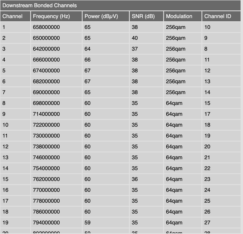

Hi Deschavador,
yes please give us the values of the downstream and upstream channels. It is quite possible that the values are outside the tolerant.
Regards
Wallace
I hope you get the images below. So far, the uptime has been 12 days !! Which is amazing!
Wallace
Hey,
the upstreams seem to be disturbed on your connection and I would like to have a closer look at that. Send me your customer data (name, address, customer number, birthday) in a private message and then let me know here that you have sent the data.

Hi,
I was right with my assumption. There is a disturbance on the upstreams and our technicians are already in the process of eliminating it. You will receive an SMS from us when our colleagues have been successful.
