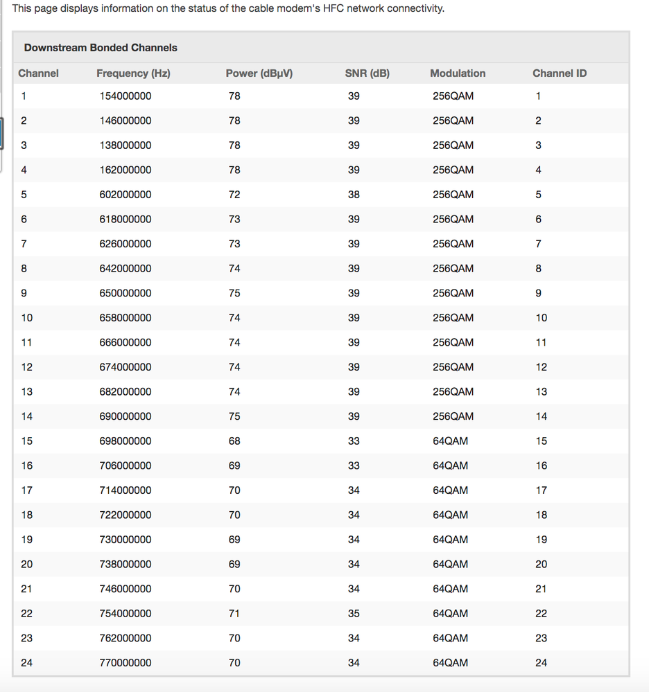

Screen Shot 2020-02-26 at 13.10.16.pngScreen Shot 2020-02-26 at 13.10.21.png
Some connection relevant information.

Hello radicalrj,
apparently the modulation fluctuates upstream. Maybe there are too many errors in the transmission to CMTS. I'd be happy to take a look at it. Please send me your customer number, address and date of birth by private message.

Hello radicalrj,
the signal levels at your connection are not correct. It fits to the neighbors in the house. Do you use the supplied antenna cable or do you use your own cable? Can you make sure that this cable is firmly connected and undamaged? Otherwise, a technician must look at you. Do you have a multimedia antenna socket or a normal antenna socket? If you are not sure, send a picture.

Some connection screenshots again:
Screen Shot 2020-02-28 at 20.22.10.pngScreen Shot 2020-02-28 at 20.22.24.pngScreen Shot 2020-02-28 at 20.22.30.png

Hello radicalrj,
okay, thanks for the test. Can I hire a technician to check the situation on site and see where the bottleneck is? On the one hand, this can be the shifted signal and on the other hand, a bottleneck in the workload in your area. The appointment windows for the technician are 8-11, 11-14, 14-17 and 17-20 o'clock.

Hello radicalrj,
I passed the order on to Field Ops. It was discovered that there are already upload restrictions in your area. There is also already a ticket. This was created in connection with this post. The expansion in this area should continue until the end of the year. Unfortunately, a technician on site can not fix the problem. I'm sorry. Gladly we can cancel the upload option.
