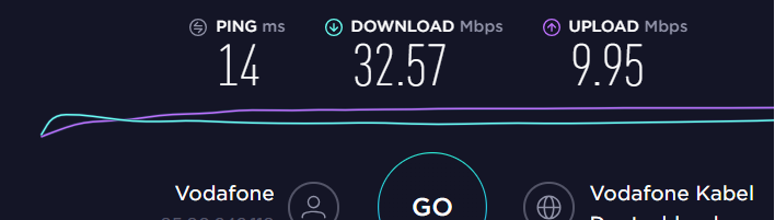

I want to make something clear. The apartment is small, all devices lost conection to the device no matter if you are next to it, the conecction will be lost. Connecting a computer via cable is possible but not viable solution since my phone and tablet cannot be connected via ethernet cable ;).
I just want my router to work as is supposed to work, and get the service im paying for and not this, when im supposed to get 200 mbps.Untitled.png
