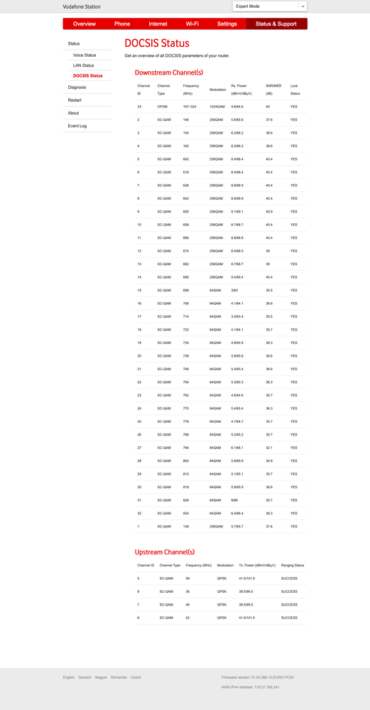

Last several days I noticed an issue with Internet access speed:
I have around  60 Mbit UP and 1Mbit Down, ping around 100ms. Speedtest ID example: tktwv94w2wyc.
Sometimes it becomes better, sometimes worse, but overall speed test is far away from my tariff is offering.
Tried to reboot the router several times: does not help.
Below the information which might be helpful:
  • Which contract do you have? Red Internet & Phone 1000 Cable
  • Which modem / router do you use? ARRIS TG344DE
  • Do you use a loaner device from us or do you have your own device? Vodafone Device
  • What is the errorLow speed, high ping
  • How is your terminal with the modem connected? Gigabit LAN, cable CAT6
  • Which browser do you usually use? Chrome 86.0.4240.111
  • Which operating system do you have on your computer? macOS Catalina 10.15.7
  • Start and period of the disturbance: Last several days
  • Upload a screenshot of the signal values. Please find the screenshot below
  • What measures were carried out by the fault hotline (available at 0800-5266625)? Unable to talk to support since I do not speak German.
  • In which state do you live? Bavaria
Appreciate any advice/assistance. If any other information required please let me know.

EAM2020
Sorry, I've incorrectly defined the speed issue in the previous post.
Currently, I have 60 Mbps DOWN and 1Mbps UP whereas my tariff offers 1000 Mbps Down and 50 Mbps Up. (!)
Regards,
Claudia
Hello EAM2020,
we still have your data from a former thread, so I could already check your line. There's a problem with the return path that causes the low upload, I made a task for you. Regarding the download speed, is it low in the evening only? Please make a speedtest via ethernet in the morning to check that.

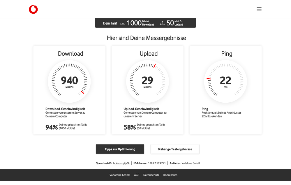

EAM2020
Claudia hello,
Thank you for your reply and support.
I measured speed metrics yesterday and today during morning/evening time and they look much better now: ~950 Mbit Down and ~ 35 Up.
I'll continue to monitor for a couple of days, if everything is fine, then thread can be closed.
Thank you.
Screenshot_2020-11-10 Speedtest Plus für Kabel- und DSL-Verbindungen Vodafone(4).pngScreenshot_2020-11-11 Speedtest Plus für Kabel- und DSL-Verbindungen Vodafone.png
