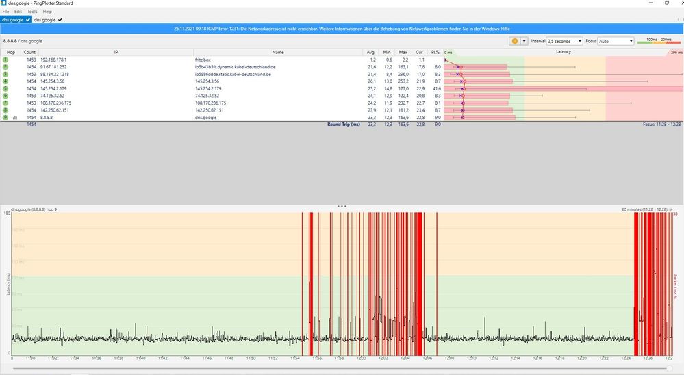

Beigefügter Pingplotter Screen sowie ein Auszug aus den Supportdaten der Fritzbox:

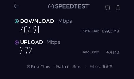

Speedtest:

Anbei noch der aktuelle Pingplotter:
modemneustart war gegen 10:00 Uhr deshalb sieht man zu Beginn keinen Packetloss:

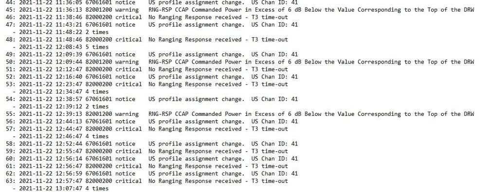

Mit einer zweiten Fritzbox (diesmal 6591) (Version 07.29) eergibt sich das gleich Fehlerbild:
DOCSIS CM Eventlog:
37: 2021-11-25 23:41:48 82000200 critical No Ranging Response received - T3 time-out
- 2021-11-25 23:53:48 9 times
38: 2021-11-25 23:57:13 82001200 warning RNG-RSP CCAP Commanded Power in Excess of 6 dB Below the Value Corresponding to the Top of the DRW
39: 2021-11-26 00:00:01 67061601 notice US profile assignment change. US Chan ID: 41
40: 2021-11-26 00:03:50 82000200 critical No Ranging Response received - T3 time-out
- 2021-11-26 00:04:48 2 times
41: 2021-11-26 00:07:32 67061601 notice US profile assignment change. US Chan ID: 41
- 2021-11-26 00:12:32 3 times
42: 2021-11-26 00:13:48 82000200 critical No Ranging Response received - T3 time-out
43: 2021-11-26 00:14:33 67061601 notice US profile assignment change. US Chan ID: 41
44: 2021-11-26 00:14:48 82000200 critical No Ranging Response received - T3 time-out
- 2021-11-26 00:14:48 3 times
45: 2021-11-26 00:17:18 67061601 notice US profile assignment change. US Chan ID: 41
- 2021-11-26 00:25:04 8 times
46: 2021-11-26 00:25:48 82000200 critical No Ranging Response received - T3 time-out
47: 2021-11-26 00:25:49 67061601 notice US profile assignment change. US Chan ID: 41
48: 2021-11-26 00:26:48 82000200 critical No Ranging Response received - T3 time-out
49: 2021-11-26 00:27:19 67061601 notice US profile assignment change. US Chan ID: 41
- 2021-11-26 00:30:49 4 times
50: 2021-11-26 00:35:48 82000200 critical No Ranging Response received - T3 time-out
51: 2021-11-26 00:35:50 67061601 notice US profile assignment change. US Chan ID: 41
- 2021-11-26 00:36:20 2 times
52: 2021-11-26 00:36:49 82000200 critical No Ranging Response received - T3 time-out
- 2021-11-26 00:37:48 2 times
53: 2021-11-26 00:42:06 67061601 notice US profile assignment change. US Chan ID: 41
54: 2021-11-26 00:46:48 82000200 critical No Ranging Response received - T3 time-out
55: 2021-11-26 00:46:51 67061601 notice US profile assignment change. US Chan ID: 41
56: 2021-11-26 00:47:48 82000200 critical No Ranging Response received - T3 time-out
- 2021-11-26 07:06:50 162 times
Während und seit der letzten Fehlermeldung bleibt ein massiver packet loss und ein Upload kommt kaum noch zu stande. Erst der Neustart des Modems löst das Problem für ca. 2 Std.. Das Problem ist bei allen Modems gleich, daher bleiben folgende Fragen offen:
